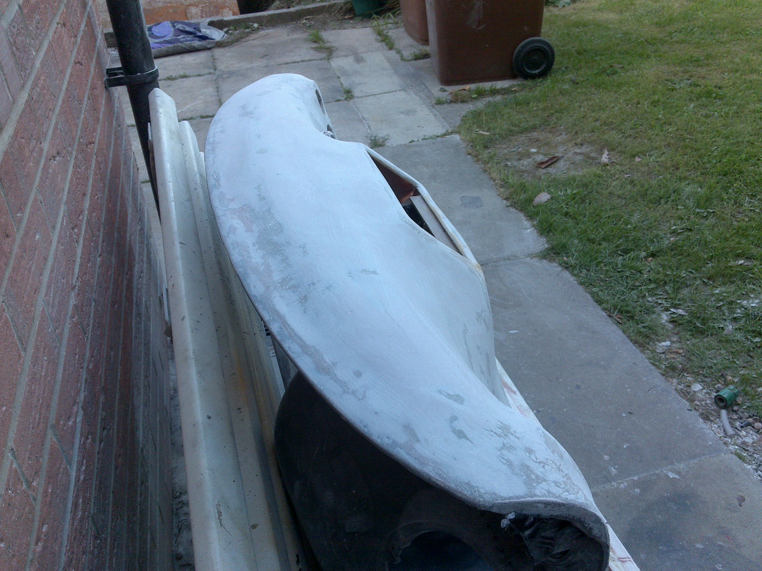

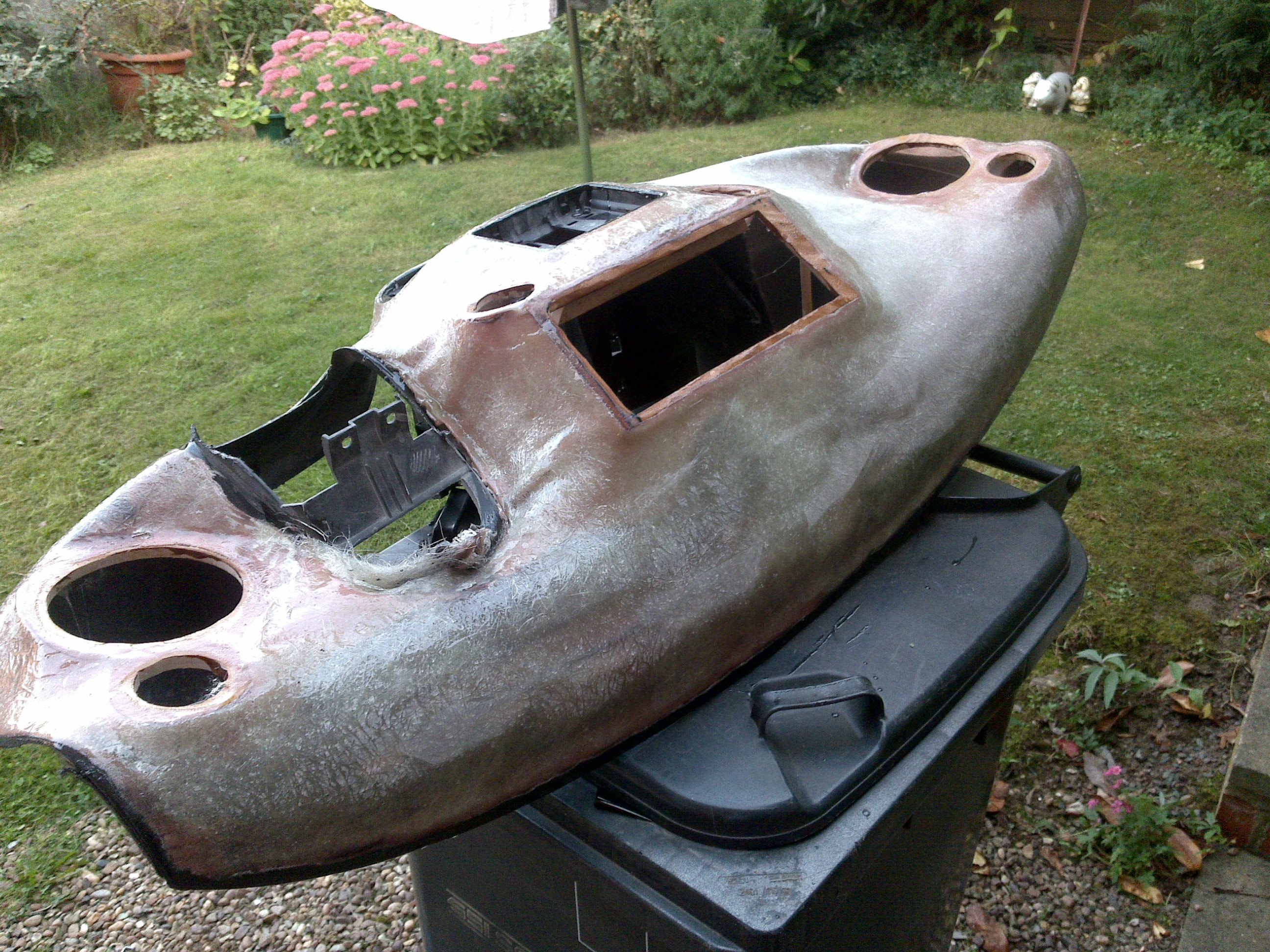

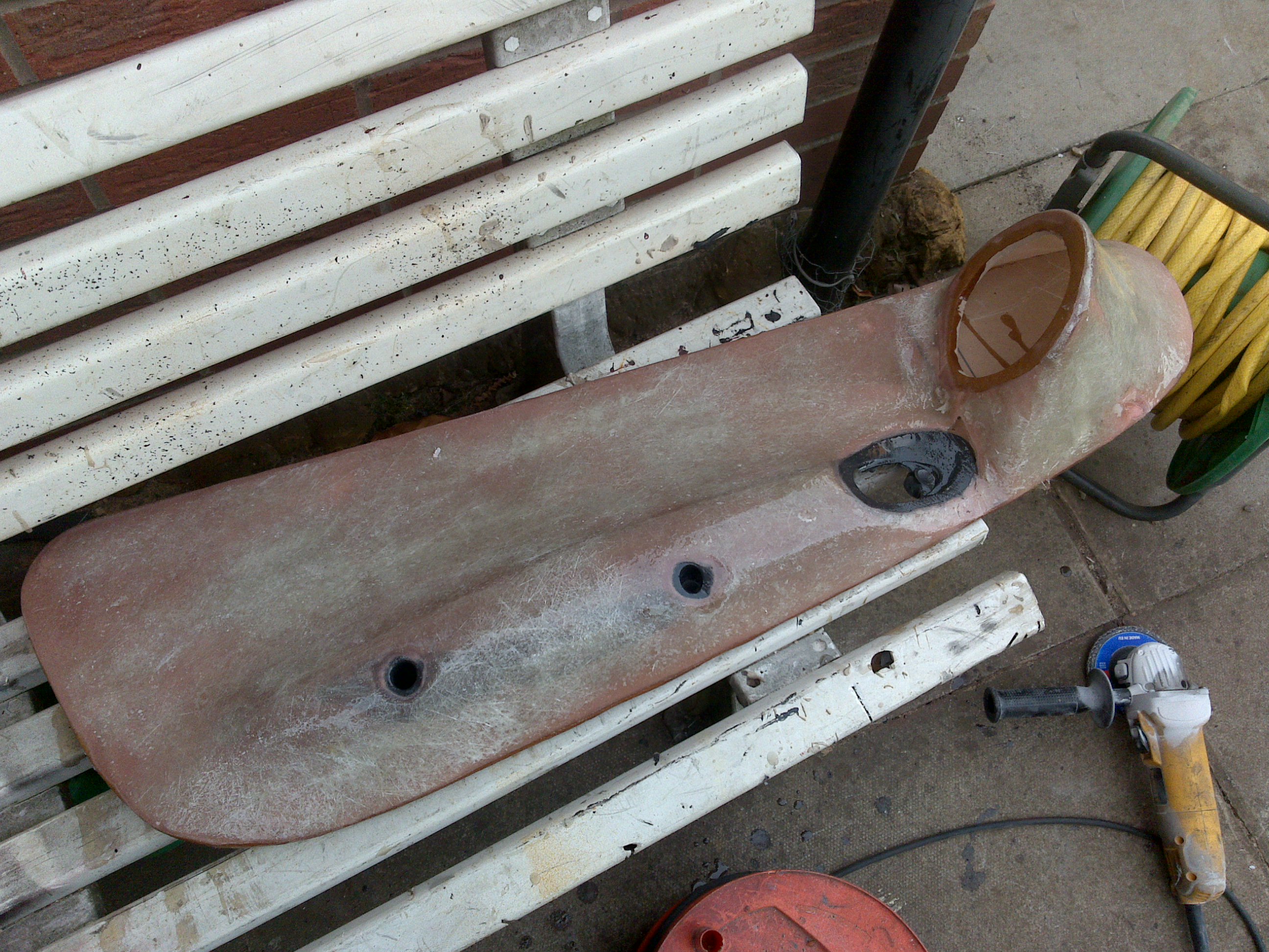

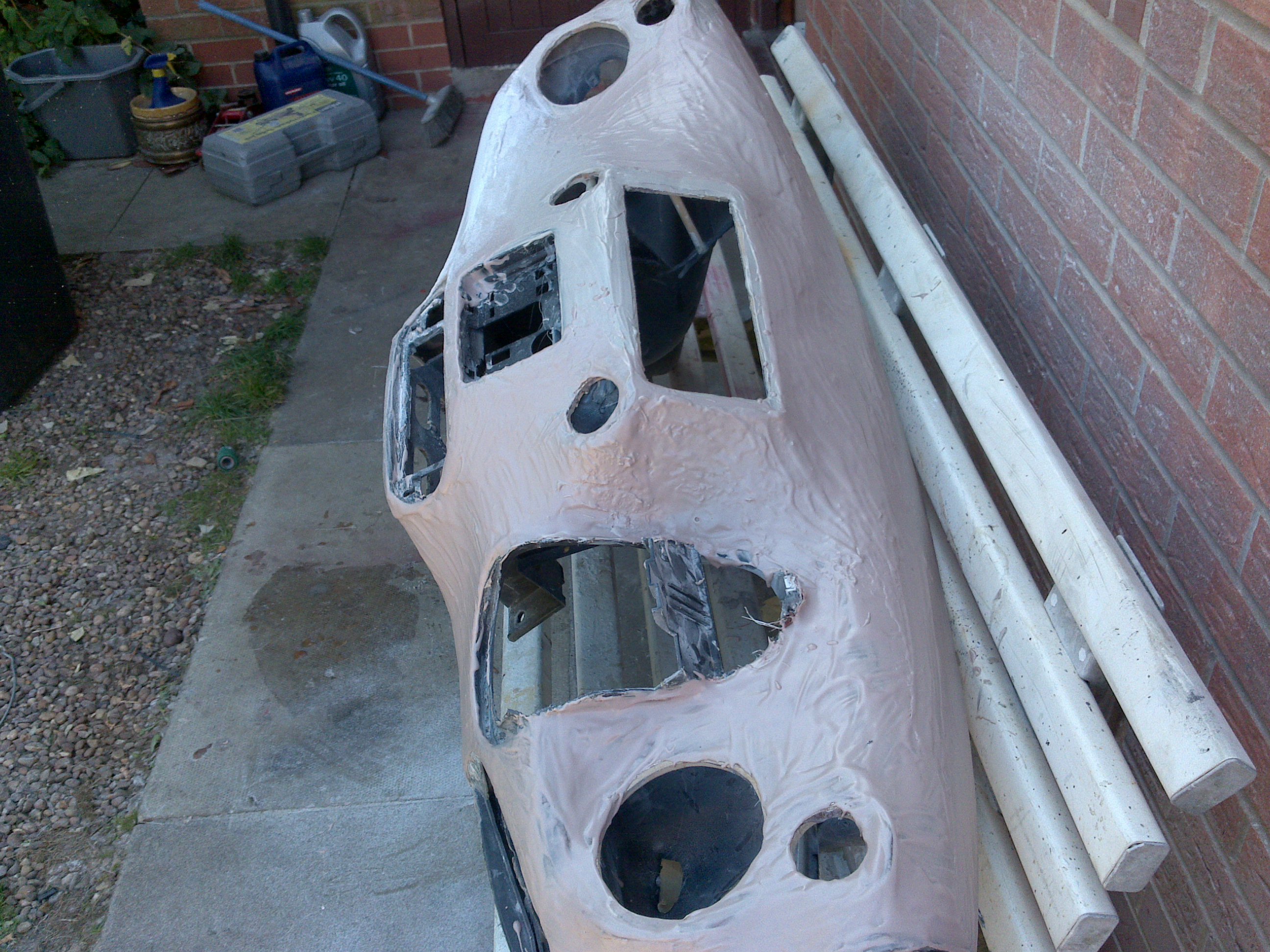

how you finishing the dash mate? paint of flock? go on mate, go get flocked!!!
Possibly smoothing out and spraying in a custom paint mix... Pearlescent Nihtfire Red with metallic flakework...
Although i will be checking out birmingham tomorrow to see if i can get hold of any material flock prior to smoothing the lot out fully.... (loads less work to flock lol)
