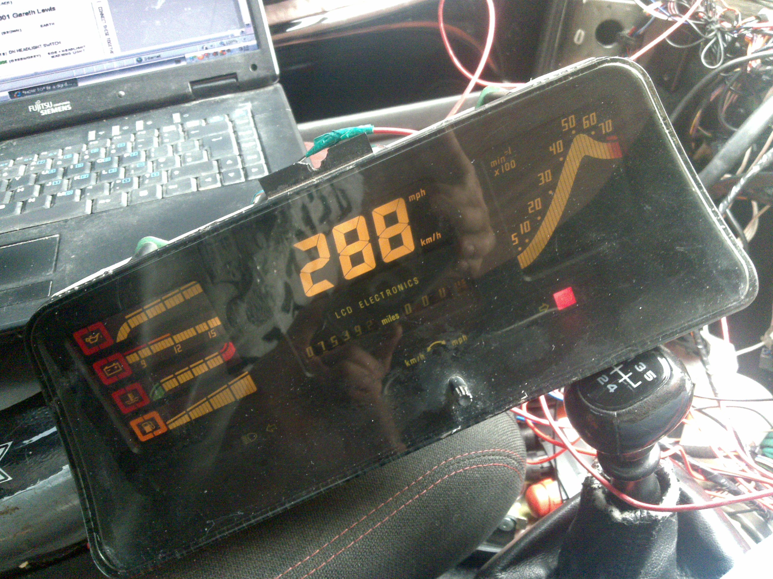

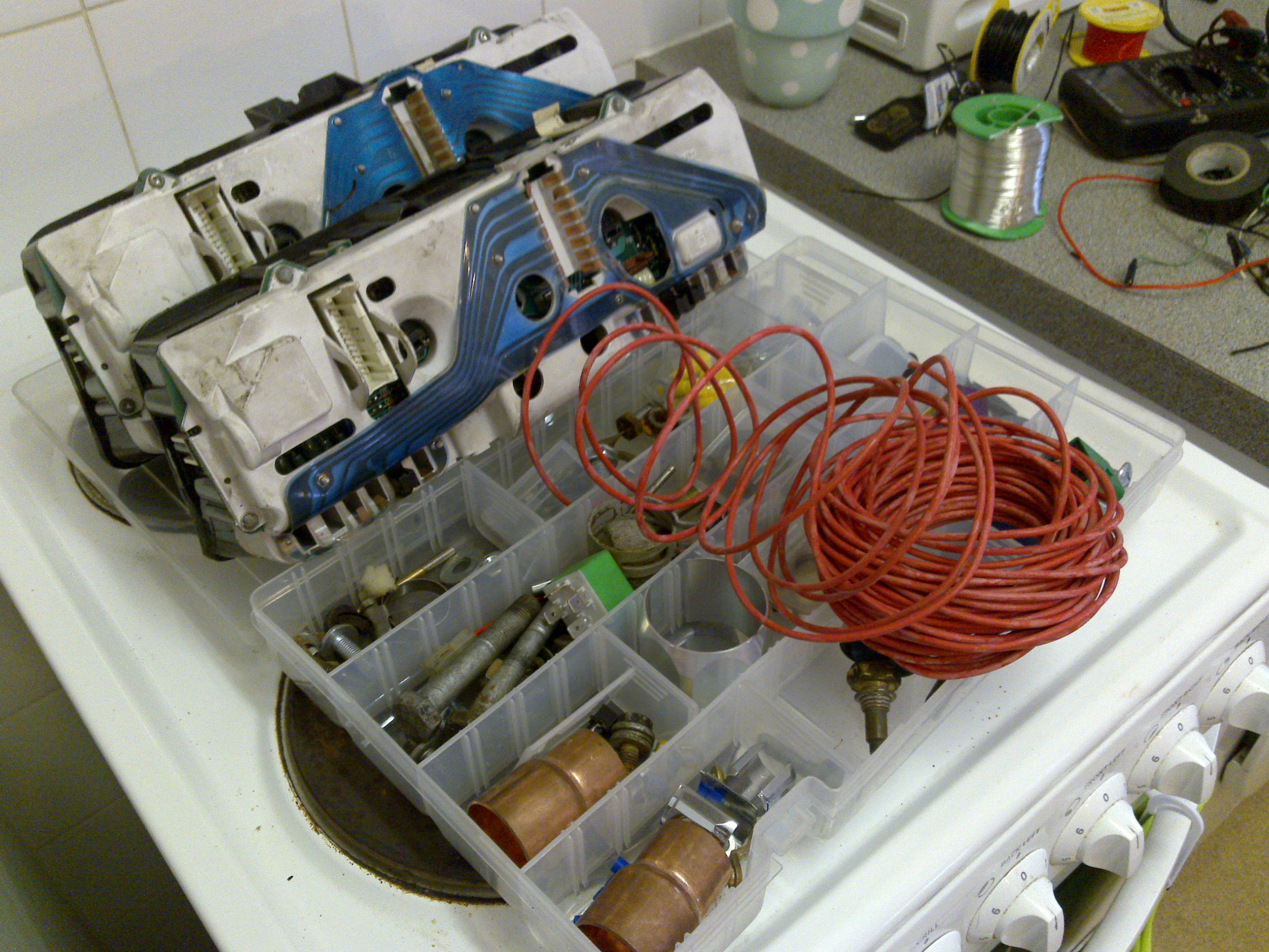

Today ive been wiring up my vauxhall clocks... Bit of a nightmare without a decent wiring diagram.. I had to repair the loom that came with the clocks, and then trace the wiring from the fiat clocks, cut it out and join the relevant wires together..
4 Hours later and they are in and working :D:D:D
Well worth the hassle in my opinion...
(managed to get a pic while the clocks do their initial full sweep)

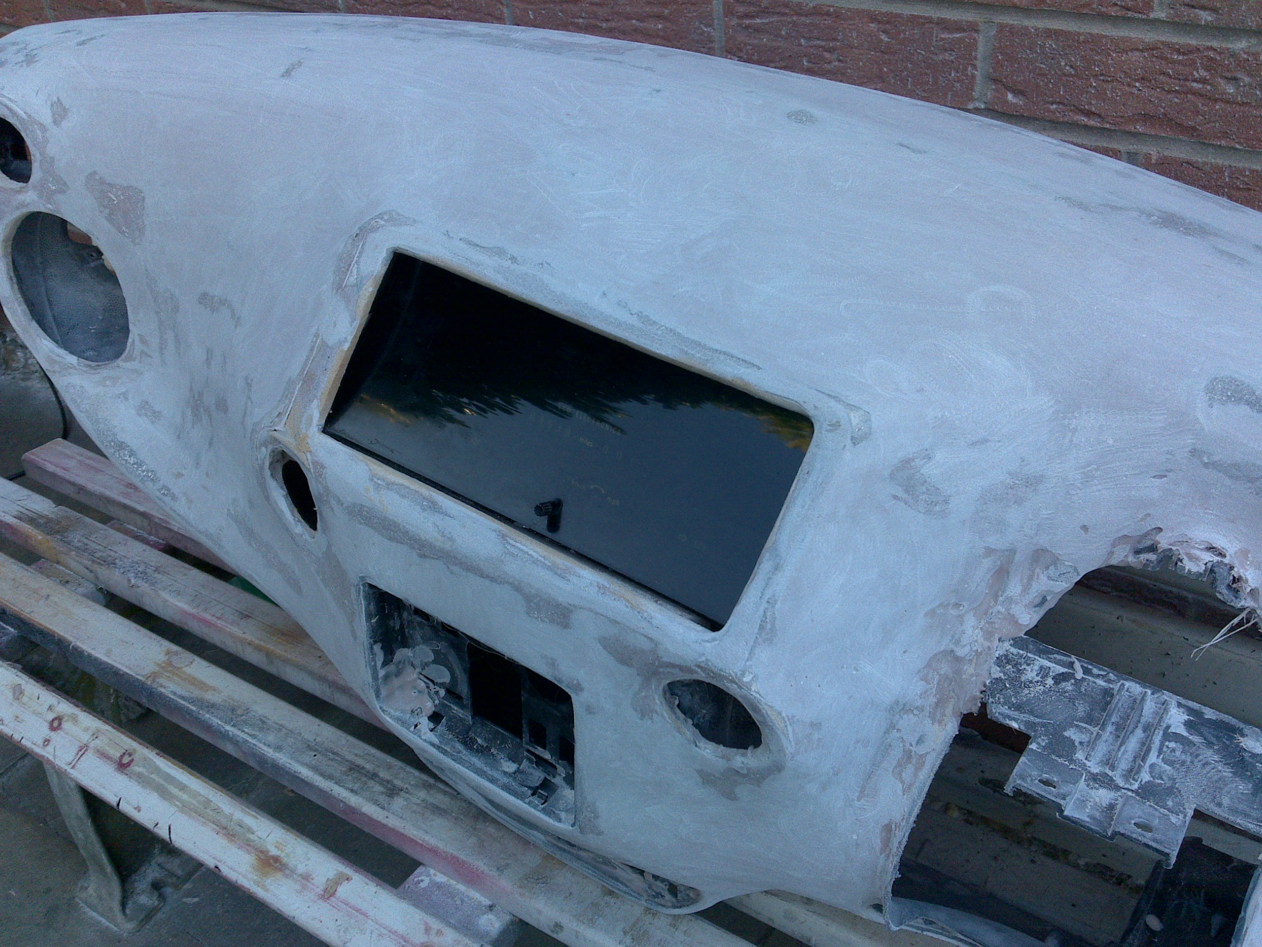

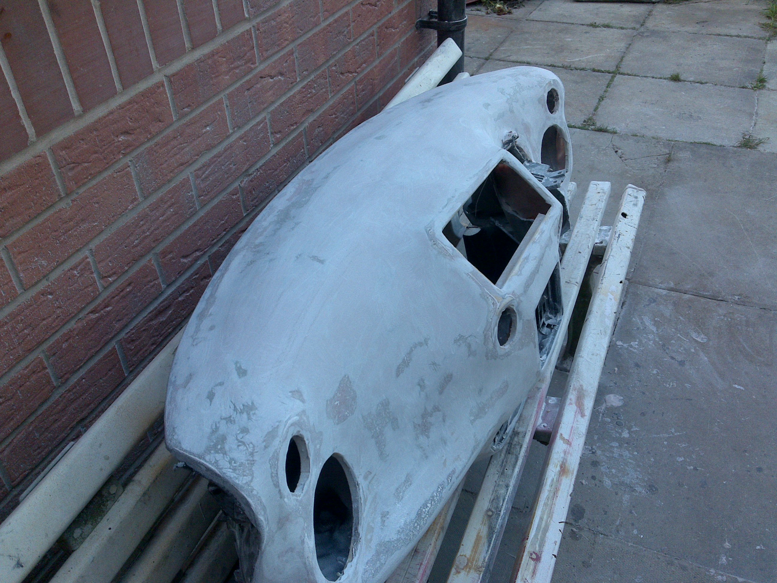

The carpet stuff is black which will match the seats... Im spraying a few bits which will match the seats and rocker cover. Not really sure how much to spray until ive covered the dash and door cards lol.
dash looks good matey, very custom :) get flocking done, my turbo sei has flocking done to it and the feel is amazing, wasnt a DIY Kit i paid like £150-200 for it to be done, they staticly charge the fibres to make them stand up using a waterproof resin so the end effect is that its covered all over equally and feels soft and velvety
Sophie at http://www.southwestflocking.co.uk did the dashboard of my GT4, very good quailty and that dash is considered a large dashboard and cost £120ish including return delivery. You geta choice of flock length as well, I went for shortest at 1mm as looks very neat, but longer 1.5mm and 2mm can be had to have a fluffier alomst alcantara like finish.
A smaller dash like a Sei would not cost as much.
dont go mad. think HU surround and heater srrounds would look best. perhaps a bit on door cards or door handles
Lol there's not much left to spray haha.. only really have the electric window switch surrounds, the main dash part where the original speedo is (like a pod thing) and a few odds and ends in the rear...
My door handles are chrome, but i might colour code them depending if they look out of place.
I really want it flocked, but dont have the time to wait, or the cash at the min :'(

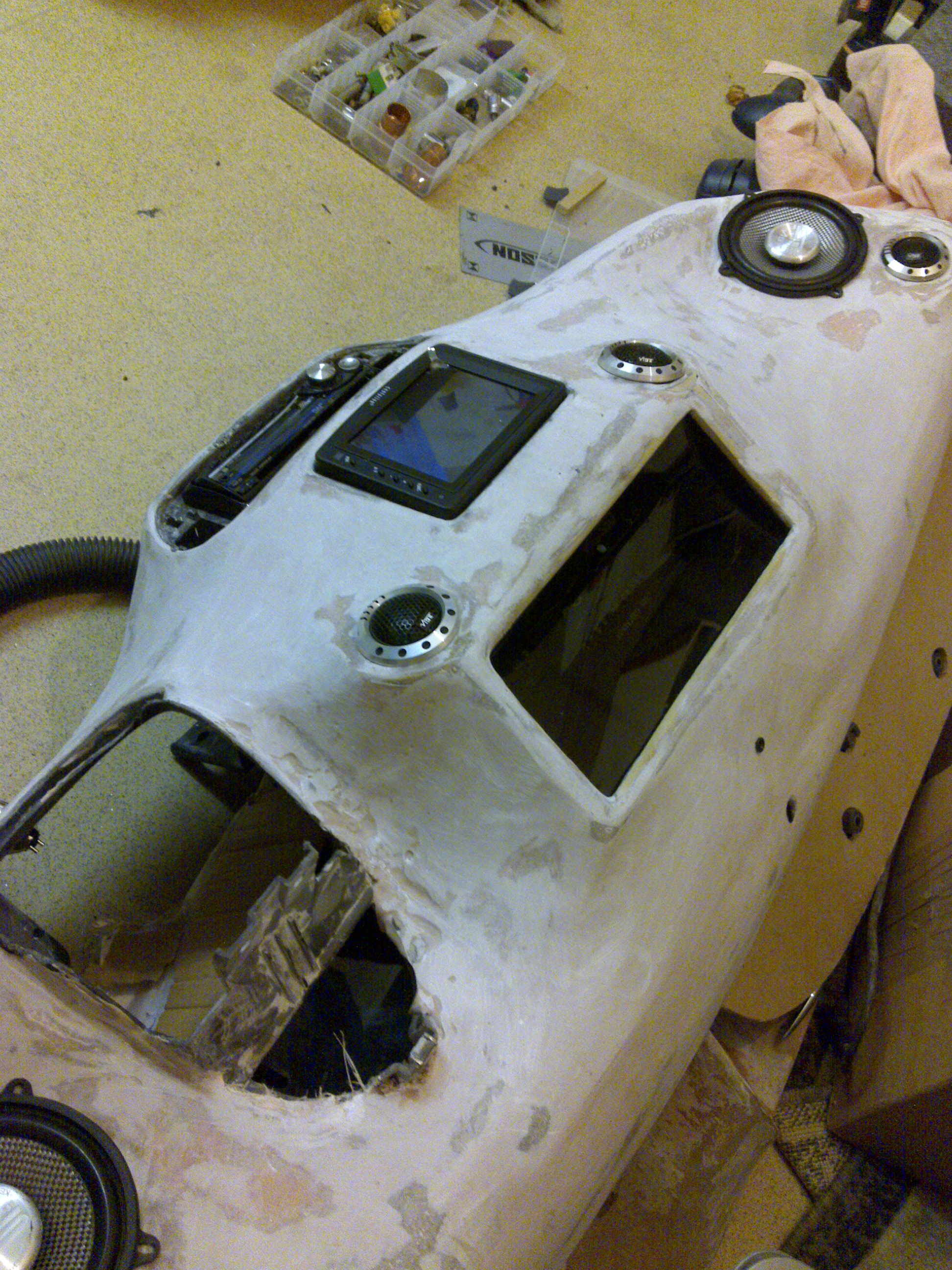

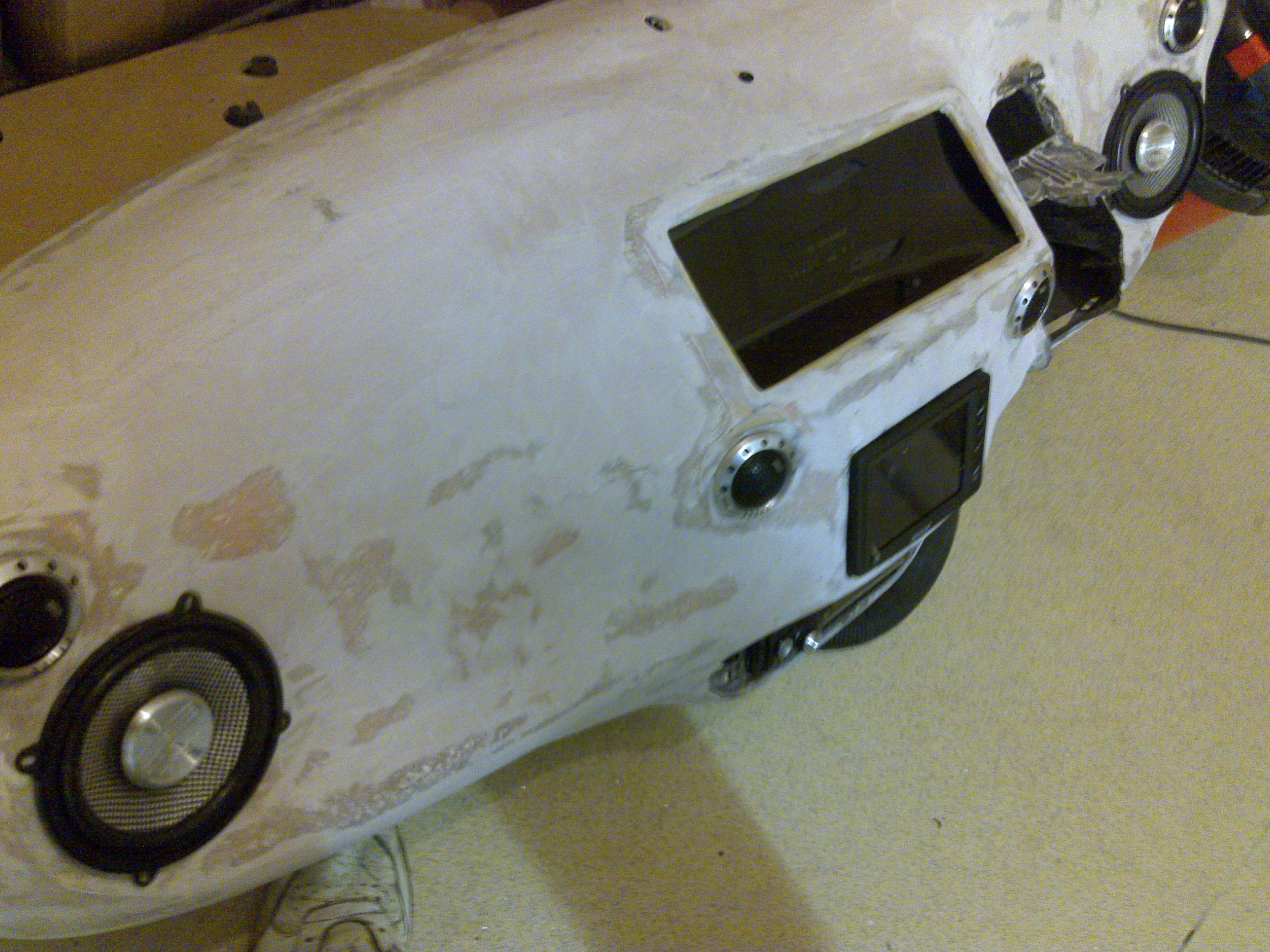

Managed to do some more on the car today... feels like the jobs never seem to end lol.
Anyways, ive sorted the last of the wires out, mainly wiring up my headunit, components, tft screen and camera.
Ive also rebuilt my digital dash as the LCD was flickering. While putting it all back together i gave everything a clean... Looks like new now!
Ive trial fitted the speakers to make sure it all fits before trimming the dash, and so far so good...
Heres a few pics.
