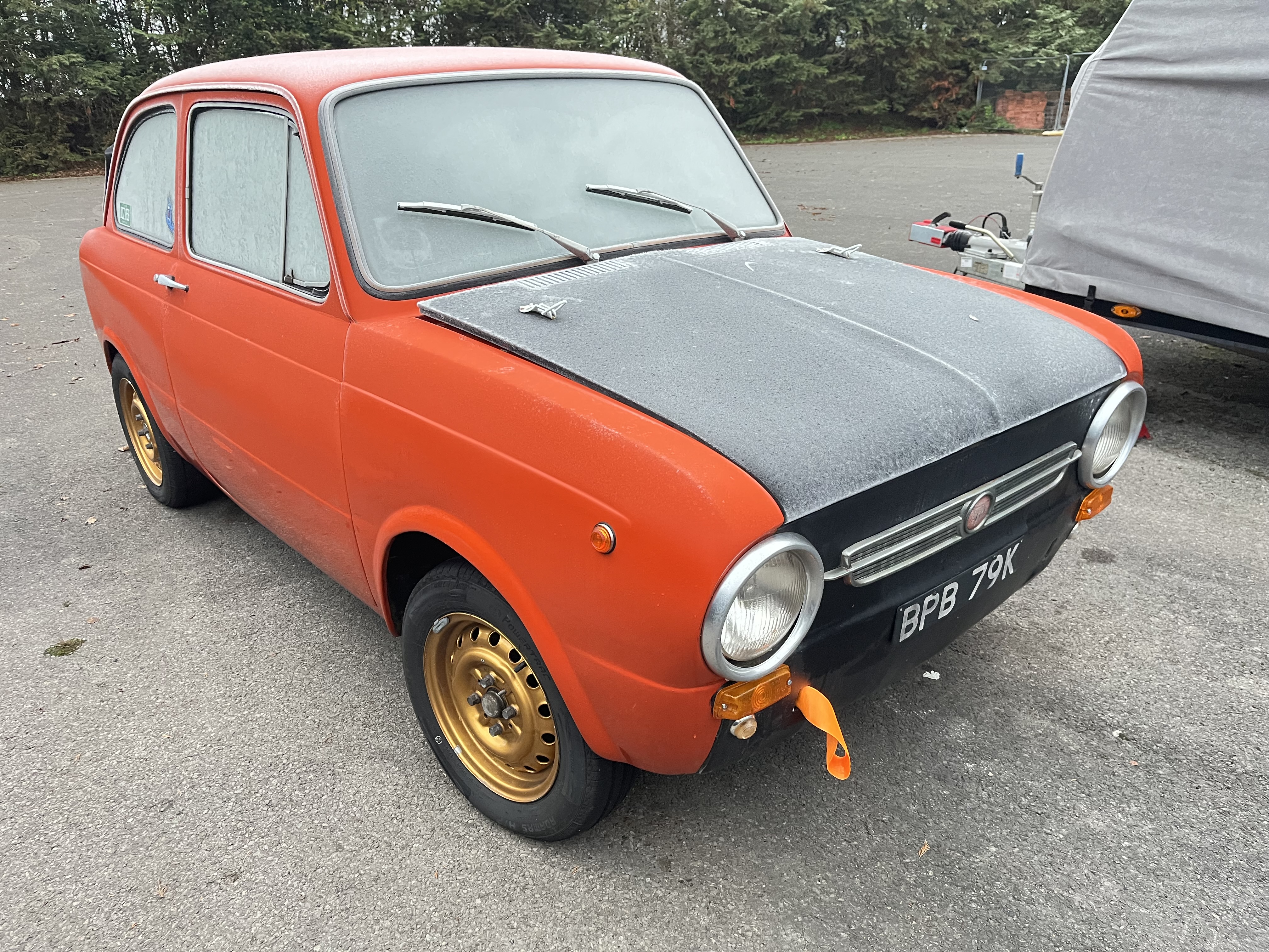

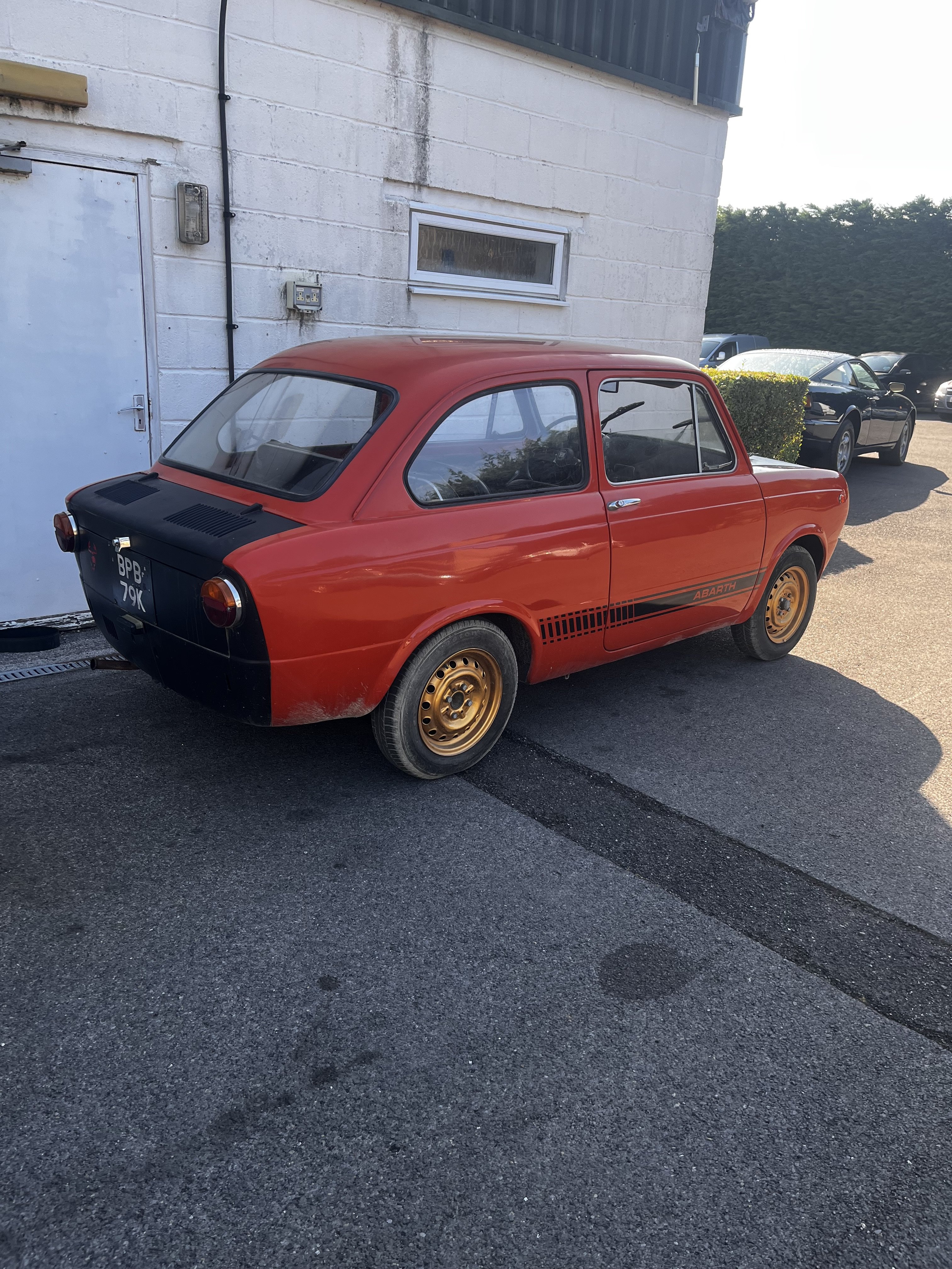

1972 SEAT 850 especially build
This is my 1972 seat

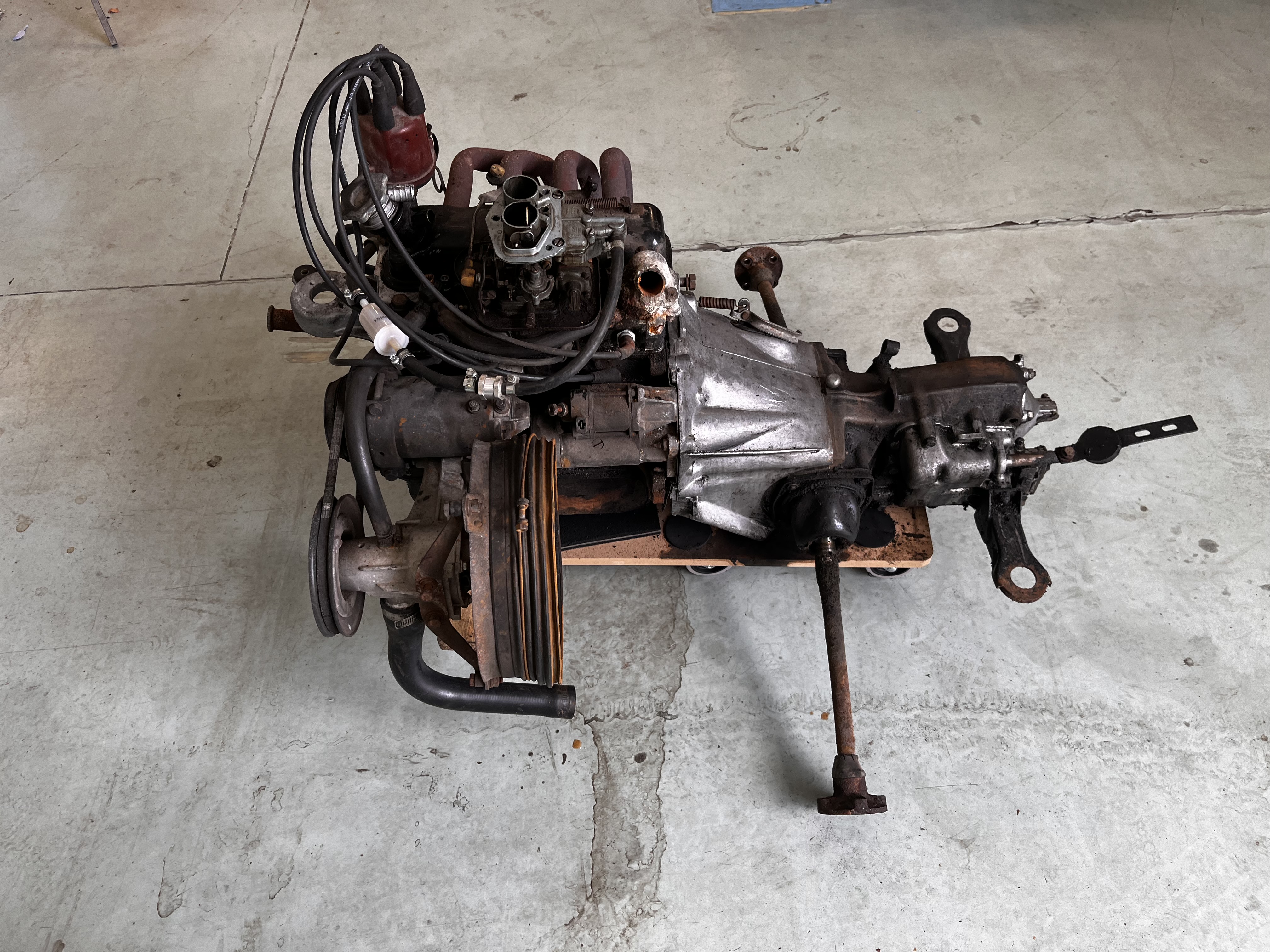

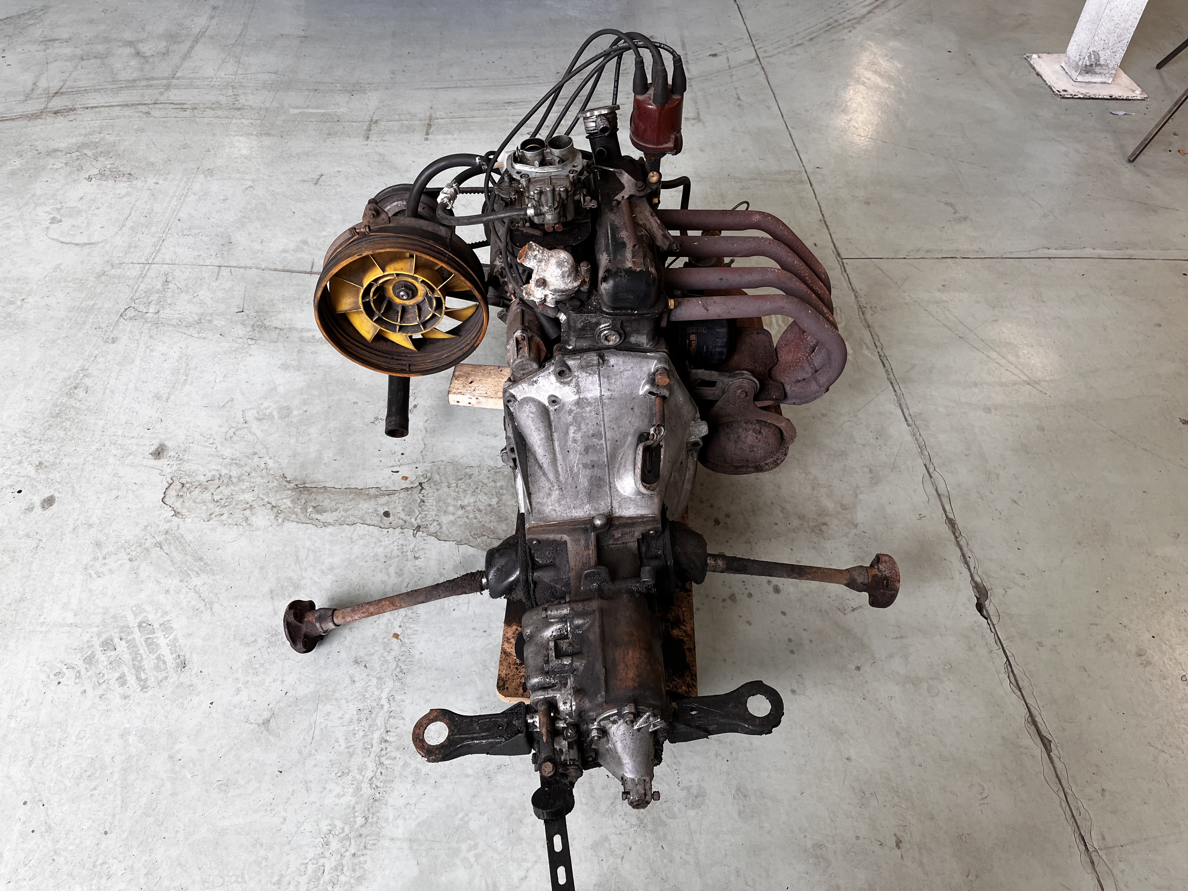

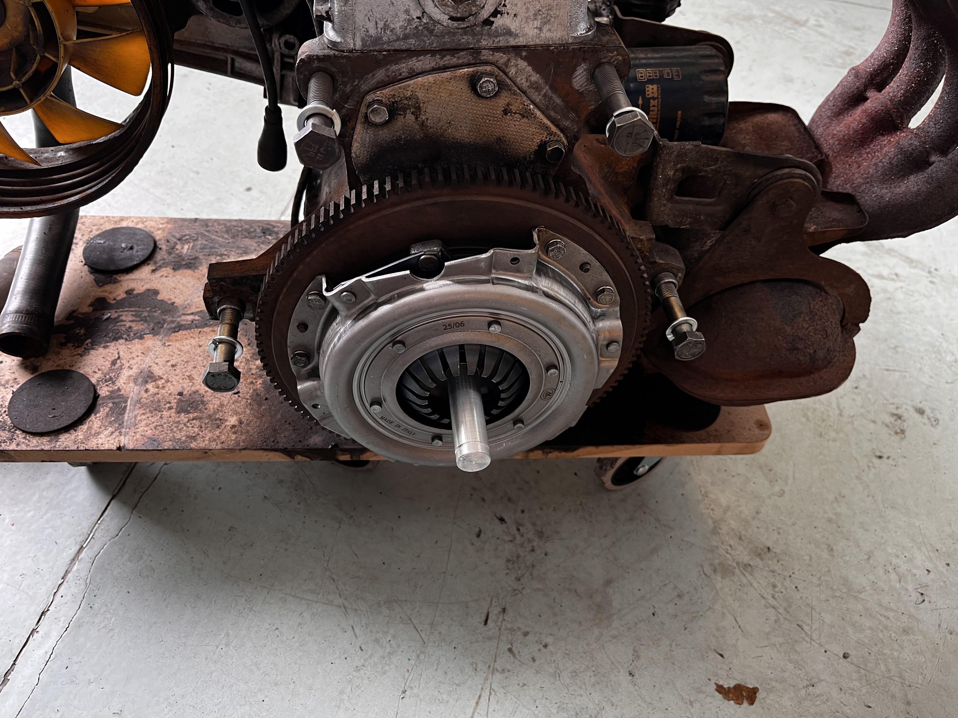

While driving to get the tyres changed ( first drive on the road) I found out the clutch was slipping so could only achieve 40kph up a small hill so dearly undeliverable. Also found I have no flywheel cover . If anyone has one I would be very interested.

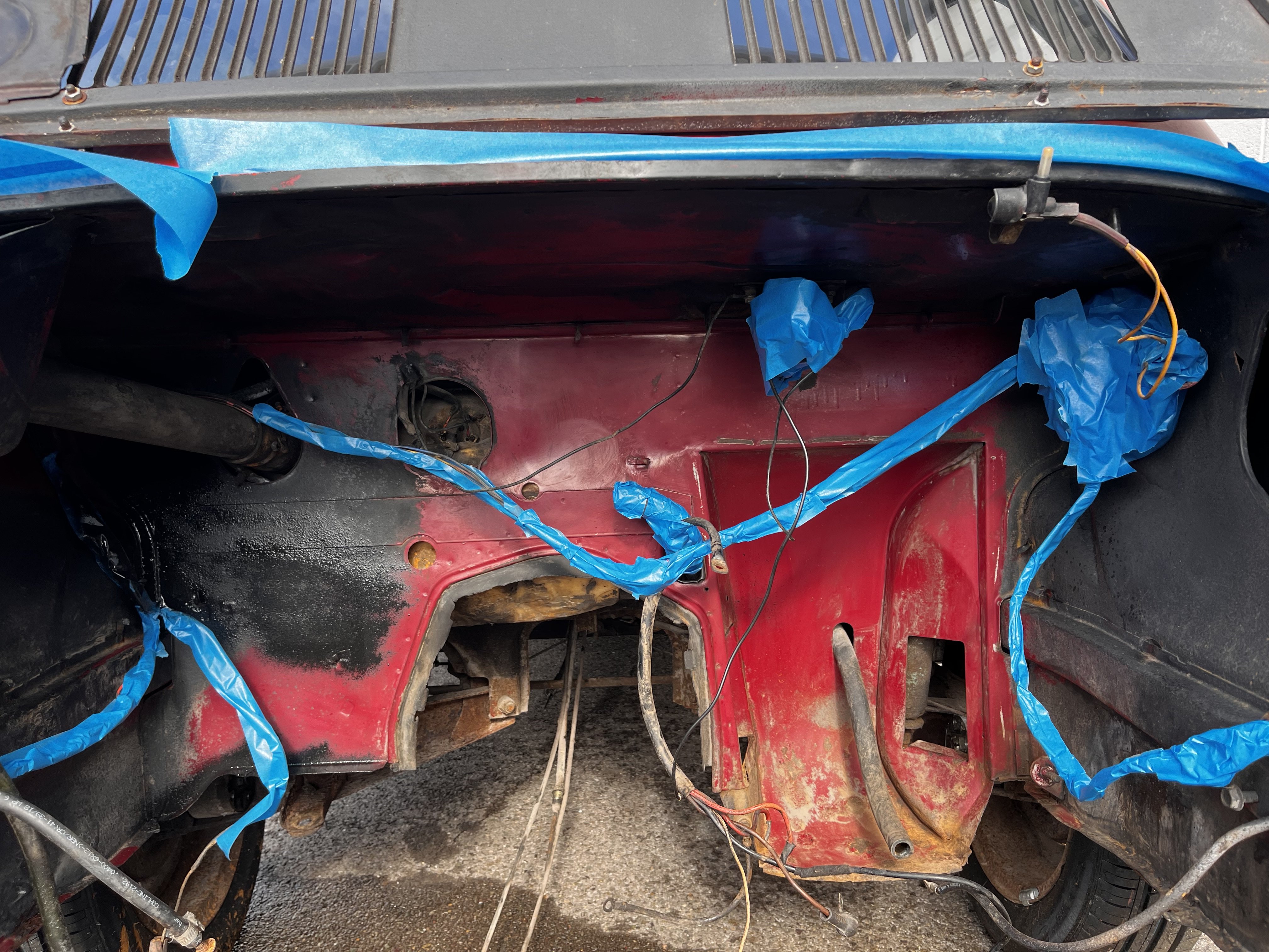

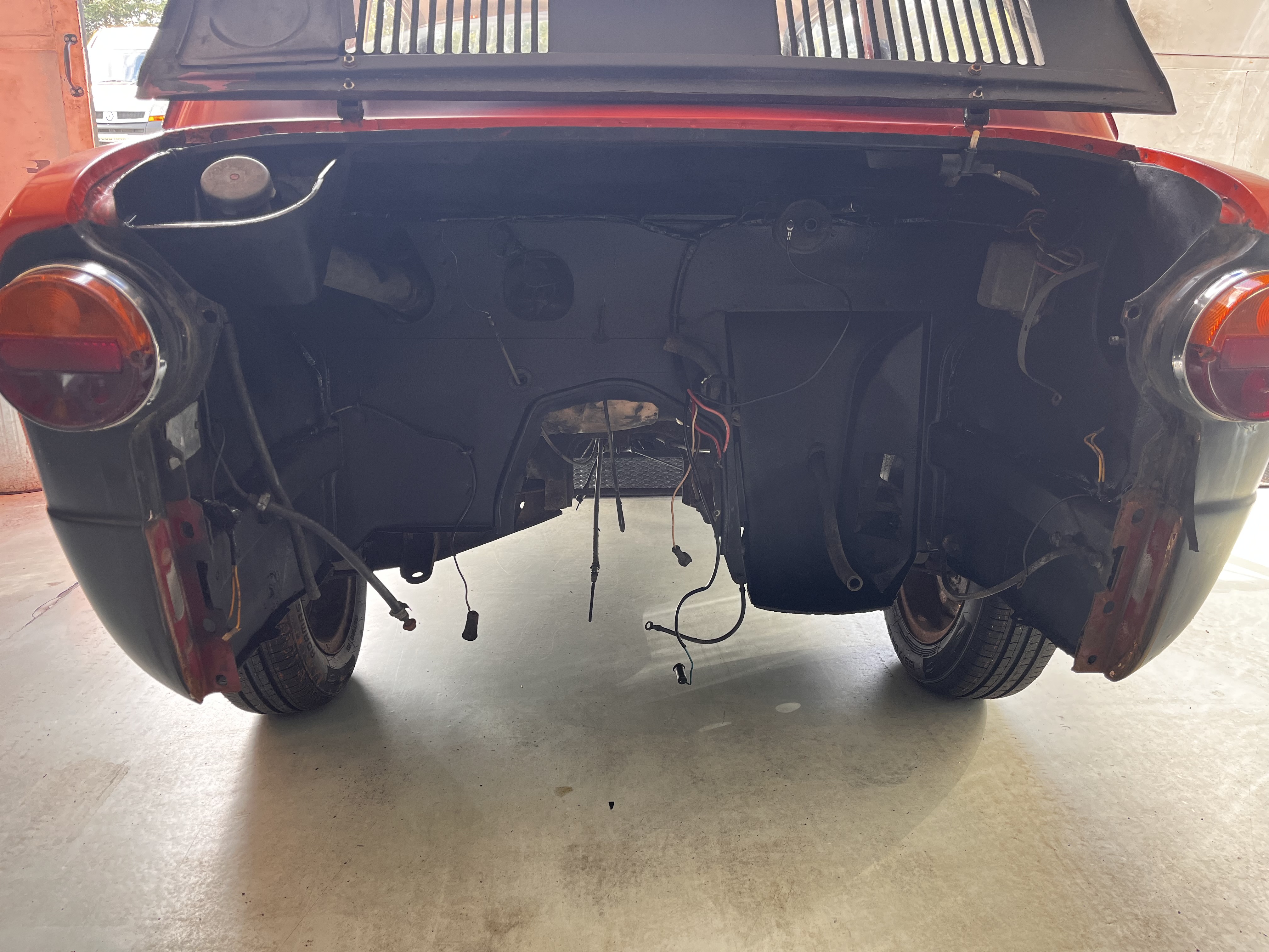

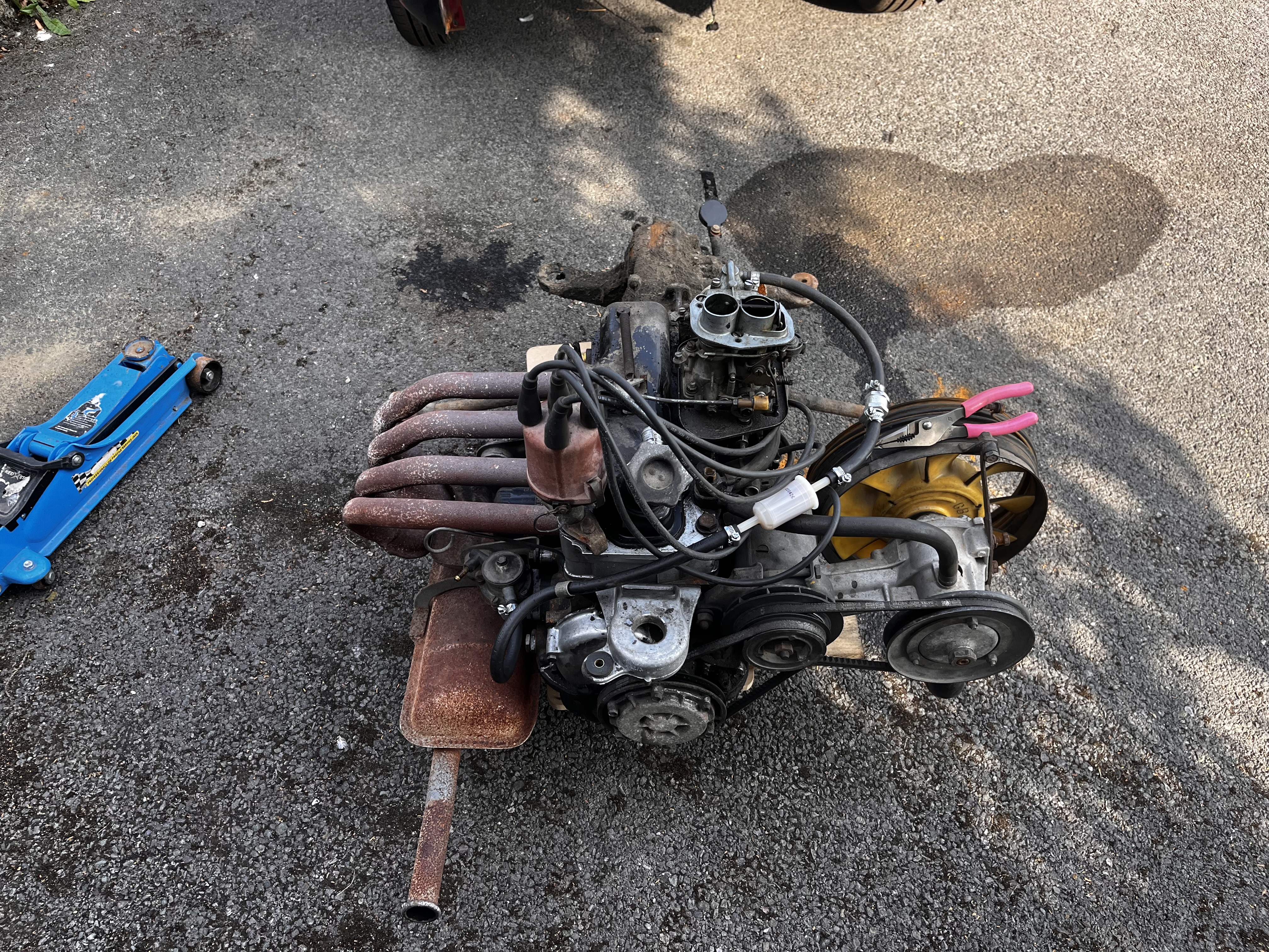

So….. out comes the engine and box.

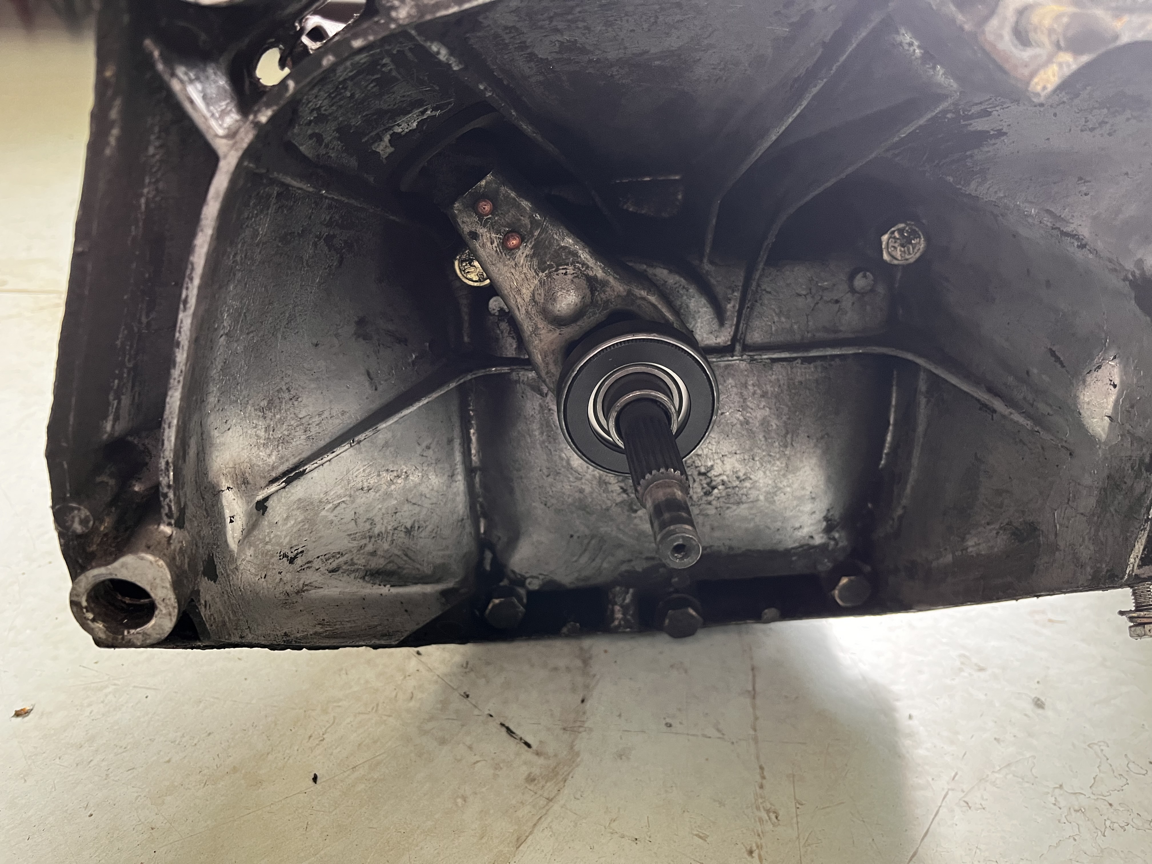

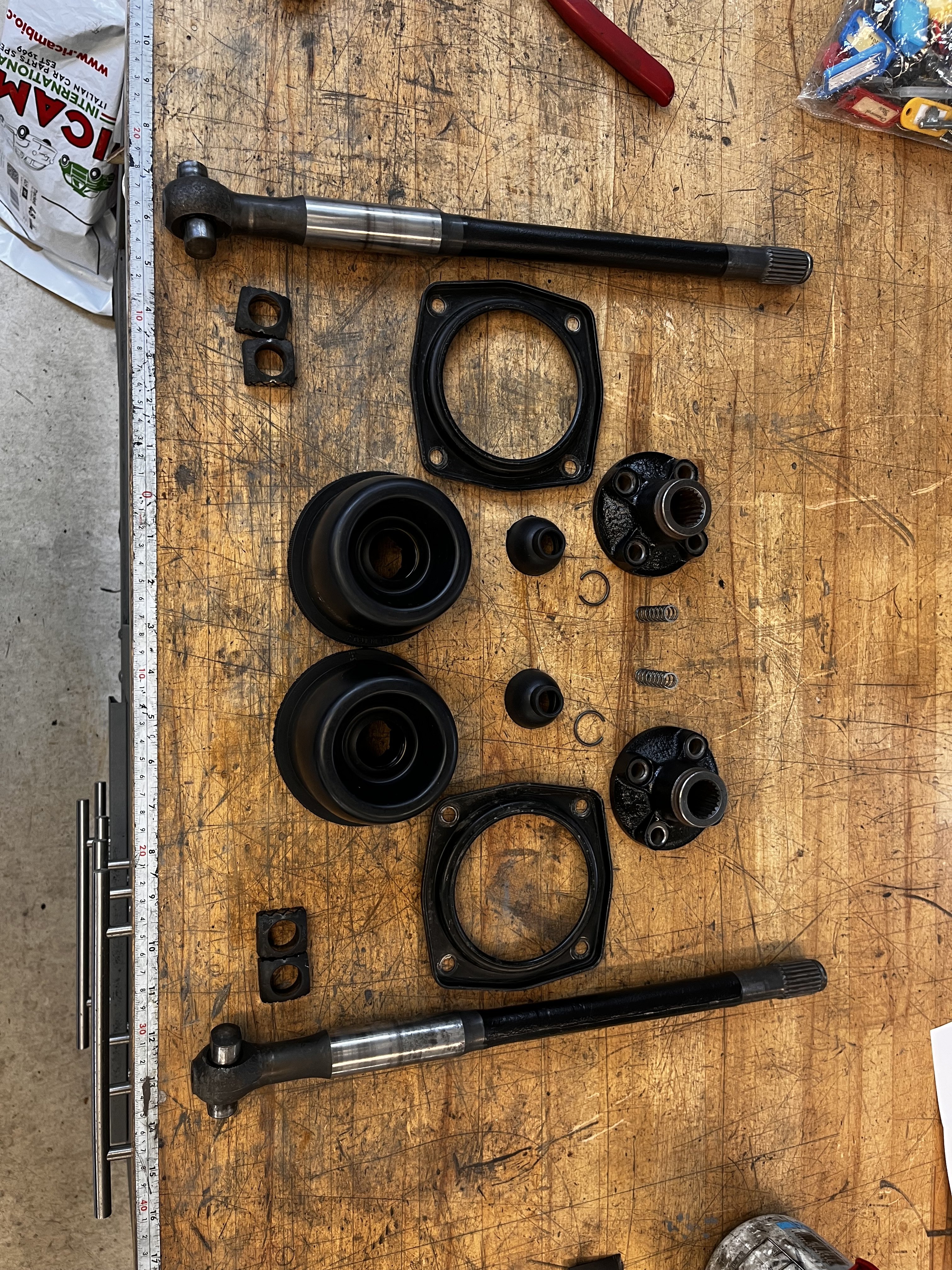

After removing a lifetime of grease and farm from both , probably 2-3lbs of crud. I removed the gearbox to get a look at the clutch ,
Friction plates has started to break down and has worn so much the rivets have grooved the pressure plates. So a new three piece is needed.

Unless already fitted a light flywheel skim may be advisable if rivets have scored flywheel as well as old pressure, unless of course you were lucky.;)
Reason being it reduces clutch contact area until worn in to match grooves, a bit like brake discs.

I have been fortunate that the flywheel is in great condition . The rivets were only worn through on the pressure plate side .

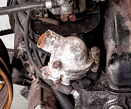

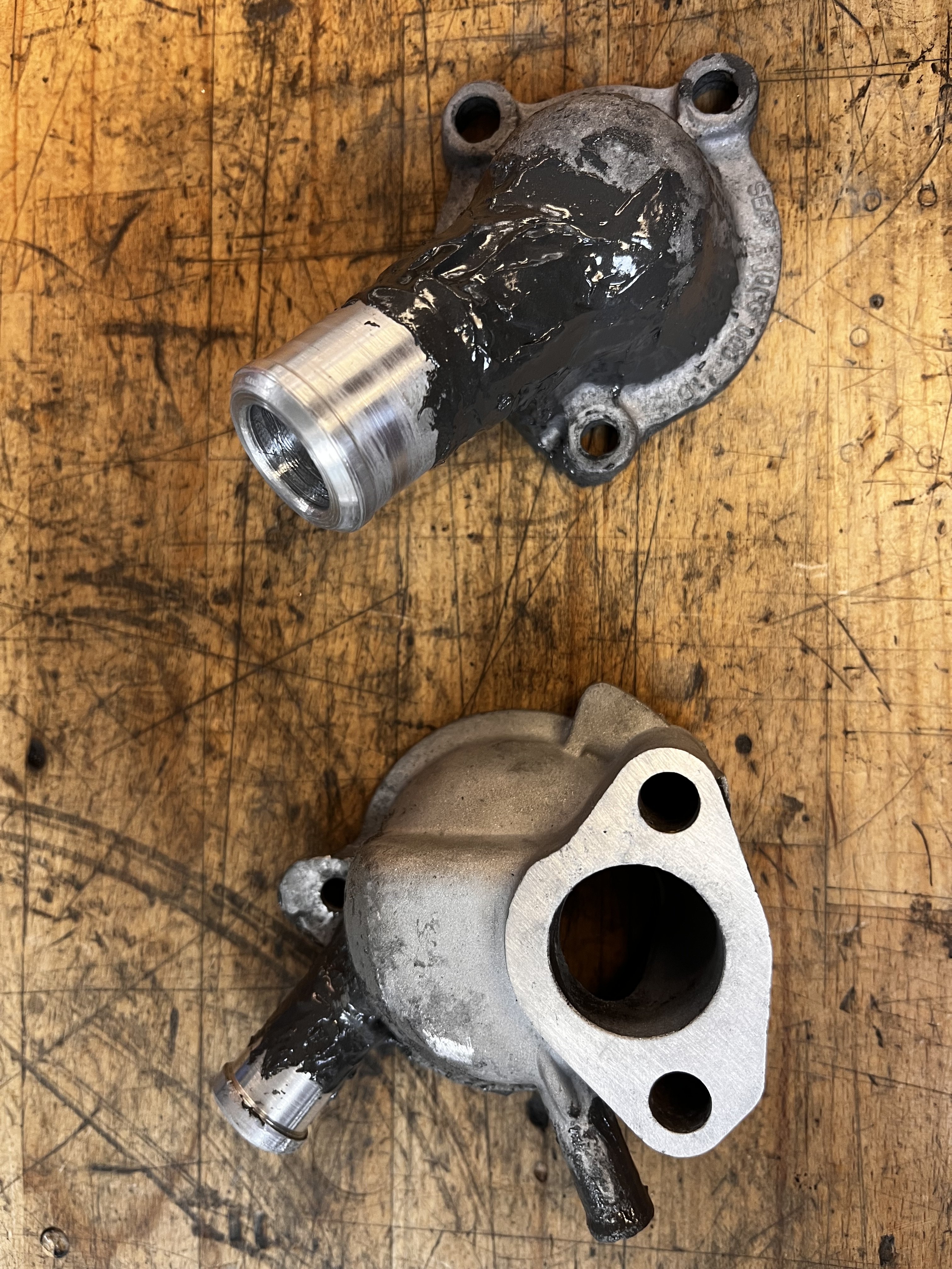

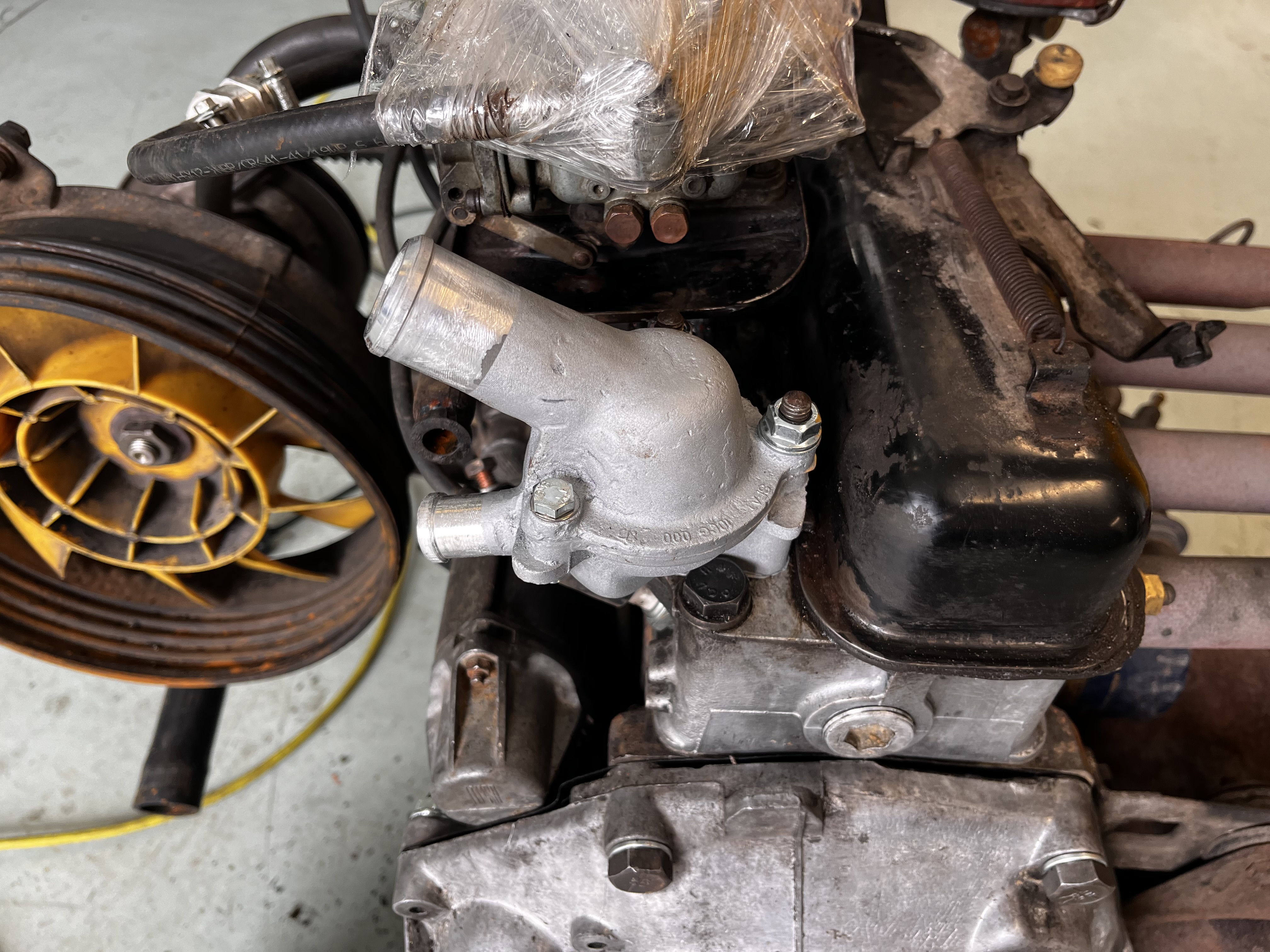

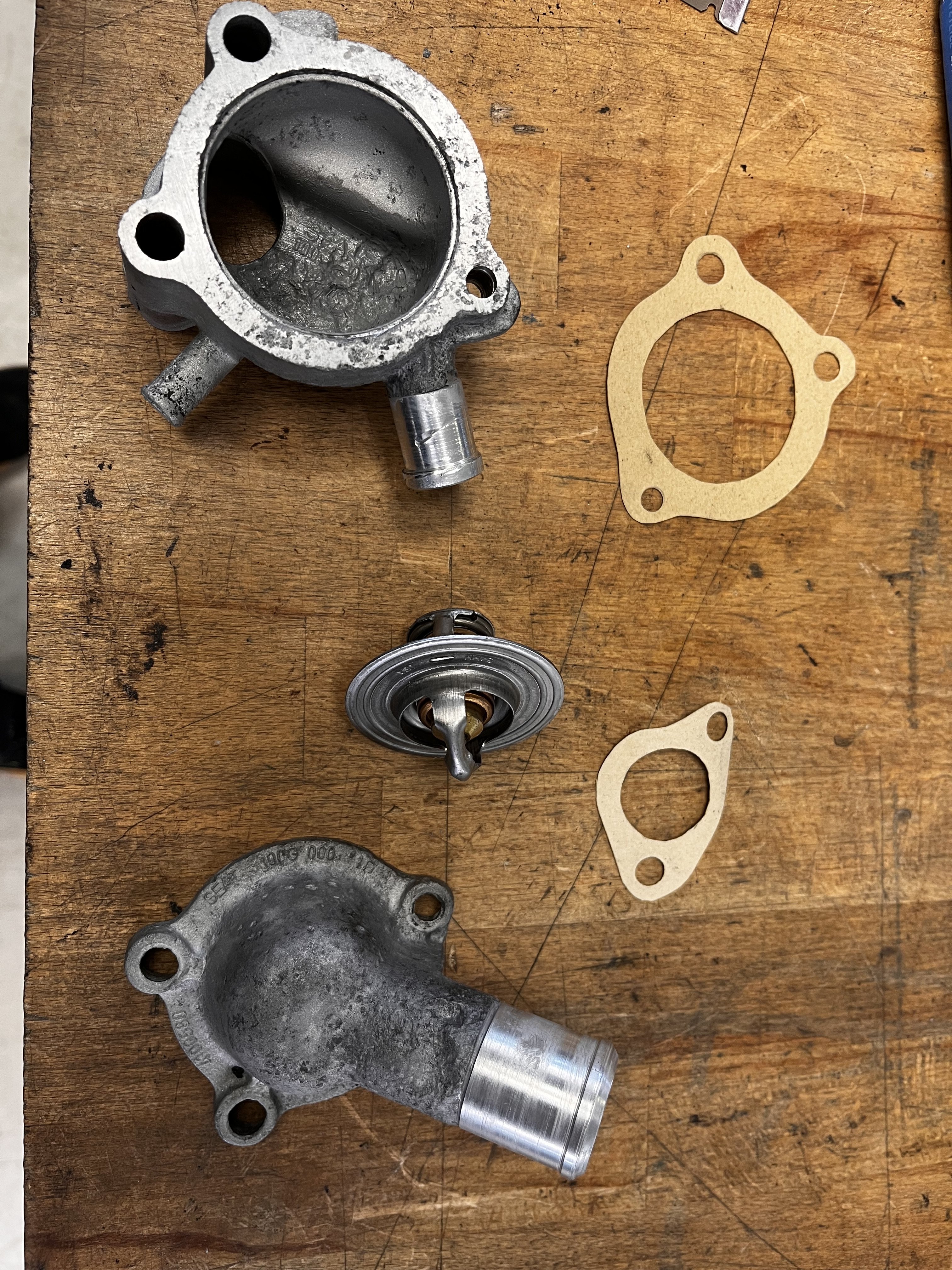

Thermostat housing was in pretty rough shape. After a strip down and blast I set about machining some sleeves to replace the corroded pipes.
Then sealed them in and built up the main body. Some final filing and the result is one I am happy with.
Made some new gaskets ant fitted the housing with a new thermostat.

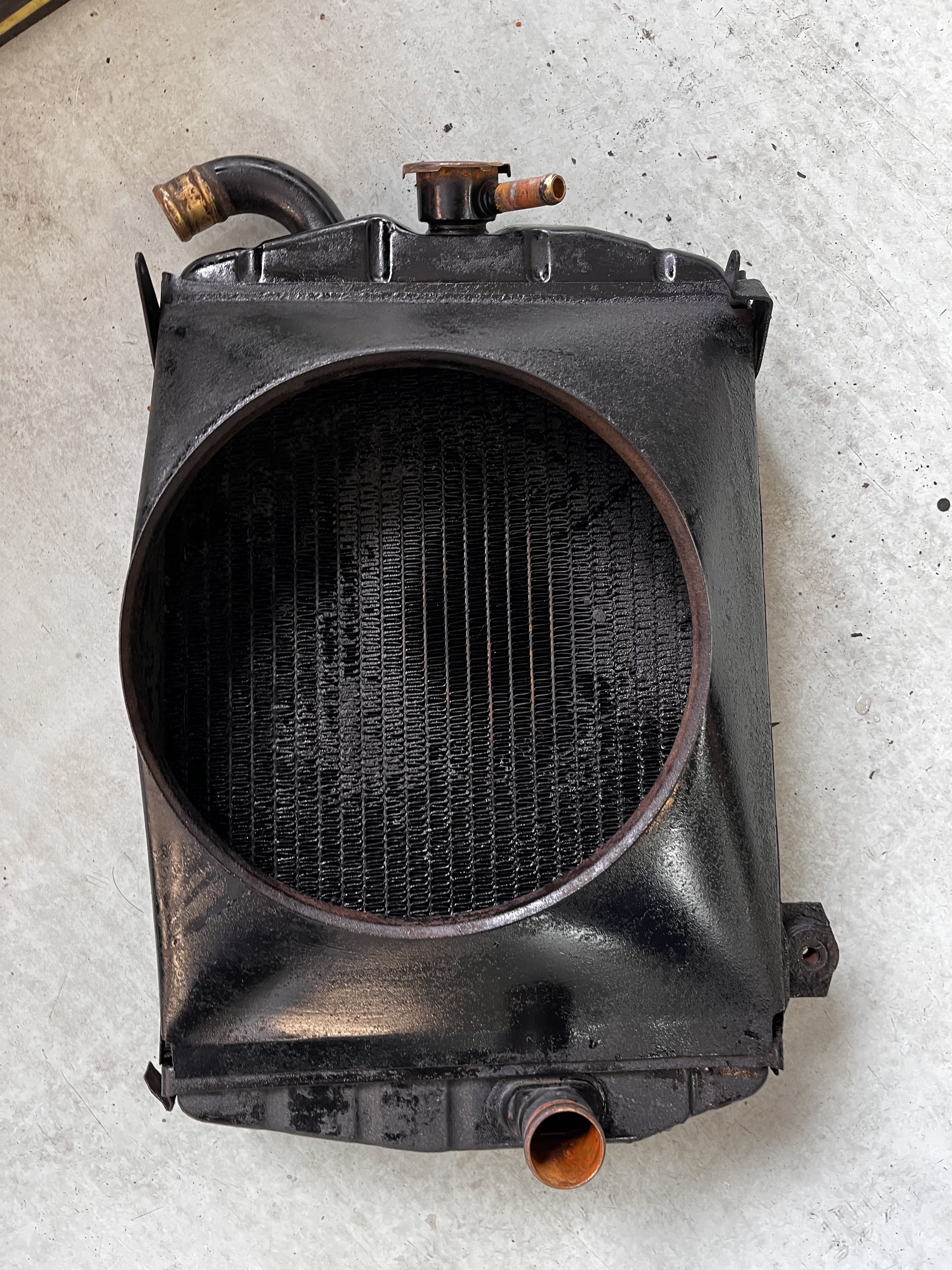

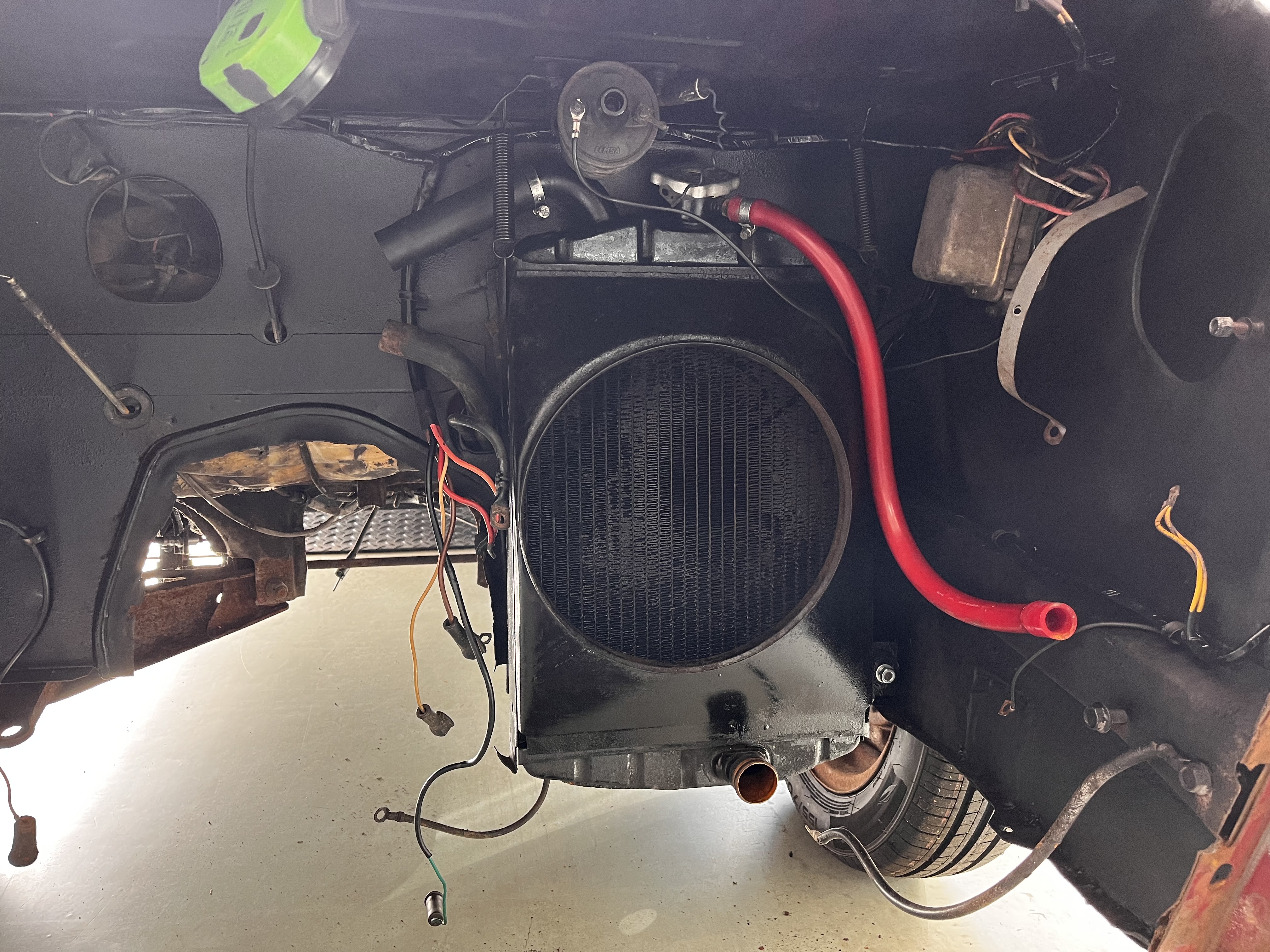

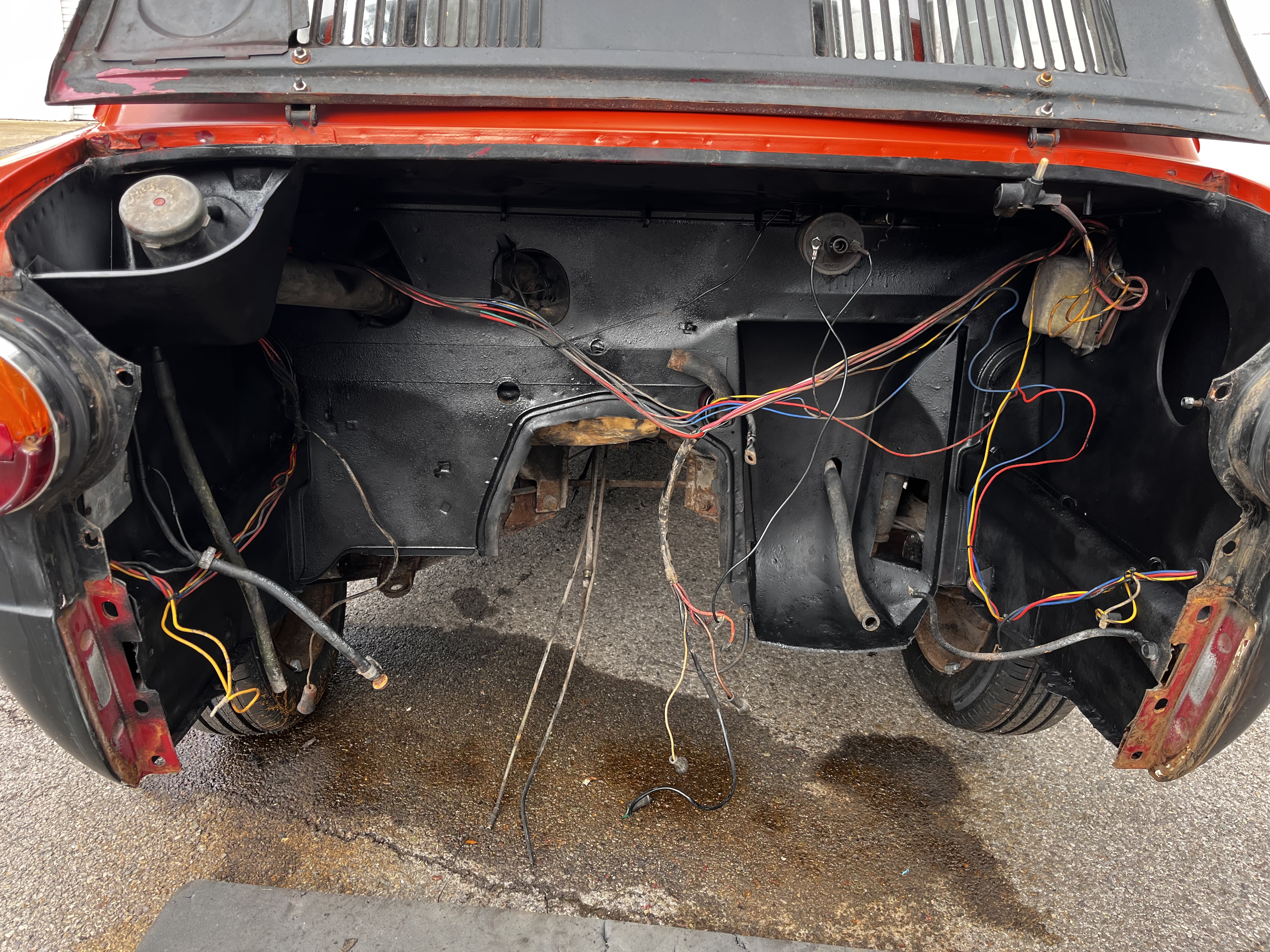

Engine bay refresh in a special rubberised black, wrapped the wiring to tidy it all up.
Flushed, cleaned and painted the radiator which has no leaks.
Fitted the radiator.

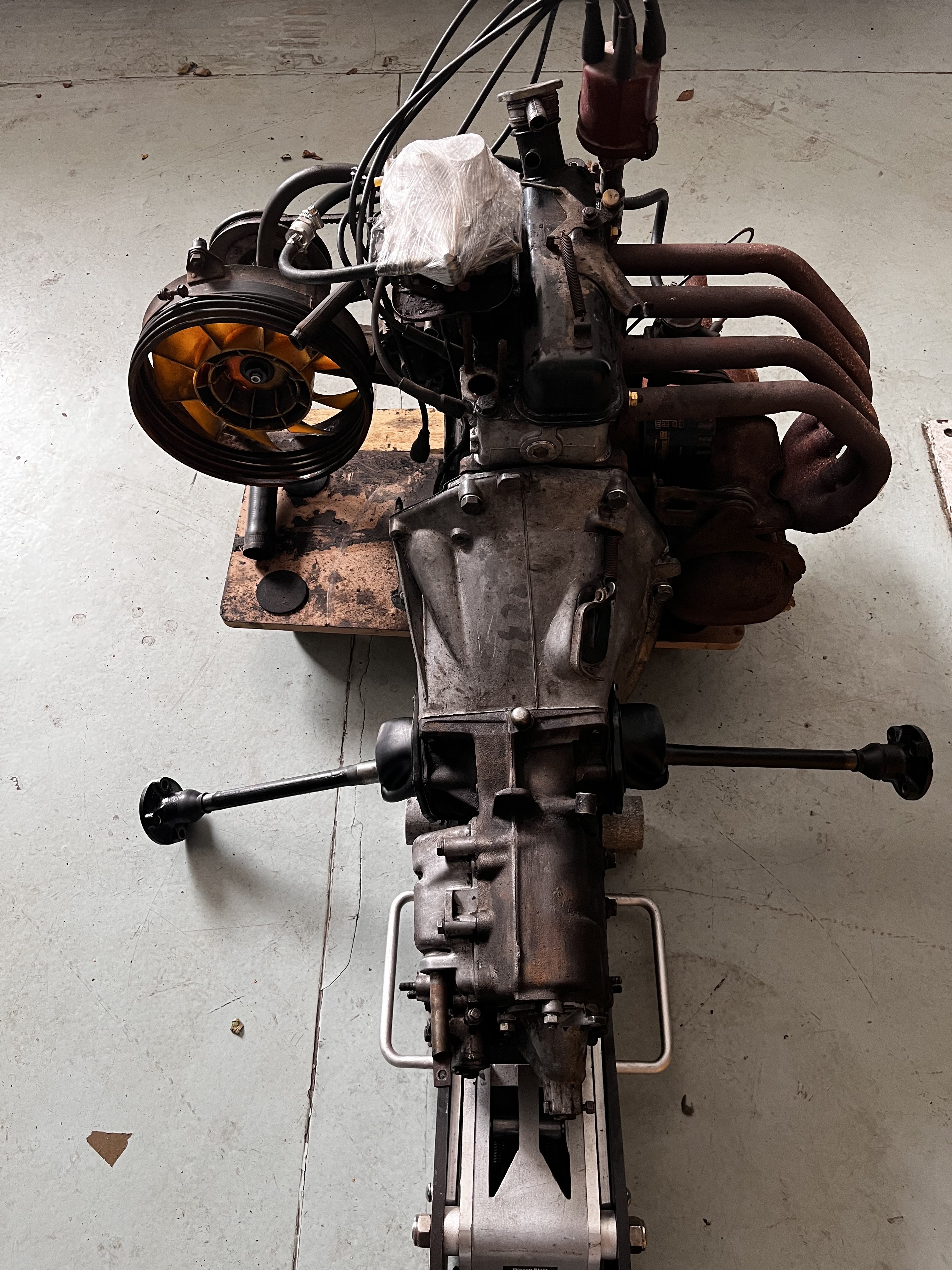

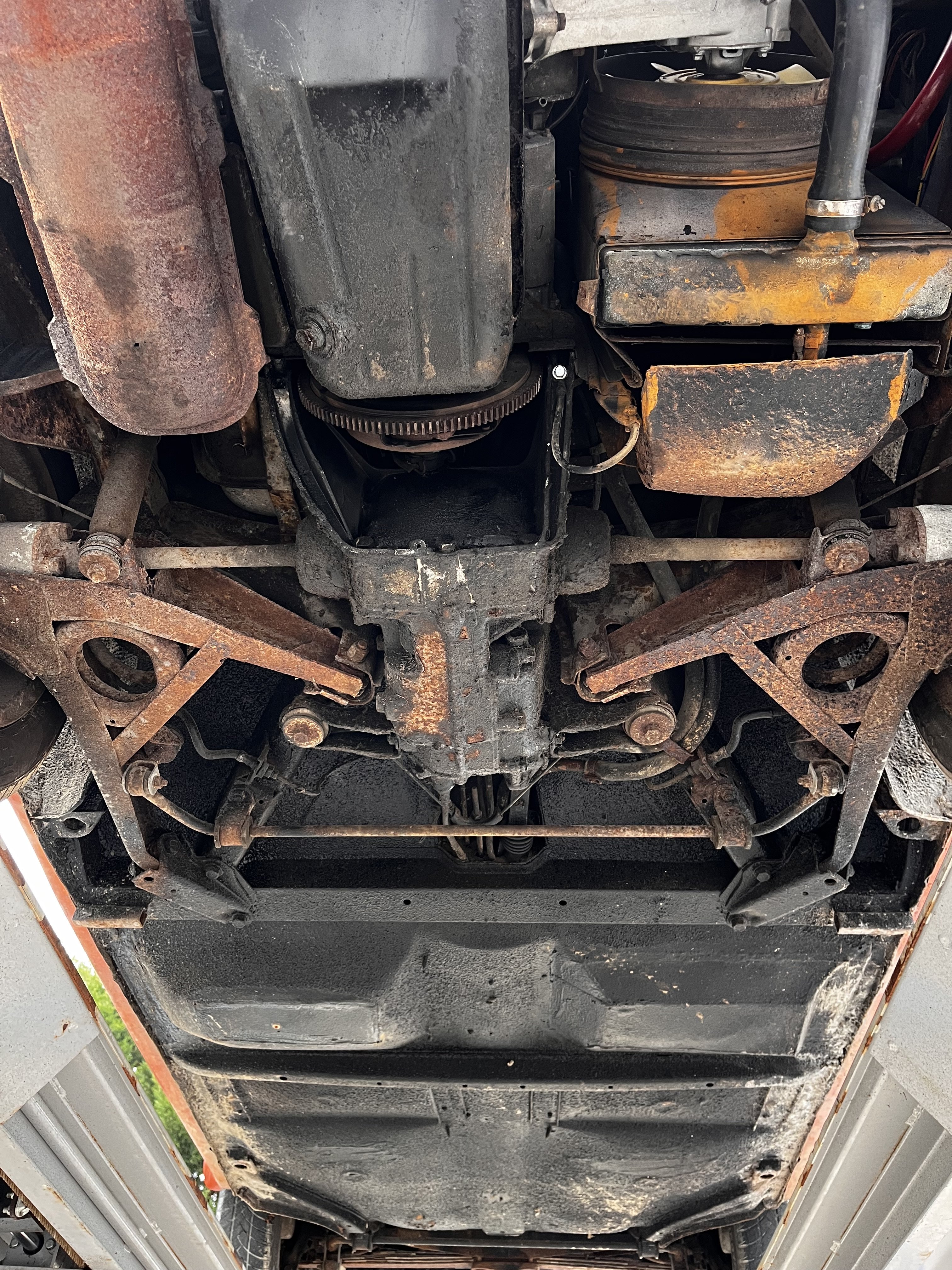

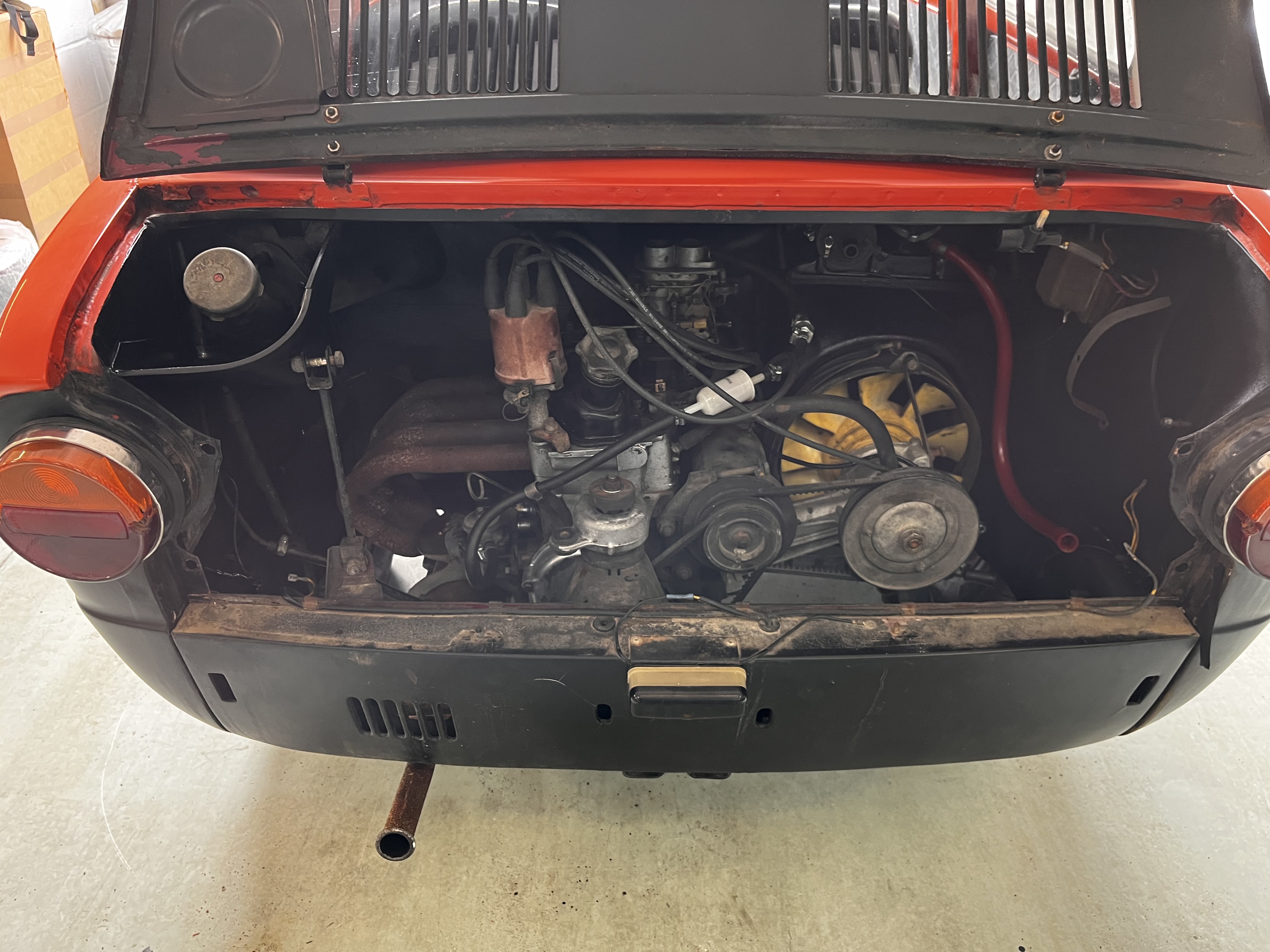

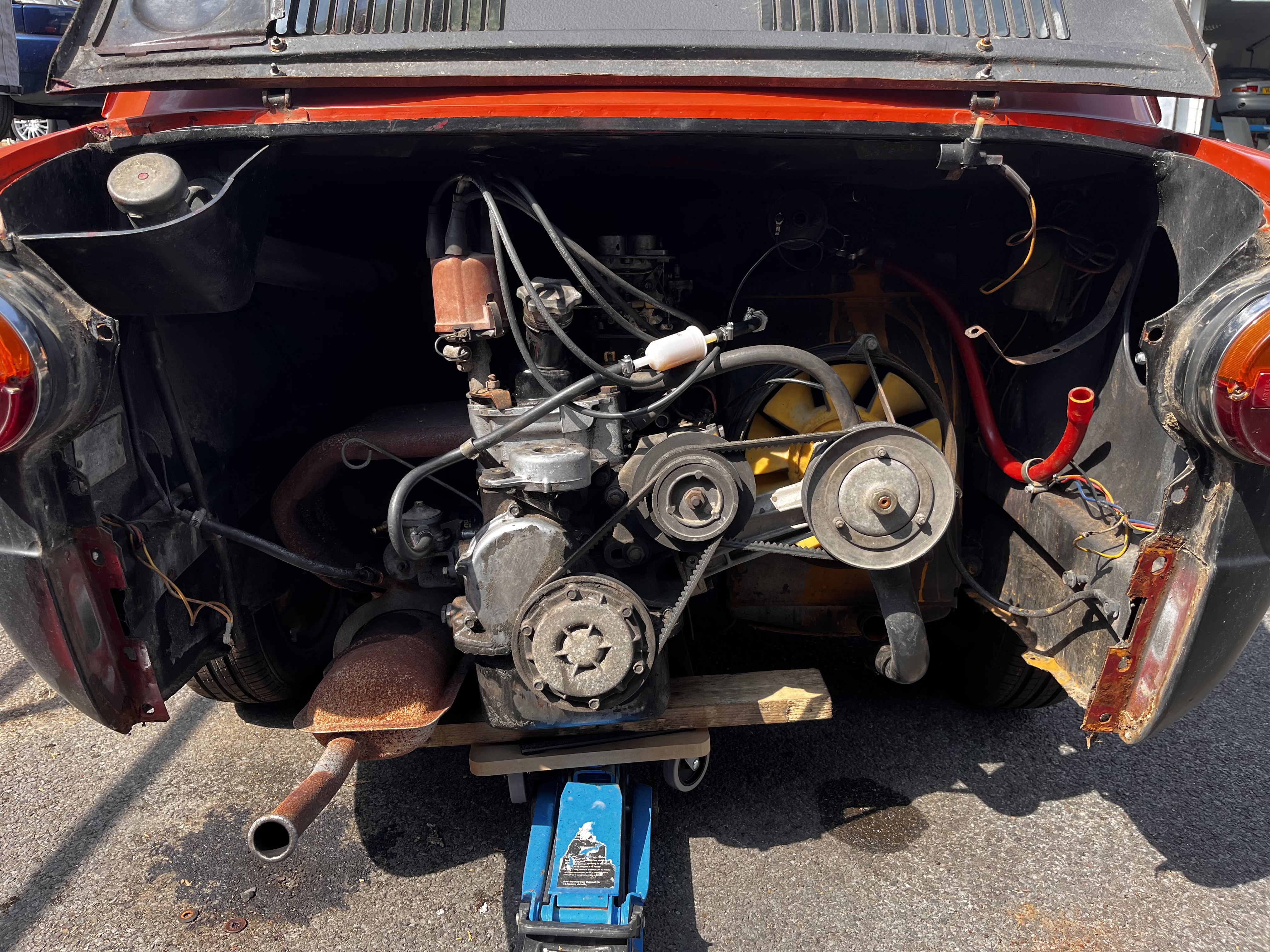

And finally installed the engine and gearbox .
Pretty straight forward. I had them on a trolley which I wheeled into place and jacked up from underneath.
Fitted the rear valance with rear center mount first , then moved the jack to the rear of the gearbox end and bolted in the other two mounts .
Connected cables , wiring and plumbing , did a quick start test and put some coolant in.

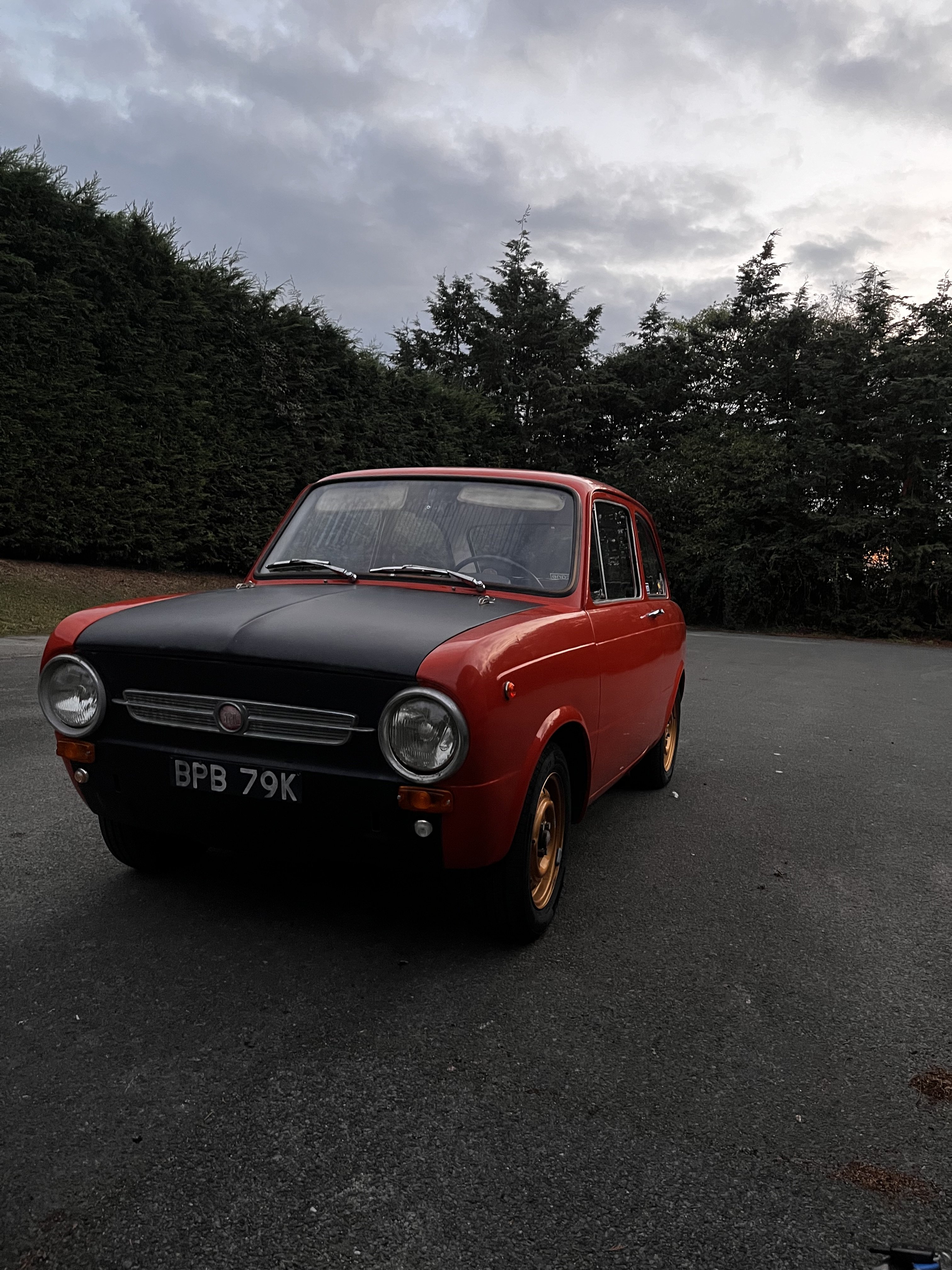

All that effort should be now repaid with a fun little car to drive. I always liked then when several came in as an apprentice in early 70s.:)
So the seat drove ok , no issues. Everything works as it should . Gears are great . Clutch was ok , gave it a slight adjustment (one turn) and locked it off again.
I think I’ll have a Quick Look at the timing and double check ignition , points and such to see if everything is as it should be.

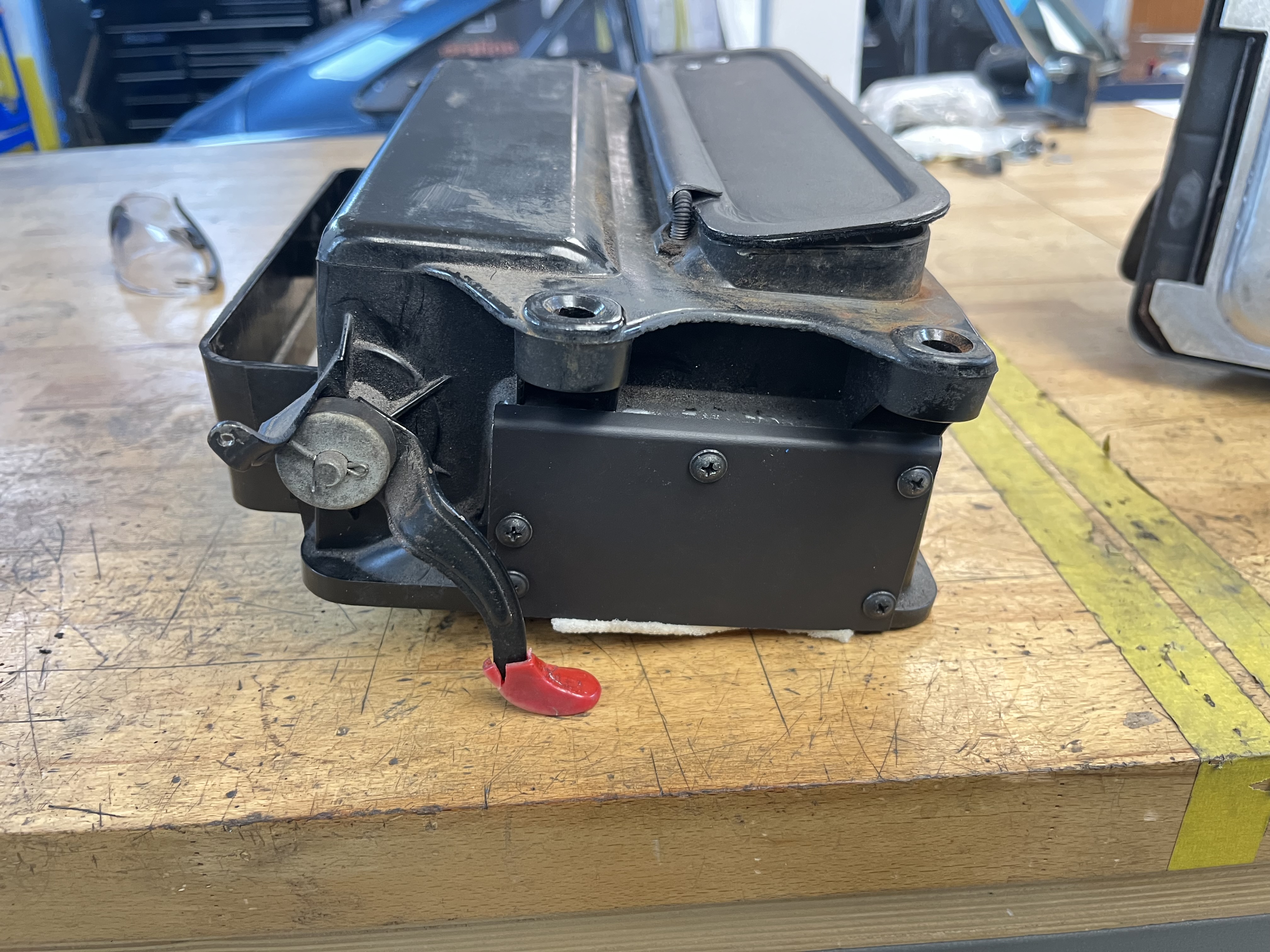

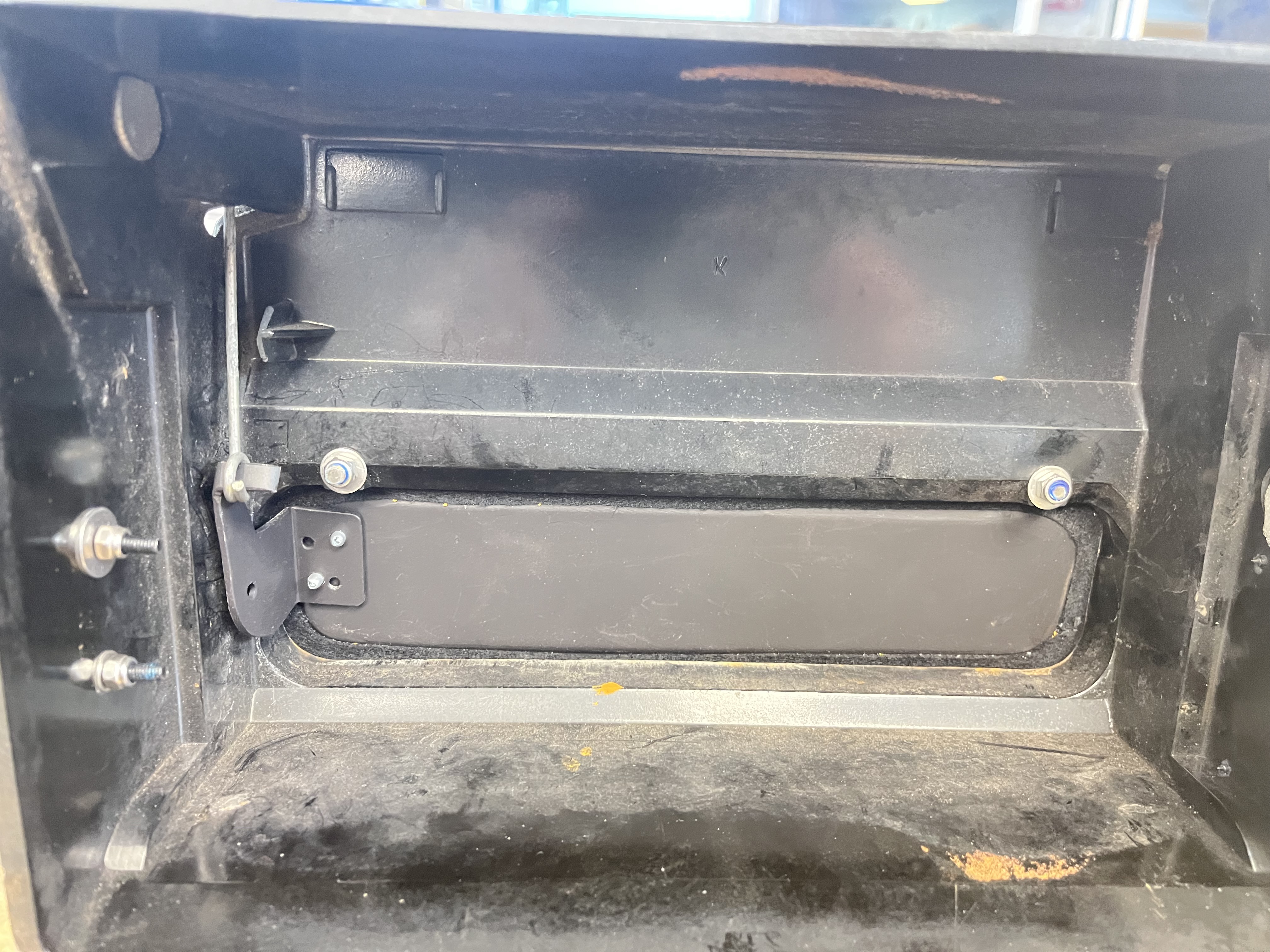

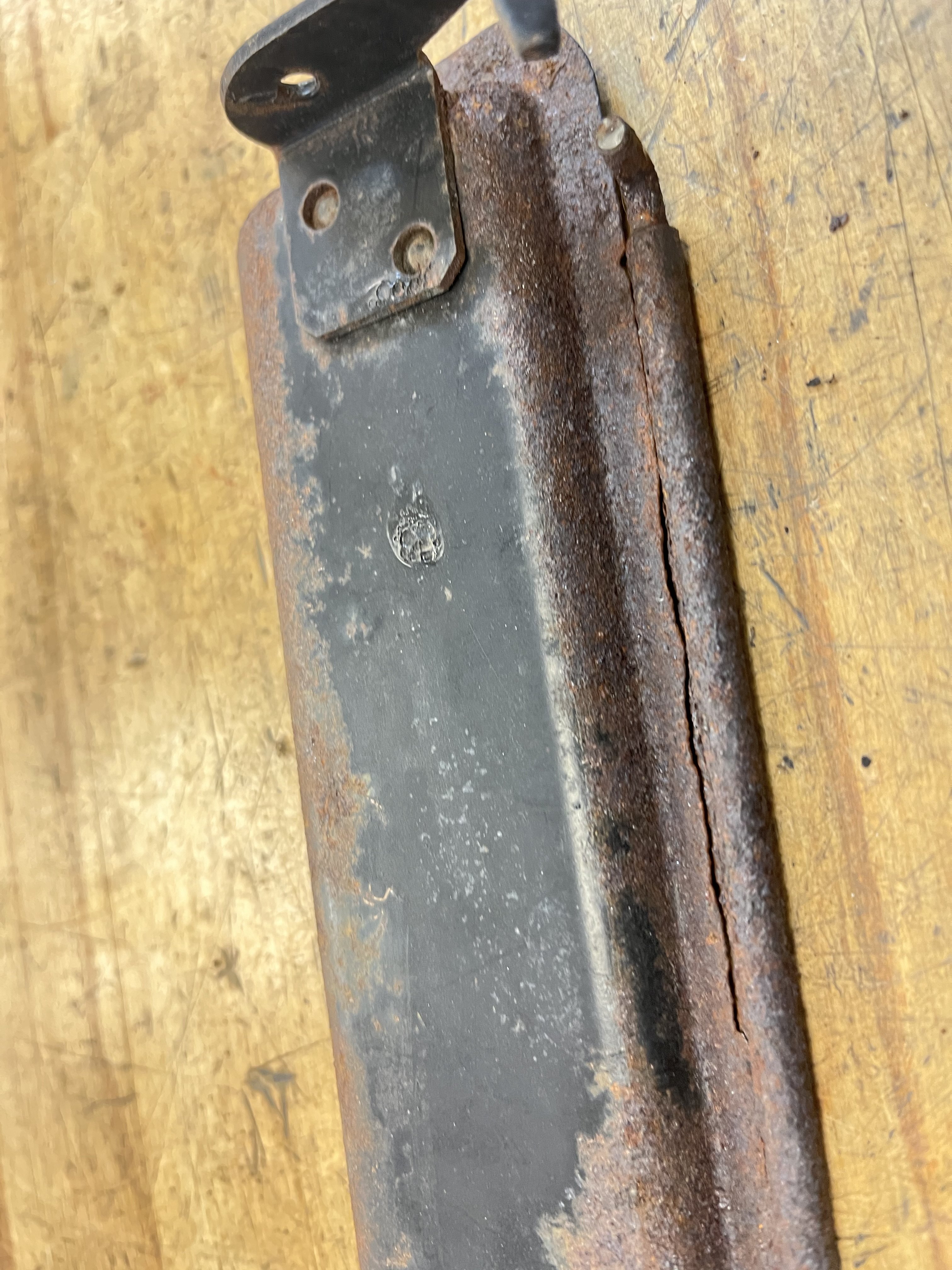

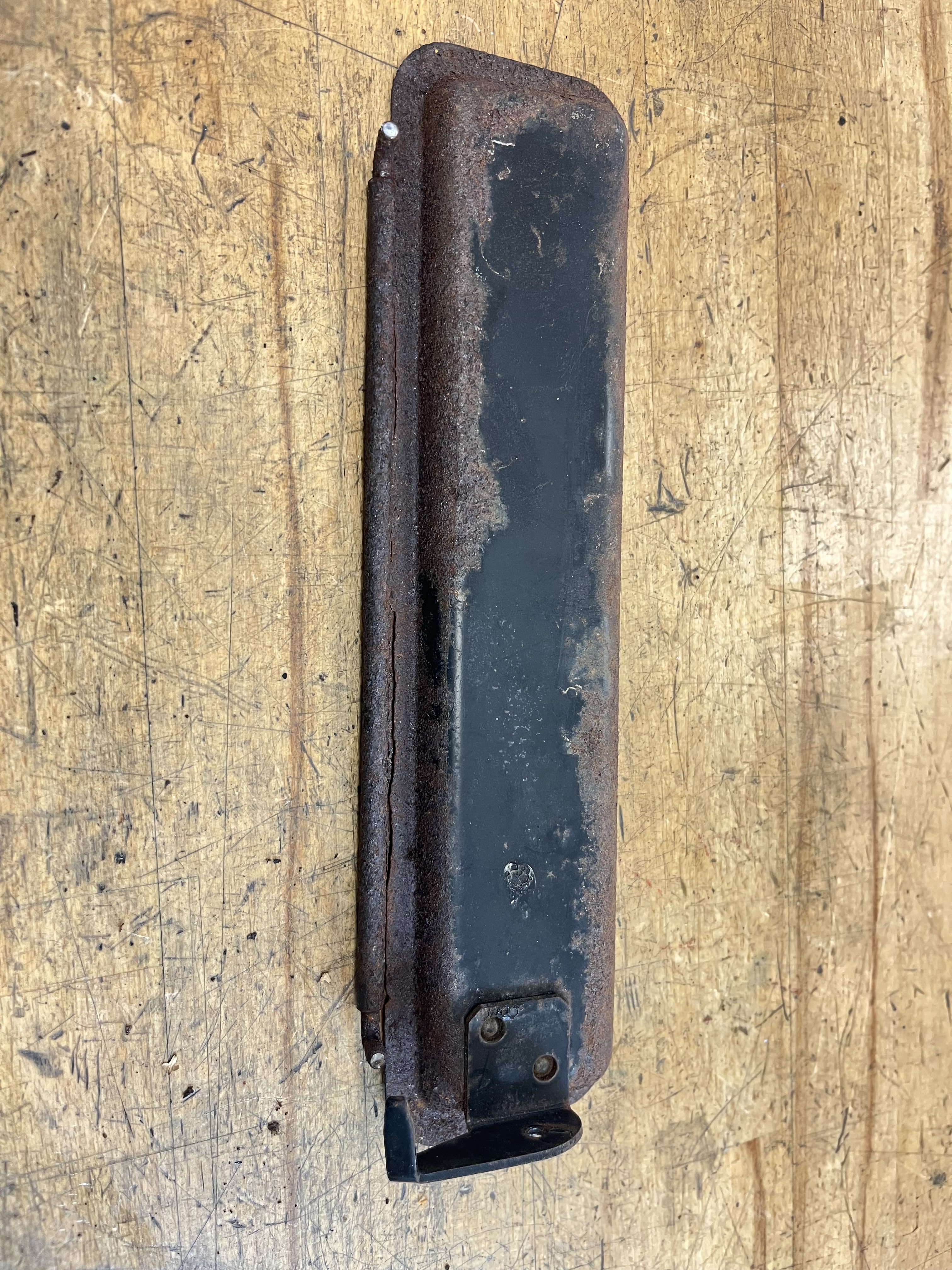

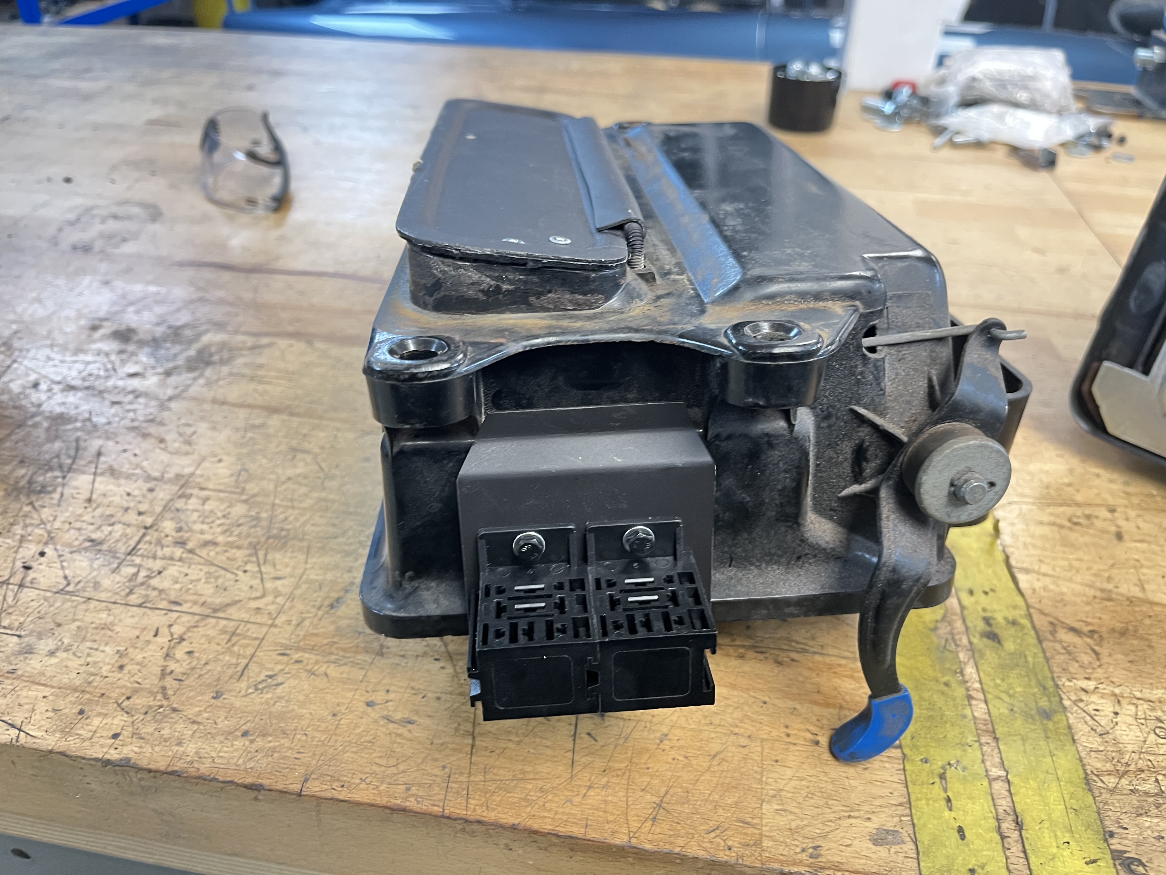

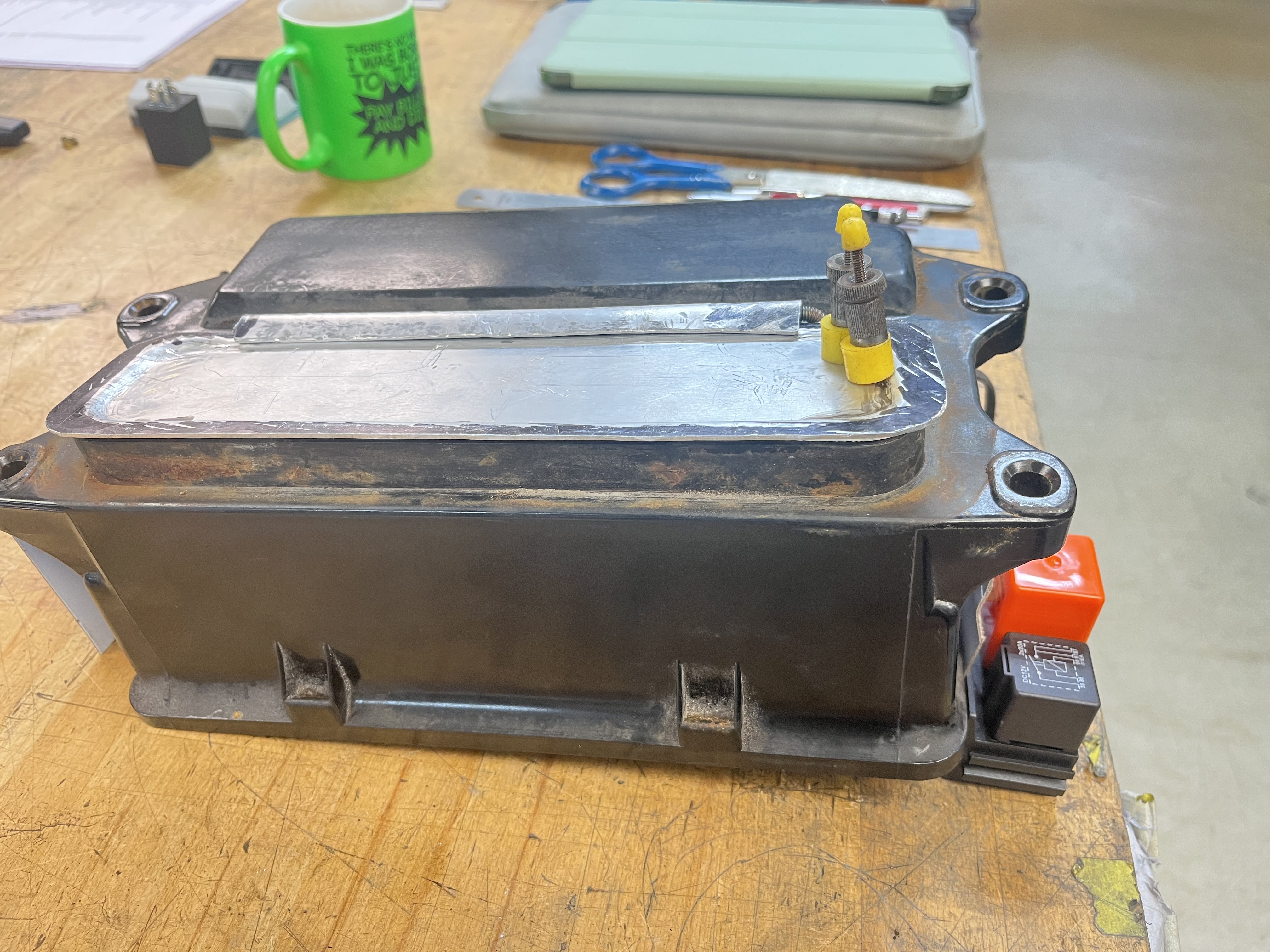

Time to tackle me heater issue ( lack of ) . With no heater pipes from the radiator to the heater as they were leaking at the middle. I have retrofitted an electric element. 200w to start with , this could be upgraded. I had to make a new flap too. So this is all done and fitted twin filters. I used a heated window 10 minute timer switch as well just for safety etc and it works really well. I may add another larger element but for now this will be more than adequate.

Never used an electric car heater, does dynamo cope?
If stationary, is that a bit like leaving a valve radio on whilst doing a bit of "courting" from a long distant memory, killing the battery.;)
and then finding the coil is burnt out because you had to have the ignition on to feed power to the radio and the points were closed!
One thing to note on those electric heaters, make sure the plastic can take it…I fitted one to our Polaris diesel UTV (due to the factory fit system never bleeding the cooling system properly, as the pipes were like spaghetti junction going up down and all over the place)…I bought a decent 400w heater but the existing heater box, made by Polaris chocolate branch, went very soft very quickly
