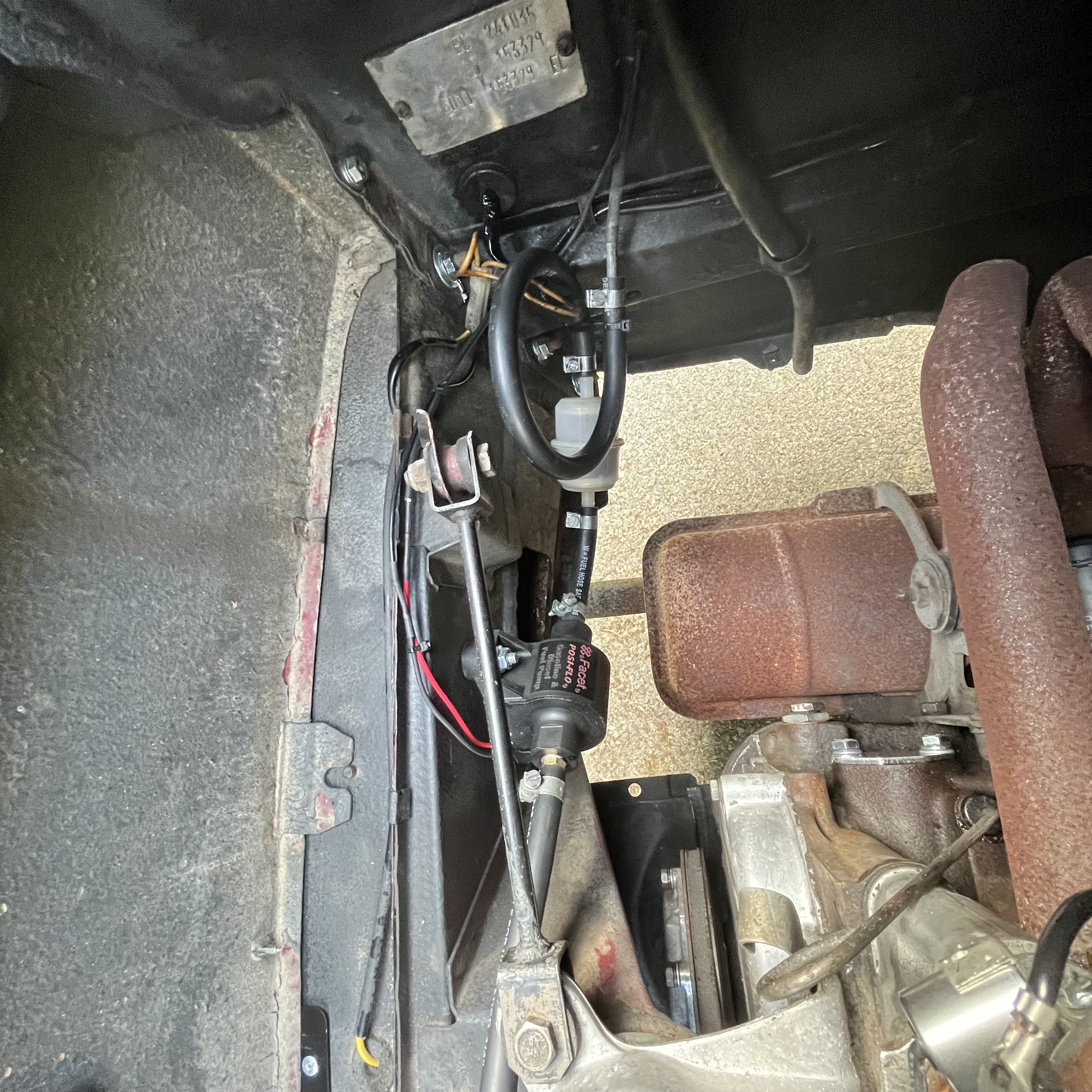

Never used an electric car heater, does dynamo cope?
Seems to cope there is only a very small current drop from this setup , I started small initially as just a way to demist the screen so early days yet for full testing but will update as I can.

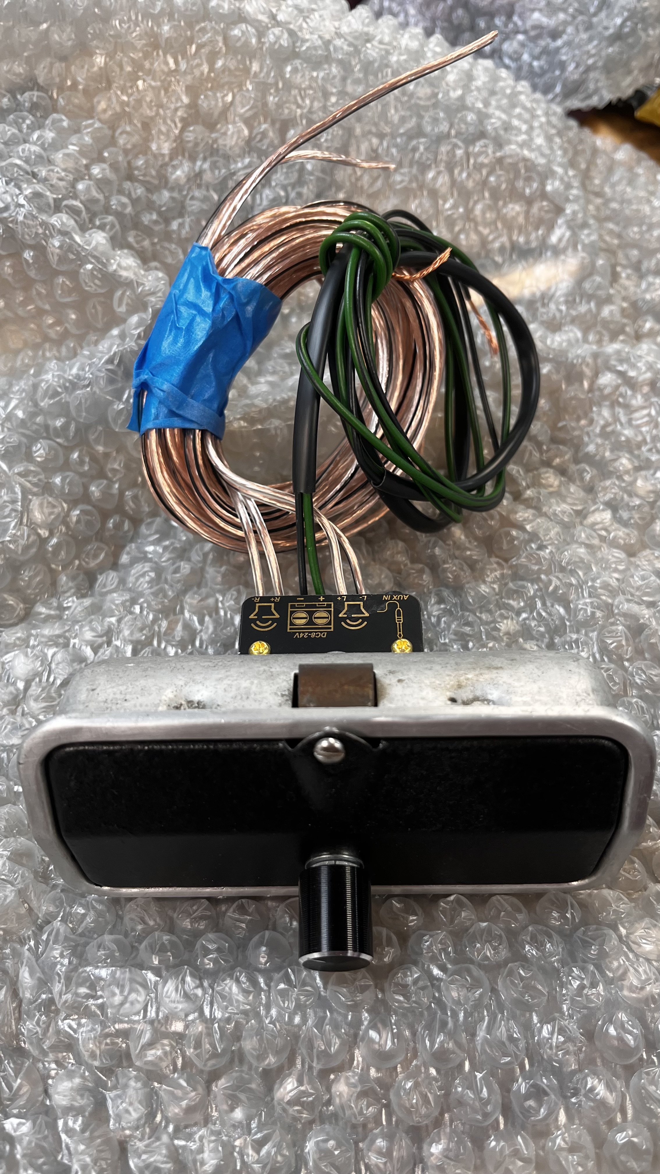

Ifs been a little while since my last post and i’ve done a bit of. Firstly i have fitted a radio.
I didn’t want a full fin radio on show and there is nowhere to hide one so i modified one of my spare ashtrays. And then fitted speakers to the rear seat side cards and perforated the leather covers.
