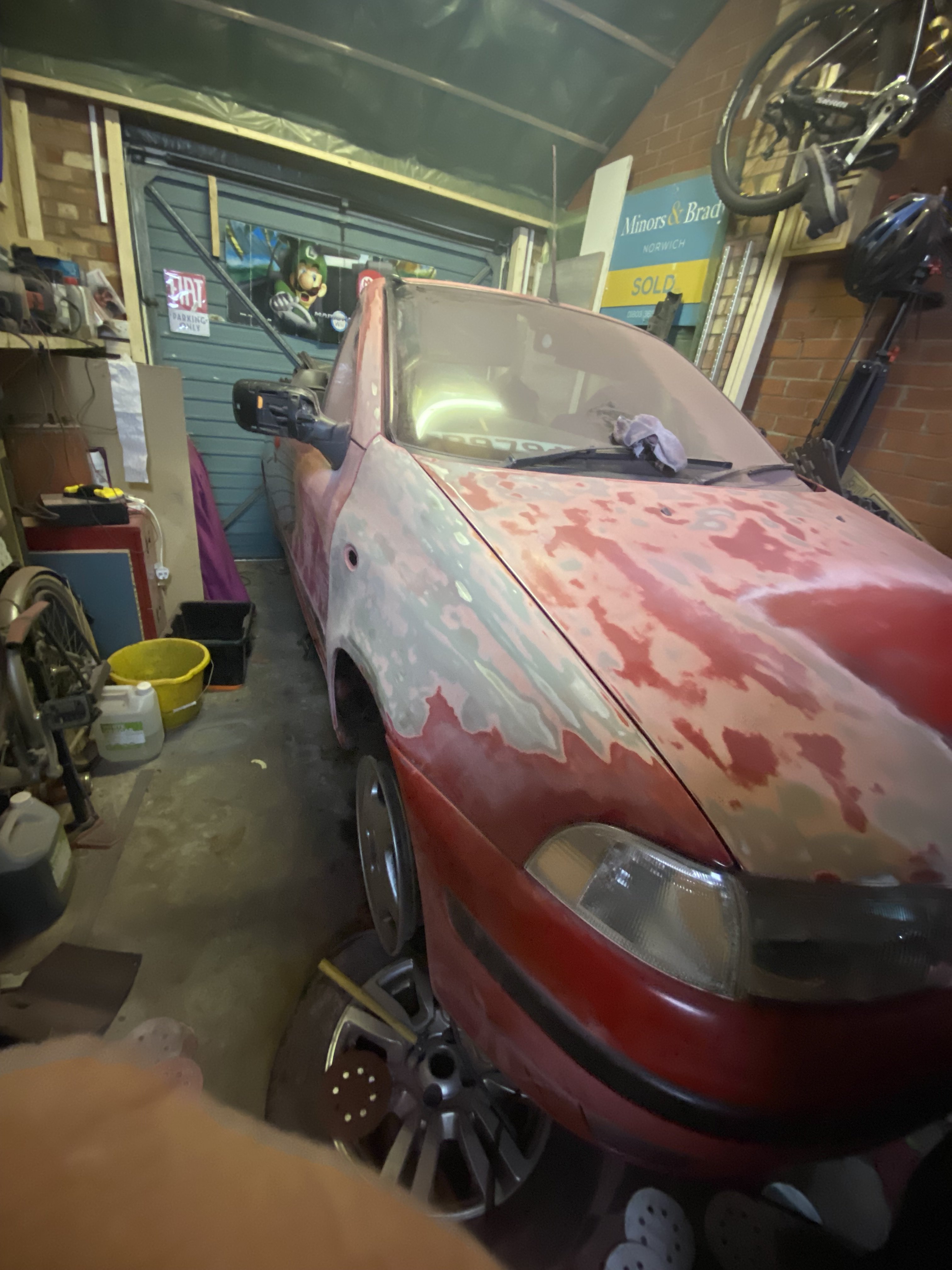

Just a couple more pictures of where I am.
The whole front axle is now ready to go back on the car, though its 70Kg so it will be coming apart and reinstalled in pieces I am not trying to lift this up and connect it to the bottom of the car on my own.

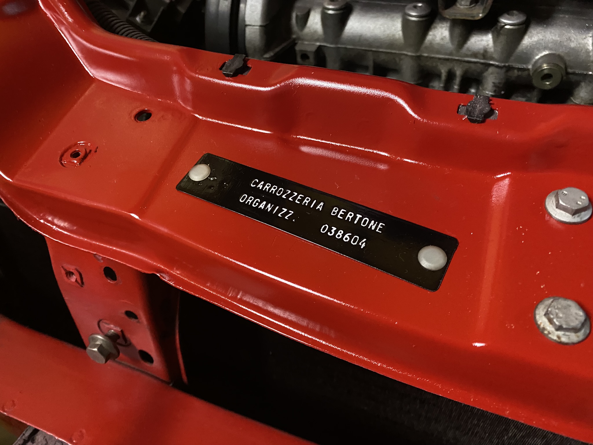

Before I put this back together, I have been spraying around some rust preventer to make everything last another 25 years.
in doing so I have repainted the slam panel and reconditioned this little number plaque that was installed by Bertone when the car was built.

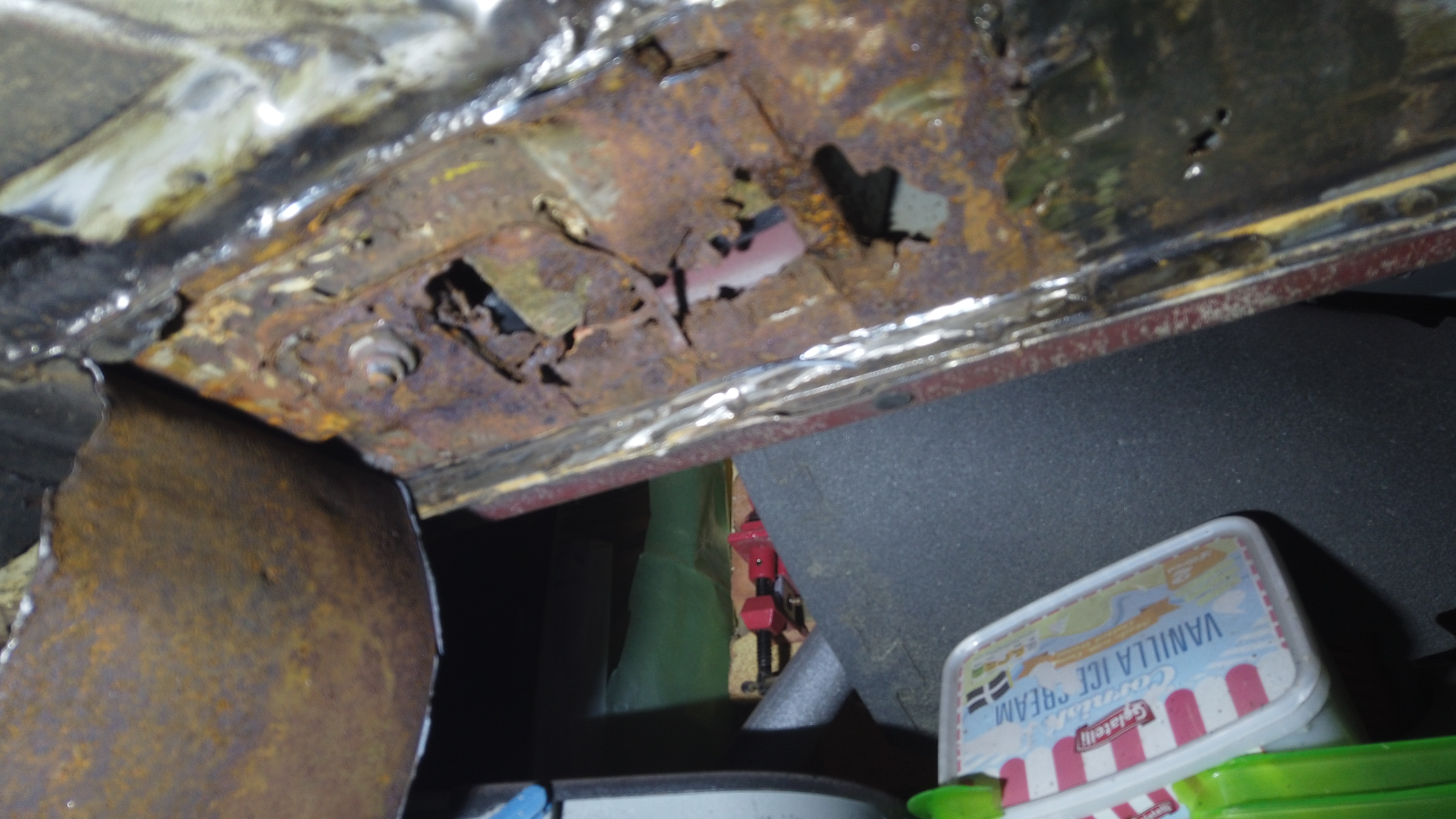

So progress has been slow, I have been tied up with a combination of DIY projects, child care and work, however when ever I can I have been crawling under the car and stripping off the old under seal to see how good the floor is. Most of it is surprisingly sold, however I could not ignore the welded patches which were pretty badly patched, so with grinder in hand I carefully removed the patch of the drivers side
This isn’t too bad, they had basically welded a patch of metal over a hole, this it’s located right near the front of the drivers seat I suspect where water had gotten in the car it had pooled under carpet and rusted the floor from the inside.
This isn’t going to be a bad one to deal with, I will cut out the rot and replace with good metal.

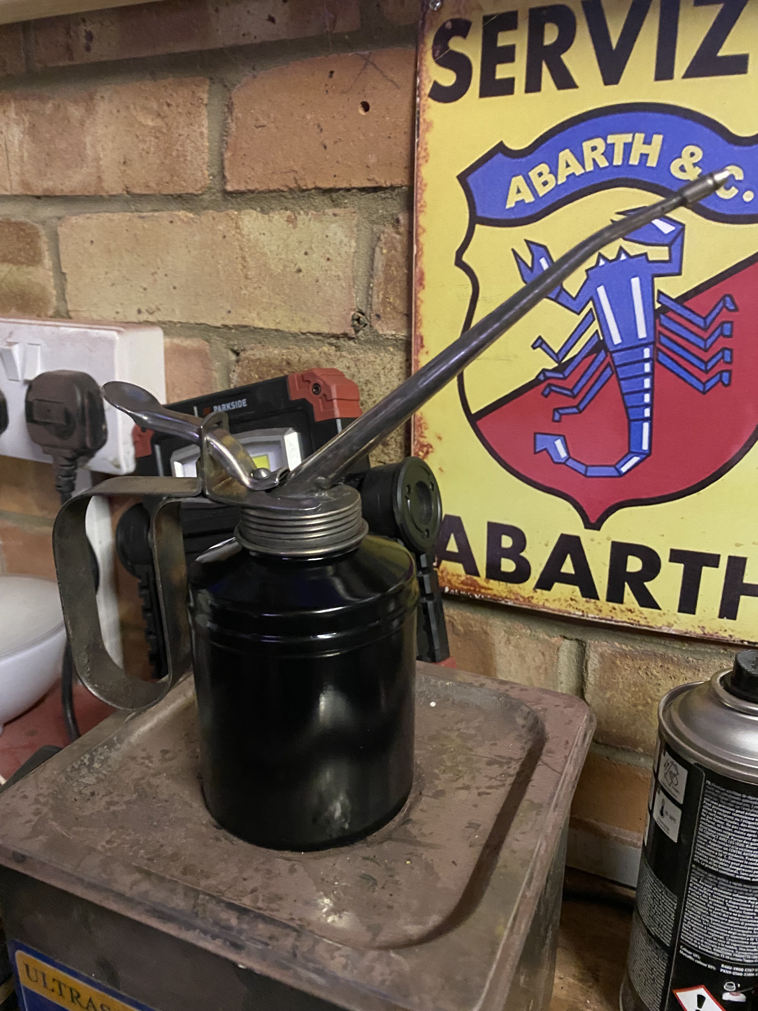

A couple of miles down the road from me, once a month is a very large auto jumble, I went a long a couple of weeks back because I really wanted an old oil can like the ones I remember my grandfather having in the 90s,
He died in 95 and so we threw loads of them out when clearing out his garage.
Anyway I found this lovely little can, cost me just £3
There was no paint on the can, there were some fragments that suggested it was previously red, the top part was also in pretty bad shape to I gave the whole thing a really good clean up painted the can black and nickel plated the whole top part, then didn’t clean it up or polish it to give it an old patina.
I love it, such a lovely little thing and will come in handy doing jobs around the house. It’s currently filled with some left over oil from my Punto Evo.

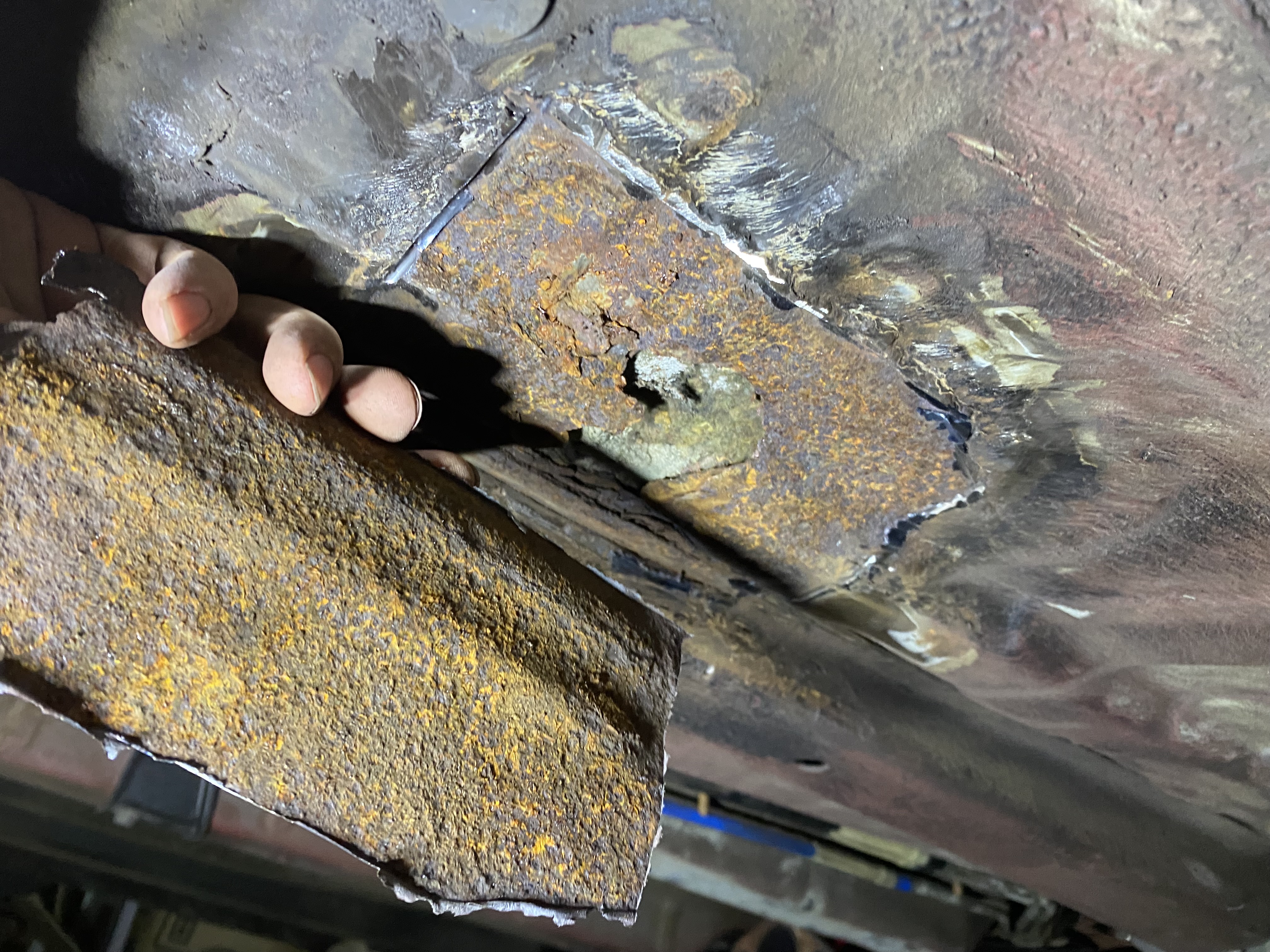

So the worst rust, well on the passenger side there was a very large patch of steel just welded over the underside of the floor, I needed to cut the steel off to take a better look, and well, it doesn’t look good.
What you can see is the panel I cut off hanging down to the Left of the picture, the sill and the floor pan in the center, this is located at the back of the passenger seat and as you can see it’s a pretty large area of rot.
That all being said I have been under the car again tonight and it’s a lot better than you might think. No part of the sill is rusted, that is solid, there is a cross member through the middle of the rot which is also untouched, so it really is just the floor that needs replacement. I suppose to do it properly I am going to have to take out the whole interior. The previous repair being over the top of the whole large area meant any water in the passenger side of the car now had its own reservoir to fill up under the bottom of the car.
I suspect a pool of water had developed between the plat and the floor and just caused the floor pan to disintegrate.

I like stuff like the oil can, a bargain at £3.

front floor panels appear some places but are out of stock, the rears just don't seem to exist. I am going to have to fabricate.
I have acquired some nice chunks of VW T6 transporter van, so it should be better metal than it was made out of to start with. (cut out to install windows) these panels are as big as pretty much the whole floor pan of one side of the car, so I should have plenty of material. The one thing I am struggling with is the mounting piece for the seat, there is a small separate shaped part that doubles the thickness of the floor at the mounting point. I need to think how I am going to make this part, everything else is a doddle.
