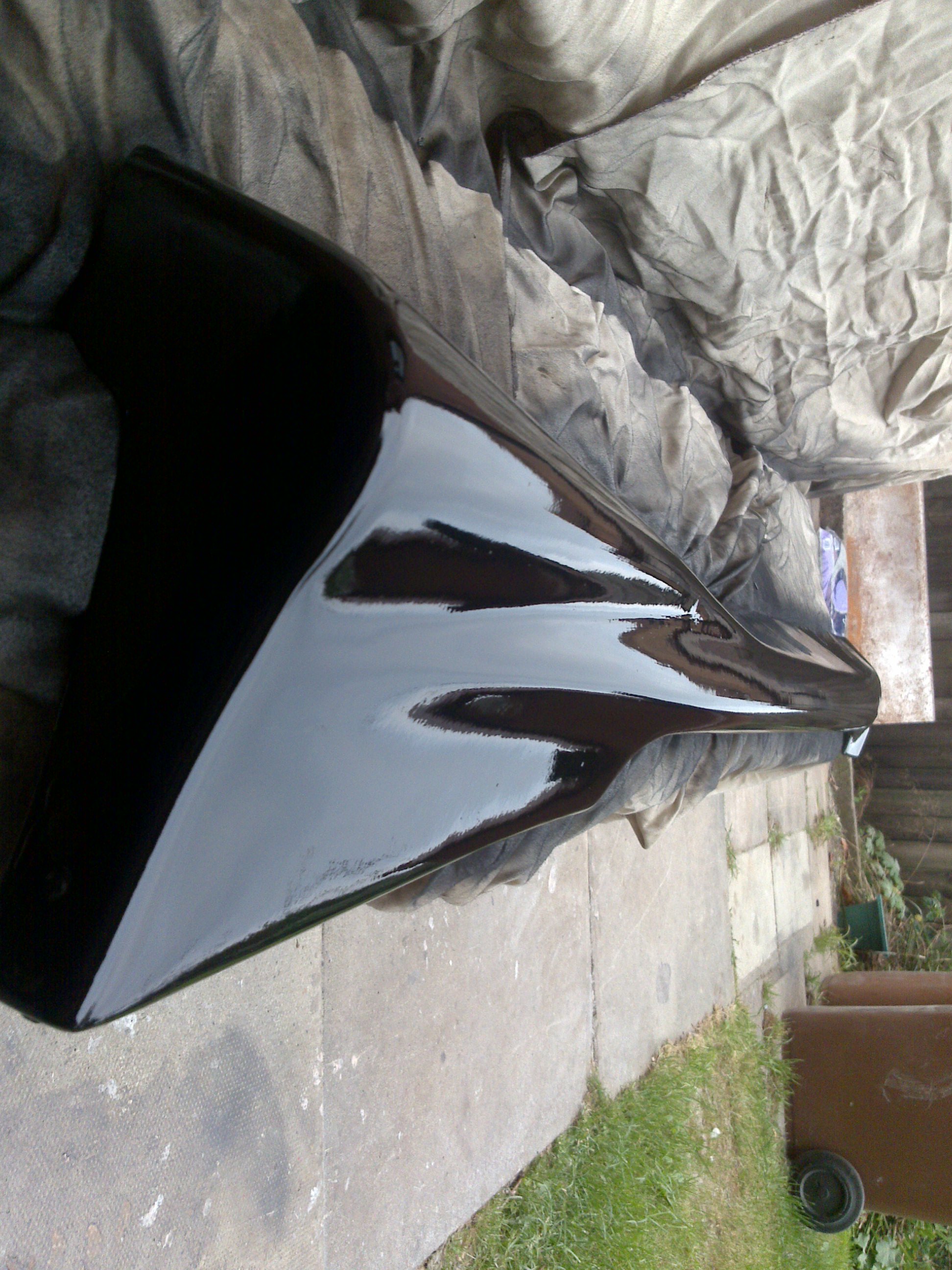

Took the rattle can to my side skirts today...
Will give them a good few days to cure before i fit them....
Happy with the outcome as they were kind of a rush job....

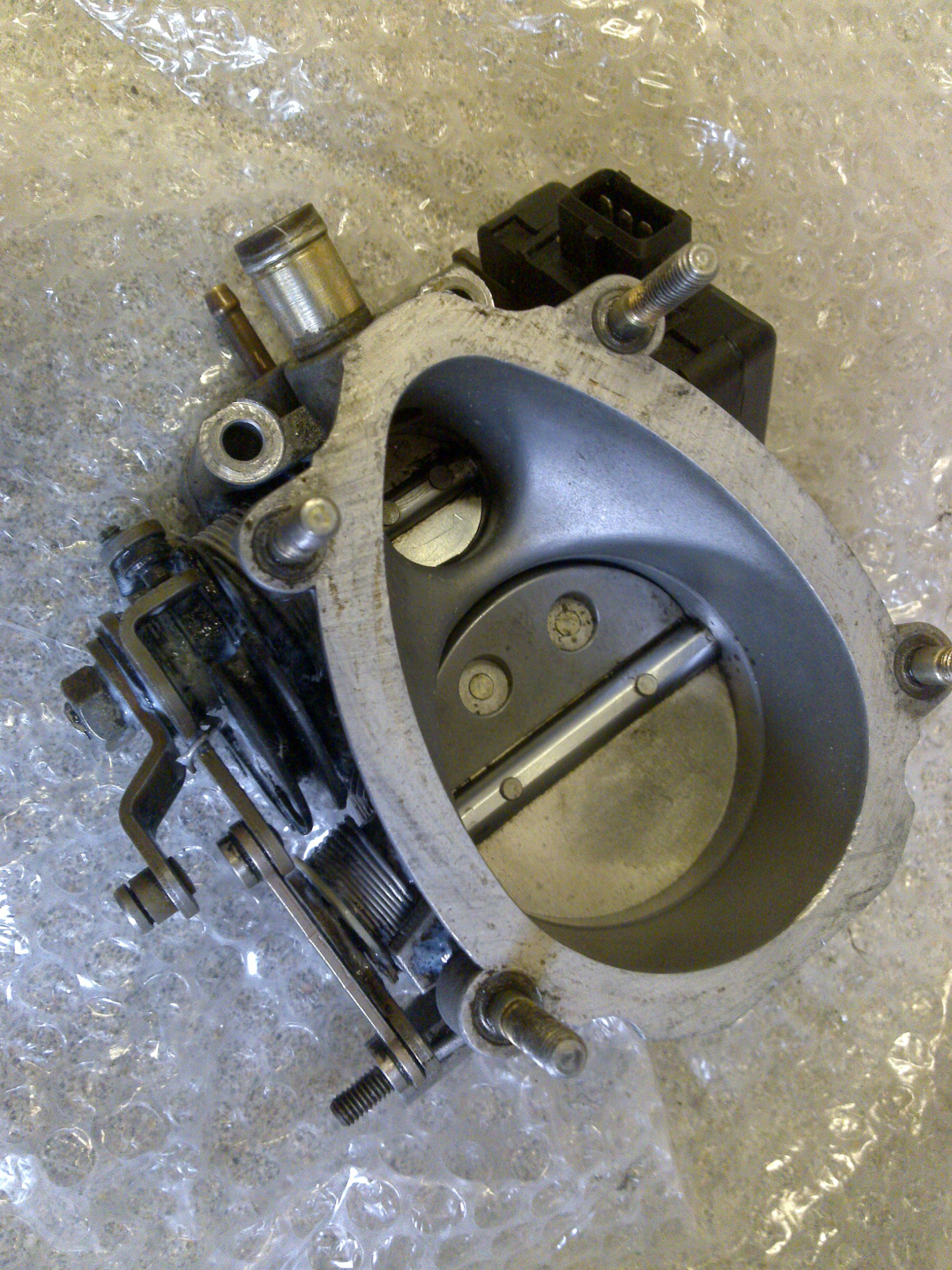

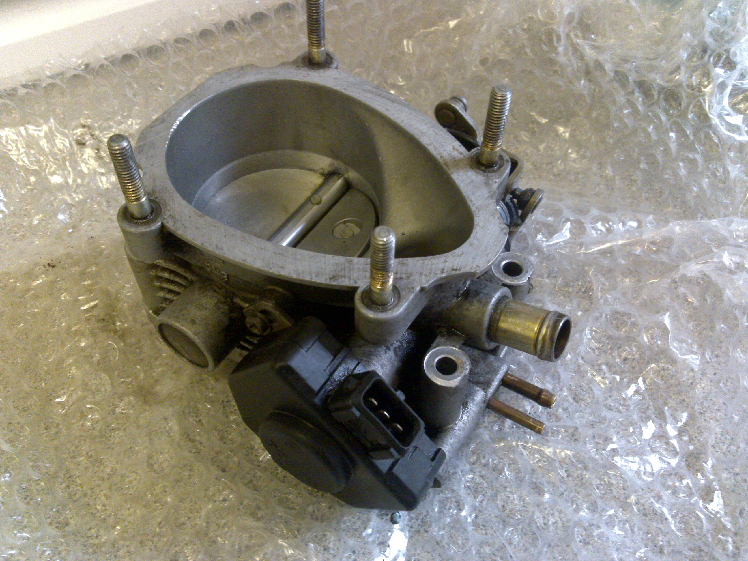

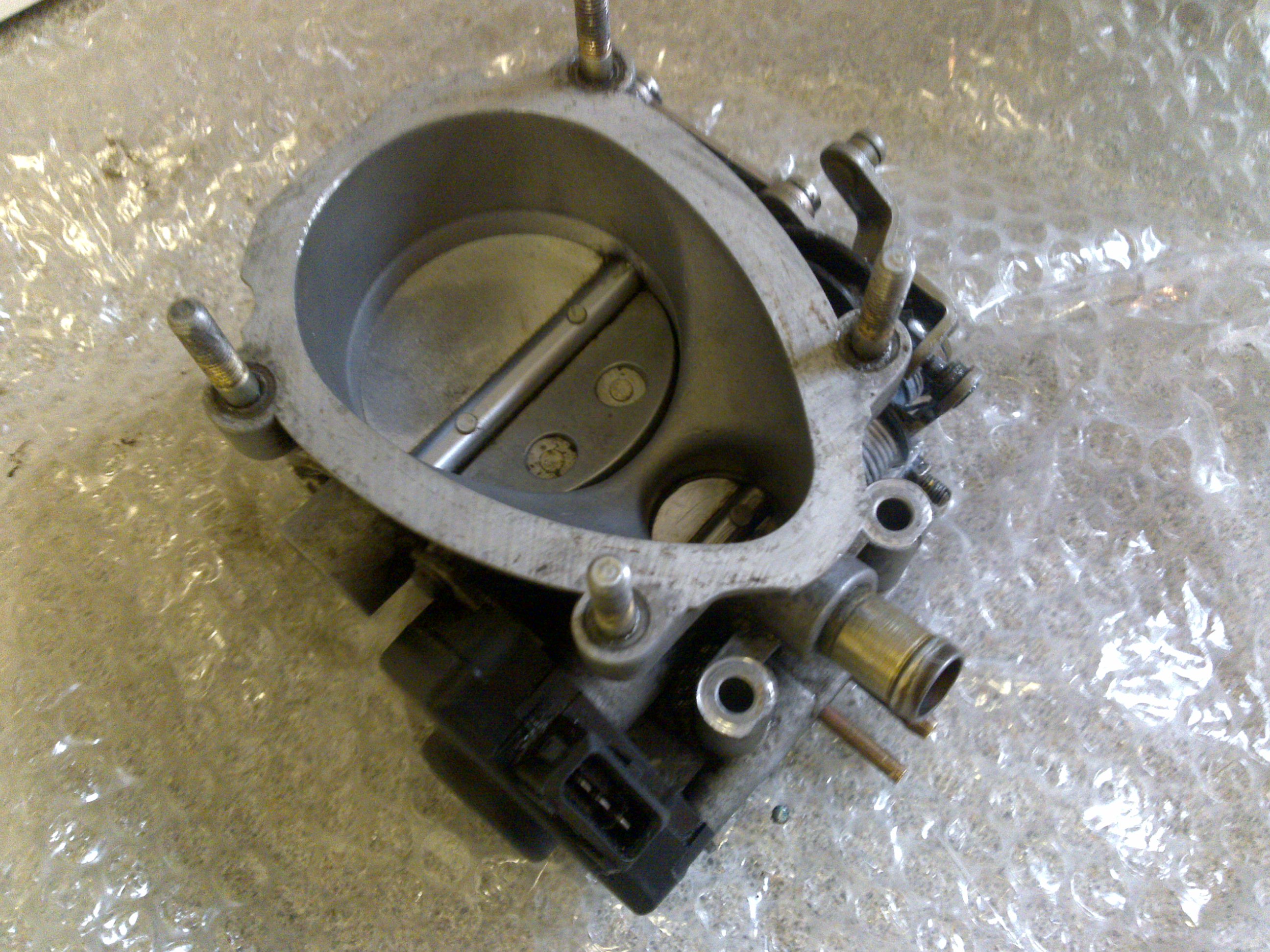

The new early XE throttle plate has turned up today, along with the TPS sensor i should be using with my ECU (should stop the problems i was having and now give me full throttle)...
I wish i could say the same thing about my material as ive been waiting for that to arrive since the weekend...
Anyways ive spent an hour or so cleaning out the double butterfly, springs etc, with it all re-greased it moves nice and freely which is good lol...
Will get round to fitting over the course of the weekend...

How big is the throttle butterfly on that?
Changed the air filter on my (standard) Cinq Sporting a couple of weeks back and the butterfly look somewhere between the size of 1 and £2 coins :p

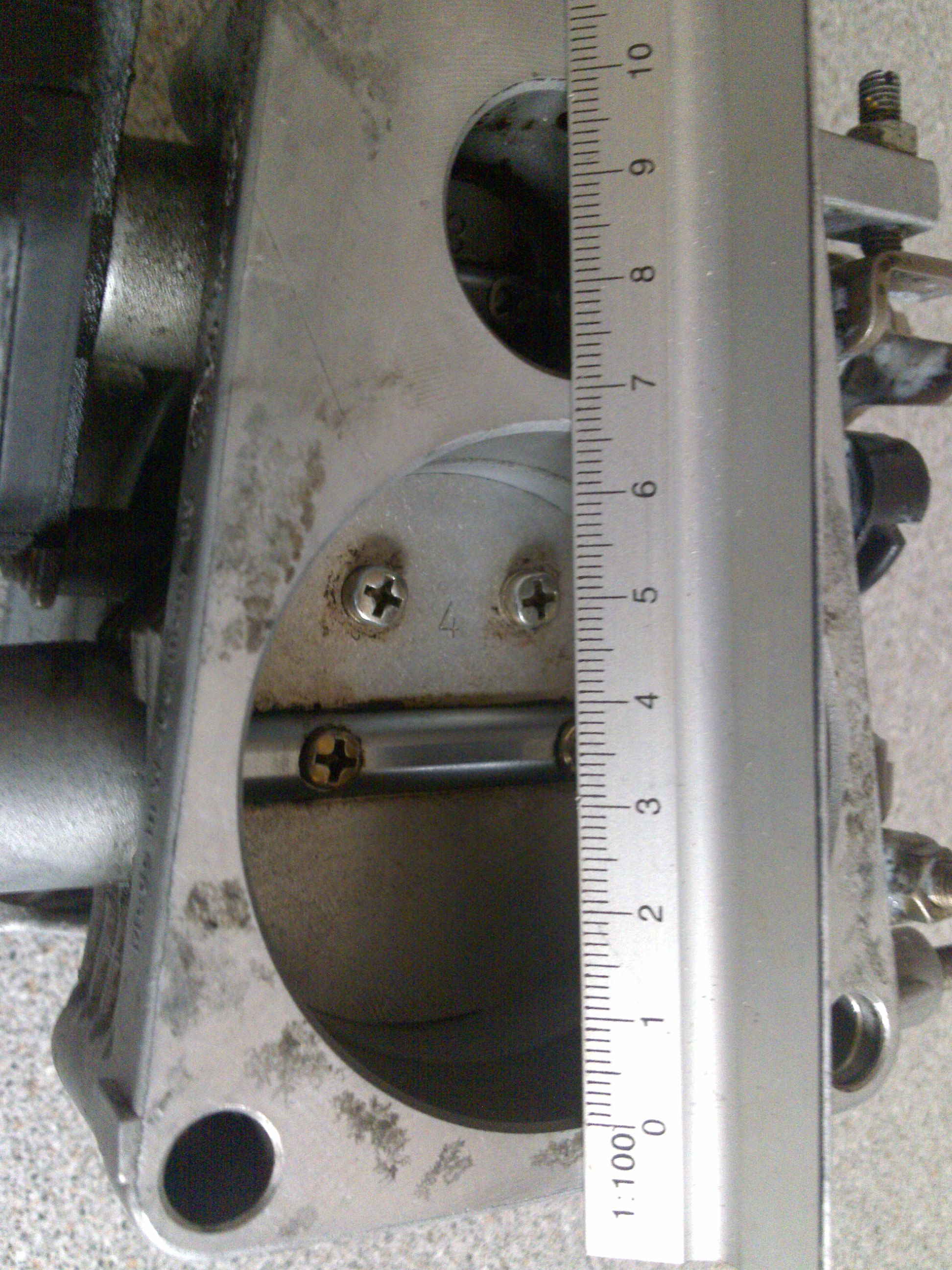

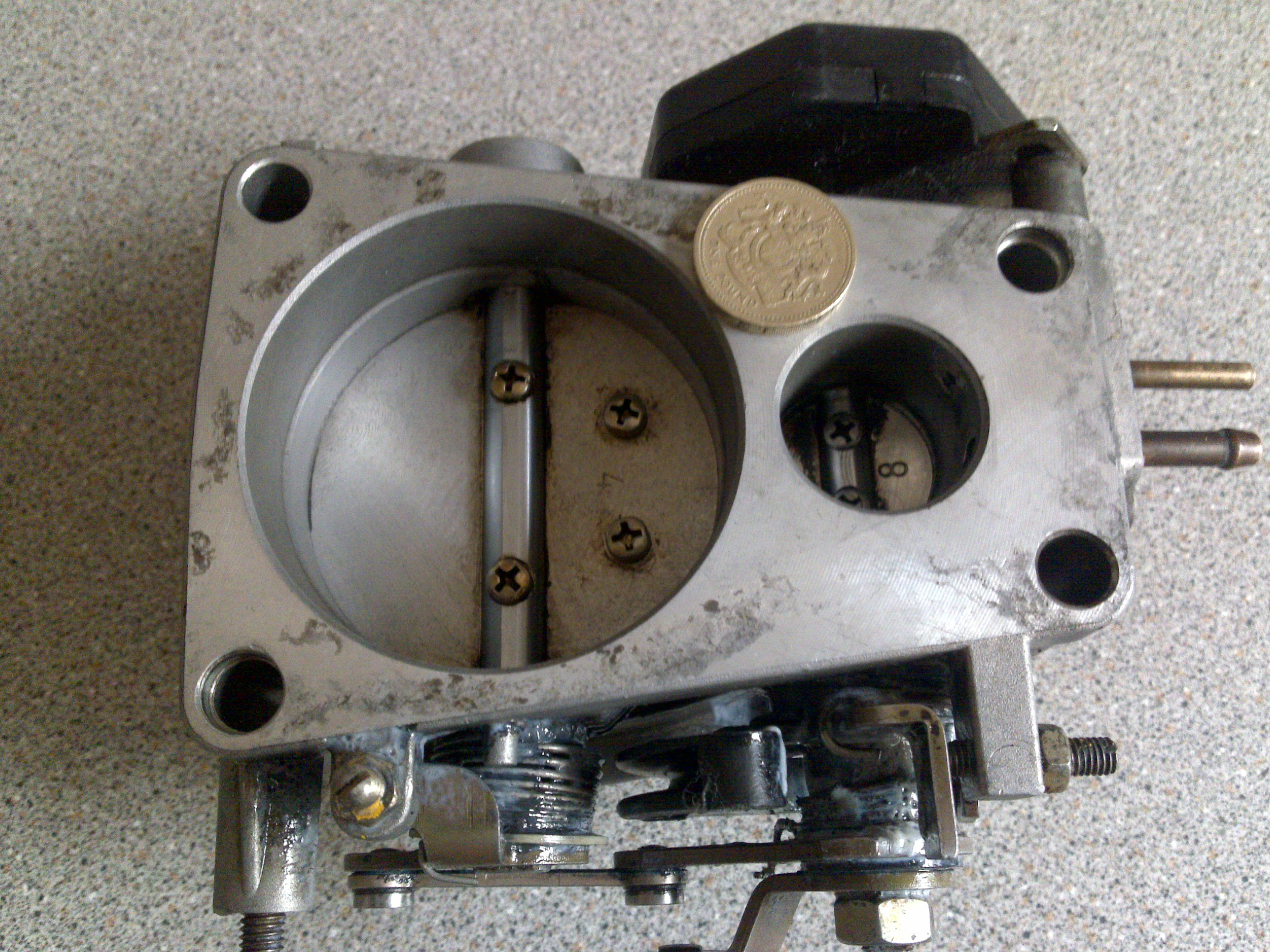

Lol, ive done the £1 coin test, and got the old steel rule out to show the size....
The £1 coin happily sits down the smaller of the two butterflies lol.

Just a bit bigger then :D

65MM!
How come there are two butterlfies though...
To be honest im not 100% sure.. the smaller one opens first to a point, and then the second one starts to open... Full throttle and they are both open.
I thought it was down to the idle, as in ajustment for the idle speed, but this is done via an allen key bolt on the ICV...
I'm not 100% but I think its for economical reasons - at lower speeds the smaller butterfly will only let in just enough air for a small amount of fuel whereas even if the bigger one was only open a tiny crack it'd let in more air requiring more fuel - just a guess tbh but seems like a reasonable explanation.
