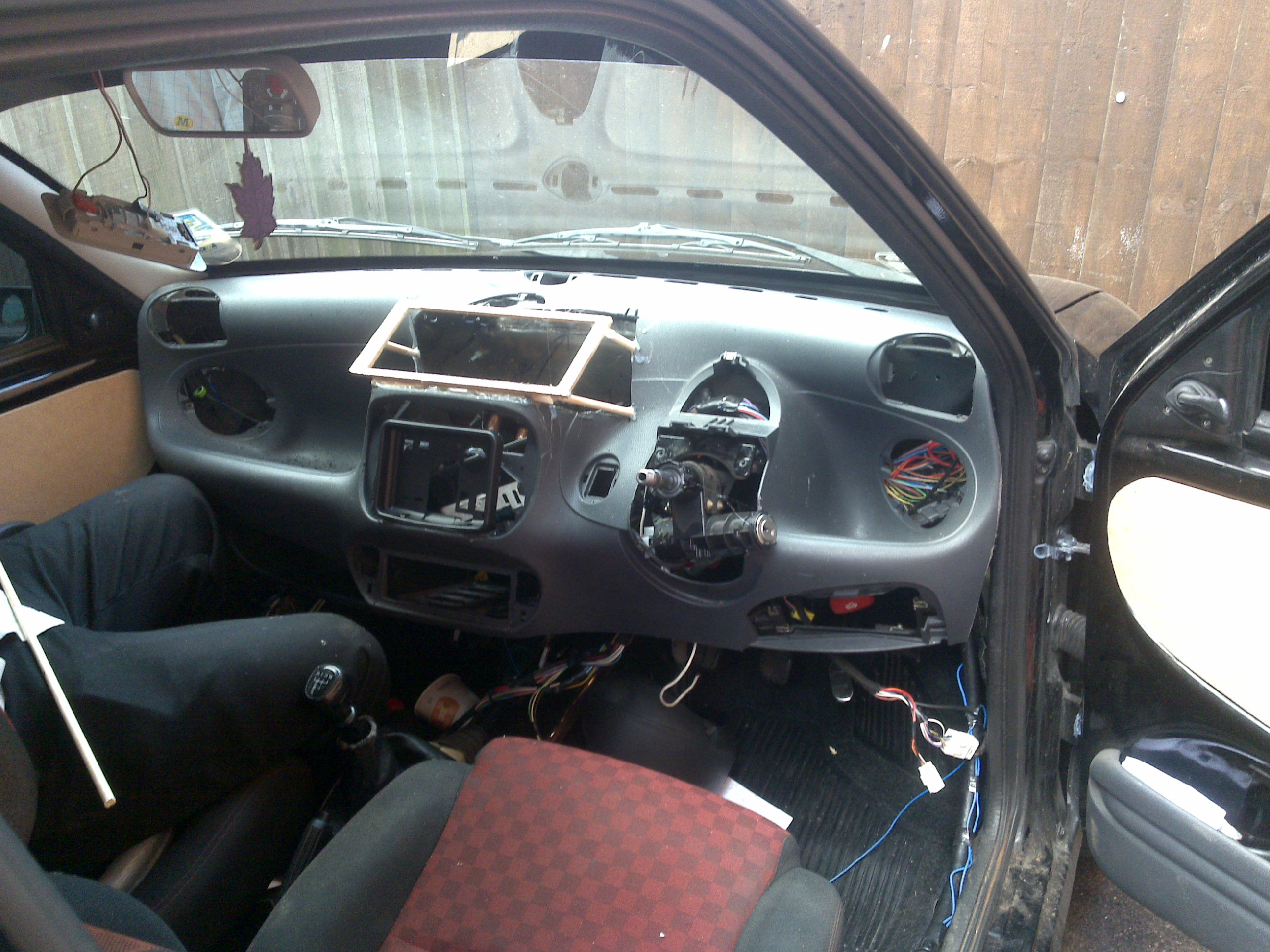

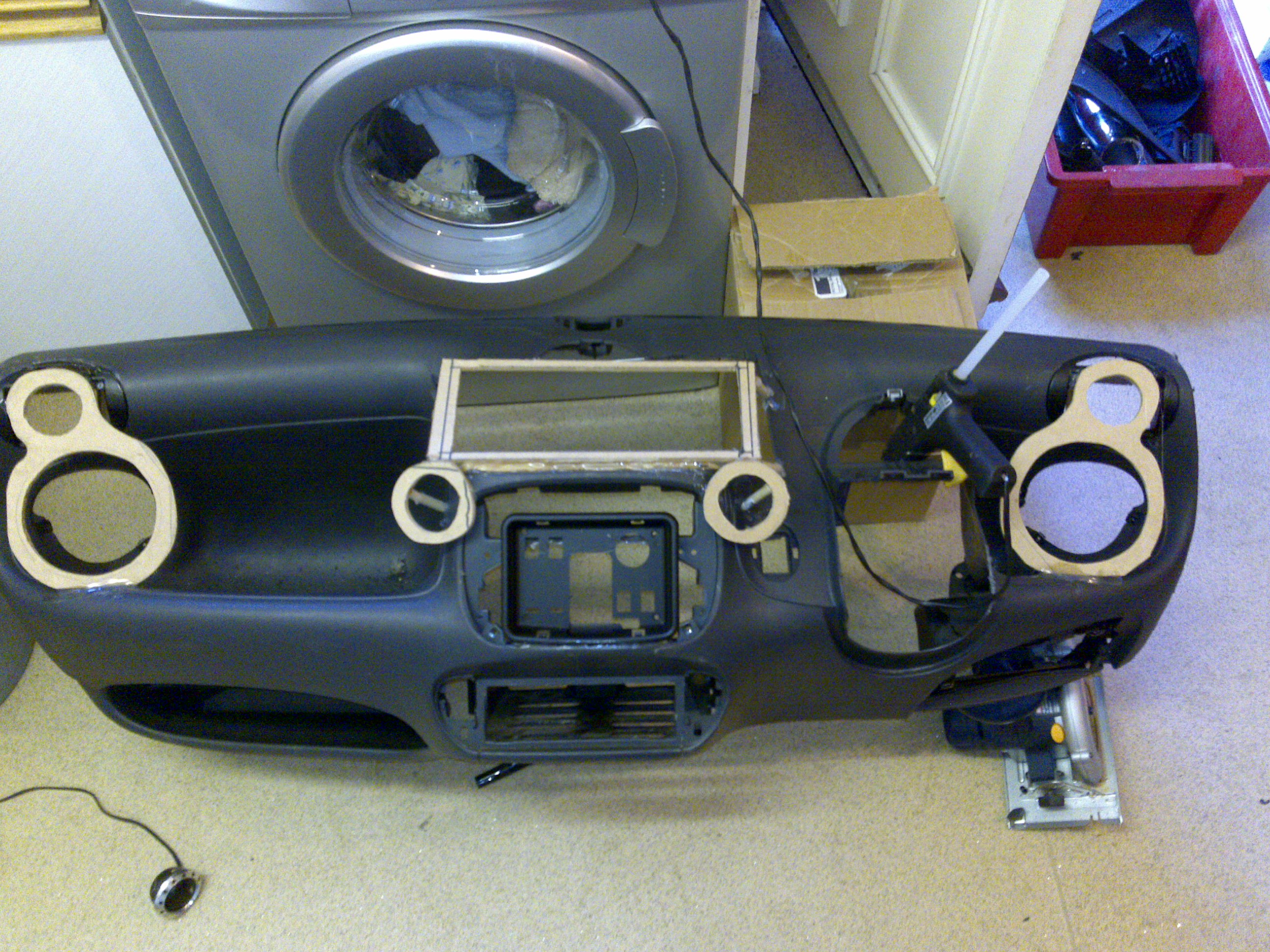

Heres another update... as the engine is pretty much sorted (just needs a sensor) so now ive moved onto the interior...
Ive remade the dash to house the vauxhall digital dash, Tv screen, and two set of vibe SE component speakers (the bullet proof SE series speakers)...
There will be 4 tweeters in the dash, two midrange speakers also in the dash... then the door cards will hold the other set of mids...
I will then be fitting two 12" subs in the rear (yet to decide what.. possibly something VIBE)...
Also have a set of 6x9's to fit, and two amps... 1x 900w RMS mono amp, and another 400w peak amp... Will be running the components with the 400w, and the subs with the 900wrms amp...
I know the 6x9s will effect the 'soundstage' but i have them already, and i want the car show worthy, aswell as a daily driver... so they are being crammed in regardless lol... (plus i need something to drown the noise out from the fans lol)

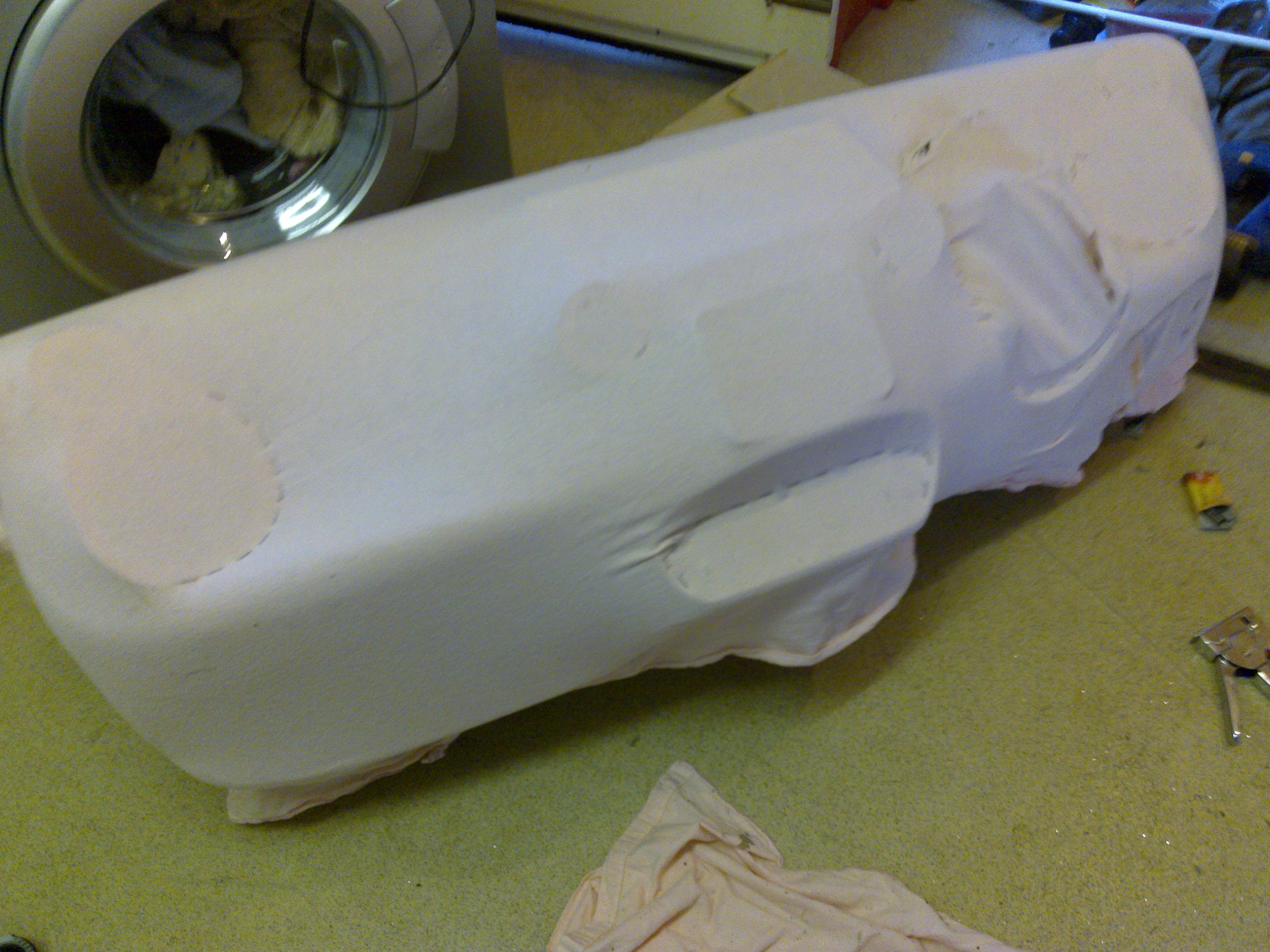

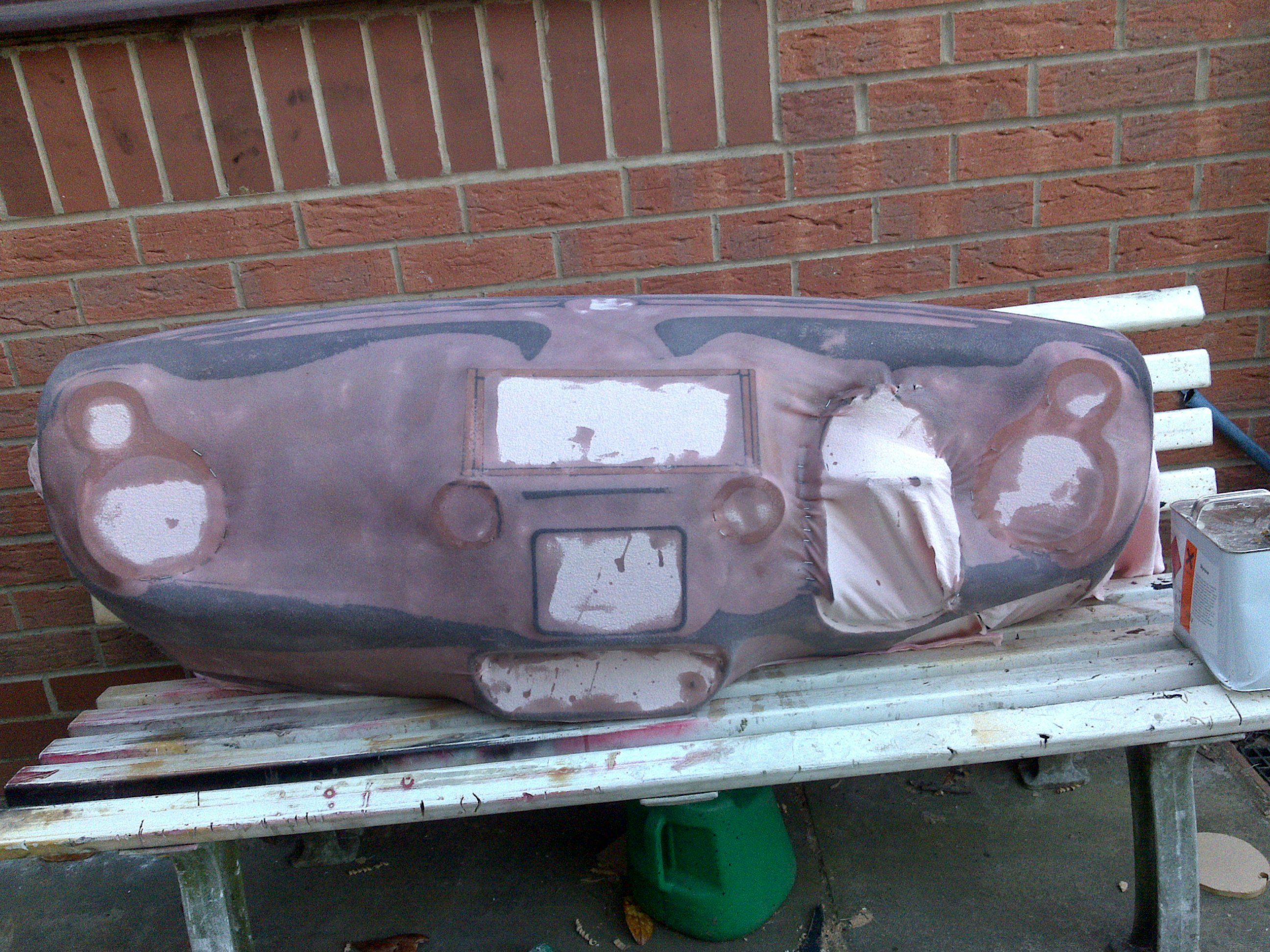

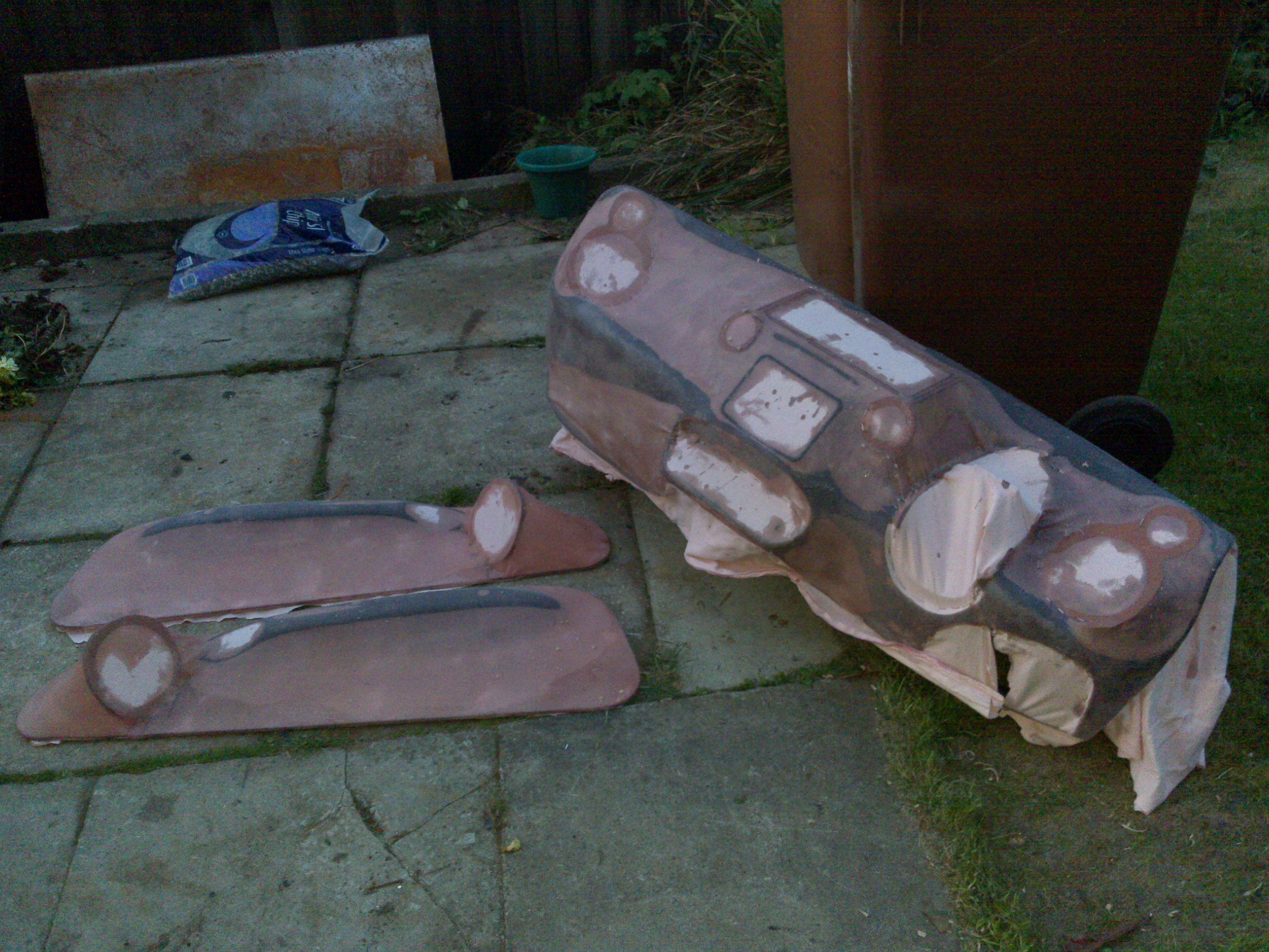

Heres where i got to today....
I am waiting for the resin to dry before i can apply the matting...
