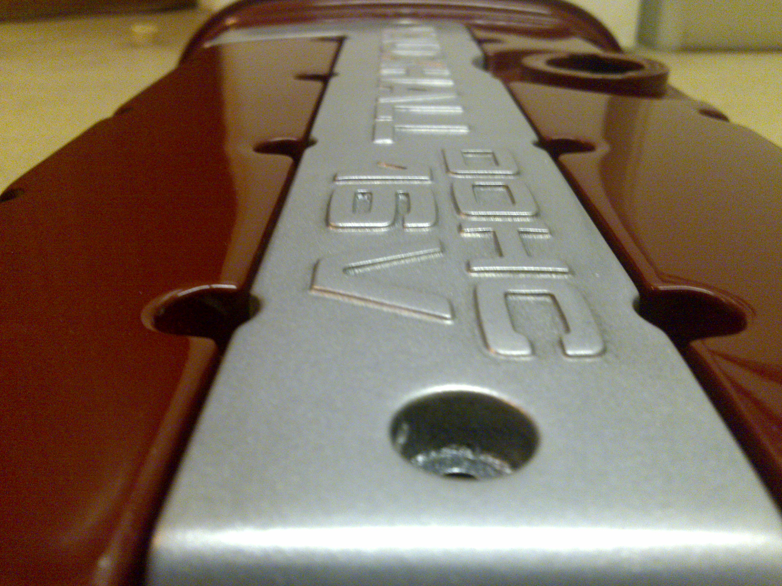

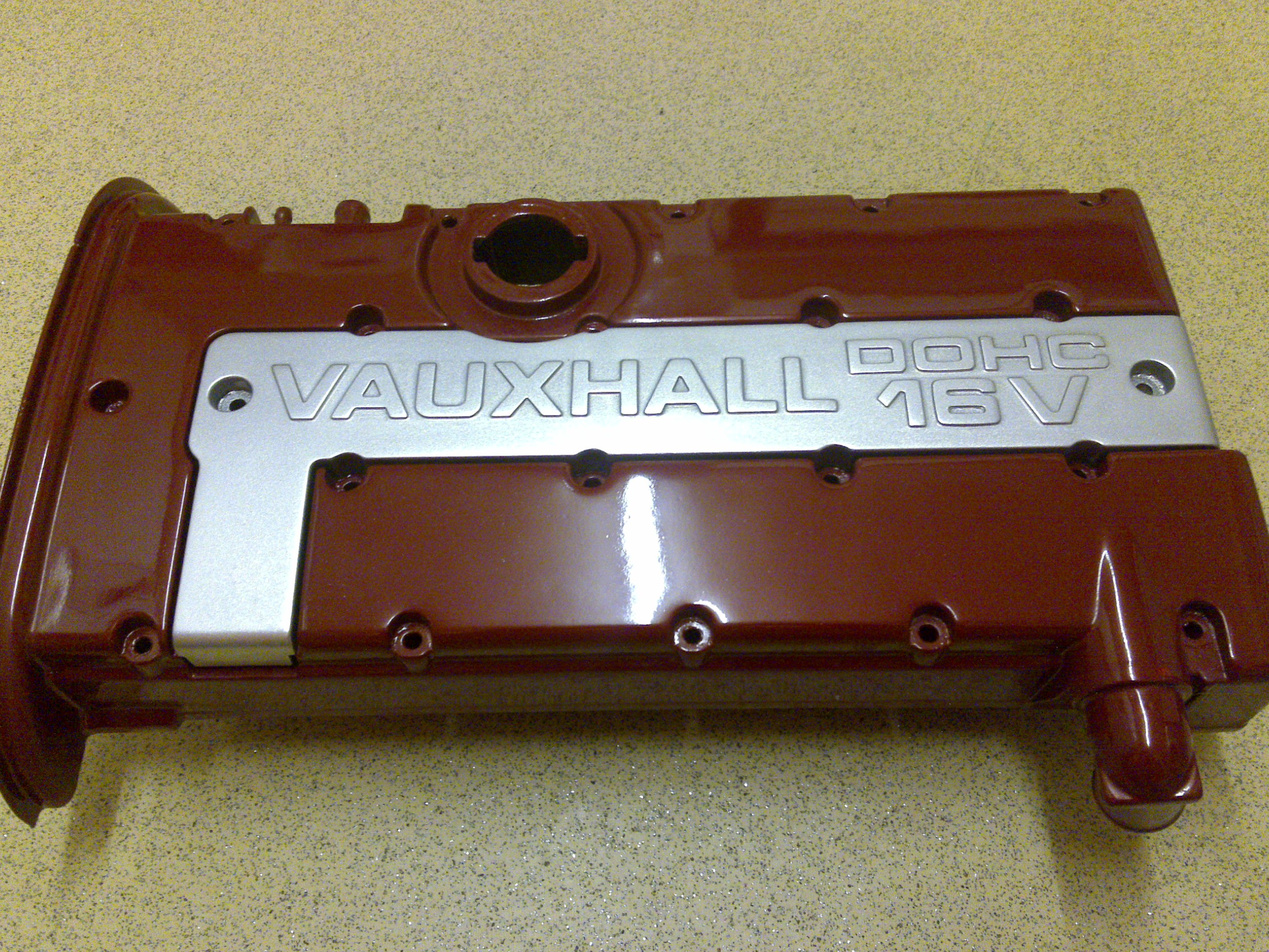

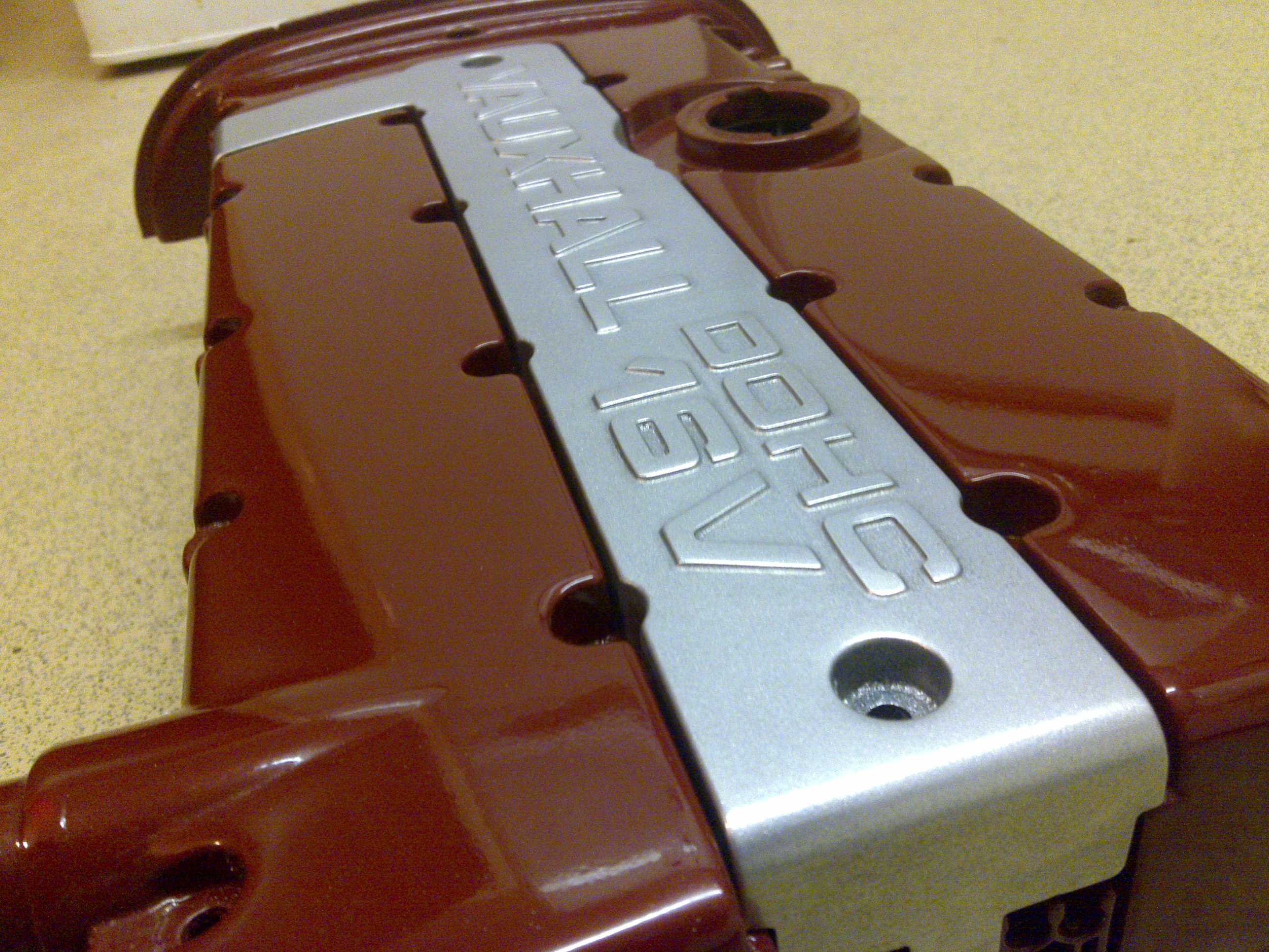

Just finished painting and polishing for the day... heres my rocker cover MK2 lol....
If i get the car driving, then it will be put on as soon as i get to trax... Im not risking it getting scratched or damaged lol... annoyed me having to redo it all....
