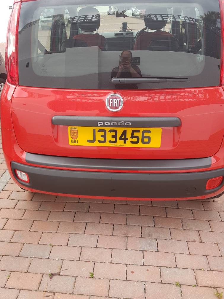

I got a grniune Fiat one from eBay along with 4 door sills, £63 inc delivery. [emoji16]

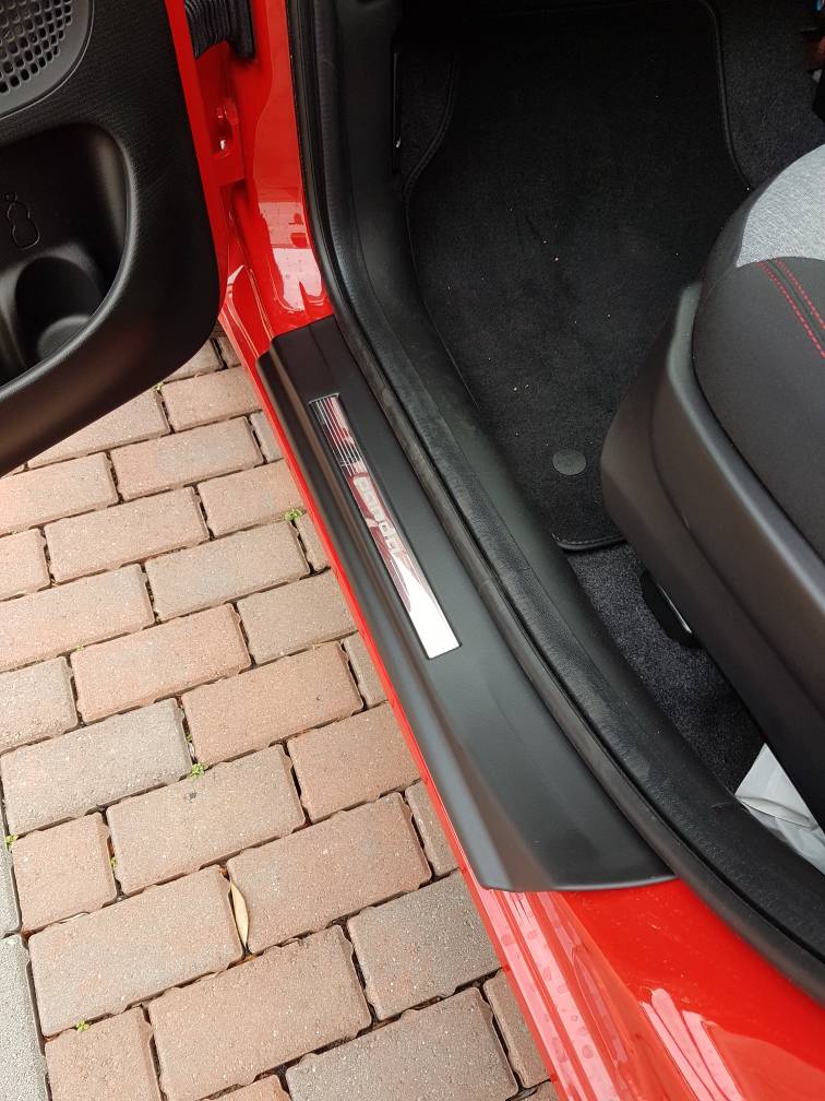

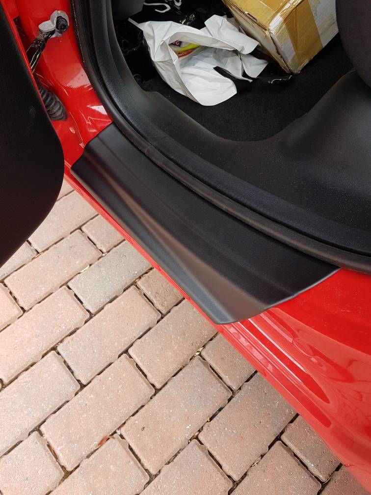

Can we please see the door sills?
But I have never seen these from FIAT.

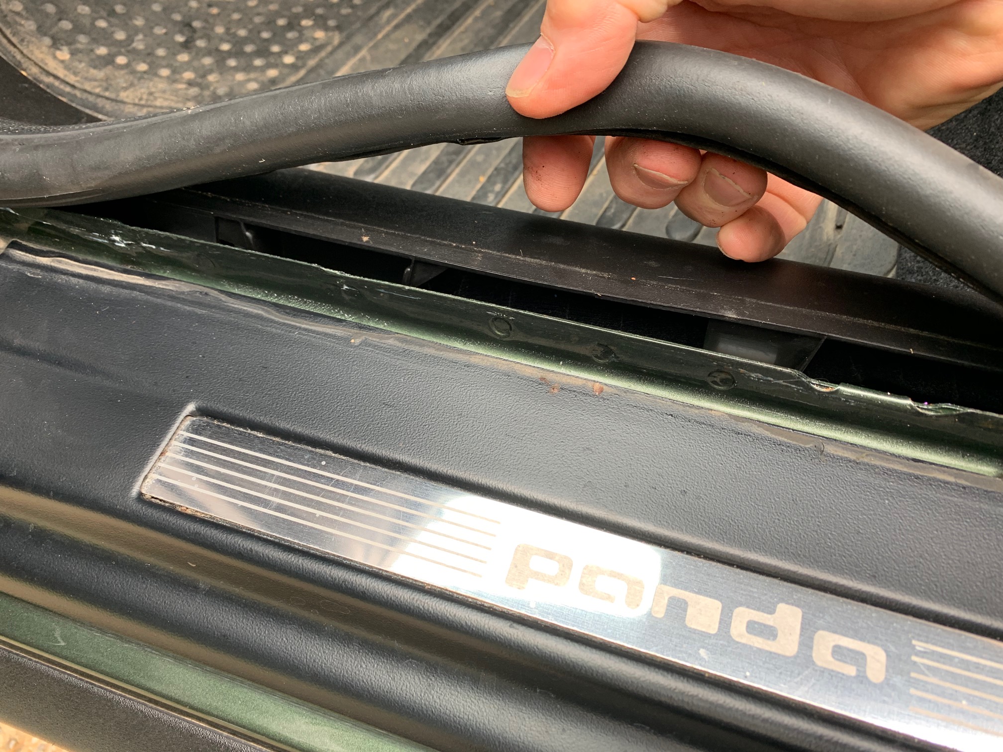

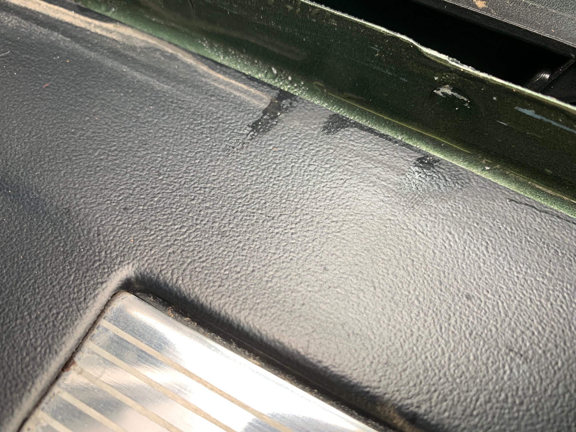

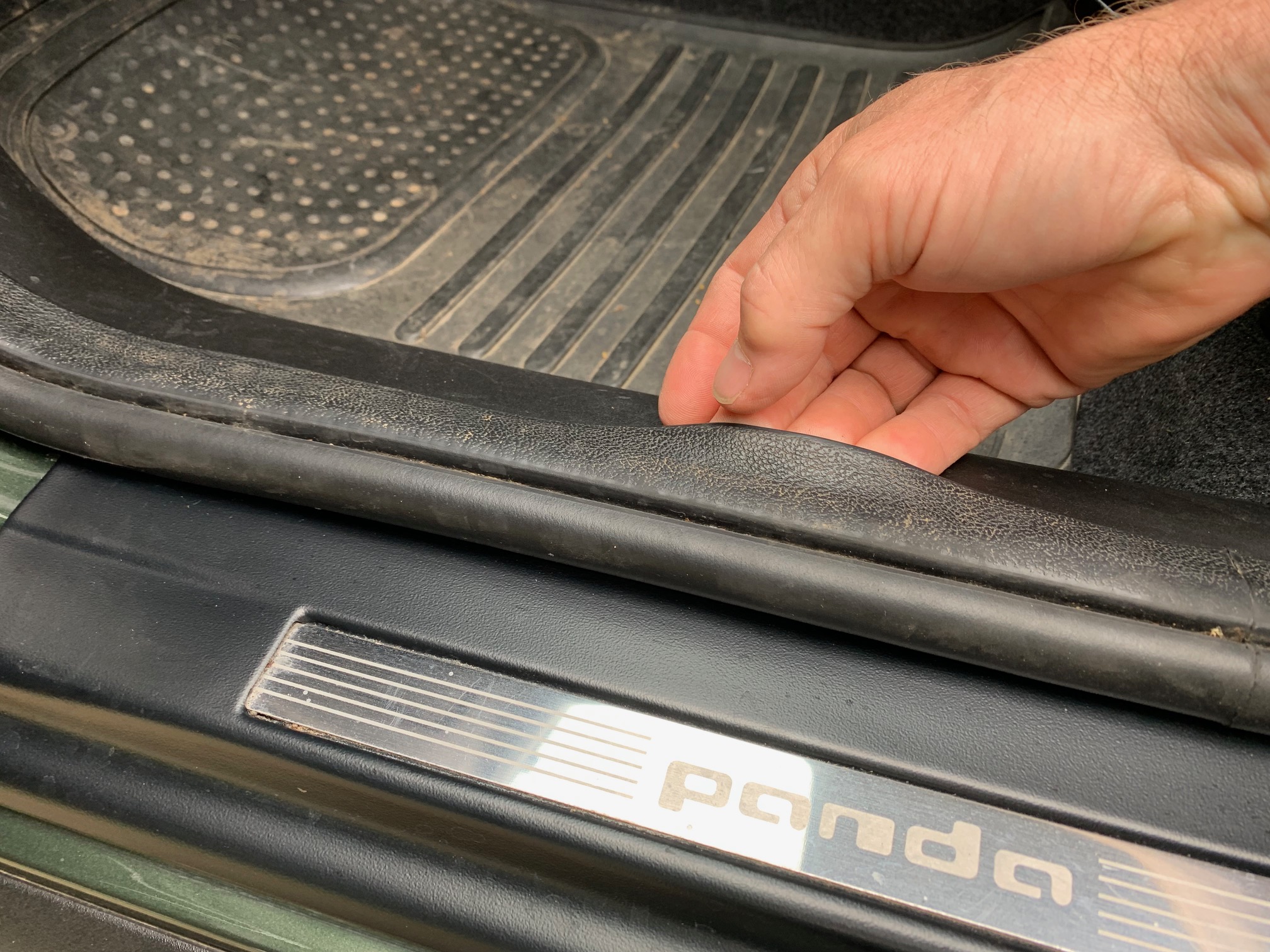

Do they go under the rubber strip or not??
I do not feel sure.
And should you seal them, so no water is trapped underneath?
I mean REALLY under.
Not just the thick, sealing part of the rubber,
But the part that holds on to the car.
Yes, they go under the rubber strip.
I found it was much easier to fit the sill protectors if you first pull the rubber strip away from the sill seam - and then push it back on after fitting the covers. The rubber is a push fit: see photos...

Done three sets so far and I agree that it would be easier to do as you suggest. Can be done without moving the rubber if you take care. Best tip is test fit and mark the lateral position as per the fitting instruction.
