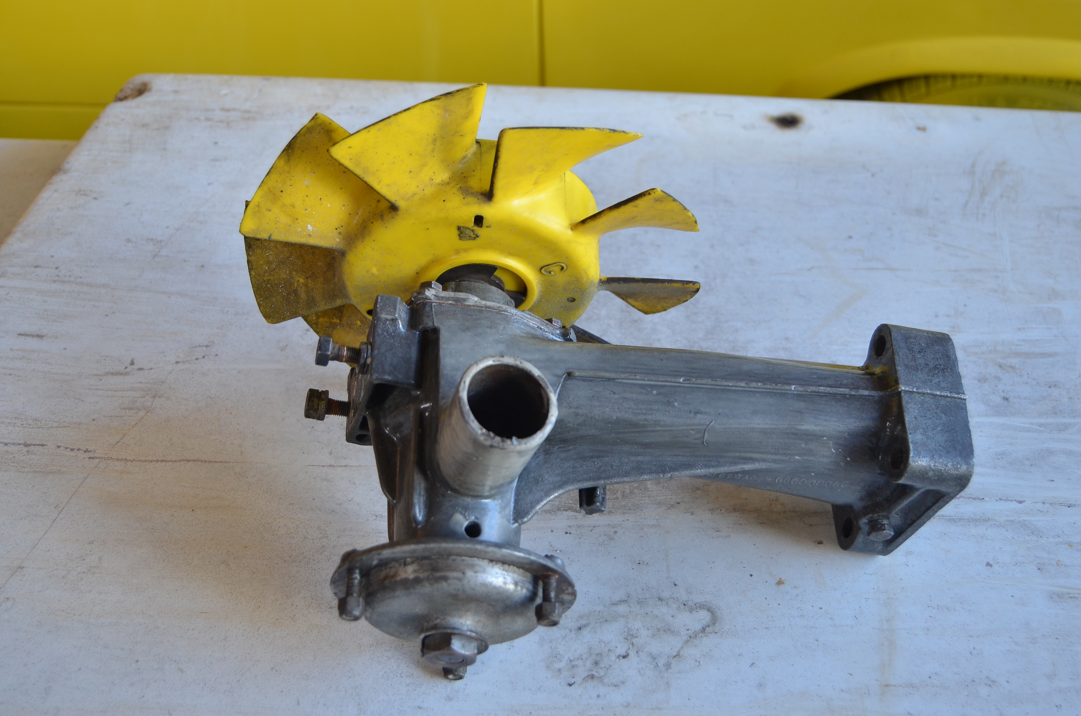

I'm still waiting for some of the parts for the water-pump and I've made a repair to the casing I damaged on removal by using epoxy-adhesive and a tailored steel plate to strengthen it. A big package of mainly rubber-based parts arrived whilst I was on holiday. So I could make a decent start on the front suspension, amongst other things, but I must first get the engine back together.

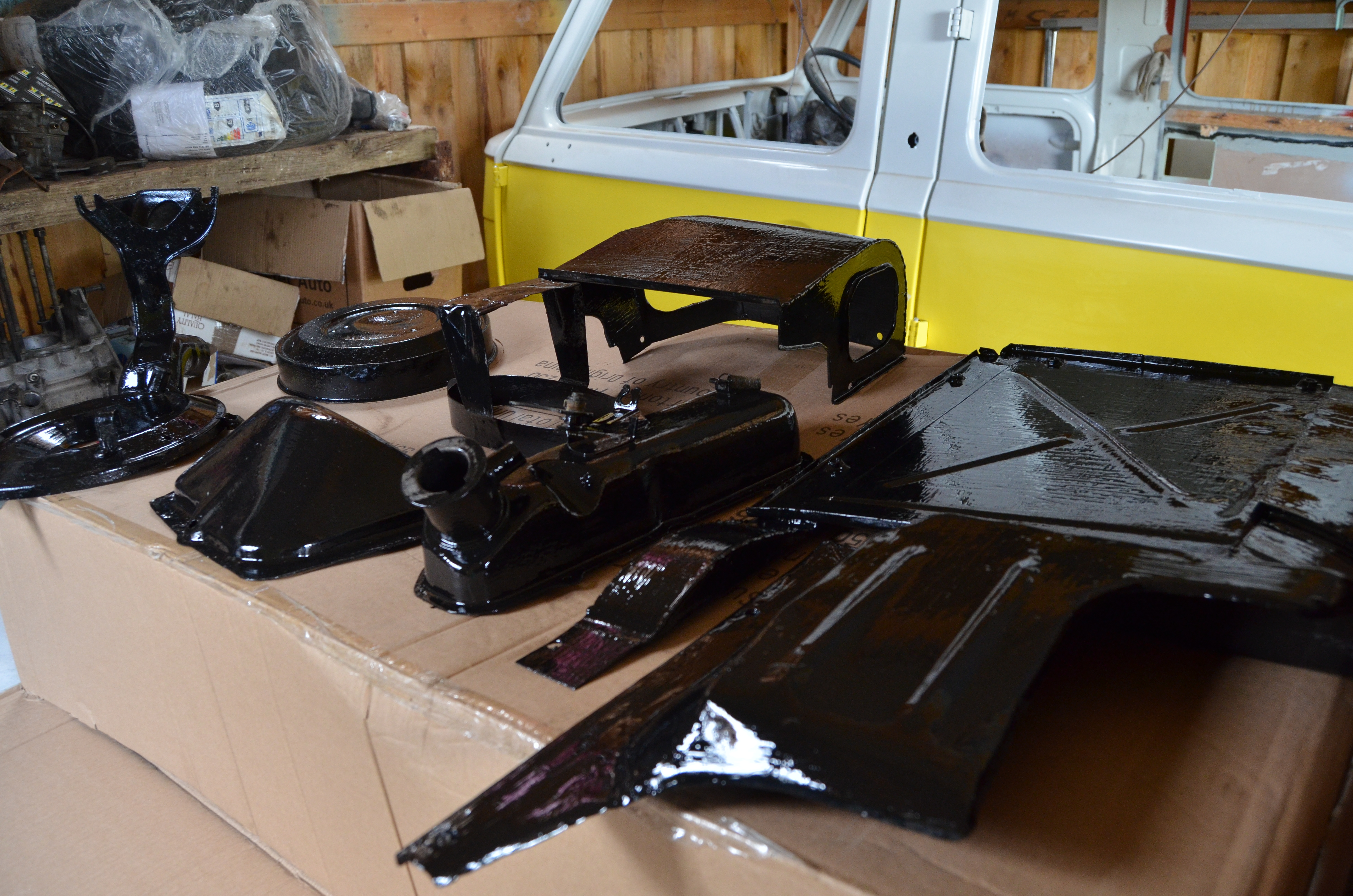

Every day I sort out a few details of the engine-bay and amongst other things, today I coated the pump-body and thermostat housings in clear epoxy paint; at the price they cost new it is worth protecting them from corrosion for as long as possible.
I've also got the sump and other metal parts soaking in the bath of phosphoric acid so that by the time the pump is rebuilt and ready to fit everything should be de-rusted and ready for use at the same time.

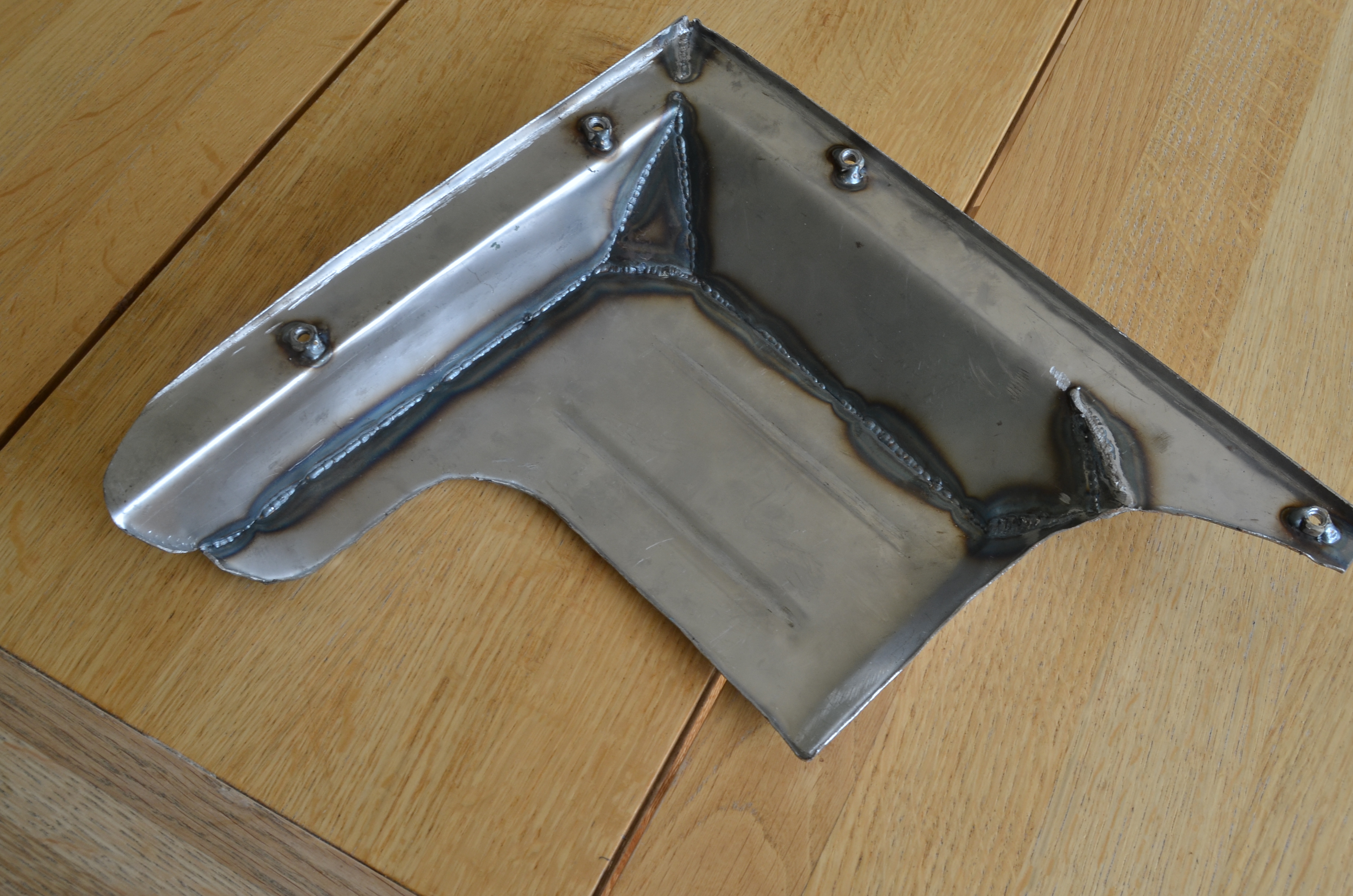

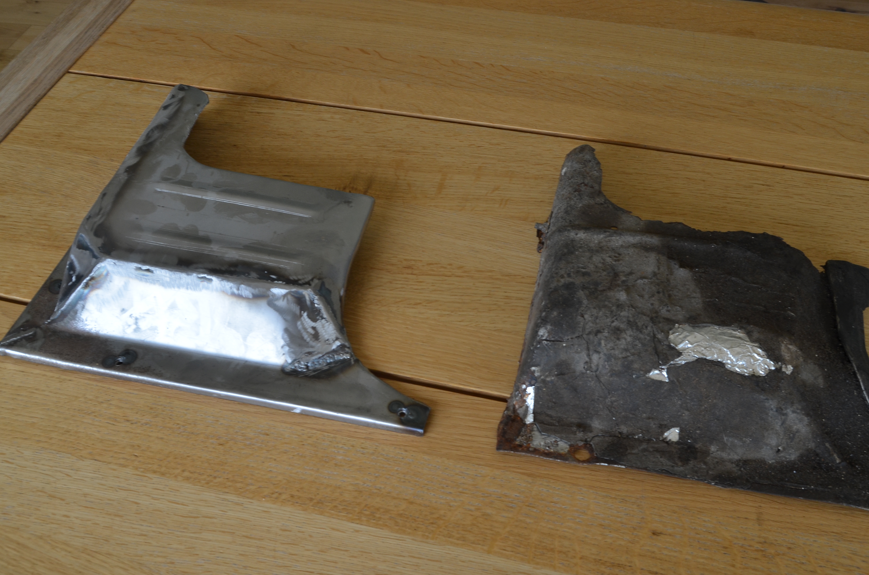

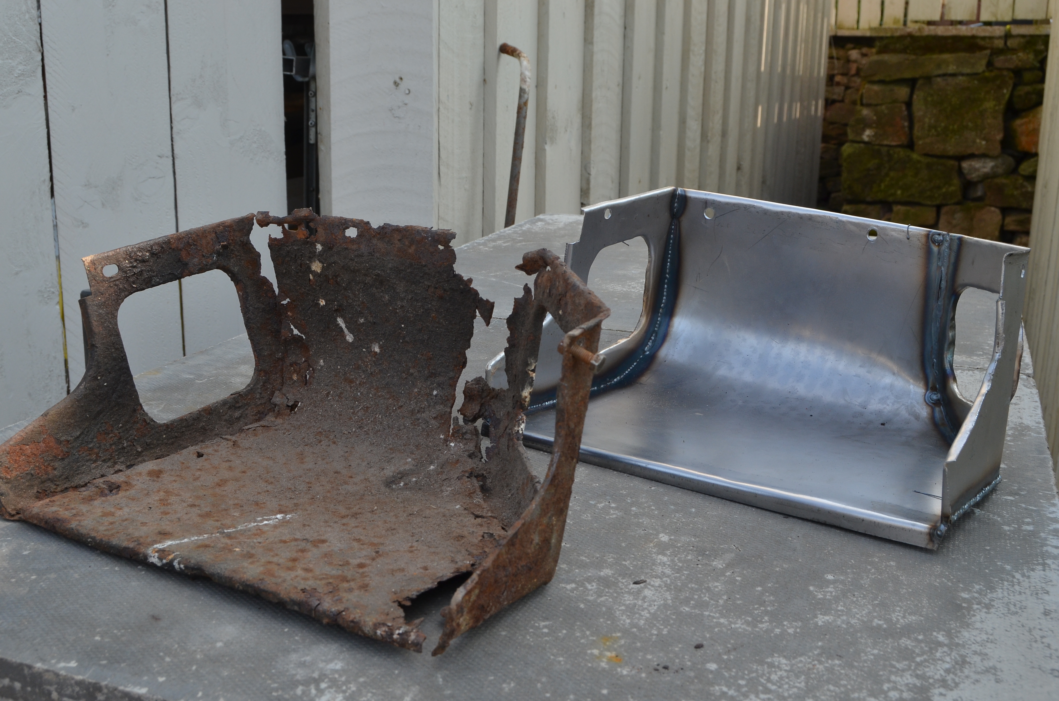

There's been quite a bit of work to be done on my 500 which has brought the welder out of storage and taken me away from the van for a week. Whilst in the mood for metal-shaping and melting I thought it was time to make a start on the engine undertrays. There aren't many pieces of this left intact and the most original remaining item is a backwards-facing scoop which directs the hot air towards the rear of the vehicle; you can see new and old side by side.
I've had guidance from an excellent blog-page here: https://spannerdude.wordpress.com/pandora/the-blown-diffuser/
But I'm not as interested in emulating the original construction so possibly found an easier way to make it. It's so good working with entirely new steel when it comes to welding. The item did take about three hours to cobble-up and I did the final tacking together with the three component parts bolted in-situ so that it would end up a good fit.
Obviously I'm very pleased with this part because it would surely be impossible to obtain a new one. The next item will be the main undertray.

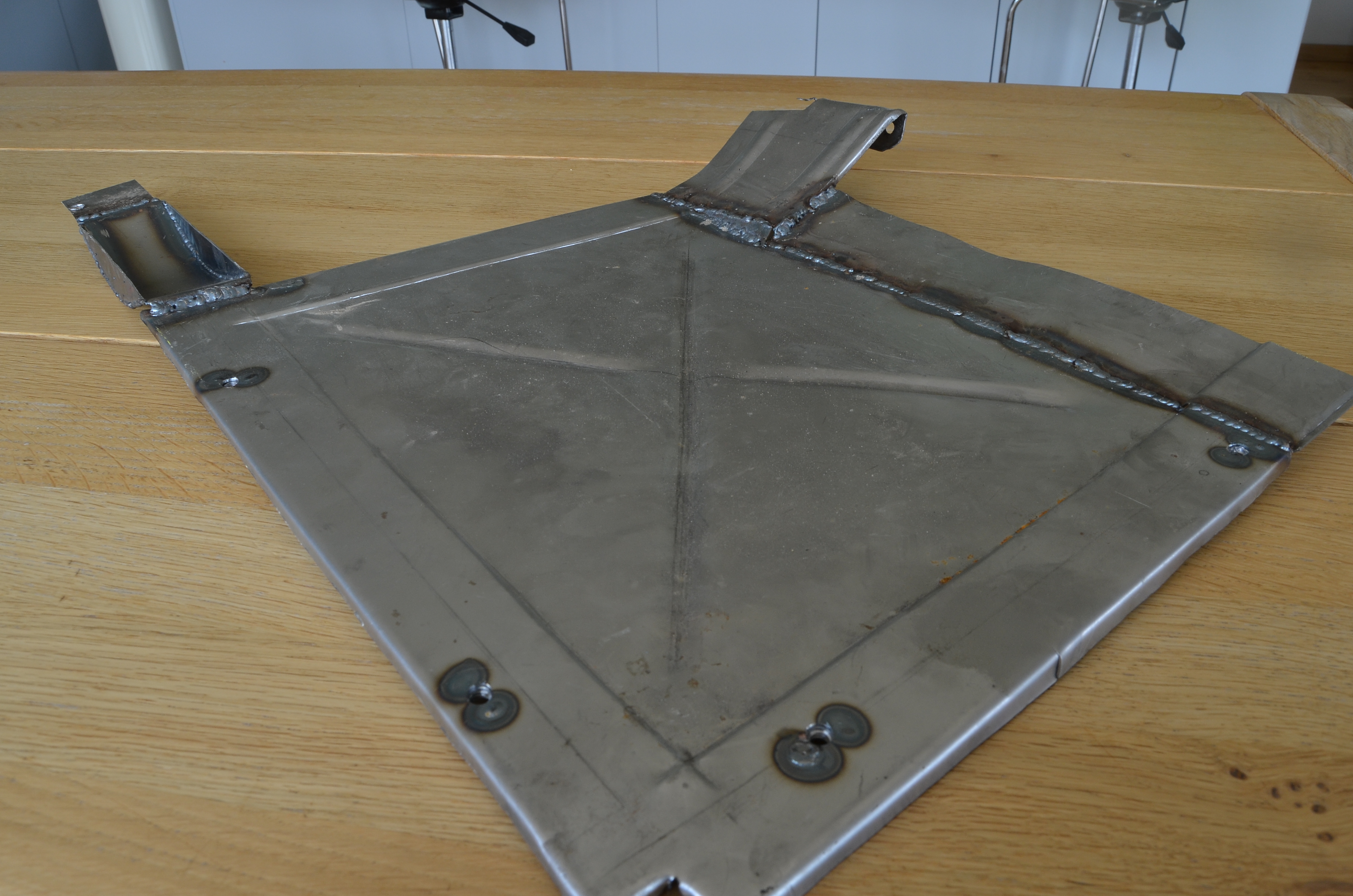

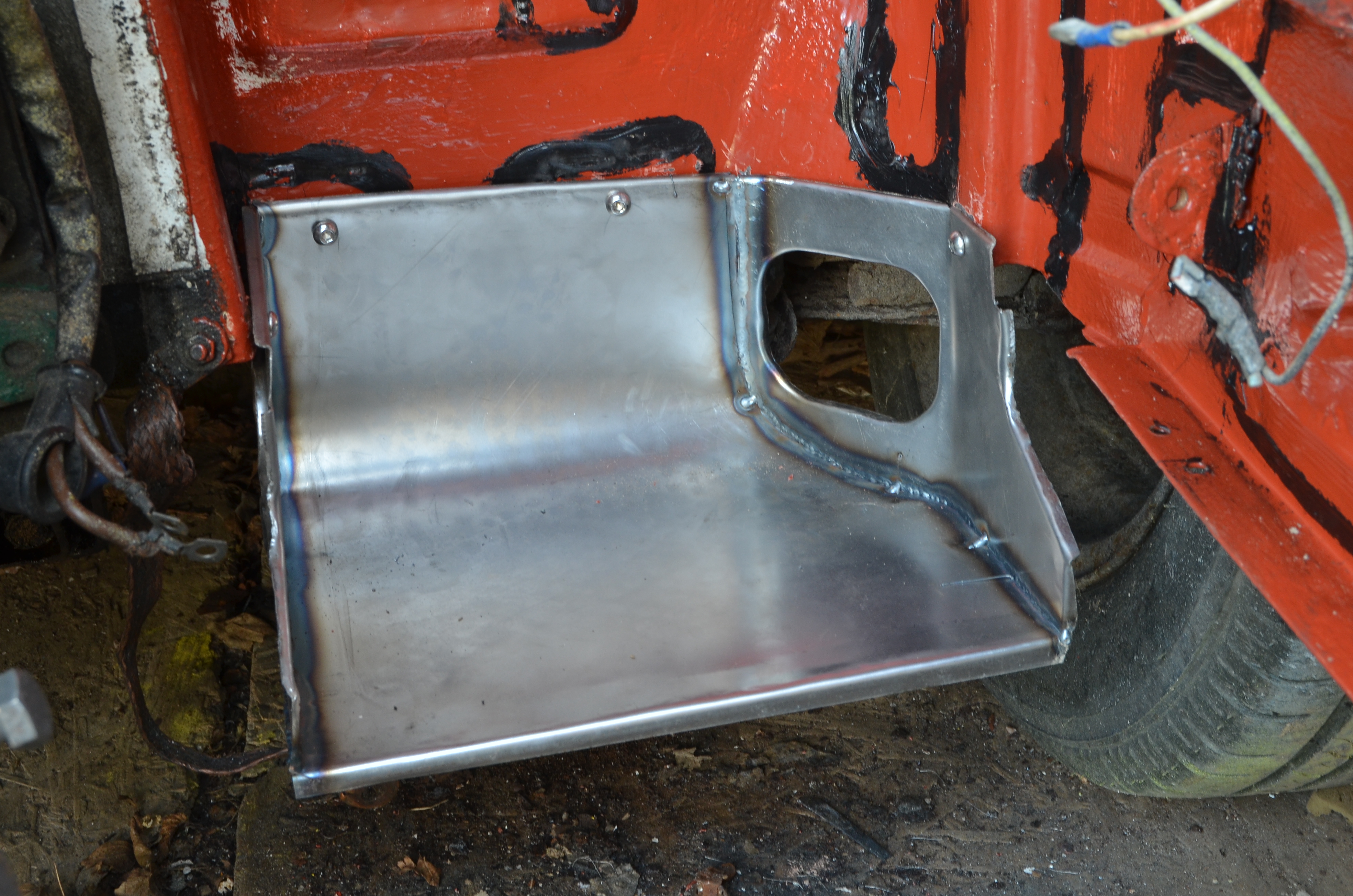

The main engine undertray supplied with the van was a simple piece of sheet-steel which was roughly cut to fit and bore no ressemblance to the correct one. So I consulted the web-pages referred to previously for clues.
I made something similar to fit;. It is relatively straightforward in shape but takes quite a bit of work to get the geometry and alignment right.
The original section of tray which fits above the exhaust silencer had been patched-up with a combination of aluminium/bitumen tape or flashing and some rough fibreglass. It was simple to make but involved a fair bit of butt-welding as it was a bit complex for me to simply beat into shape out of one or two pieces. If there is sufficient clearance I may supplement this with some spare aluminium heat-shield that I've been keeping for such a purpose.
It looks like the original trays were fixed with self-tapping screws and matching captive "nuts". As the new ones are tailored to fit I was able to weld M6 nuts so that it can all be secured using some of my surplus stainless, hex-socket screws.
I still need to get some rubber so that I can rivet a sealing-flap where the undertrays meet the engine sump, but I'll do that when it's all in-situ and the engine is fully assembled.

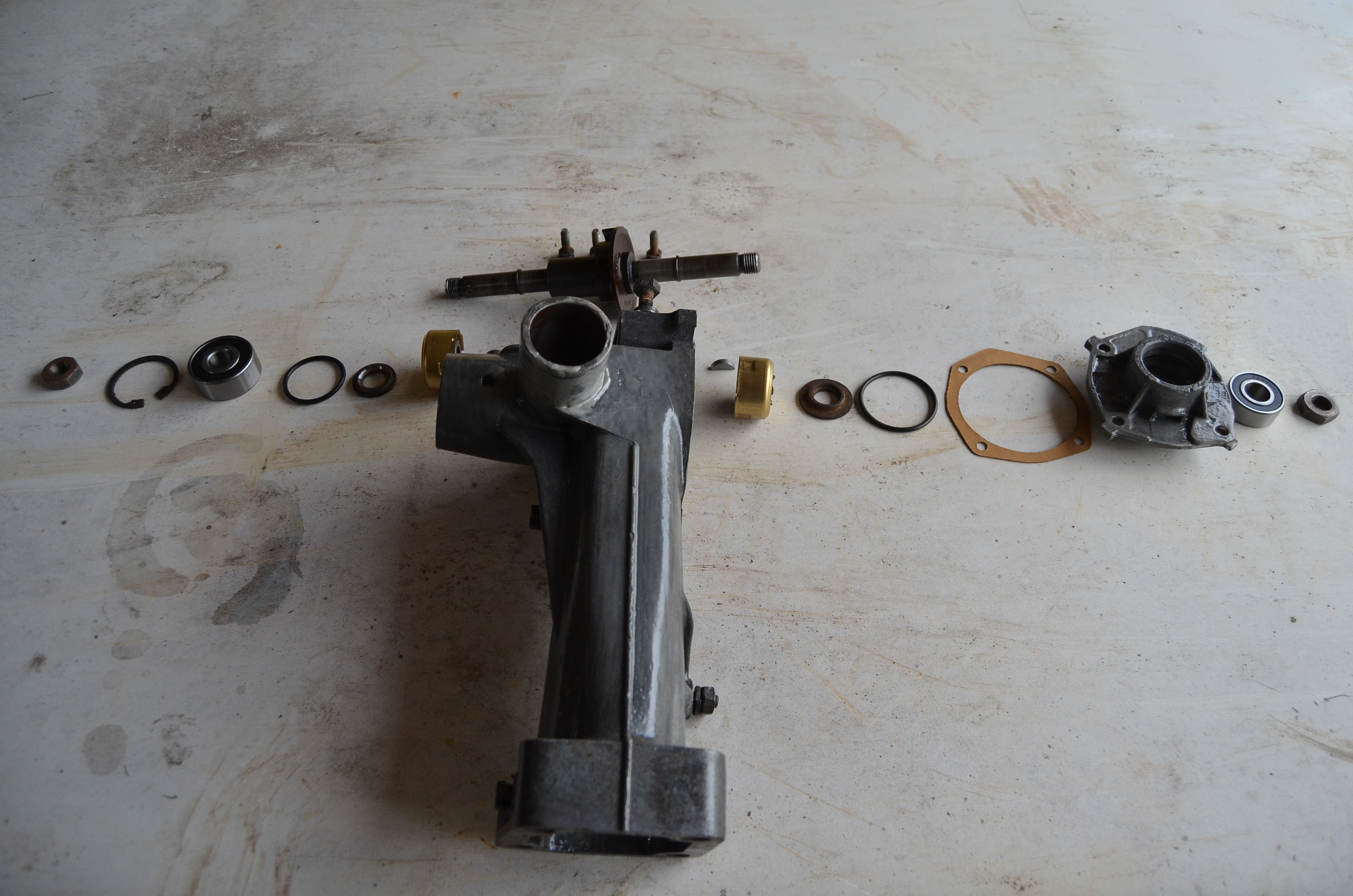

For the last four weeks I've been anxiously waiting for the repair kit for my water-pump, which has been holding up the engine refurbishment. Today I found that it had been delivered ages ago whilst I was in Italy and was sitting in a pile of logs in the garden. Everything was waiting for assembly so it followed that I should assemble it.
It's quite a tricky to work out the correct order to fit all the pieces but after a lot of dry-runs and faffing about it's now in one piece again.
It's a relief to have saved the hundreds of pounds that a refurbished or new pump would have cost me and good to know that this very important component functions like new again. OK, it doesn't look like new, but that's not my way of doing things, but with new seals and bearings, new gasket, keys, re-threaded shaft and new nuts, some epoxy repairs to the casing and clear epoxy paint to protect the aluminium, it should be good for another 35 years.:)

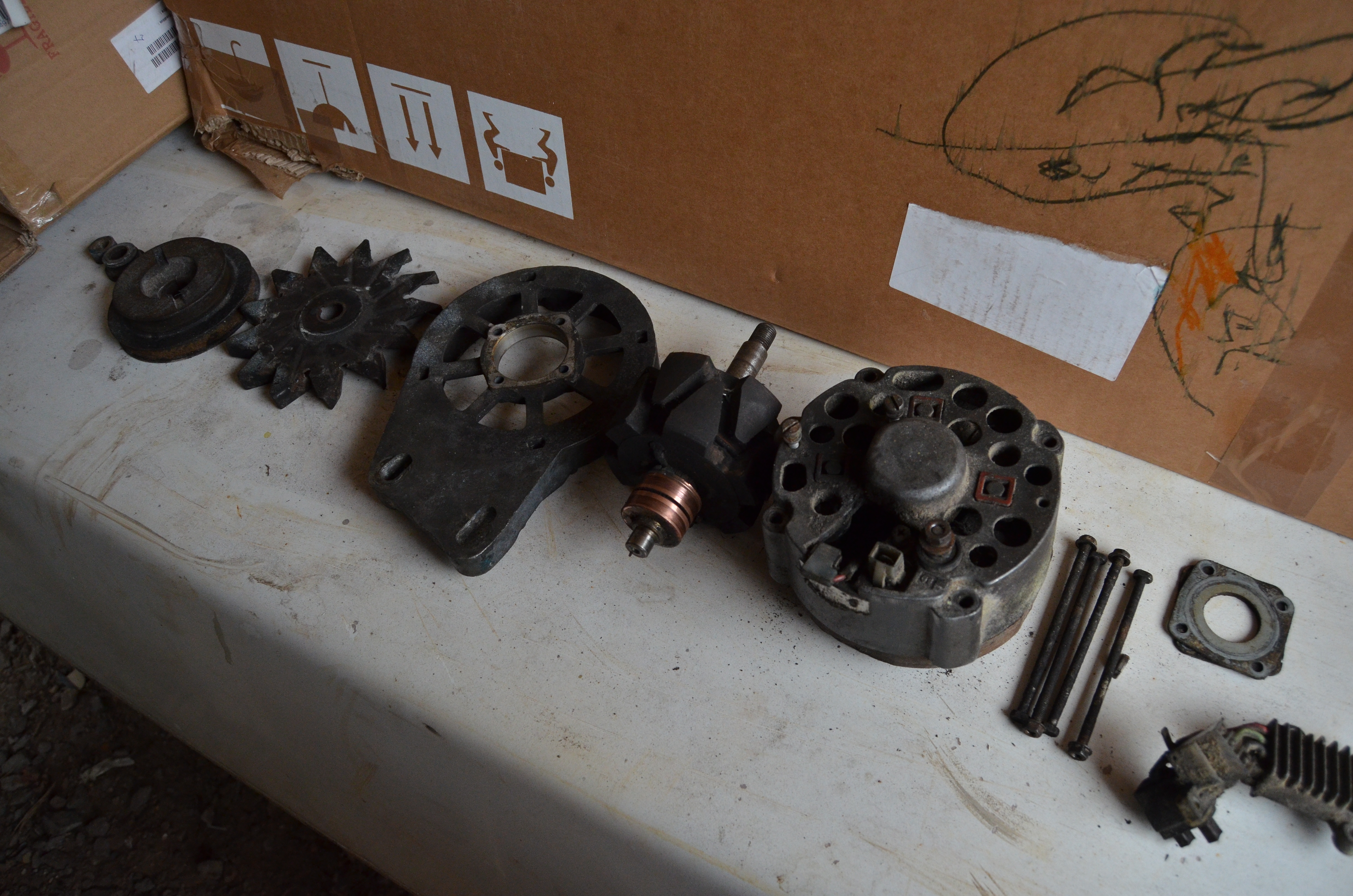

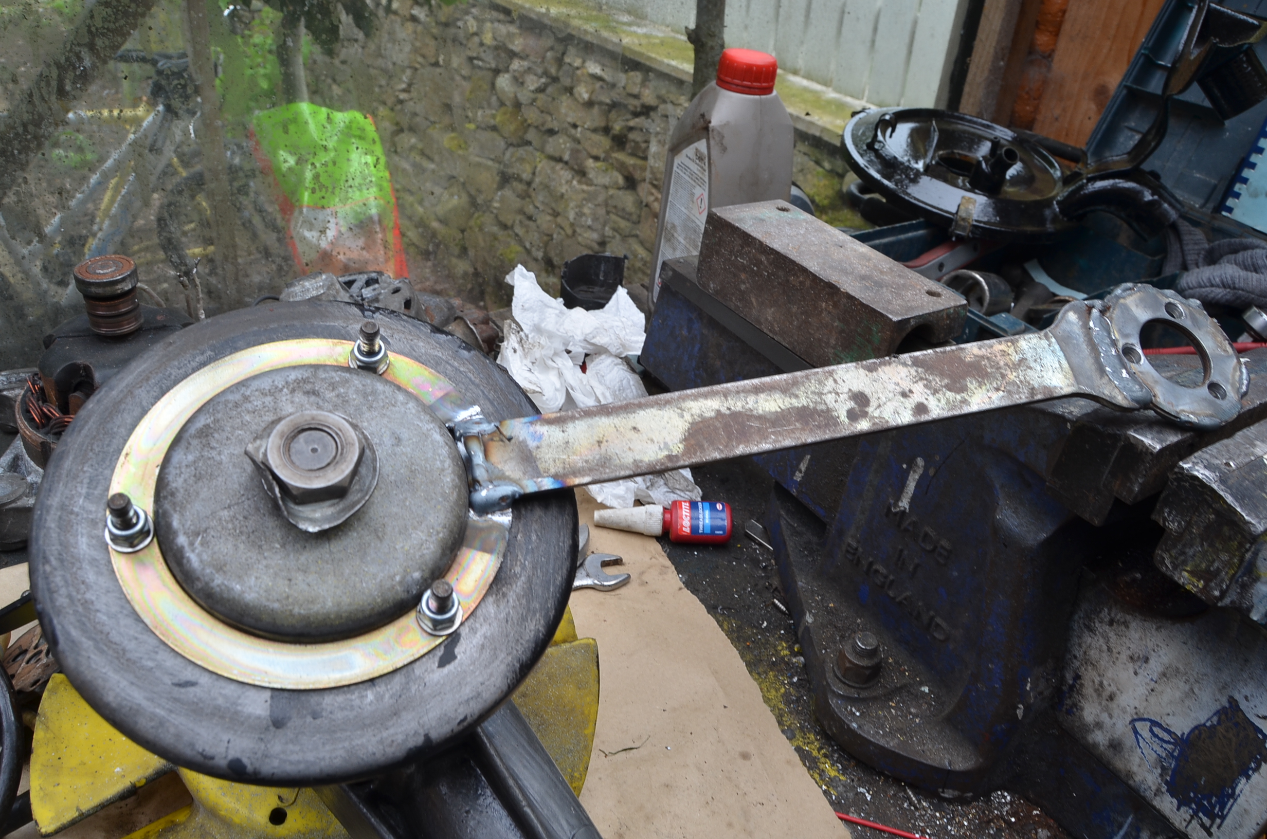

I had a look at the alternator and decided it was worth stripping it down because the bearings felt a bit rough. I also found that the brushes were worn unevenly, but visually, everything else looks good. I'll have to test the electrical parts and then it will take a bit of detective work to track down the spares I will need.
The undertrays etc. all now have a shiny coat of Tesco paint and I'm now homing-in on a load of little jobs that have come to light as I stripped it down. One of the stud-threads for the starter-motor has obviously been stripped for ages and another was looking dodgy, so both now have shiny, new helicoils fitted. I'm not sure if all three fixings were originally studs because non-original setscrews were fitted to the damaged holes. I might as well refurbish the starter-motor whilst I'm here so that's the next job.

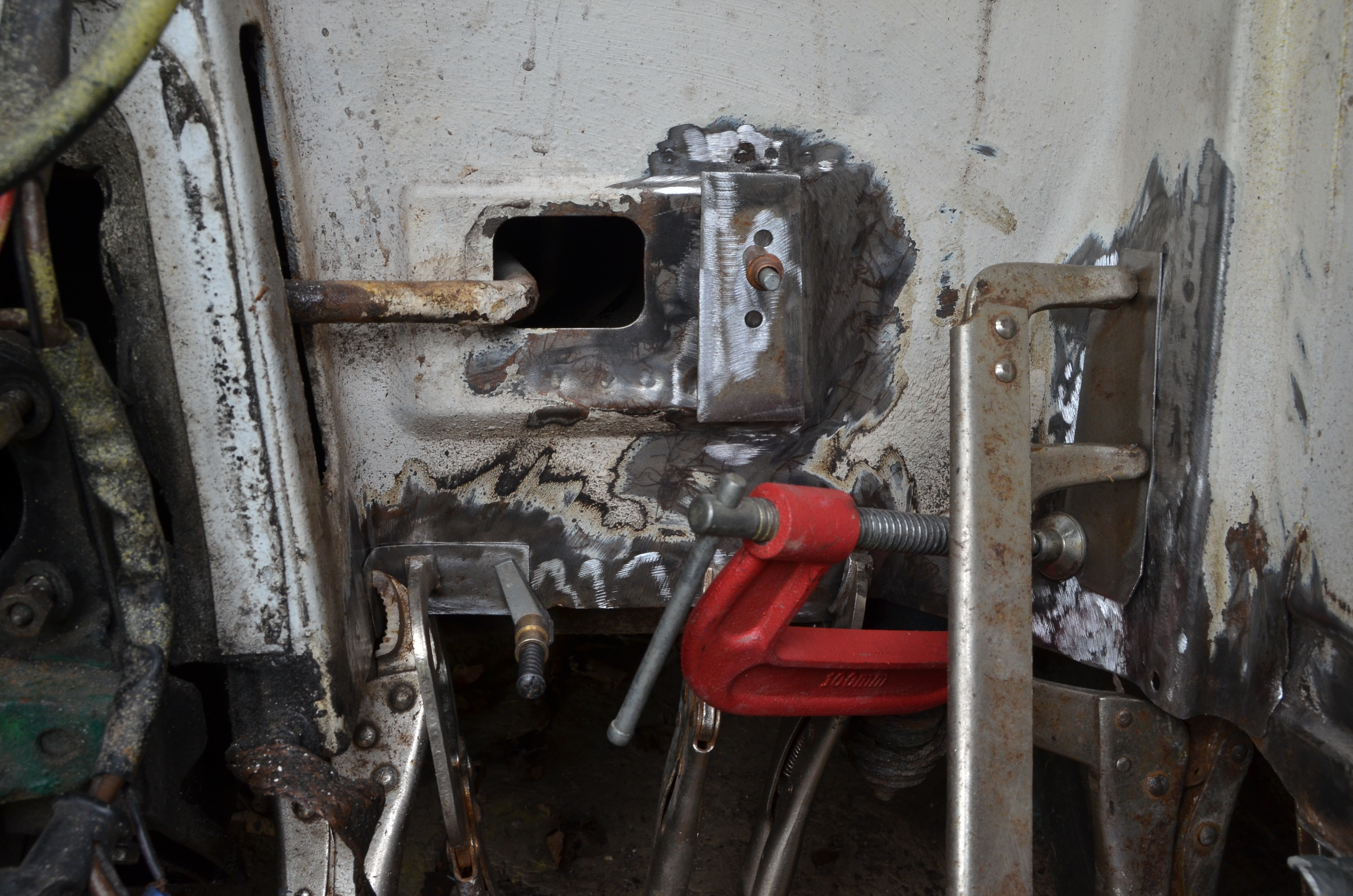

I've had a successful week of achieving bits and pieces. I worked out that the roof hinges which I had condemned were just slightly distorted; so I tweaked them. One is broken but I'm adapting a new steel one to fit.
They fix into fibreglass and the original rivet-holes were damaged, but then I realised that the glass was reinforced with an aluminium plate. So I've tapped into that, fitted Helicoils and the hinge problem is over. A few holes wouldn't co-operate so I've obtained some excellent rubber inserts with brass threads at the bottom which act as hollow-fixings.

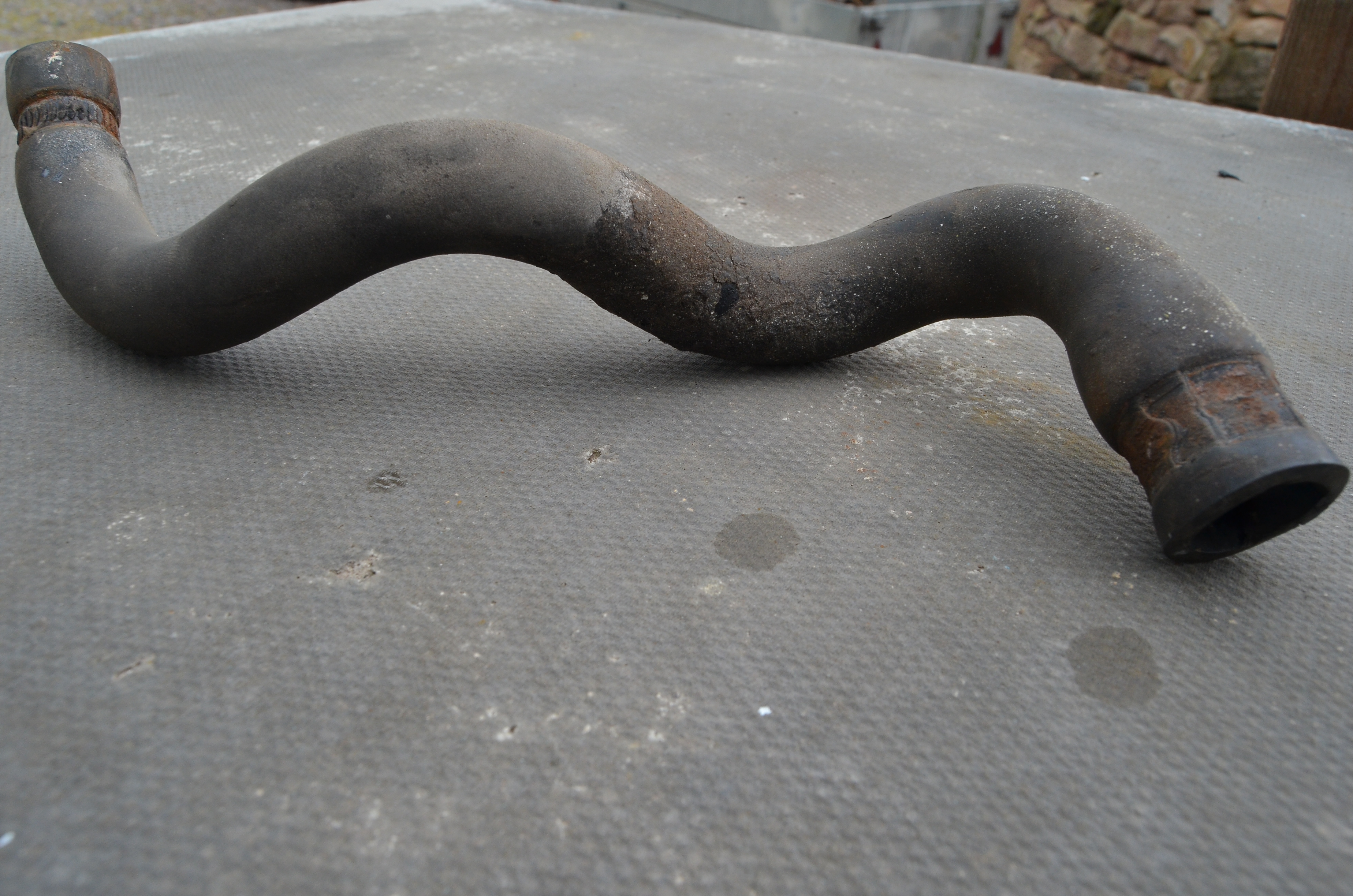

I gave up trying to find new replacements for the two heater hoses of which the hot water feed is a real one-off. So I've cleaned them and then wrapped tightly in amalgamating tape, which bonds to make a leakproof and protective layer. I've used this as chafing protection on the two new solid pipes I've fitted where they pass through the "chassis". I've copied Vin 's idea but adapted it to use a couple of 15mm compression fittings I had lying about and I fitted solder-ring fittings to the ends which gives me a nice grippable spigot for the rubber pipe.
The alternator is rebuilt and fitted. The slip-ring was a perfect fit and although fittng it to the shaft and solder it was nerve-racking it's another job well done.

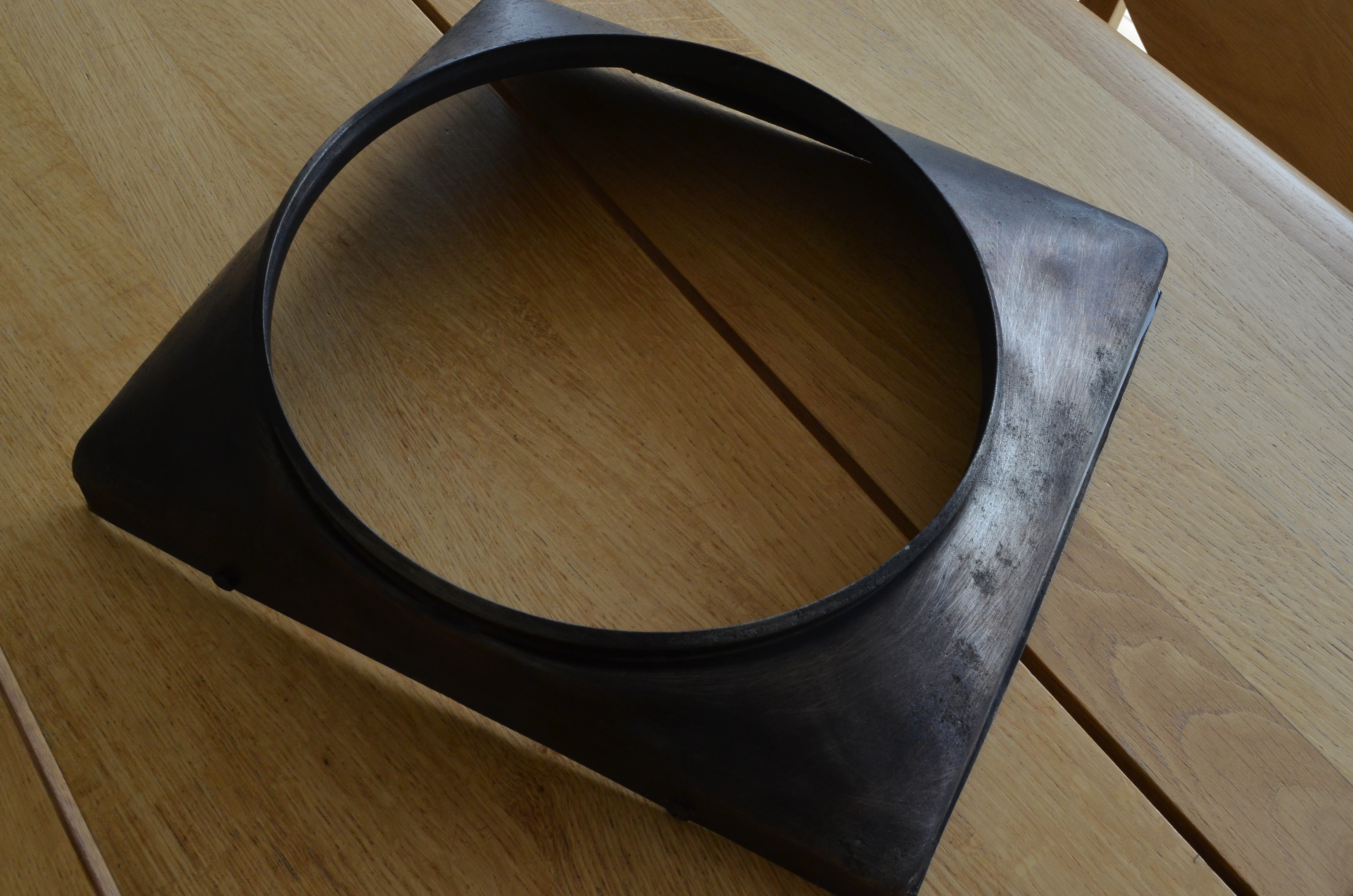

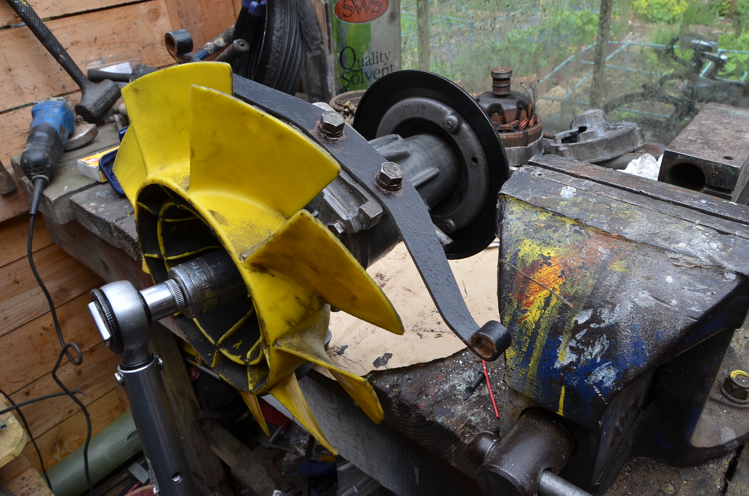

I've been held up by the diversion of sorting out the radiator and coolant pipes. I also found I had a leak from the gasket and one of the M10 setscrews securing the water-pump. So forget the gasket and I will be using my old Permatite favourite instant gasket material. I've also got some fibre-washers which will go under the steel-washers and I hope this will stop the leak.
Taking the pump off allowed me to try to modify the cooling-fan shroud to stop it catching. One of the things I tried was to move the position of the fan on its spindle slightly, which didn't work. Ithink it has just been mishandled and needs some carefull bending. :eek: I wasn't 100% happy that the securing nut was tight so by using a spare pulley-spacer welded to a handle I was able to lock it all up in the vice and put on the full torque. Without this I had to hold the fan itself or use another spanner on the opposite nut; this is not conducive to accuracy. You can see that my special tool is setup for the same job on my Fiat 500.
With a bit of luck I'll have the thing running again by the weekend.:)
