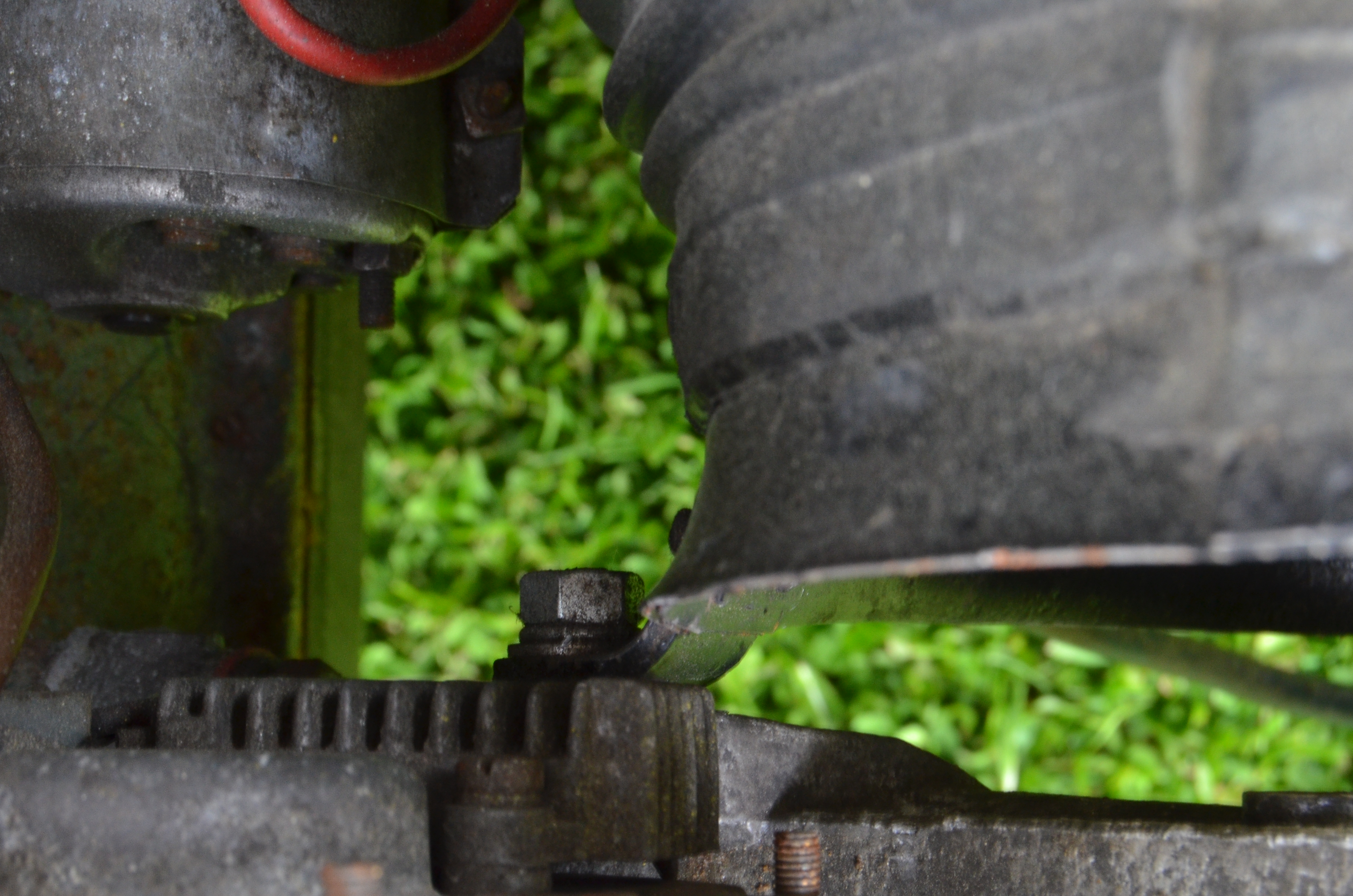

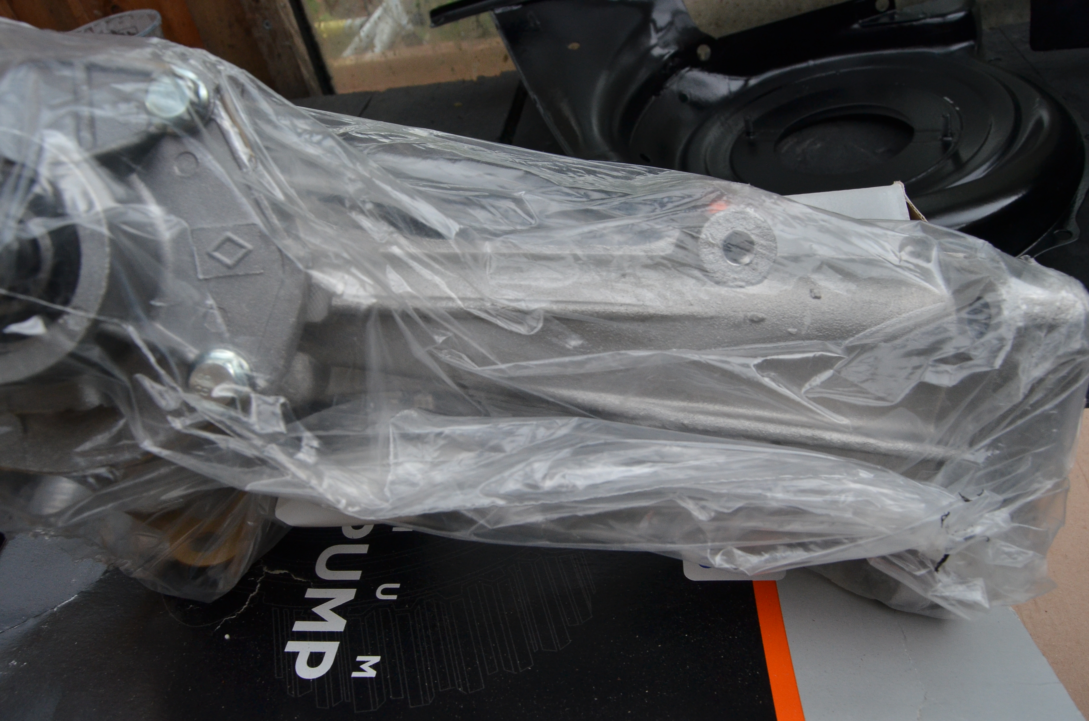

This is the new pump (sorry I didn't remove from the bag) which shows the tapped hole. The other picture is a bit hard to understand but shows where it attaches on my existing pump.

The mounting point is missing on my water pump. Looking at the casting it looks like it should have been there at some point. I suspect that it would have been a bad casting that got through the Fiat quality control back then :)
