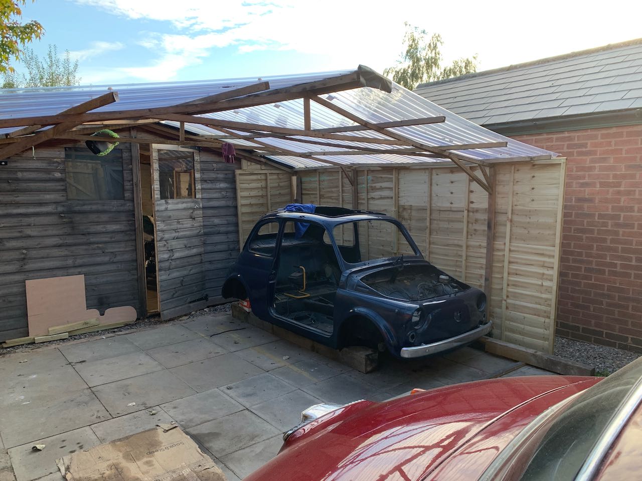

Hi guys :)
My name is Steve, and I'm a rusty-old-car-aholic :p
I've been quietly browsing the forums for a while, and slowing collecting knowledge while looking out for a 500 project. A few weeks ago I took the plunge and bought a project, it's definitely not the best starting point, but it's also far from the worst.

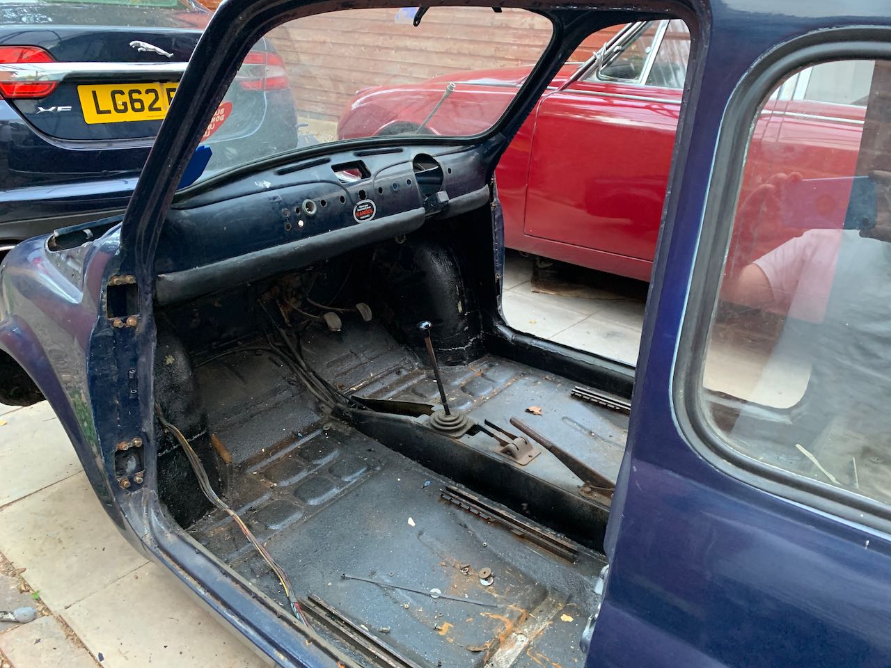

It's a RHD 1965 500F in dark blue. It appears to have been off the road since the mid 80s, and was recently purchased by a trader who was clearly looking to getting running and flip it for a profit before he realised just how much was wrong with it (and there is quite a lot wrong) beneath the surprisingly shiny paint job.
This means it's come to me already mostly disassembled. I'm aware this is a bad idea, especially as this is my first 500 and so I'm not familiar with how it all goes back together... It can't be that complex though can it?! :p
In the photos you can see how it looked as delivered to me, and also how my other classic (also resurrected from a 30+ year lay up period) dwarfs it!

It's been a slow start to the project so far. First order of the day was just to make sure I could find all the parts I thought I should have, and the good news is it does appear to be all there.
As the weather is closing in on us, it also seemed prudent to take some time to put the winter weather protection up on my car port.

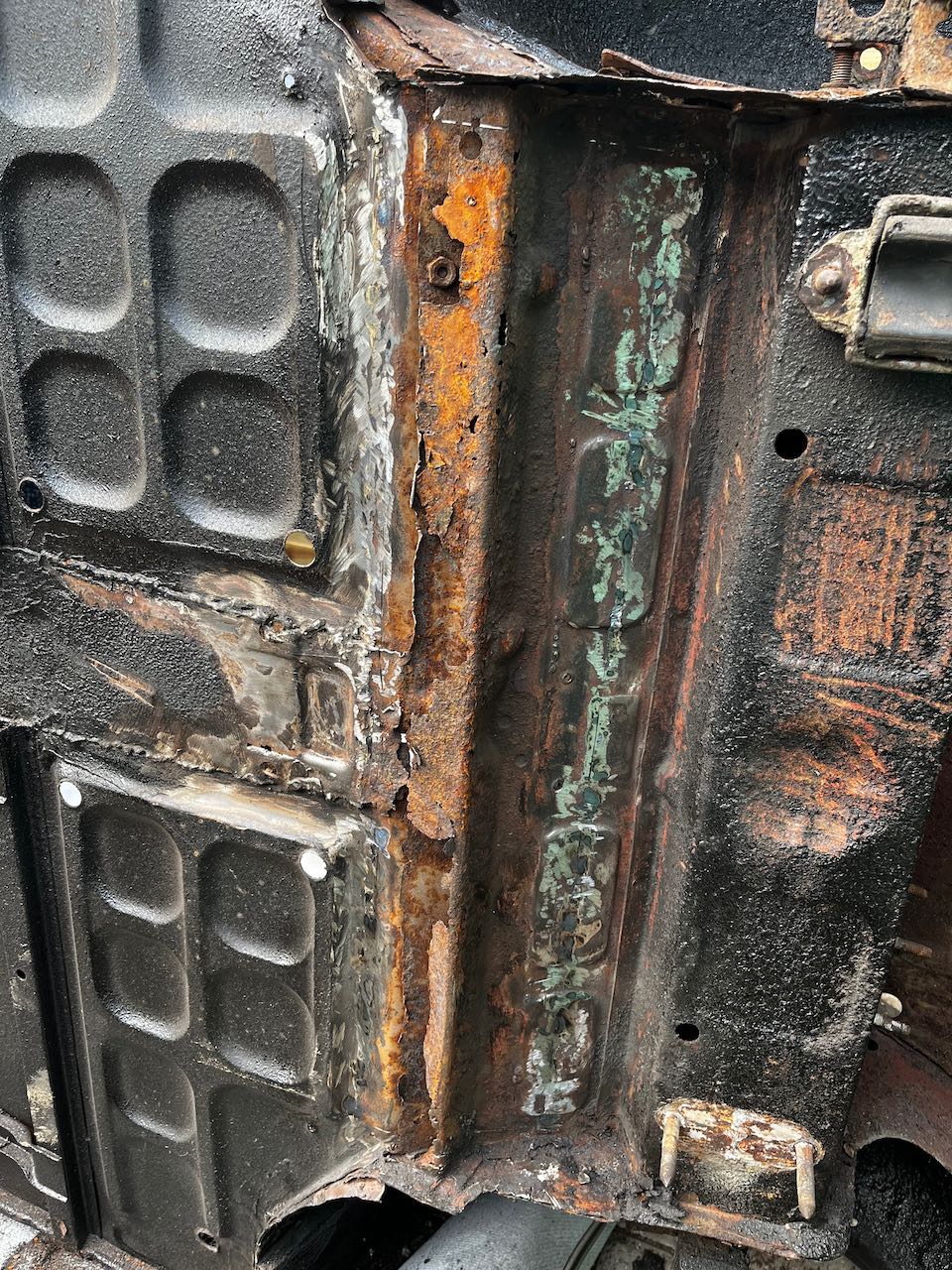

I've worked on enough rusty old cars in the past decade to know that it always turns out to be worse than I thought it would be and this one is no different, but there is good news too.
The front panel, and the bulkhead behind it are made of a wonderful combination of rust, fibreglass, pop rivets and seam sealer. This I was aware of, so clearly they'll need to get replaced in their entirety.
There are rust holes in the rear spring mounts. All 4 inner wheel arches have been patched, to a varying standard. The front right inner arch is especially bad and has large holes fibreglassed over. There is also a big ugly patch under the front edge of the floor, and the inner sills appear to be a pure patchwork construction. I'm sure the condition of the middle sill will be terrible.
New front wings and rear wheel arch repair sections have clearly been fitted (and been treated to shiny paint), but not welded to the inner arches. Instead someone has just fibreglassed over the gap between the new wings and the old rusty remains of inner arches. See picture of the right hand rear arch after digging the fibreglass out!
I had felt the fibreglass in the arch lips when viewing the car, so knew something fishy was going on, but I have to admit I didn't expect it to be quite this much of a bodge! Fixing it properly will mean removing the outer panels and messing up that shiny paint.
So what about the good I hear you say? Well the floors have clearly been replaced and, though the welds are ugly, are solid. The bonnet, engine lid and doors are all in surprisingly good condition. The window apertures appear to be all original and rust free, likewise the pillars and roof structure also all appear in good condition with no signs of previous repair.
Very much a mixed bag, but I knew that would be the case and now I knew what I was working with, I could make a start :)

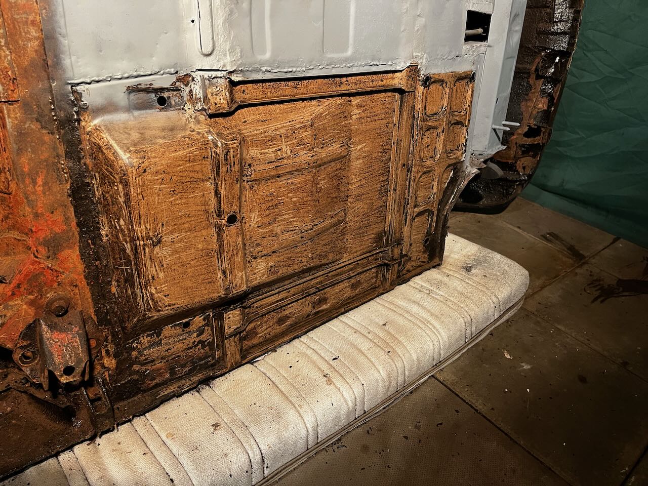

A final quick-fire update brings us up to date with where the car currently stands.

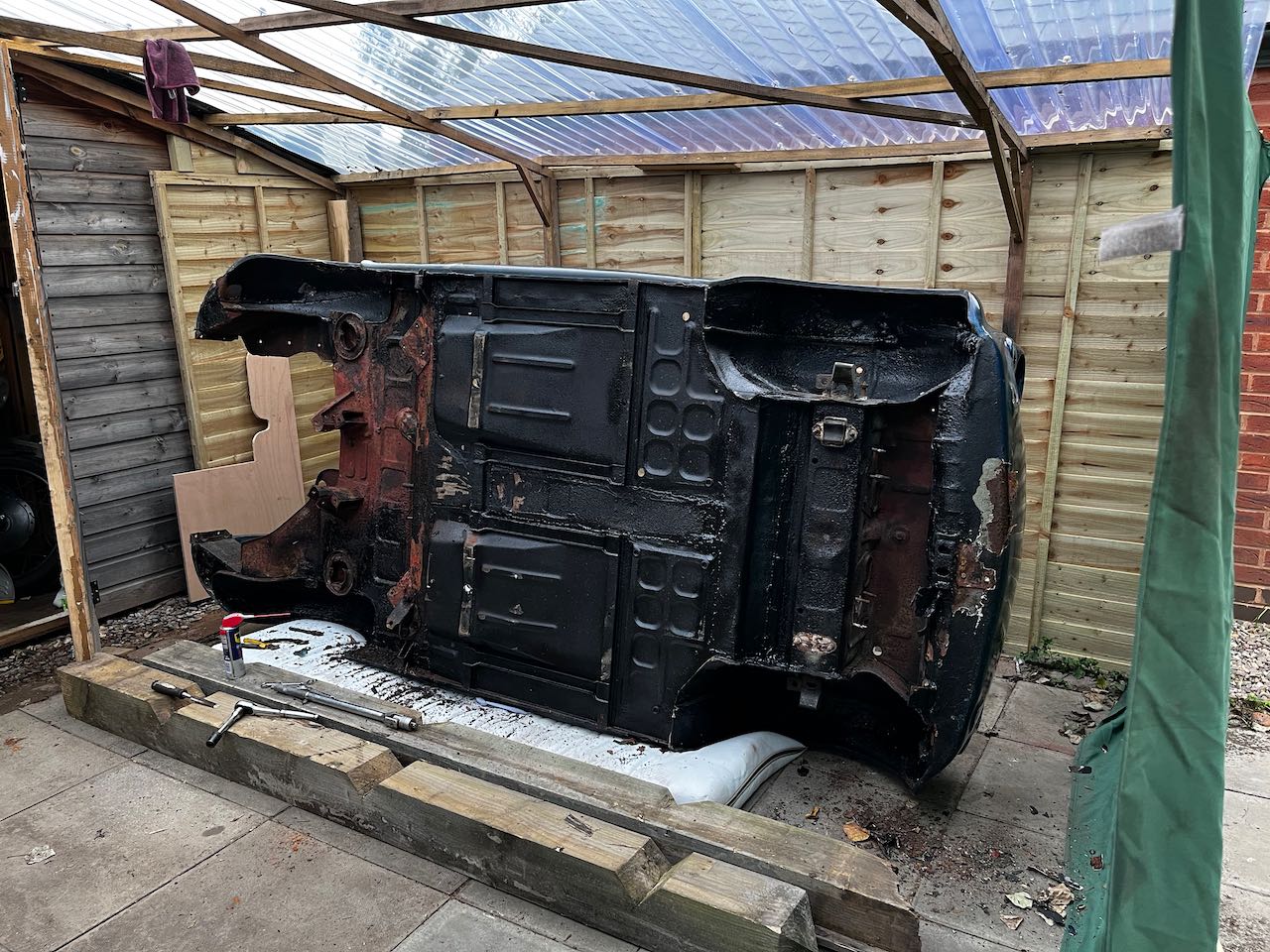

I decided to start underneath the car, to build on the strength in the floors, before starting to take larger sections the shell apart. After the Daimler I swore that I didn't want to do another major restoration lying on my back under the car. So when I bought this project I had a mind to buy / build a rotisserie...
But while reading about 500s I saw several builds, including a couple on this forum, where instead the shell was just flopped on to a mattress. It seems kinda crazy, but when I felt how light the bare shell was it seemed worth a shot. As it happens I had a spare old mattress waiting to go to the tip, so I had nothing to loose! It was easy enough to roll over on my own and I've got great access to the underside now.
I started by investigating the large ugly patch at the front edge of the floor. As expected, when I cut the patch off the rotten original floor was still there. It is typical of the patch repairs on this car, where there should have been two layers of metal welded together in several points to create a box section giving the front of the floor some strength, instead there were 4 layers overlapping each other and not joined at the critical stress points.
So I removed the two original rusty layres, exposing the underside of the new floor and leaving it ready to make a patch to the toe board / bottom edge of the front bulkhead / whatever you want to call it!
At the same time I started the laborious task of scraping away all the old underseal. I'm using a sharp chisel to scrap the worst of it off then running over it with a wire wheel to finish and giving it a quick coat of primer to stop any corrosion starting. I've got about 1/2 the floor done and will keep chipping away it as and when I've got a few minutes.

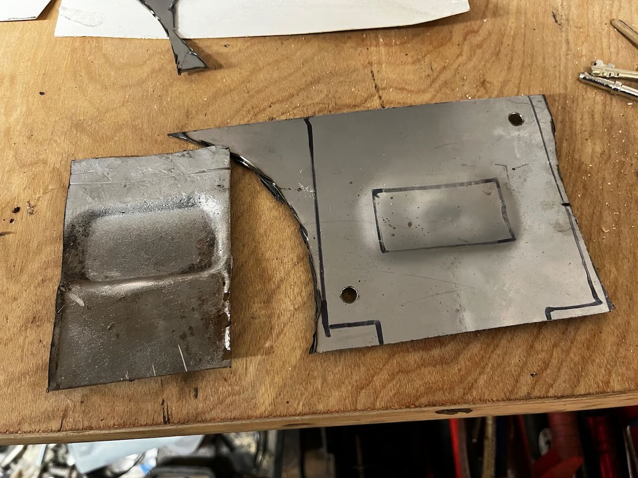

The next bit of new metal to go in is a small patch to the centre of the front of the floor. I wanted to try and replicate the factory pressing.
I tried cutting out a little plywood form and using my press, but it wasn't really strong enough, you can see in the attached picture of the original floor and my test piece that the edges are much too soft. Still the shape was roughly right ,and with some clean up with a hammer and blunt chisel, the final patch came out nicely.
With that patch welded in, I could now rebuild the bottom of the kick panel. Sadly it was just a couple of inches too wide for my little metal folder, so I had to make it up in two halves. Still it came out fairly well and is a massive improvement over the previous repair.

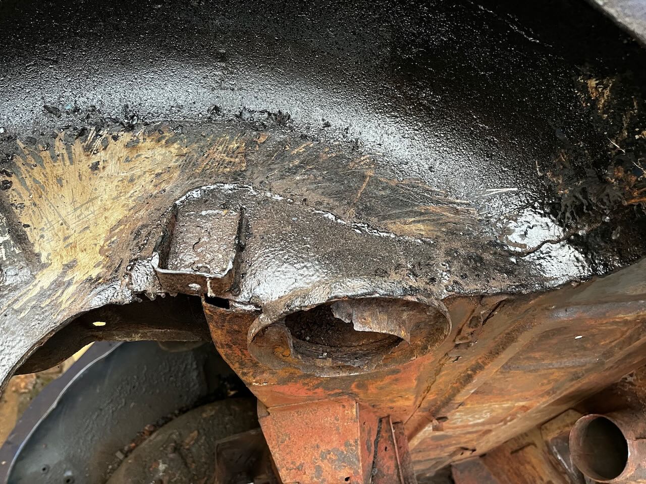

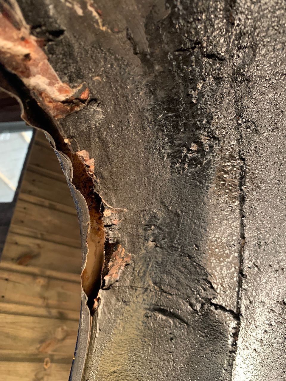

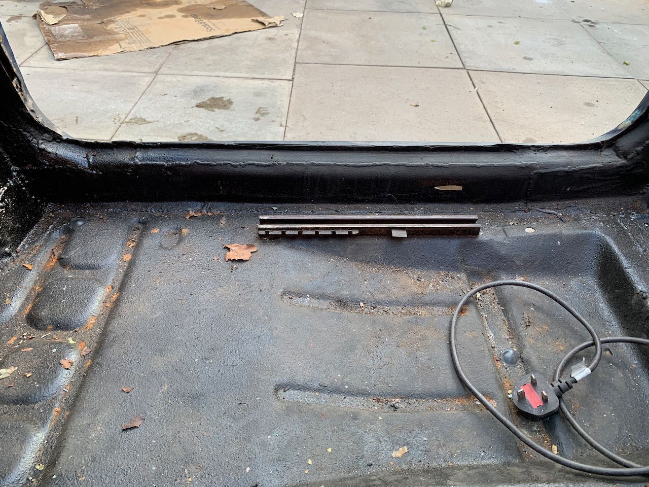

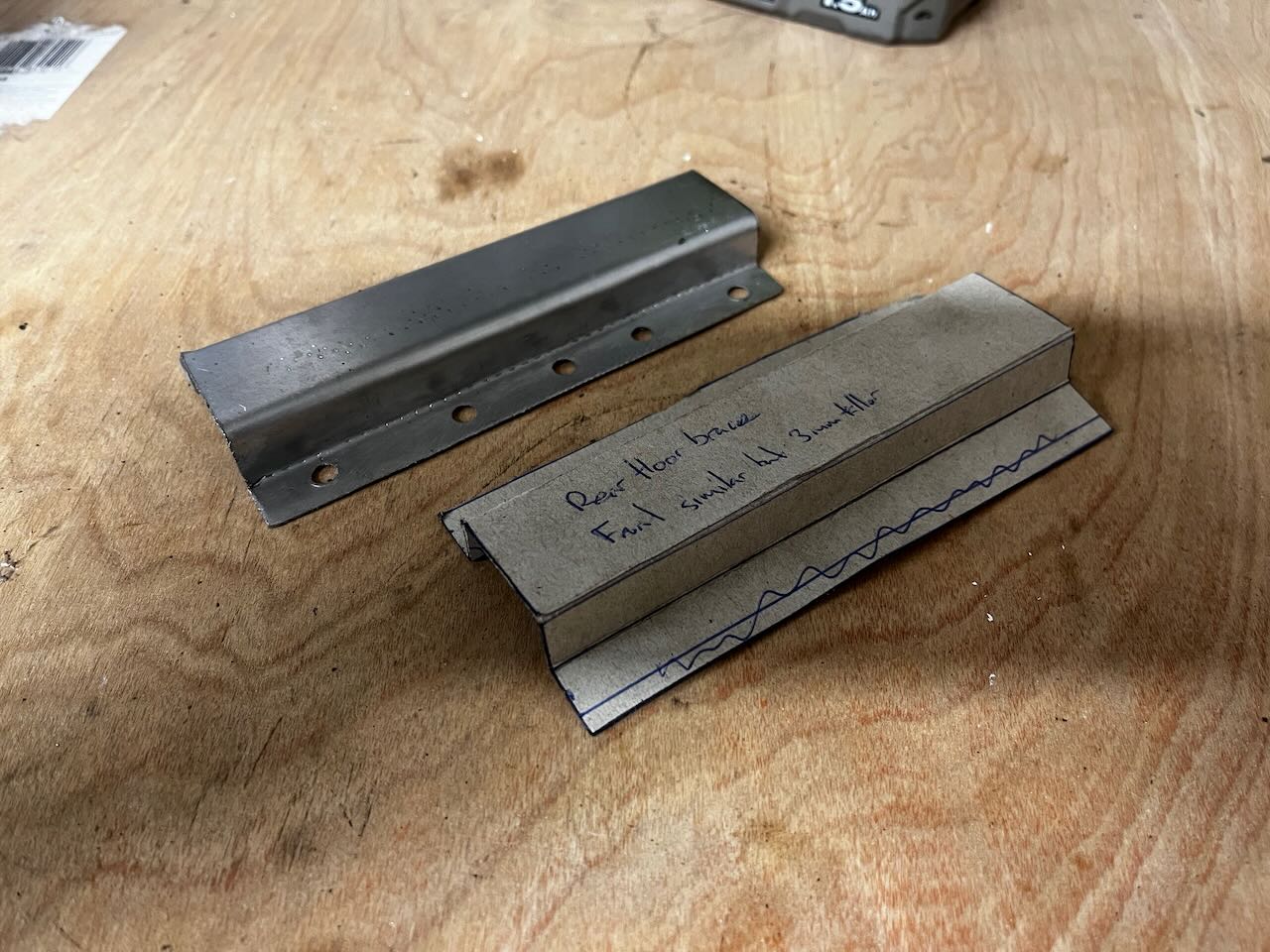

I have been making some more progress in the past few days. While the car is on it's side the next problem area to deal with is the rear spring mounts.
As you can see in the first picture, there was a nice ugly MOT patch over the top (not very well welded as large chunks of the weld just peeled back when I went at it with a chisel), the bump stop bracket appears to be a couple of inches away from where it should be and the actual spring platform itself is rotten through. So out with the grinder!
I ended up chasing more of the rear seat pan back than expected, but its a simple enough repair. You can now also see another reason why the original patch was poor, there's lots of layers of the inner structure of that rear crossmember that should be welded to the wheel arch, but were in fact just welded to the rusty remains of the original arch under the patch and as such were adding no strength.

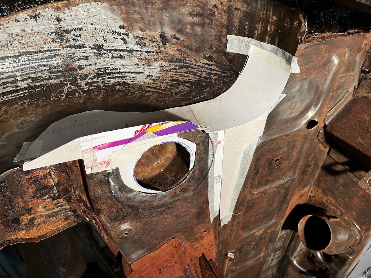

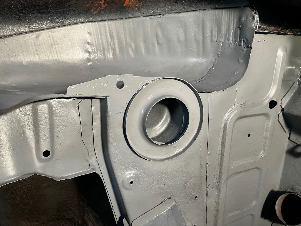

Now I could see what I needed to rebuild, lots of cardboard templates was the next stage.

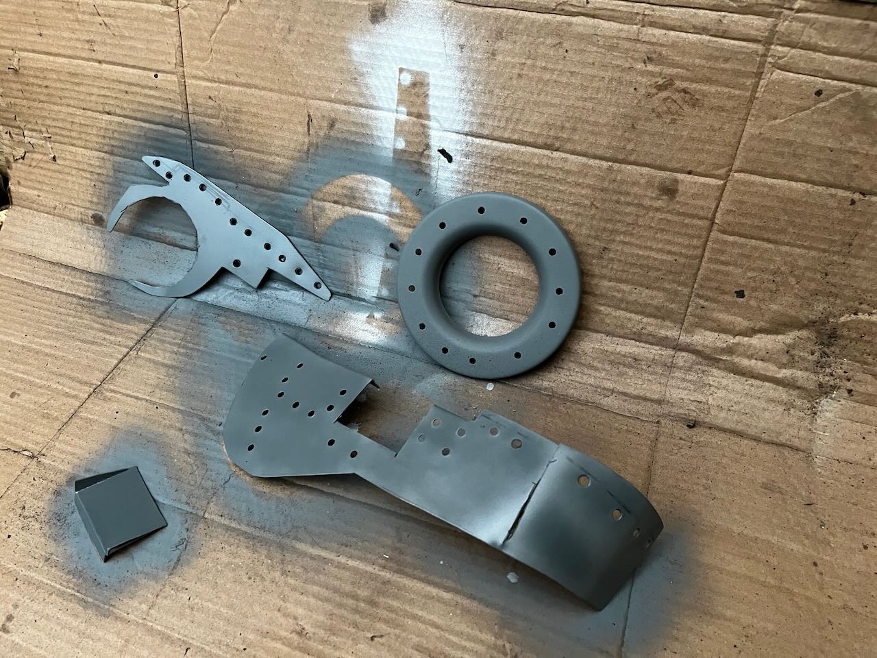

The old bump stop bracket wasn't salvageable, and given that it's a pretty simple construction, I decided to just fold up some replacements. The guys from Project Binky (a great YouTube build of a crazy mini with Celiac GT4 running gear if you've not seen it!) would be proud of the bracketry! :p

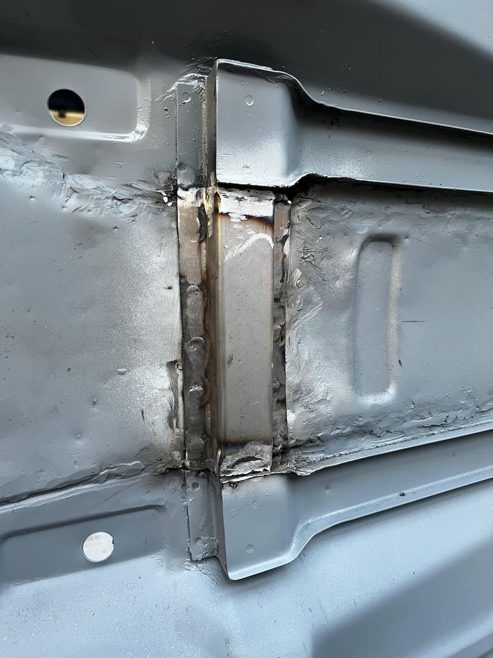

I then got all of the card templates transferred to steel, cut out, drilled for plug welds and given a coat of weld through primer. You can see just how many plug weld points there are in that wheel arch patch! Should be back to full factory strength in that corner.
Lots of welding later, and thats another good chunk of the underbody welding ticked off.
In the last photo you can see I've started cutting out for the jacking point repair, which is the last bit of underfloor work on this side of the car. The passengers side rear spring mount and jacking point needs all the same work, but I think I need to roll the car on to the other side to get better access to it.
I've also got some repairs to do in the front wheel arches near the spring mount/cross member, I'm trying to work out if I'm best tackling them with the car on it's side still, or better waiting till its the right way up and doing them when I deal with the rest of the front end metal work.

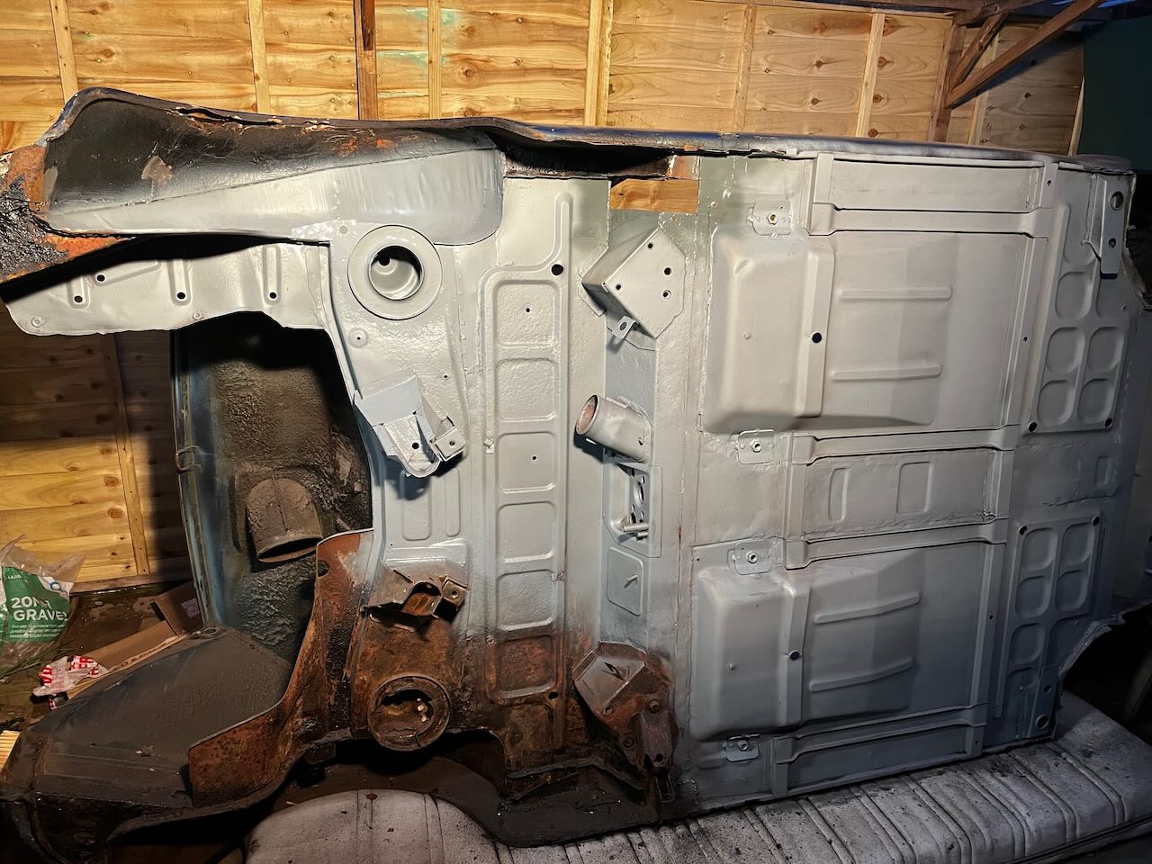

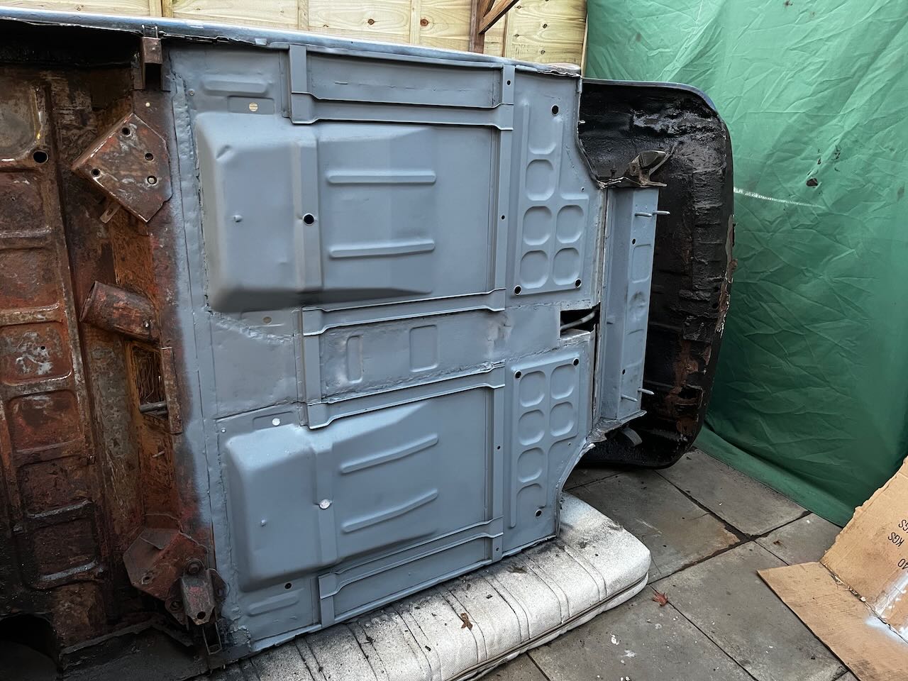

Life has been a bit busy, so not much has happened on the Fiat, and I’m only just getting round to having a browse of the forums and doing a few updates!
Picking up where I left off, a few days later I received a new jacking point in the post and it was pretty simple to weld that on with a couple of small patches to complete that rear drivers side floor corner. It was nice to get that jacking point off and see another little area of the car fully repaired.
The last major underfloor area to do was the passengers rear spring mount. I was able to turn the car over on to its other side with the help of a friend, and was faced with almost exactly the same mess.
It’s a bit boring doing exactly the same repair on both sides of the car, but at least I knew how it would layer up and where to start. I soon got it cleaned off and had the rust cut out and made a near identical set of repair sections to the other side.
The next evening I started welding them in, and was making steady progress…
… at which point my wife went into labour. So tools were downed and I’ve not had chance to pick them up again since!
So small Fiat has to take the backseat for a bit, but I’m hoping it won’t be too long till I can start grabbing a few minutes here and there to go out and do a bit of work on it. Part of the plan when I purchased the car was that it would be something I could just potter at slowly when I had some spare moments, and something to escape to once in a while once the small people were born. So it’s going to be a slower build and I’m just going to try and enjoy each session working on it for its own merit, rather than racing towards the finish line like I normally would :)
