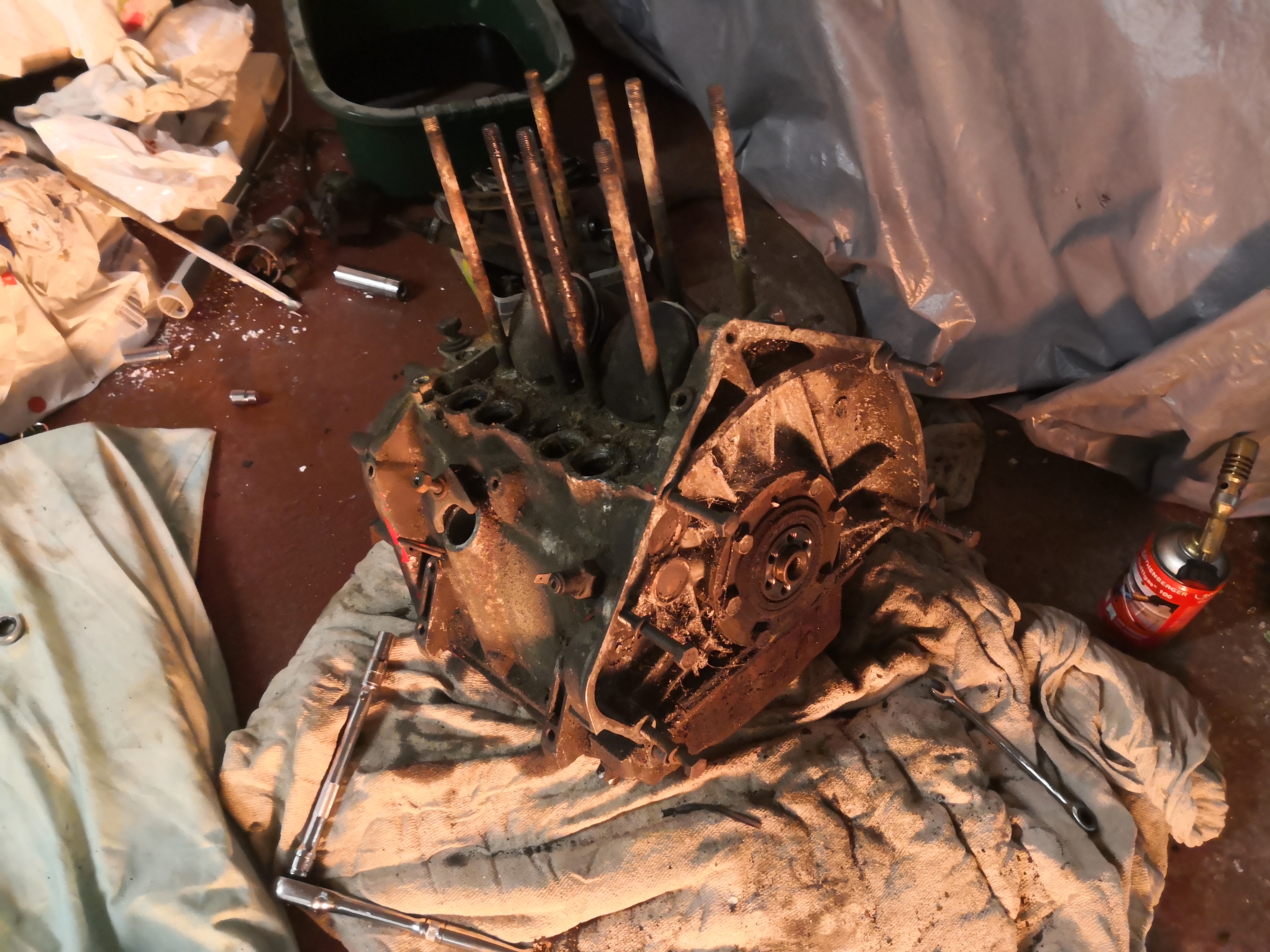

On my day off I began to strip the engine right down and inspect the wear as you can see below a new set of big end shells is required. But generally good condition on wear

Well done, and thank you for the pictures. The 'freebie' seems to be in good condition. You are absolutely correct--the car is there to put a smile on YOUR face---if it puts a smile on other peoples faces, that will be a bonus. Don't be afraid to ask questions, even if they seem 'silly', we are here to help.
Don't discount the 600cc engine (a Mk1 '126' unit)---they can be tuned and make very good replica "Abarth 595" engines and if used sensibly, are pretty well unburstable. Are you intending to leave the 650 engine standard, or are you planning to 'improve' it?

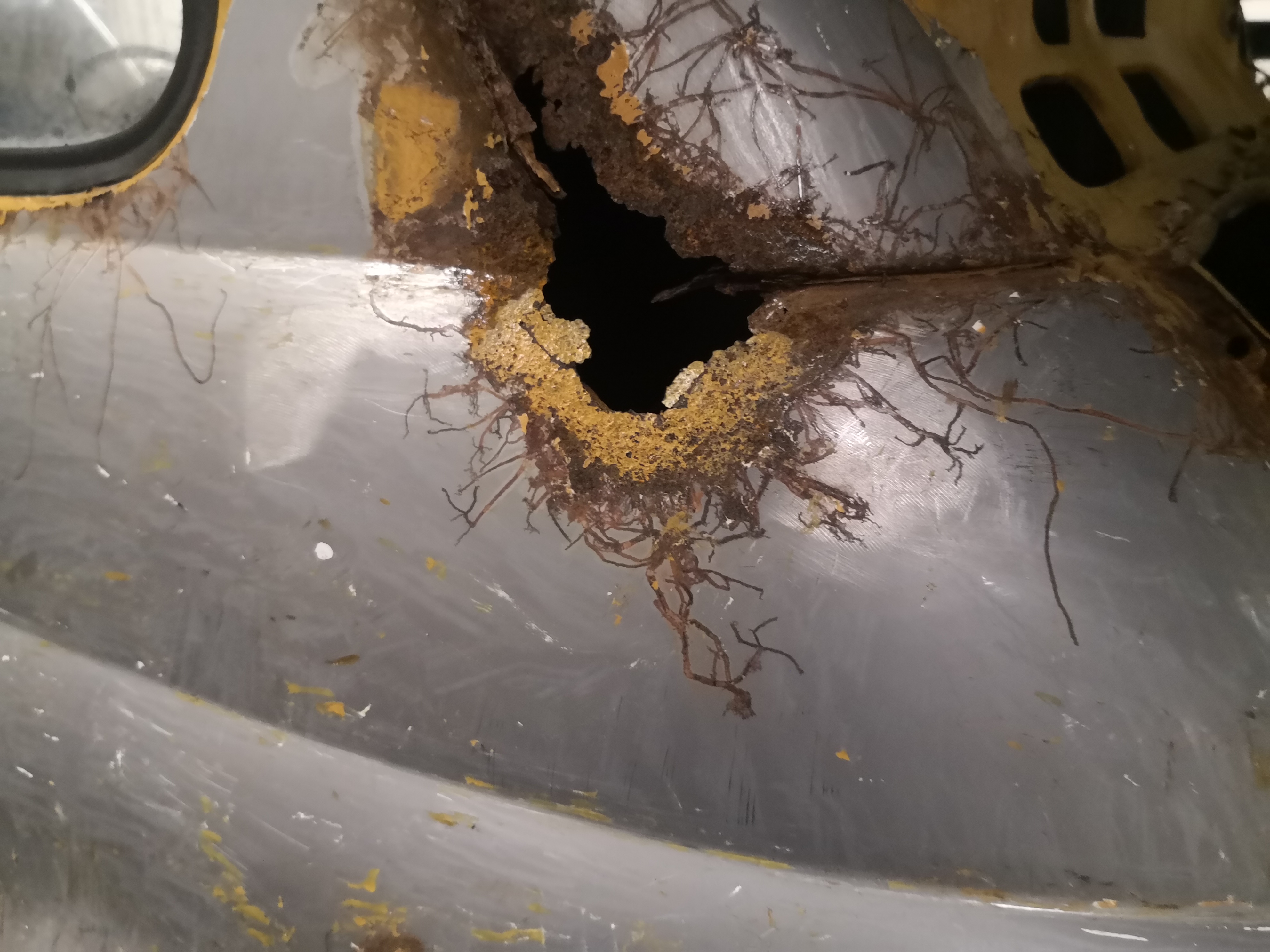

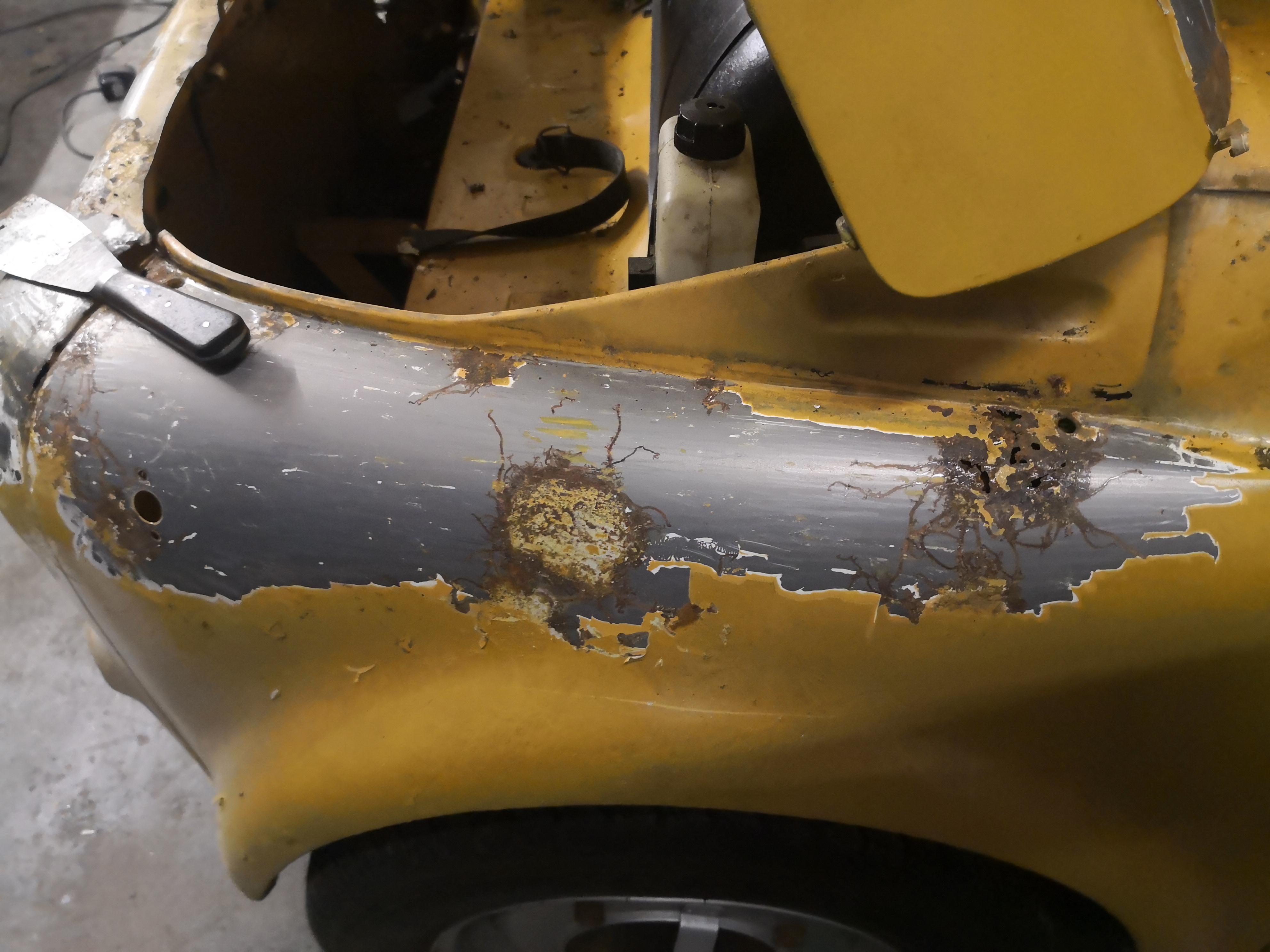

Some progress has been made with the body work, with the paint removed we can see the metal underneath isn't as bad as first thought which is great news.
