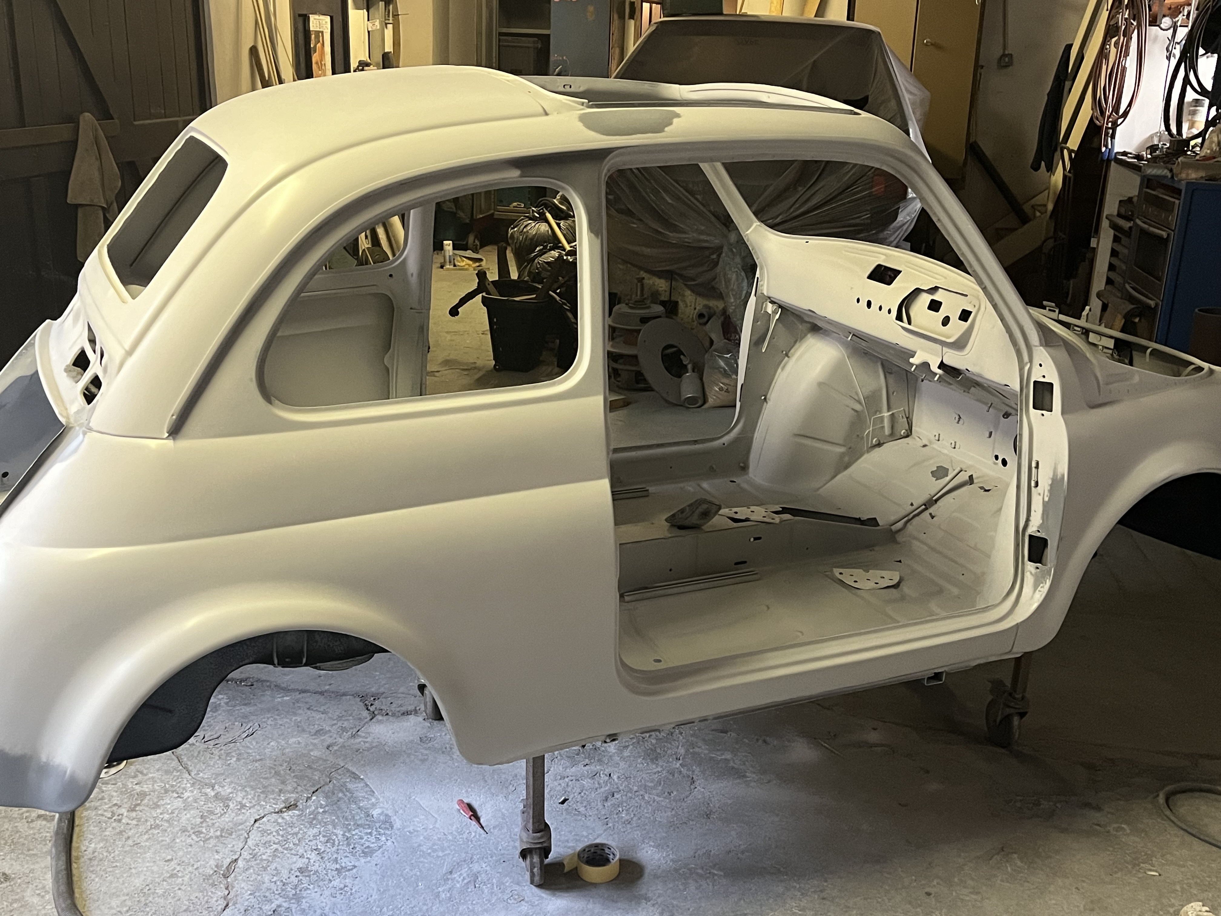

Having dug out my 500 recently after a very long time dormant (20 years since I did the panel work) I’m feeling motivated. I’ve painted the bolt on panels and today started applying some to the shell so am starting to get some thoughts towards building it up. There’s a couple of problems on this front, firstly the huge gap since I took it apart and the unfortunate fact that a lot of the parts were lost in a fire where they were stored some years ago. I’ve sourced some of the more crucial parts over the years and have spent a fair wedge recently on new stuff. I think I’m dialled in on what needs bought but its tricky knowing every small bit I'm might or might not be missing, I have tried sourcing a parts book but as yet had no luck, out of stock seems to be the theme. Does anyone know where I might buy one? or maybe an online link? I’d much prefer a paper copy.

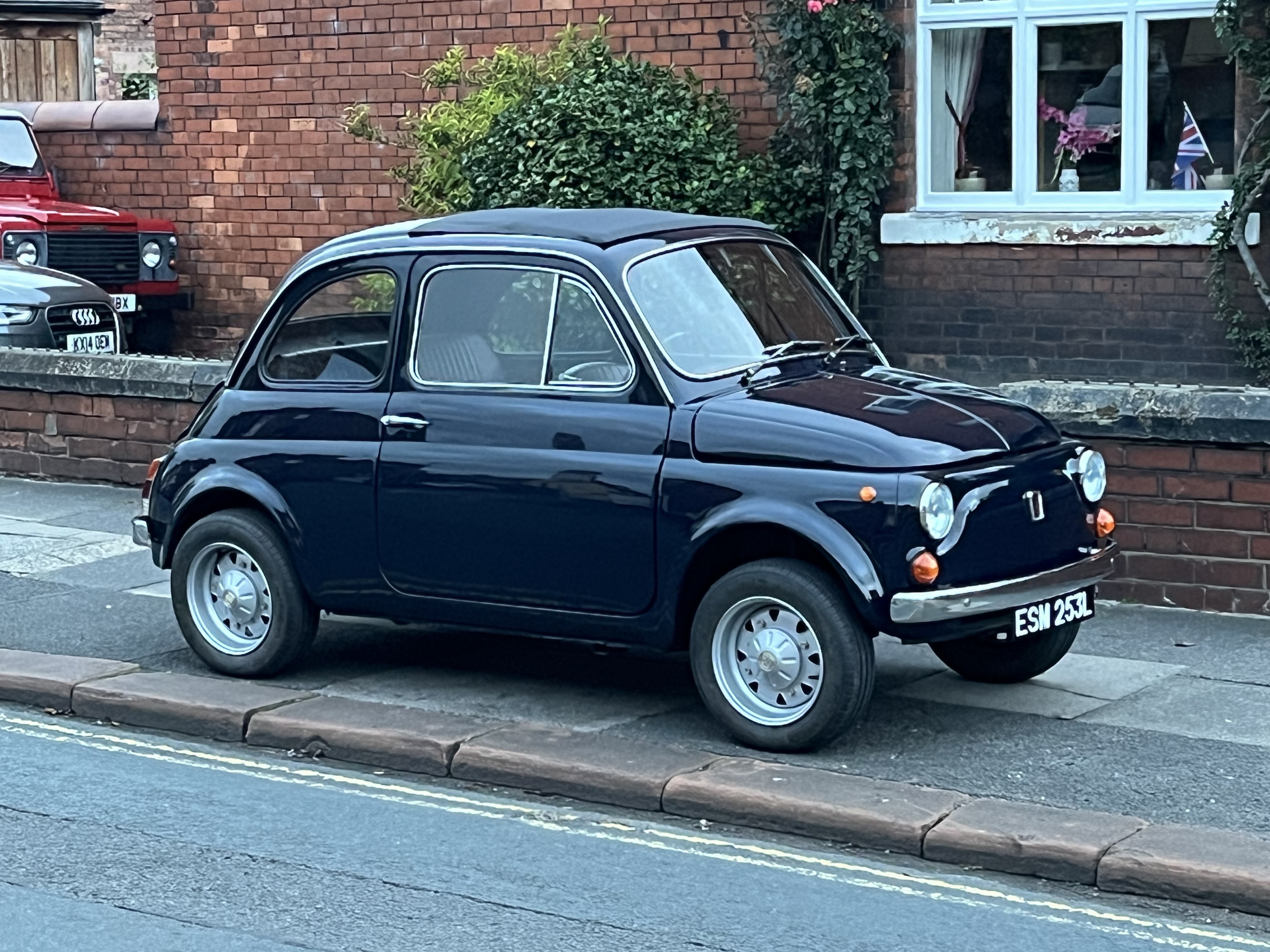

Today’s post is inspired by Malcolm having a trip out on the open road yesterday, his first journey in 40 years! All seemed reasonably ok, the suspension geometry needs looked at but now he’s mobile I can take him to my favoured professional who have the relevant equipment. I think I’ll have to rebuild the steering box as now it’s had a trip out there’s a drip, the folly of trusting all was well when I fitted it but being as it hadn’t done anything for so long the seals are likely rock hard. Has anyone had experience of overhauling the steering box? Any tips or advice would be greatly appreciated.
Anyway, here he is outside my house yesterdayView attachment 473916
He's looking great. Fantastic to be back on the road. What a pity that the cold, wet and windy season is on the doorstep.
