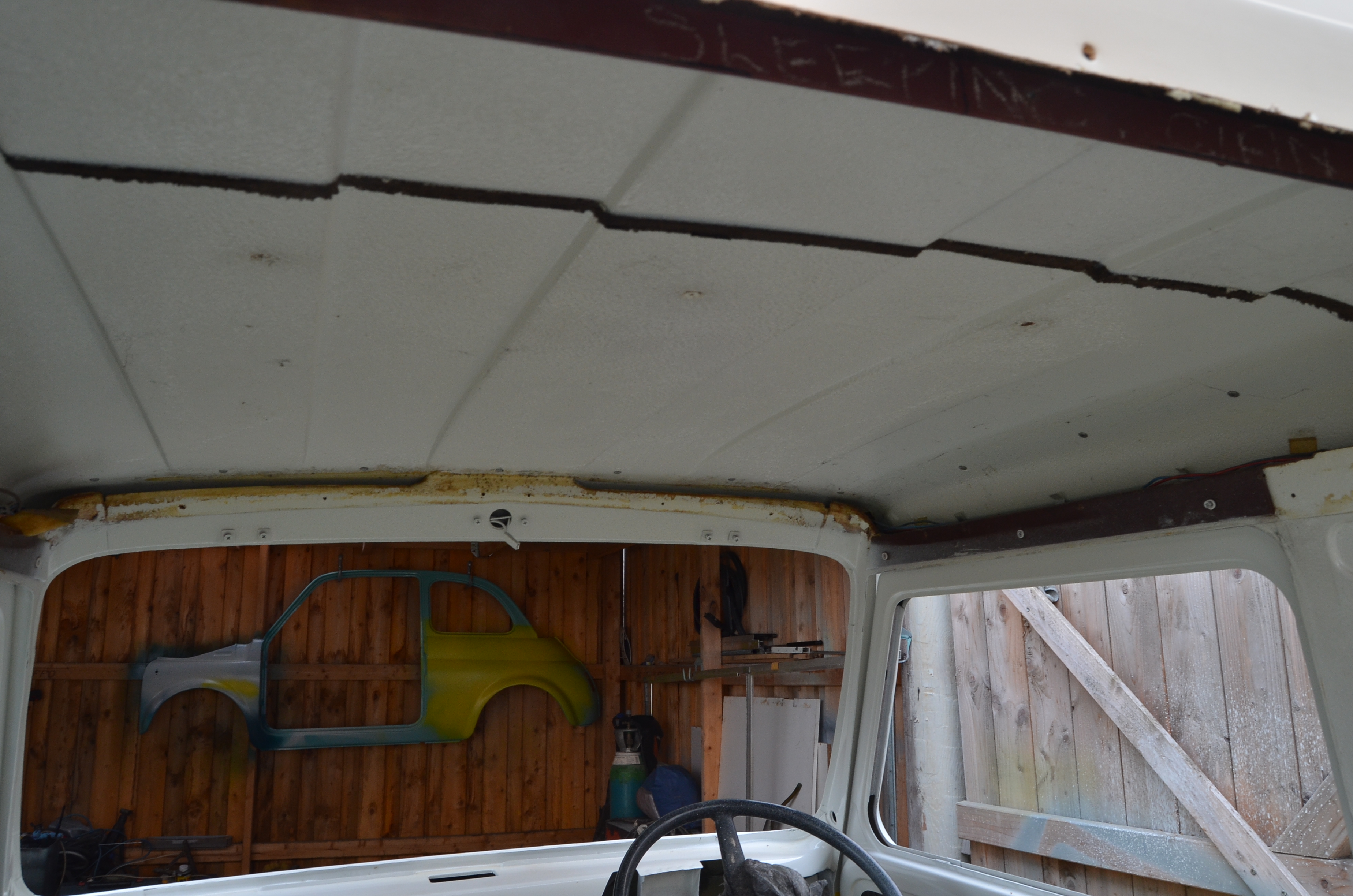

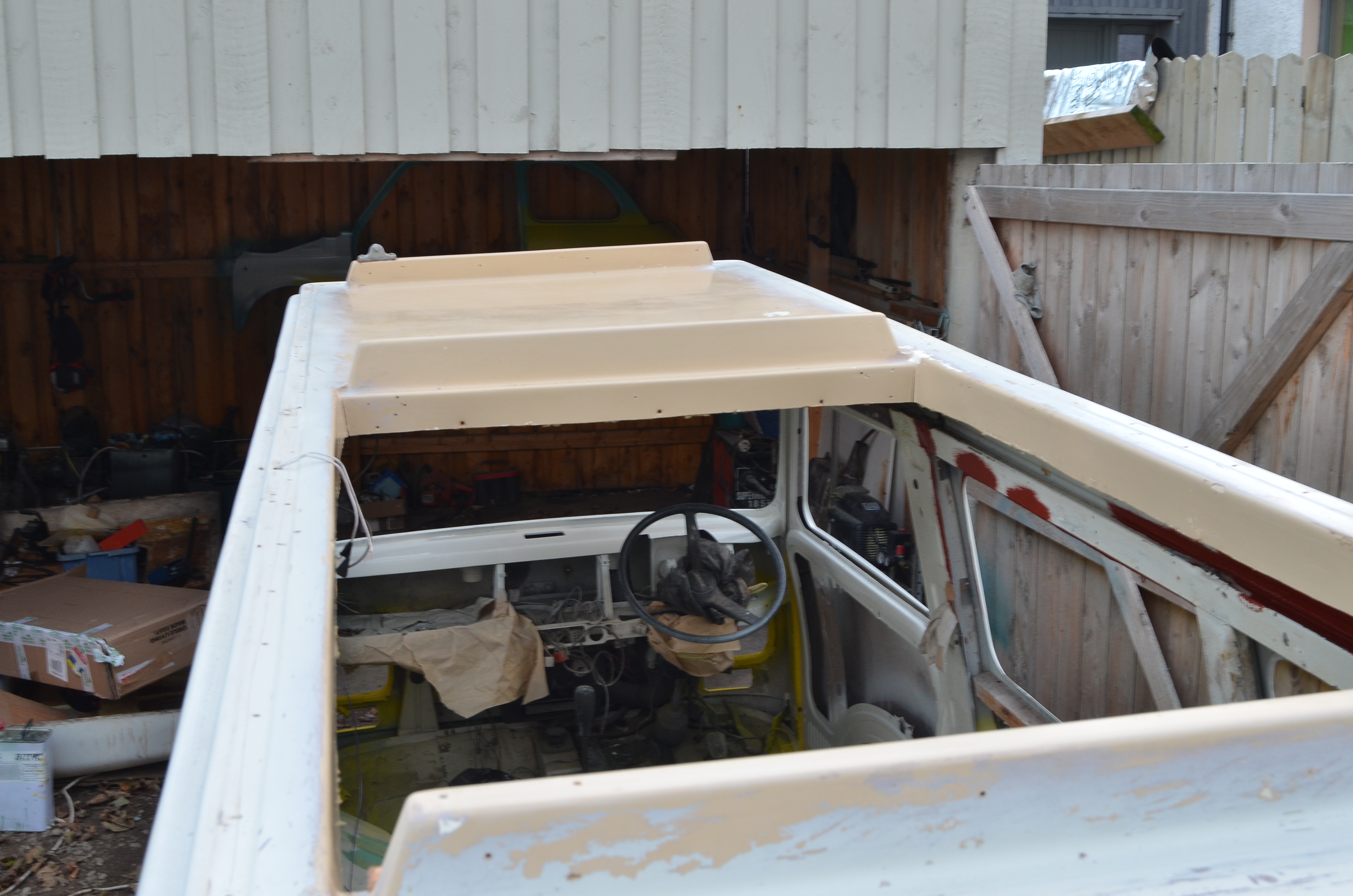

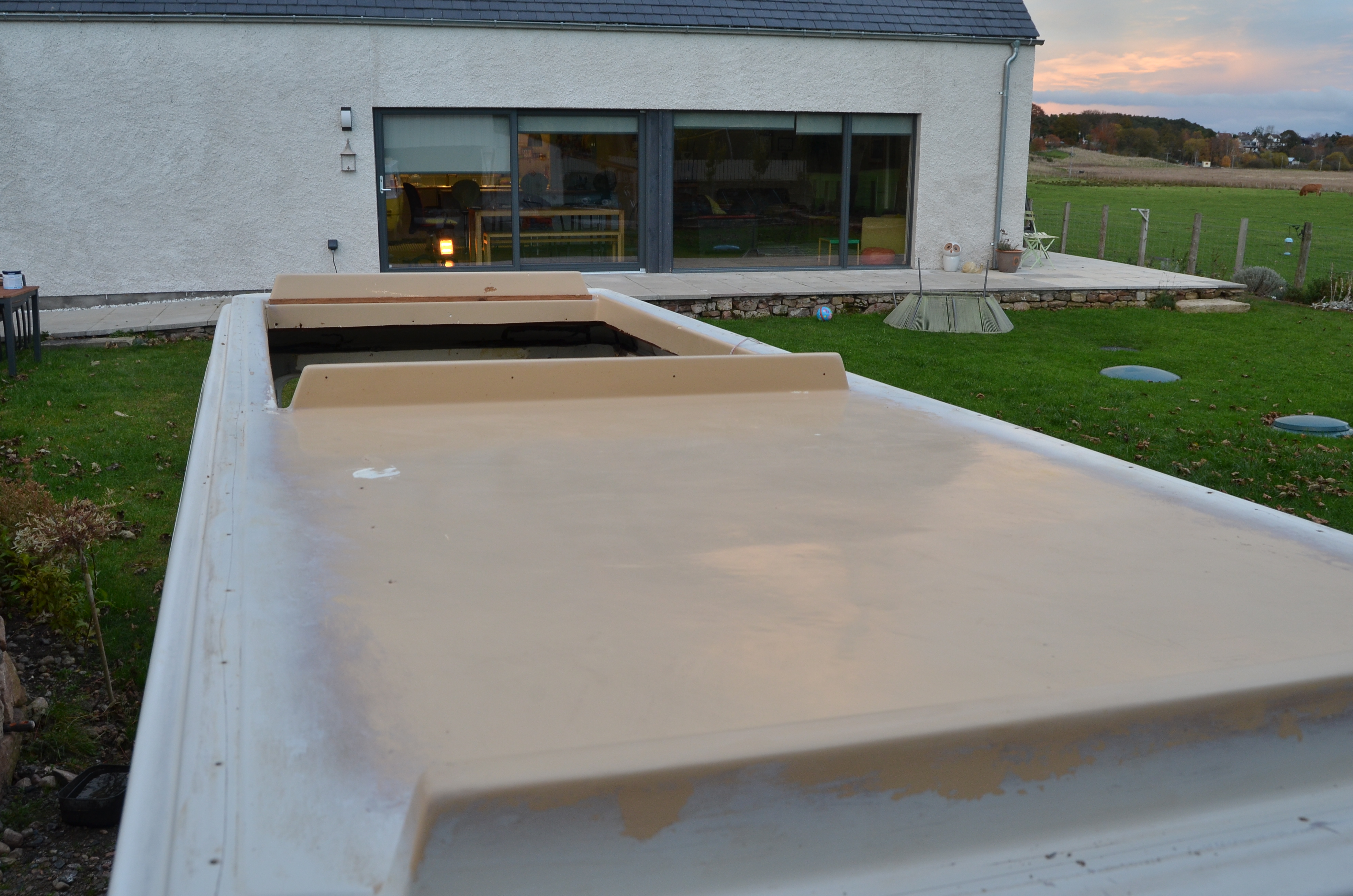

I hadn't intended to be quite as thorough as this but in removing the old "carpet" inside the roof I was left with a horrible expanse of old adhesive. By using a scraper, cellulose thinners and some stainless-steel wool I've got it all off so that I have a clean surface to start the re-trim.
Now I can see the fibreglass roof in all its glory I realise that it's an exceptionally clever and well made construction.
Having exposed the inner roof of the cab I'm wondering did these utilitarian vehicles leave the factory without a lining? The material was fitted in a very basic way like the rest of the campervan trim.

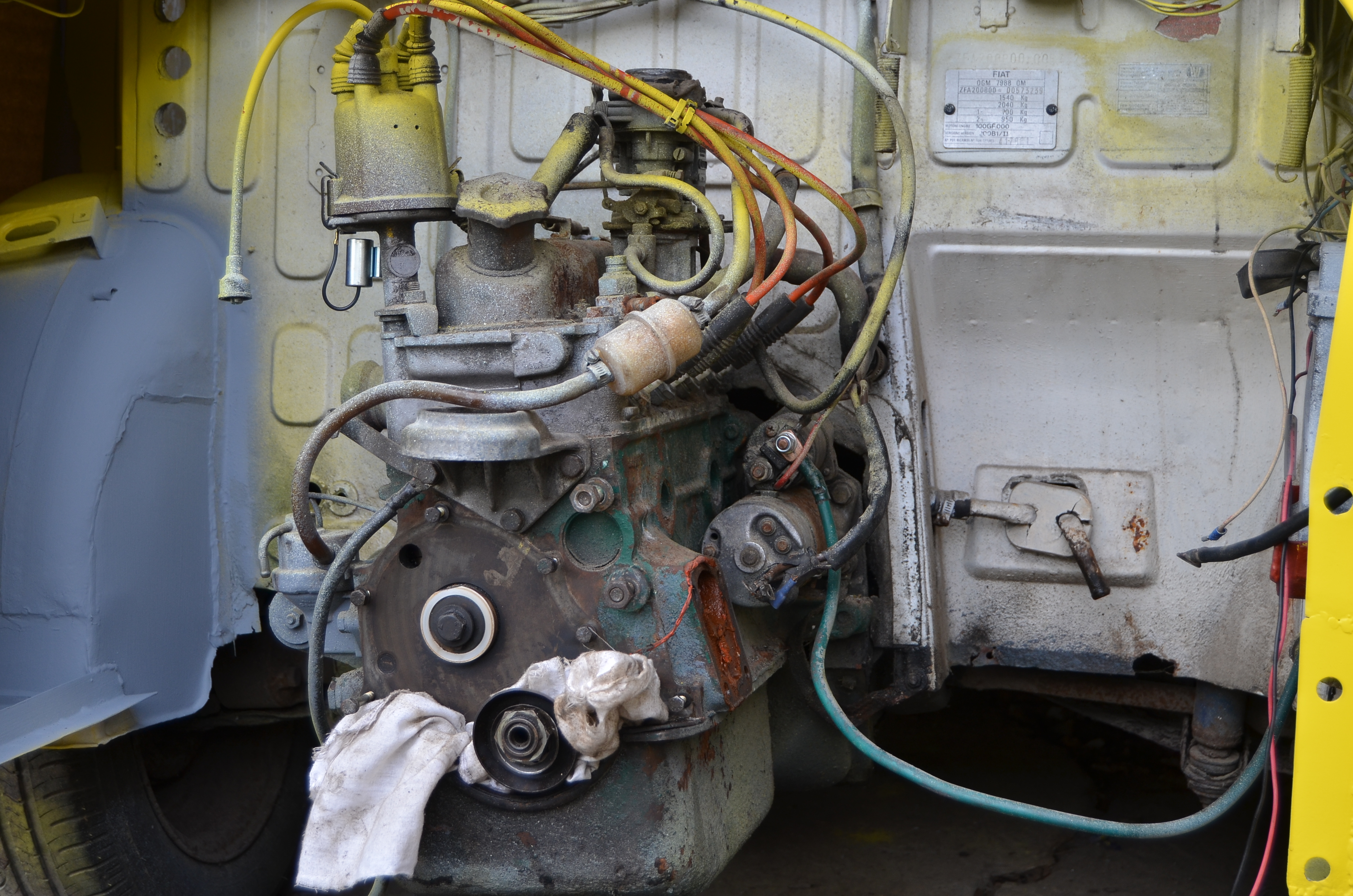

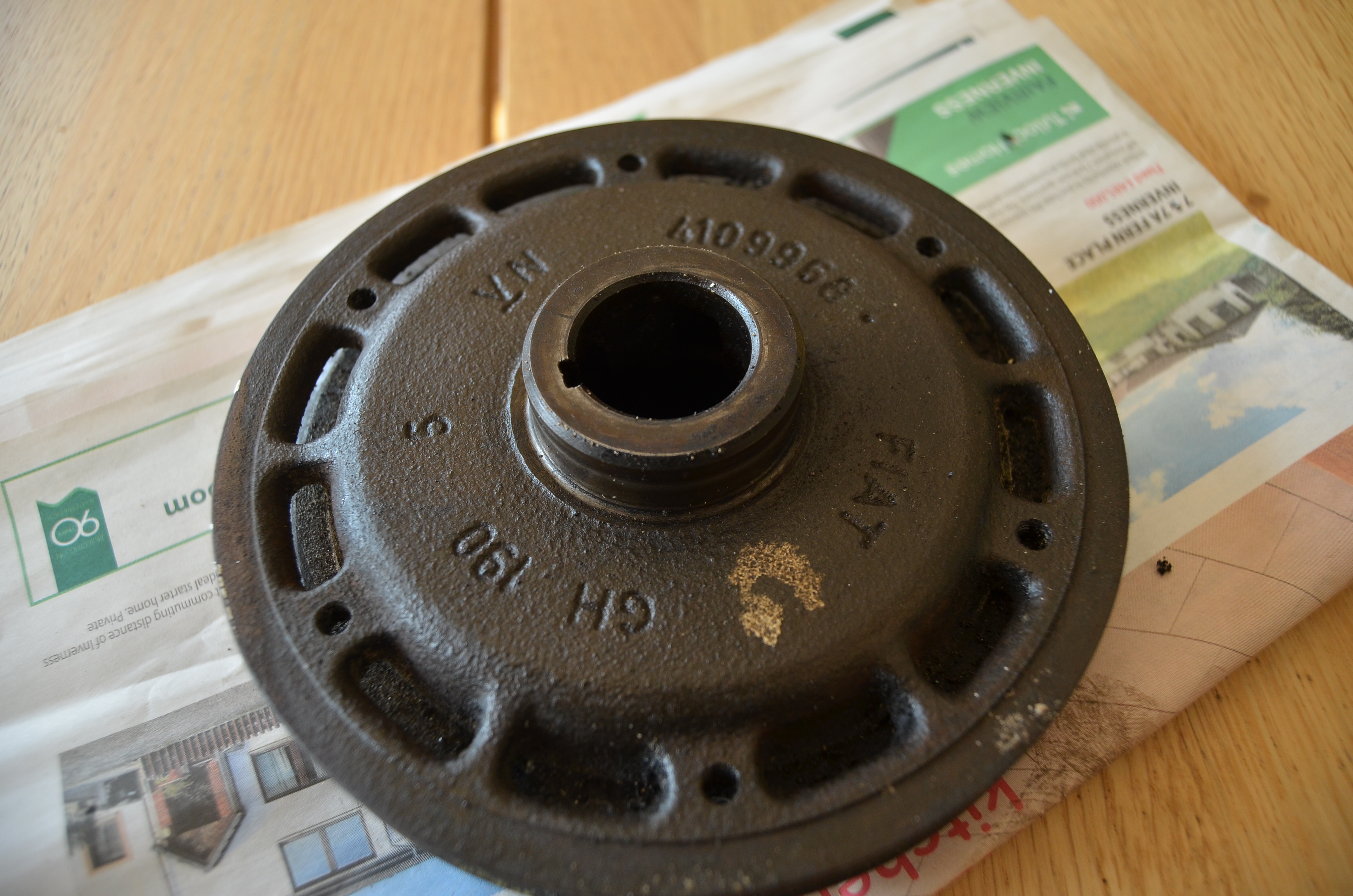

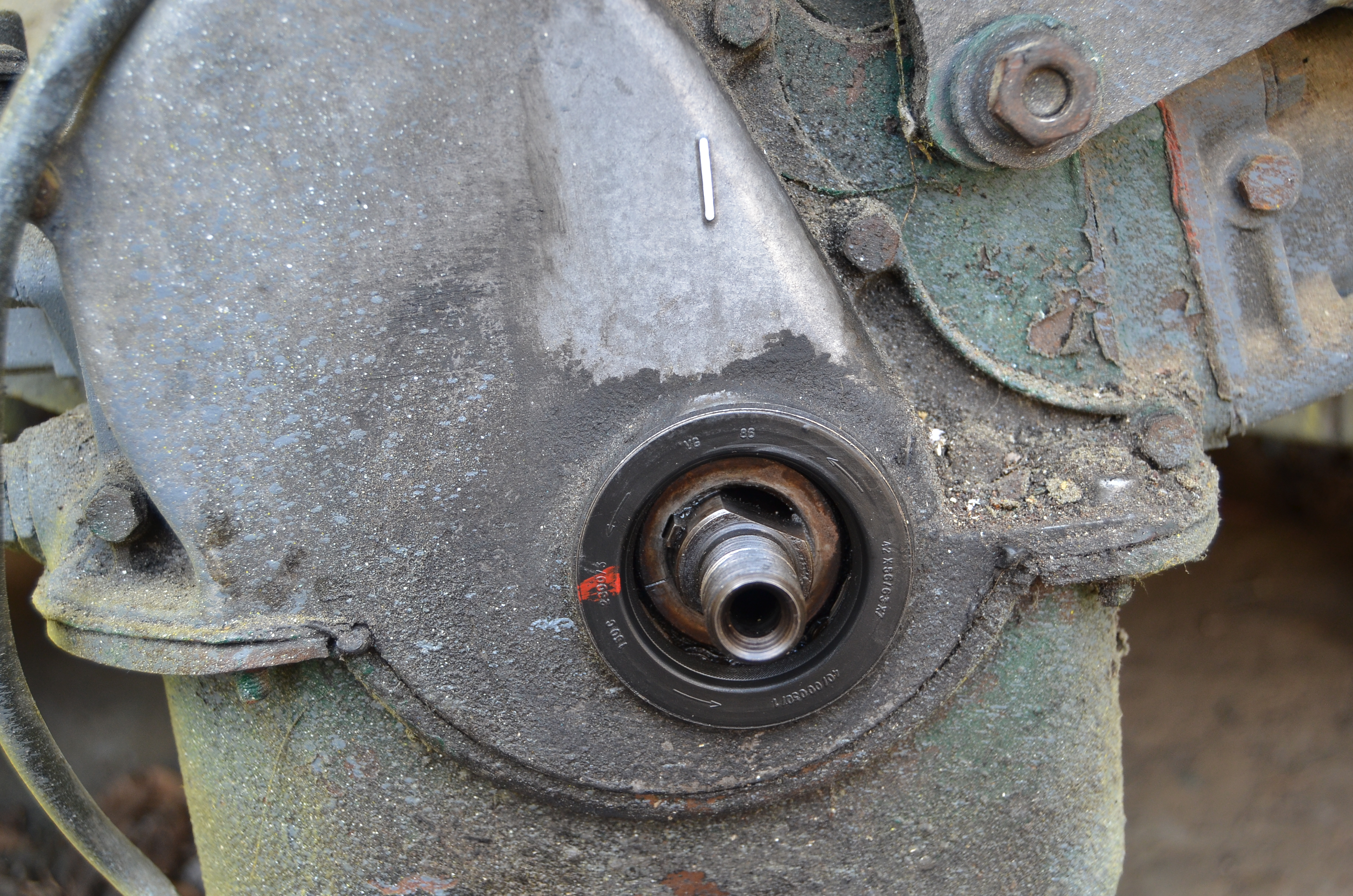

I've not abandoned the restoration but I have had a very busy winter with a lot of projects unrelated to vehicles. Today I reached the end of a very long list of these jobs and decided to get the van project underway again.
It's much easier to do everything when it's trundled out of the garage but since the engine has been immobilised it has become a very heavy lump to manhandle all the time. Getting the engine running again is a priority so I started cleaning and adjusting all of the distributor components. Then I looked at the ignition timing which is very straightforward for me because apart from the counterclockwise engine rotation the procedure it's just the same as on my Fiat 500. But in the course of this I think I have discovered that the crankshaft pulley is loose...possibly a worn keyway. It can be rotated a few degrees without any apparent movement of the crankshaft.
So the next job is to remove the pulley and get a look at it. New ones are available but it's an irritating problem I could do without.:bang:

Hi Peter
Regarding your pulley spinning when perhaps it shouldn't, its common on the 850 pulleys see the earlier posting with Gary getting his 900t going.
Its more likely to be the cast iron pulley has worn than the hardened woodruff key, normally 85% of the woodruff key is in the timing chain gear and 15% is located in the end pulley but sometimes the key can be located more into the gear, so you could find its a case of either repair/replace the end pulley or find a longer woodruff key and machine it to locate more into the pulley.
unfortunately the fiat 500 pulleys are different.
i hope this helps more than it comfuses
Tim
Thanks Tim...that's what I meant regarding the keyway; I've already noted that the pulley is fairly widely available on eBay so as you say, a known weakness. It would be handy if I could get away with a longer key and obviously I'll get it apart over the weekend and report back.
After dismantling I am relieved to be able to say that it's not a faulty pulley; it's a very worn timing-chain which is actually scraping on the inside of the cover.
It may as well be fixed properly now I have it all apart. So now starts the task of scouring the Internet for the spares I will need. Basically everything I touched that is a wearable part...timing-chain and sprockets, belts, contact-breakers, condenser gaskets and front seal.
Getting up close to the engine I noticed that the throttle cable has a lot of slack at its connection to the carburettor; the engine would have been falling short of full revs....not good for such an underpowered vehicle!

Hi Peter
Out of interest what mileage is Bluebell/Buttercup?
I.e. is the problem due to high mileage or just unlucky.
While you are checking out the accelerator cable it's also worth checking the choke as well. These are much easier to replace if the engine is out... as I found out after the event (the choke cable snapped/rusted off at the lever end, by the gearshift the first time I tried to use it again on Connie).
I've also bought a new throttle cable, as the existing one seems a little stiff - probably due to lack of use. However, the cable I've bought doesn't appear to match what's underneath the van :confused:
Has anyone fitted a replacement accelerator cable? and if yes any tips/photos?
Hi Peter
Hi Gary, the mileage is around 83,000 and that didn't seem to change much over the final three or four MOTs. But I think that's academic as the engine has been changed not long before I bought it. So I assumed it would have been replaced with a good 'un and it certainly shows a fair amount of gasket-goo and other signs that someone has been "at it".
I guess it's had a hard life although after a careful check, the sprocket teeth don't seem worn despite the state of the chain.
But one interesting point is that the cylinder-head is aluminium whereas I thought they were cast-iron; I have a spare cast-iron one which came with the car. It also came with an extra carburettor which I will need to check out because I suspect these items were included because they will be the originals before the engine was changed. The engine block reads "100GBC and I think it should possibly be "100GF". The carburettor is also different from expected being "30ICF15" rather than 30ICF20/250.
I don't know if this change is for better or worse than standard but it appears that it may be at least a part of an earlier engine of a Sports model which has an increased horsepower in comparison with the 100GF.
