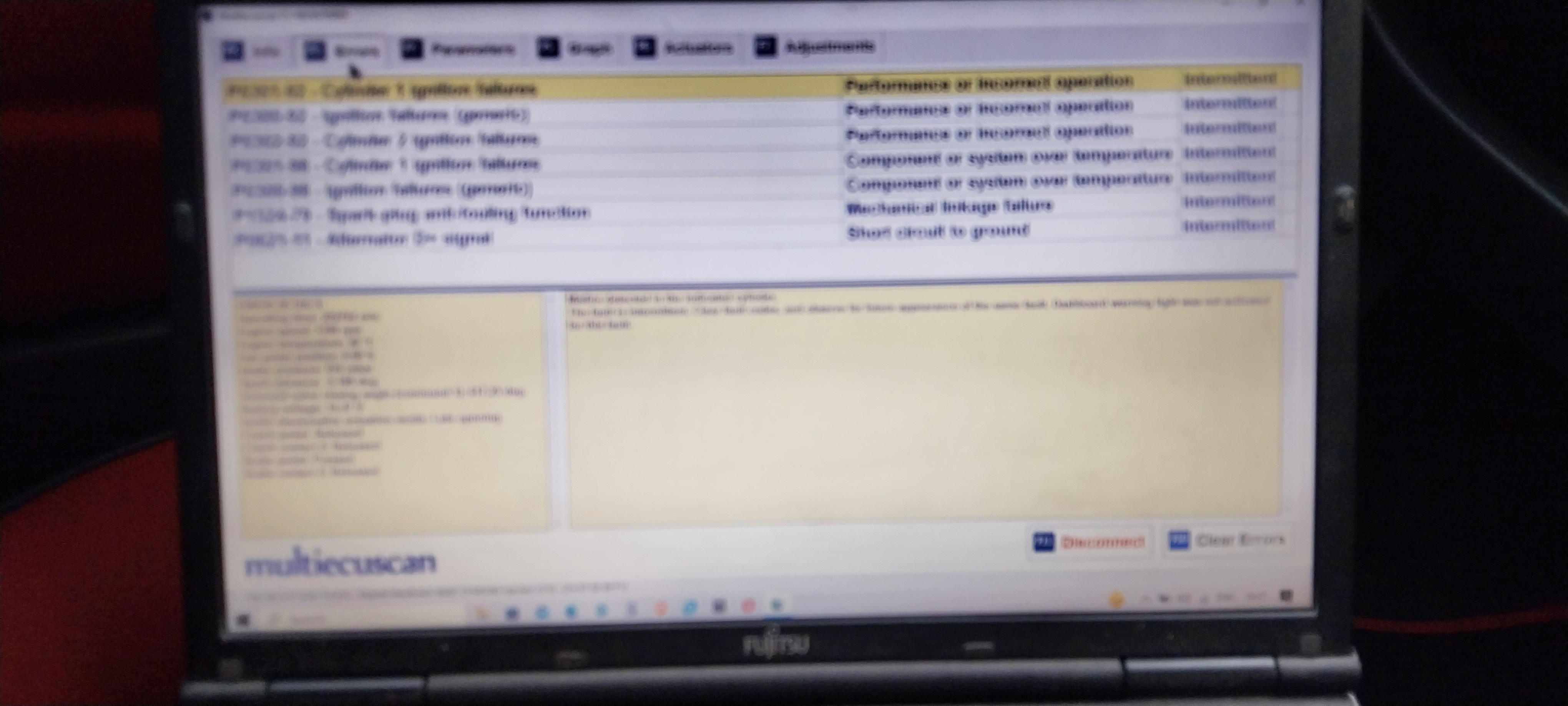

Update.
Press clutch on throttle, starts straight away. Idles ok for 15 seconds, then feels like it misses on one cylinder then ok for five seconds and it feels like it is missing again. leave it for another 20 seconds and it runs fine. If I touch the throttle at any point during the first minute it will die and will be a sod to restart ( throttle pedal floored cranking for 30+ seconds). I have noticed the interior and running lights flicker in time with the miss fire. So far I have replaced the battery, maf sensor, map sensor, clutch switch and injectors. I have also cleaned the battery connections. Does anyone have any idea what is causing such a drain on the battery to make the lights flicker when the apparent miss fire is happening. Once she is running it doesn't miss a beat. The only other observation is the start stop works one minute and is unavailable the next
The default setting for ANY electricial issue is that blinking earth cable to test without replacing it you can use a jump lead cable! connect one end to the neg battery terminal and the other to a sound earth point on the chassis! then do the start up procedure you mentioned and see what happens if the drain issues DONT occur thats pointing to the earth cable for sure!
thankyou for the information
Also if your car has Blue&Me and it goes faulty, it can cause a permanent current drain unless you physically disconnect the connector to the B&M module. This is a very common issue.
If the mileage isn't flashing, it's probably ok🙂
At last something. But where to go now
