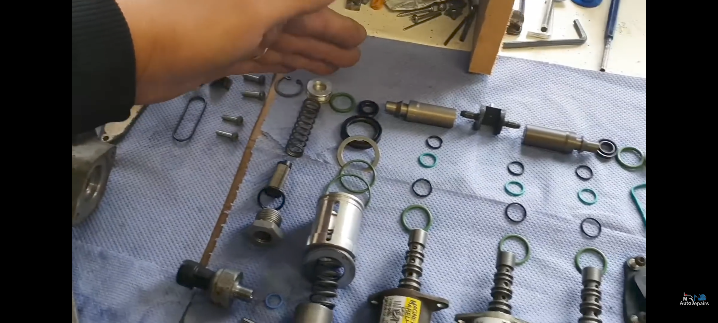

It would appear that the garage is proposing to replace one obviously faulty seal, top up the selespeed fluid and reset the fault codes. With luck, this might restore normal operation of the transmission for a short while; long enough for you to sell the car. It also suggests the garage does at least have some idea of what they're doing.
The collective experience of this forum is that this kind of repair won't give a long term fix; that would need a reconditioned actuator to be fitted, which would likely cost somewhere in the region of £1600-£2000.
Can i ask why replacing the seal isn't a permenant fix? Why is it a sign that the actuator is going to fail? I'm just trying to understand the situation as much as possible.
There are many different seals in the actuator, and the failure of any one of them can stop the transmission working properly. By their very nature, these seals wear over time, and the material which seals are made from degrades with age. So if one seal has failed, the chances are that other seals may be close to failing.
The collective experience of others who have posted here is that once one seal has failed, only a complete overhaul of the actuator with the replacement of all the seals and any other worn parts will provide a lasting fix.
Read the linked thread for some real world stories from others who have experienced similar issues.
Cool, thanks for explaing. I'll take a look at the thread.
A small amount of weeping is acceptable and there are drain holes built into the system for any bypass oil to return back to the reservoir
If it excessive it can't cope and escapes out of the sensors, loosing oil and a problem with neutral sounds like this is the case
If this is the case there no simple fix,

You could buy all of the parts and equipment to fix this yourself for much less than that, and it'd be not so difficult. Although you'd struggle to fix the dualogic ;)
It ended up having a split diaghram in some kind of ball in the gearbox as well, not sure what the part is called. It cost me £800 in the end, including the wishbones 😭 and it's still got some other little issues but at least it's starting well 😊 and i made some new motorbike riding buddies out of it, so not all bad.
Cant have to many biking buddys!
Sounds like the Accumulator
