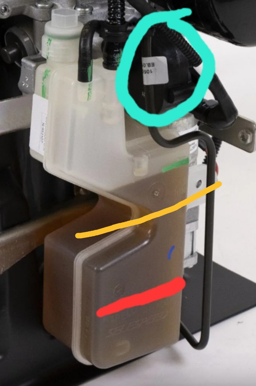

So, just to clarify in case I've been misunderstood, the leaky gearbox is causing it to lose pressure when left standing for 8 hours or more and then it's struggling to find N when i got to start it.
Also, i believe it's the gearbox oil but i have marked the attched photo in red, that is the oil he was referring to and the level the oil is at.
In the green i have circled the arear where he believes one of two seals may need replacing as the oil is leaking down the rod below.
Thanks, that clarifies what's wrong and what the garage is proposing to do. The part you've indicated is the actuator, not the gearbox itself - that's a completely separate unit.
It would appear that the garage is proposing to replace one obviously faulty seal, top up the selespeed fluid and reset the fault codes. With luck, this might restore normal operation of the transmission for a short while; long enough for you to sell the car. It also suggests the garage does at least have some idea of what they're doing.
The collective experience of this forum is that this kind of repair won't give a long term fix; that would need a reconditioned actuator to be fitted, which would likely cost somewhere in the region of £1600-£2000. Add to that the suspension and dashboard faults, and you're looking at a minimum of £2500 to put this car into good order, and that's assuming an MOT doesn't throw up any further issues.

The oil level should be here in yellow once the system has been fitted to the car and the doors been opened to prime the system
It's a sealed system
Generally small amounts lost past the selector seals drain back into the reservoir so the amount is always the same
Generally once the the level starts to go down a full rebuild will be required, read expensive
I suspect from your symptoms the oil is coming out of a actuator and going over the neutral sensor
I don't think it will be a quick easy fix
But I am not there and it's only my best guess
You could just top it up to the yellow line with the correct oil and see if normal operation is restored, before changing the seal marked in green, if it doesn't work, then changing it will make no difference
You could go to an official fiat dealership and ask them to top of the selespeed actuator fluid. That way you're sure to get the correct fluid.
Drive around the block for 5 minutes and have them take it on a lift afterwards in order to check for leaks without removing mechanical parts. If they find leaks, you could ask them to make an estimate for the needed repairs. It's always a good thing to get a second offer.
That way, they can also point out if there's more stuff which needs to be fixed for an upcoming MOT.
Oh, i see...might be an idea. I guess then we'd know if it was a bigger problem.
The fluid must be leaking from somewhere though otherwise the rod going down the side wouldn't be all wet 🤔
