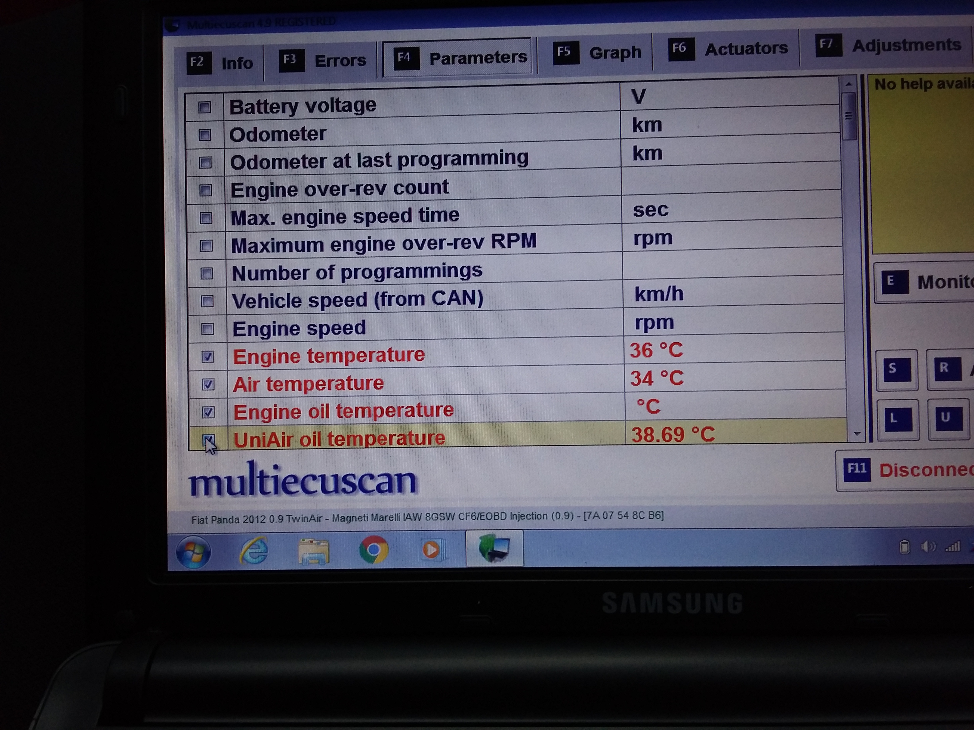

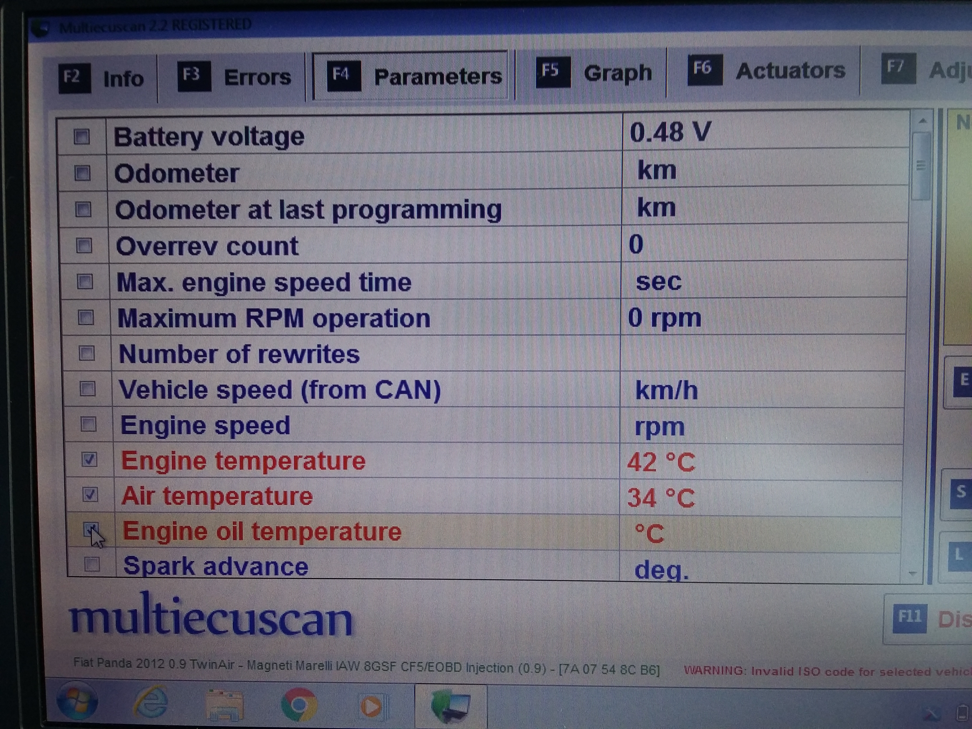

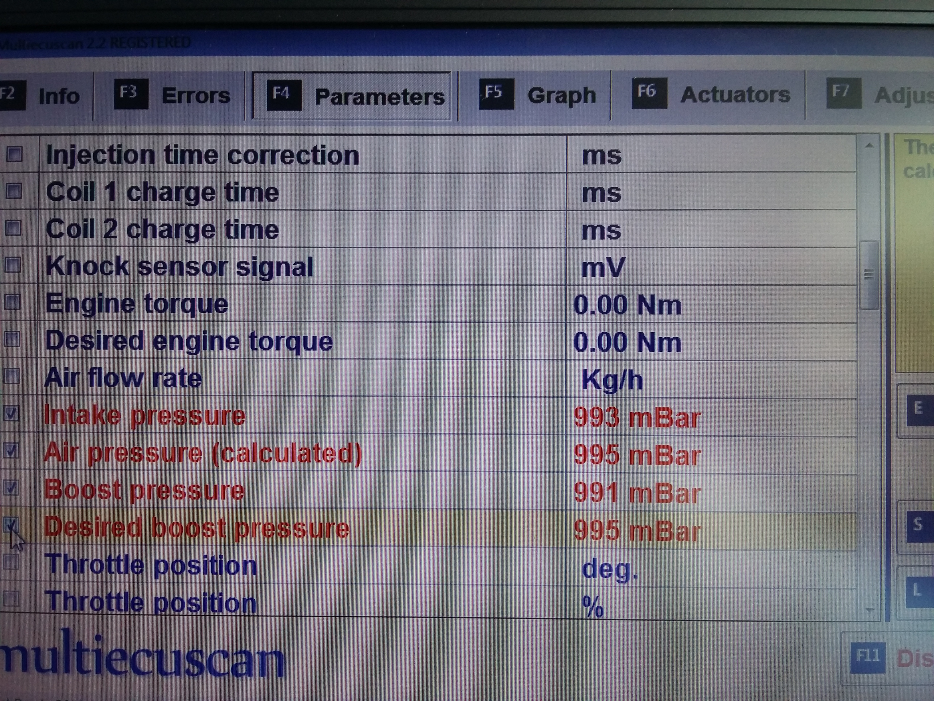

What are you using to read the timing?
These are from a Euro6 twinair
Are yours similar?
