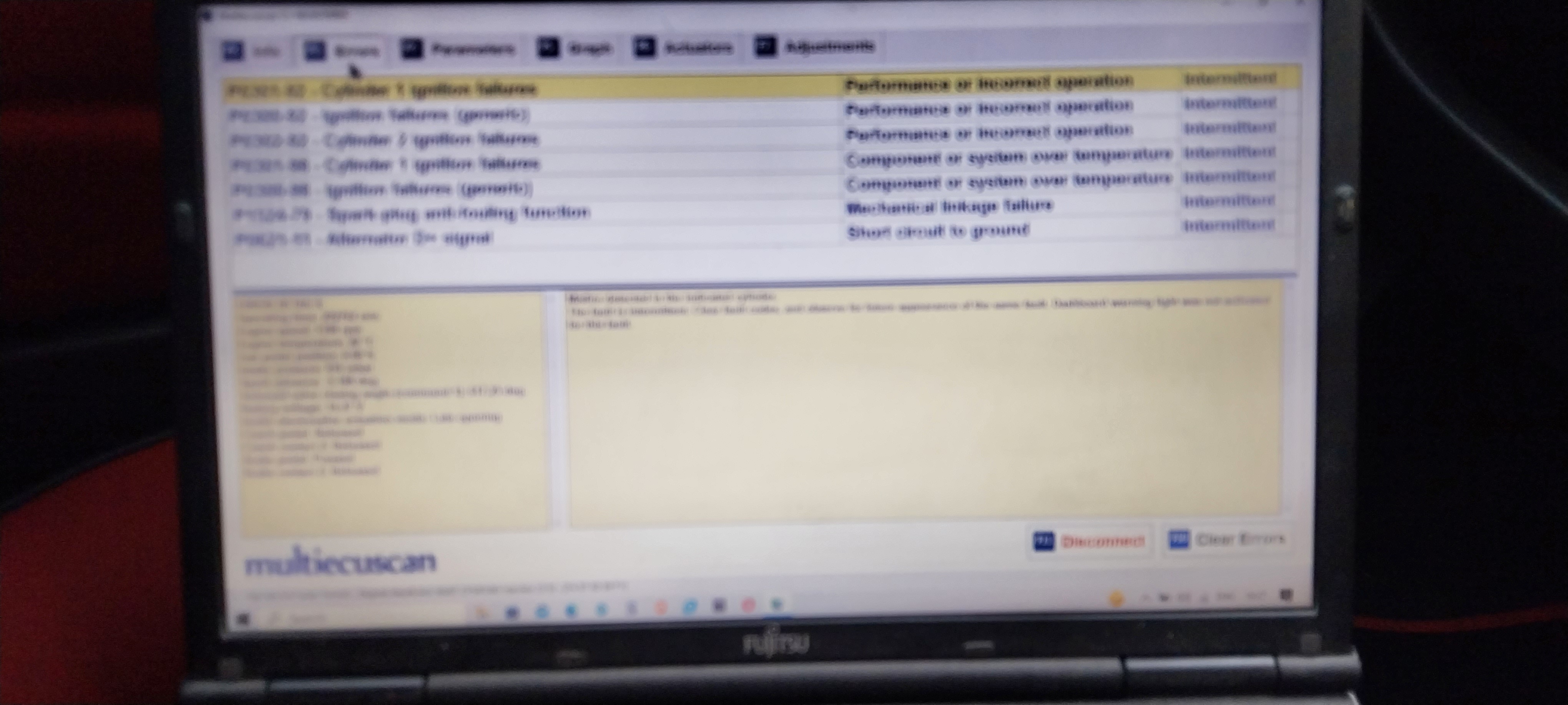

Misfires not too unusual with the Uniair problem..
Does unfair only cause a problem on first start from cold? Only asking as it's the only it does it
I think misfire is caused by restarting. IIRC I tested with MES last winter. Cleared all faults, started the car and it stalled. Read codes again, no codes. Restarted the car and , left it running for a short time and read codes again. At this time misfire was stated, but no MIL.
