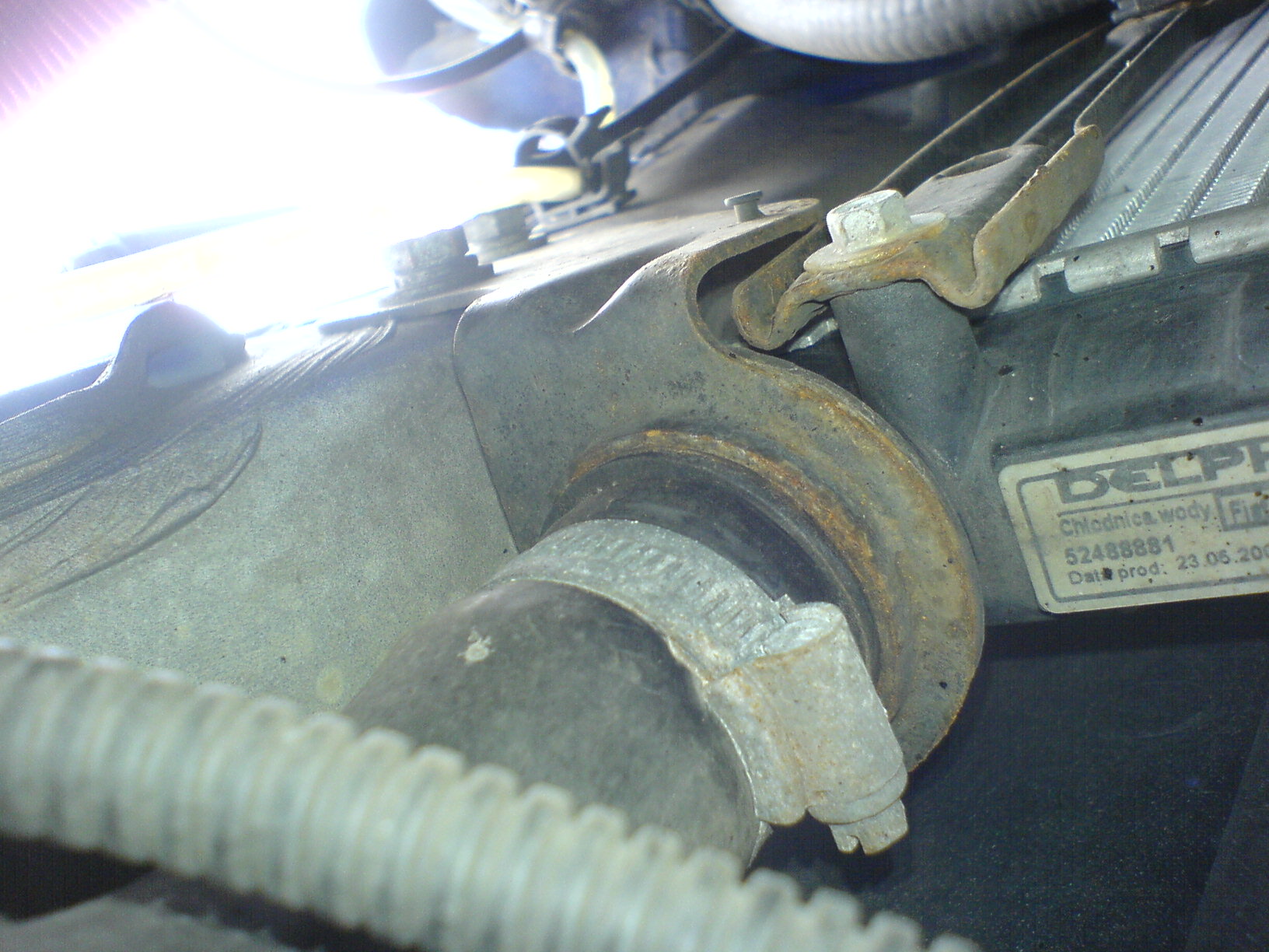

Can anyone advise me how the standard rad attatches to the car? Is there a panel that holds it, and if so does is it bolted in or welded (as i have removed it and cant remember lol)...

If its the same as mine the rad has a stubby bit on one end which slides into a circle in the bodywork on the drivers side with a bung below it which lines up and should push in.
Theres then a bracket which goes over the top hose outlet and bolts to the front (slam panel i think) in the middle but from inside the engine bay.

just a little loop bracket that hooks around the top water pipe towards the bonnet catch
So it just hangs in theory?

Bit late but the rad on my Cinq:
The fan is on a bracket which bolts onto the back of the rad (which may be a problem for your clearance).
There is a flat rubber doughnut which goes over a stubby round bit on the opposite end to the hoses and temp sensor, the rad/fan assembly is then pushed into the bit of metal behind the corner of the bumper (as mentioned).
The right angle bracket (also mentioned) goes over the top hose connector before the top hose goes on, and this has two bolts into the back of the front crossmember.
You could probably remake the bracket easy enough if you can't find it but if you're welding you could always put it on the nearside where the aircon usually goes (I think all Seis have a screw in tow hook further up than a Cinq one so this wouldn't be in the way?)
Ah cheers, looks like our rad will need fitting more to the right (well passenger side), so will have to get building... appreciate you taking the time to take the pics!!
