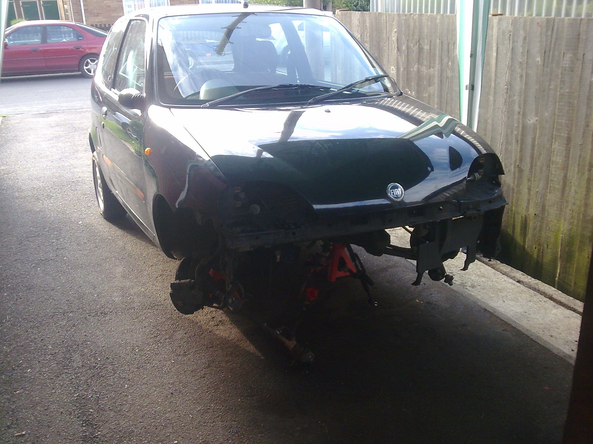

Ive got a T reg seicento sporting with 12months MOT and 6 Months tax, so this is a good base to get started on.
So far the car has been gutted, and im in the process of cutting out the wiring i wont be needing.
Im off on a 300 mile round trip tomorrow to pick the engine up, and then the battle of fitting it in will begin!

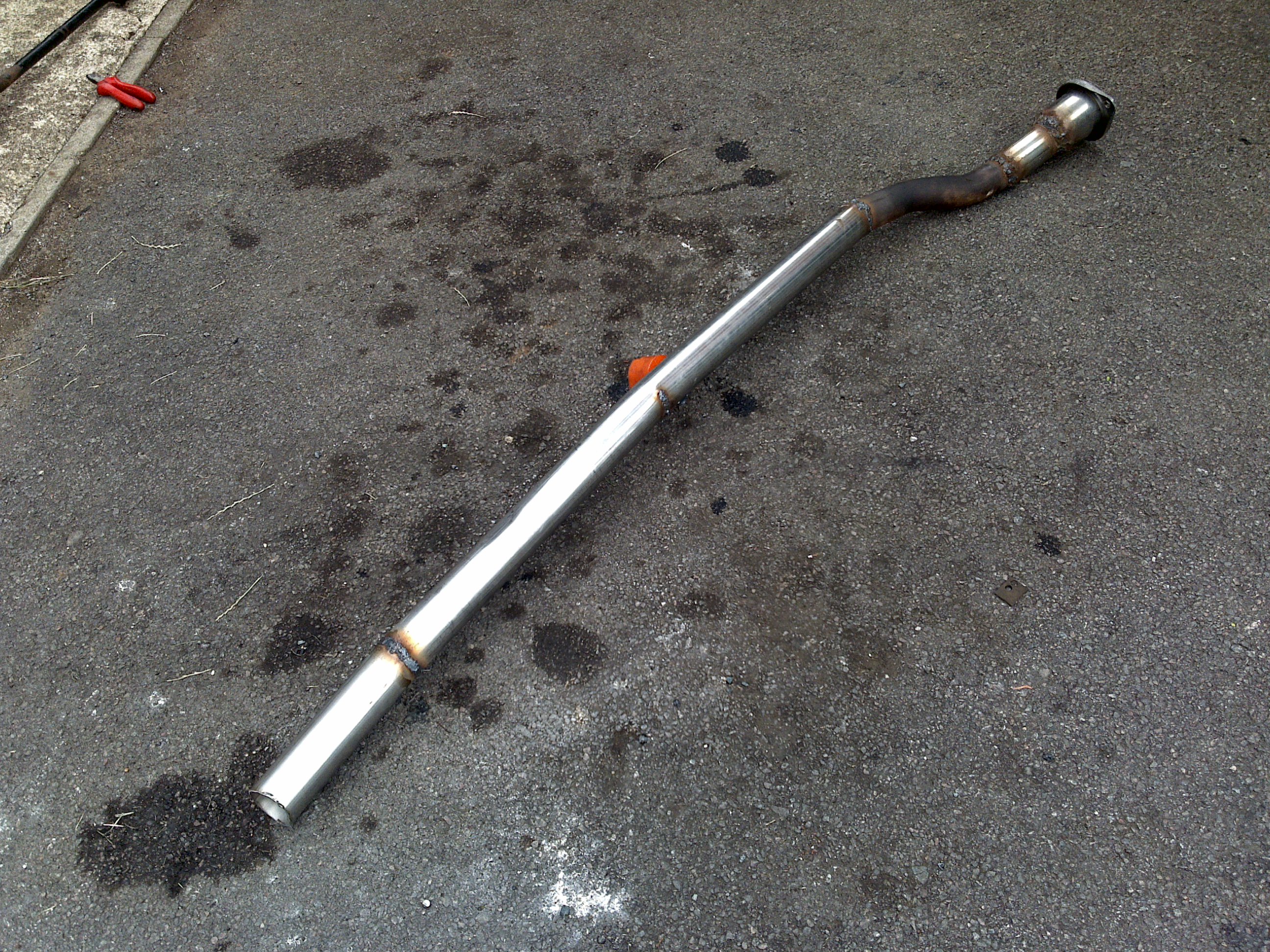

So today ive had enough lol... Made the exhaust system, and welded up most of the inside where the previous gear shifter used to be... I then went about welding the gear selector mechanism in.... after about 3 hours it was all in great, and then the panel must have warped a tad under the heat.... so now the selecter is angled slightly, and i cant get the damn gears... for the 4th time lol...
Going to cut it all out and start again tomorrow, see if i can make it as a bolt in part, rather than welding it back in place.... it needs to be perfect as it will be getting stick on a daily basis lol... :D

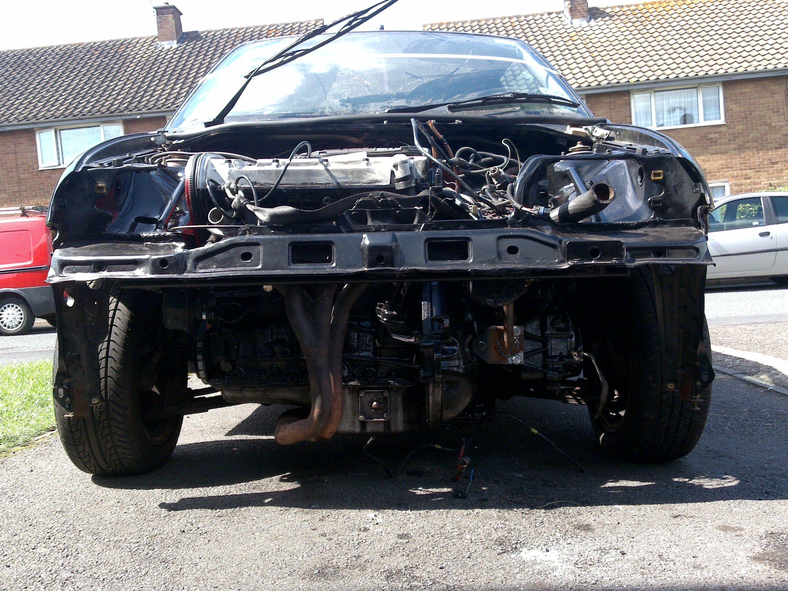

Heres a mid day update... Been measuring the driveshafts hence the car has been put on the floor... on 13's and clearing everything.. Also got around to custom spraying the rocker and the exhaust heat shield (which sits above the manifold in the engine bay)....
Today is looking promising so far...
If we get the gear linkages sorted today il host a few more piccys...

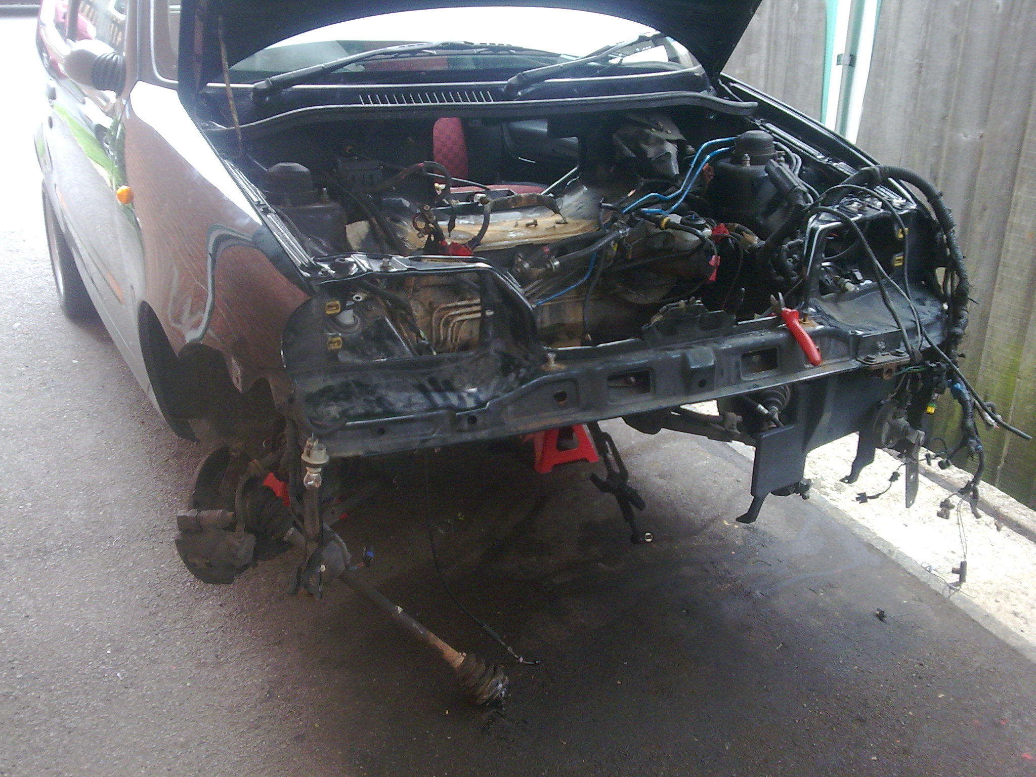

So far as usual its all gone wrong again lol...
The gear linkage wasnt the best, and i was getting fed up of having holes all over the place, so we looked for an alternative...
A friend popped over and pointed out another place the pivot could be placed for a better feel on the gears.
The pivot has been moved into the engine bay, and attatched to the rear engine mount... It needs removing tomorrow and welding as its only tacked.... so far it looks to be better, as internally it should now line up perfectly, meaning less joints in the link to go wrong...
