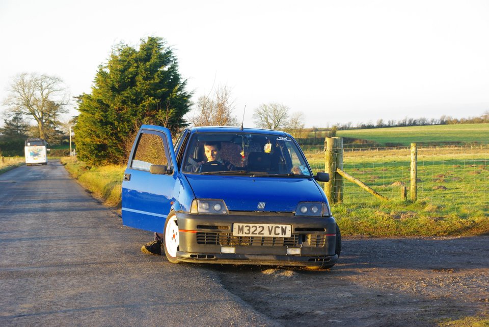

What I really don't understand though is how they negotiate Polish roads with their cars so low. Having driven in Poland quite a few times I've noticed the average pot hole is the depth of a well. Lorries have worn grooves so deep in some places you can let go of the steering wheel and your car steers itself. Some of the new highways are great but how they can can drive on any of the old roads is beyond me. :D
Meh, a lot of them do look damn cool though. :yum:
The bottom line is that most of these are show cars. Quite often they actually make it to one show or another on a trailer. Some would also have adjustable height suspension. Apart from shows they either stand in the garage or drive around the block, a 1/4 mile race from time to time. But yes, this is also beyond me, mine is moderatetly lowered compared to most PL ones, and I have seen sparks in my rear window a few times.
