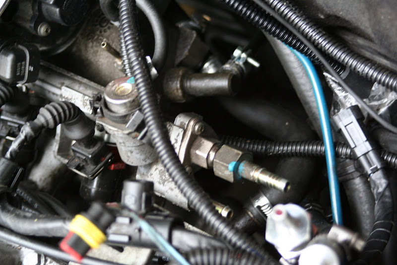

Some pictures of the tightness for his Blu-ness:
Yellow and green pipe is only temporary I have a nice roll of red stuff but keep forgetting to take it with me. ;)
Brake servo pipe is from a 205 GTI and is a hard walled flexible which is much easier to work with than the nasty plastic standard stuff.
What tightness? I can still see through to the ground on two pictures :D Certainly not possible on my Cinq.
I would suggest looking at the possibility of getting your hands on the Palio75 inlet manifold instead of the Punto one. It has much more convenient outputs for the servo and for the MAP/FPR "vaccums", see here:
Meh, it's all sorted now I will just spiral wrap the pipes that are close. There is no movement from the engine whatsoever (trust me on this!!) so it will be fine. Might be a good idea for Blu to source one if it won't fit in his though. Map outputs are fine, I have a bolt in one because it was bent but I have a screw in fitting I can use if I need to. It's actually better to use hard map pipes but they just don't look as nice as the shiny red silicone I bought. :D
