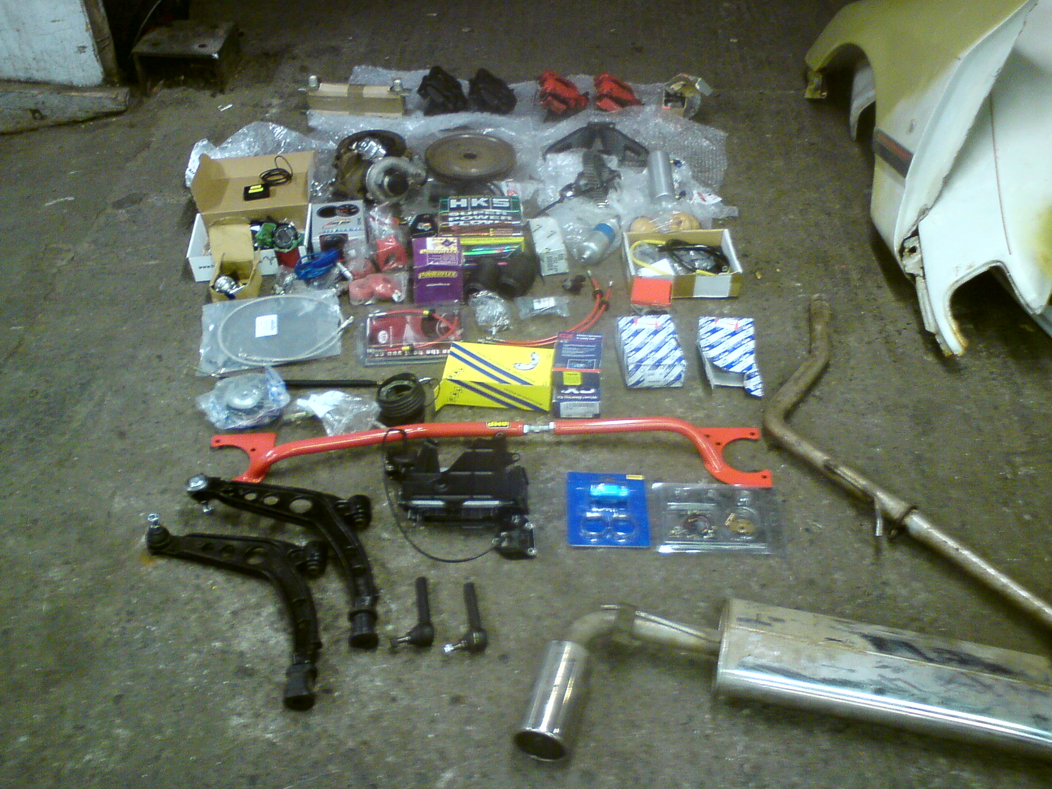

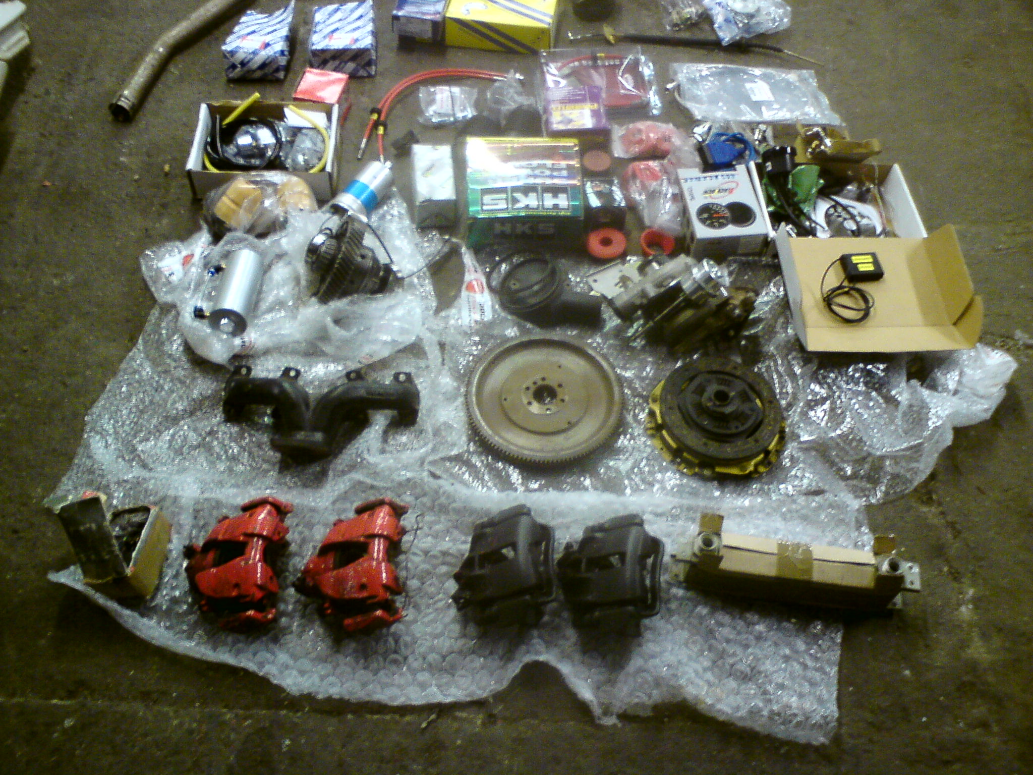

I will just post some pictures of the bits for now and then intermittently as I fit them.

Sorry missed this, yes it's a 16v flywheel we don't even have a decent scrap yard here pretty much everything is crushed before anyone gets a chance to pull any decent bits off it unless you buy a whole car. Gazzaman was breaking Smilers car at the time I purchased the engine so he was kind enough to hang on for a bit and send me the flywheel on the pallet along with the diff and UT brakes. Shipping something as heavy as a flywheel to Jersey is very expensive so it was too good an opportunity to miss. I believe WOJ runs a 1.2 16v flywheel? so we'll just have to see. I think it will be OK with an upgraded clutch (which will be new not the one in the picture) and I'm not an overly aggressive driver these days.
