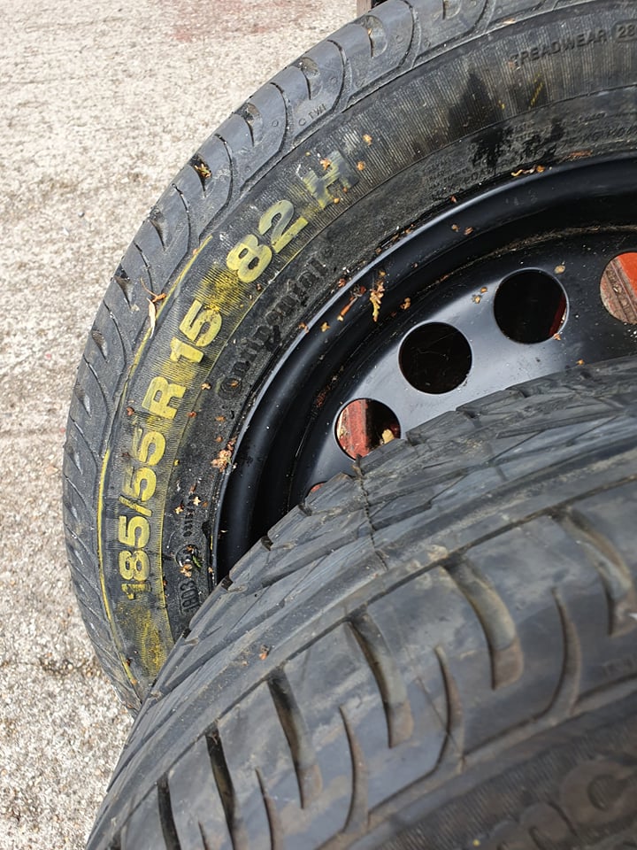

Tyres - Rear looked new and fronts not so good, so rotated them. We thought there was spare in a garage but were let down

Fresh tyres / spare set needed

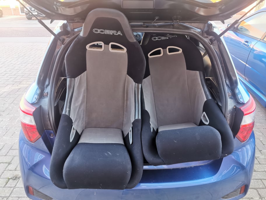

A set of bucket seats were sourced ( 4 hour drive to collect from London) for £50, there wont be time to fabricate mounts and sort out harness and harness bar in the time left so this will be for the next outing
