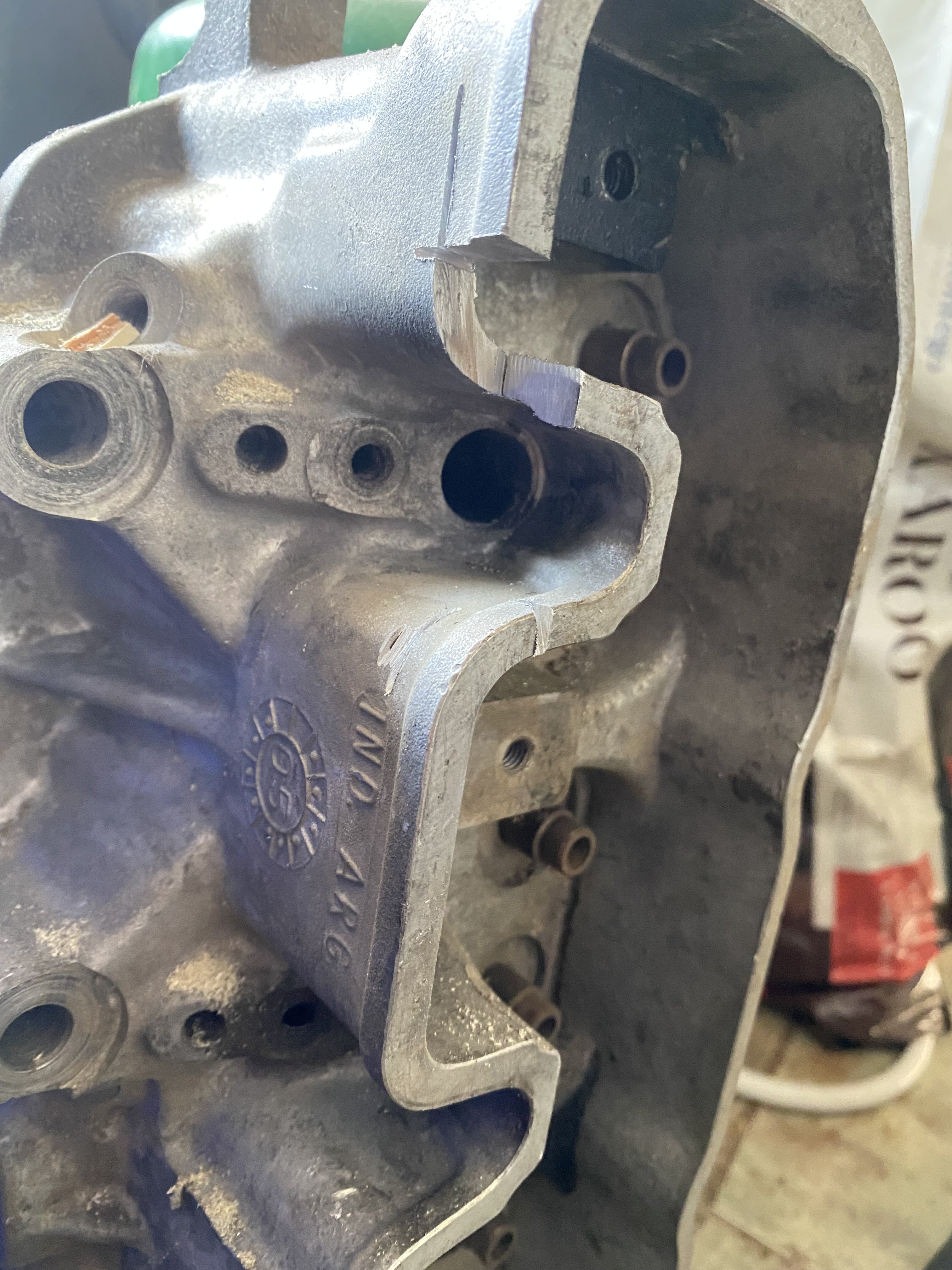

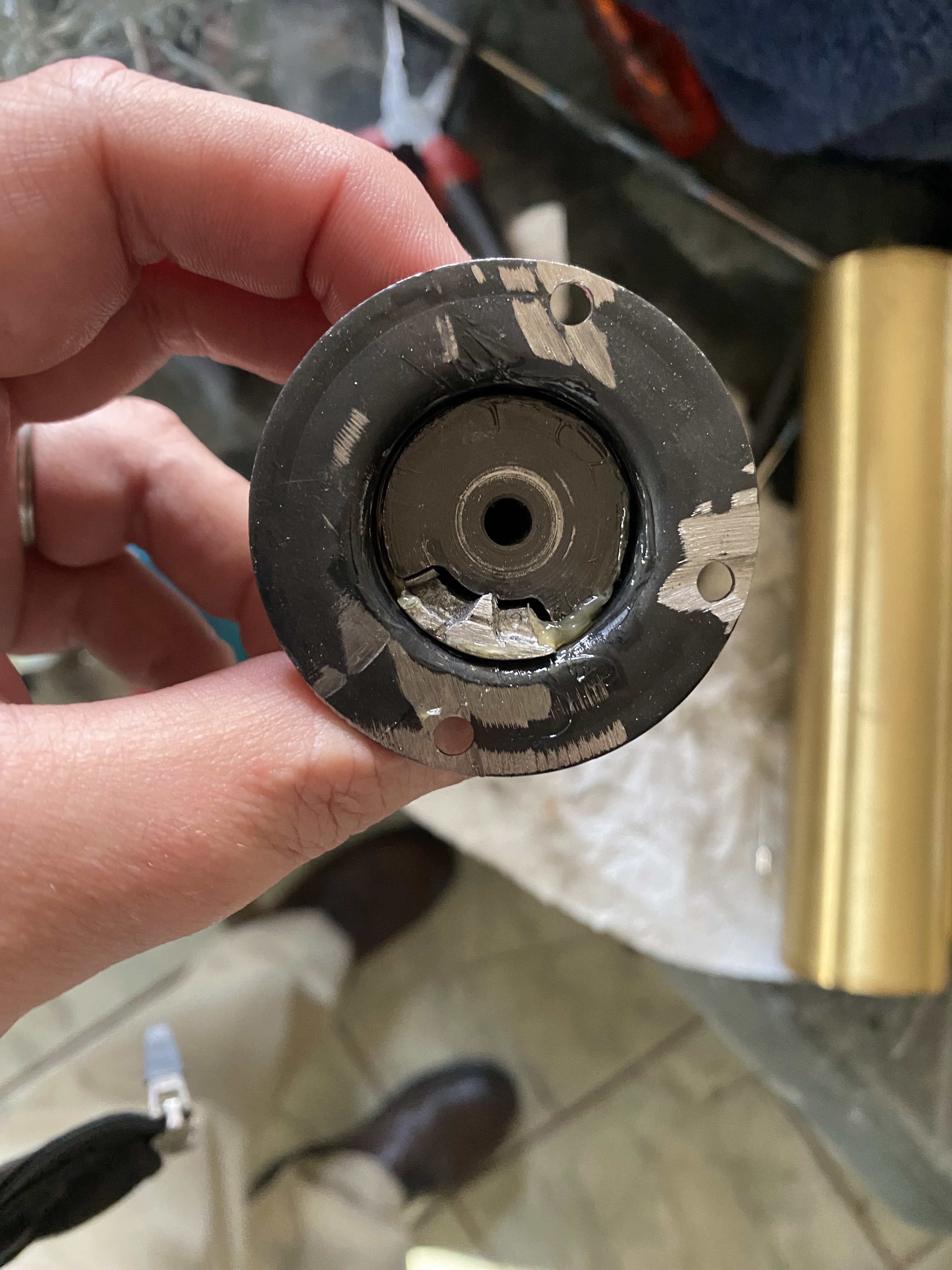

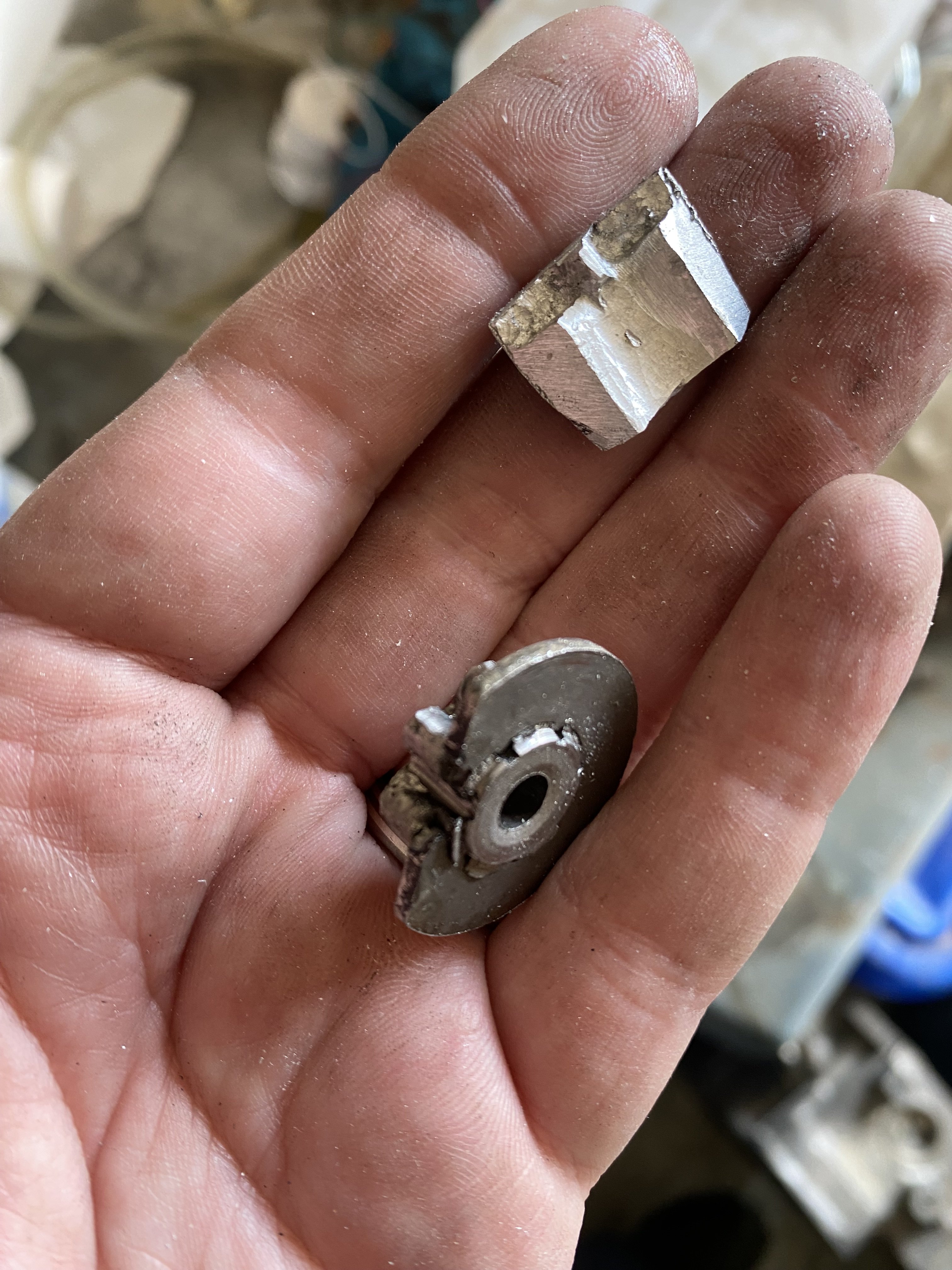

I was at least able to repair one thing. The front window winder was stripped. It has this stupid metal plate in it which kind of acts like a fuse. But is is sealed in an enclosure that needs to be opened with a grinder. As this car is a learning experience for the kids we remade the plate. This time in aluminium scavenged from a old Land Rover head I have lying in the garage. .

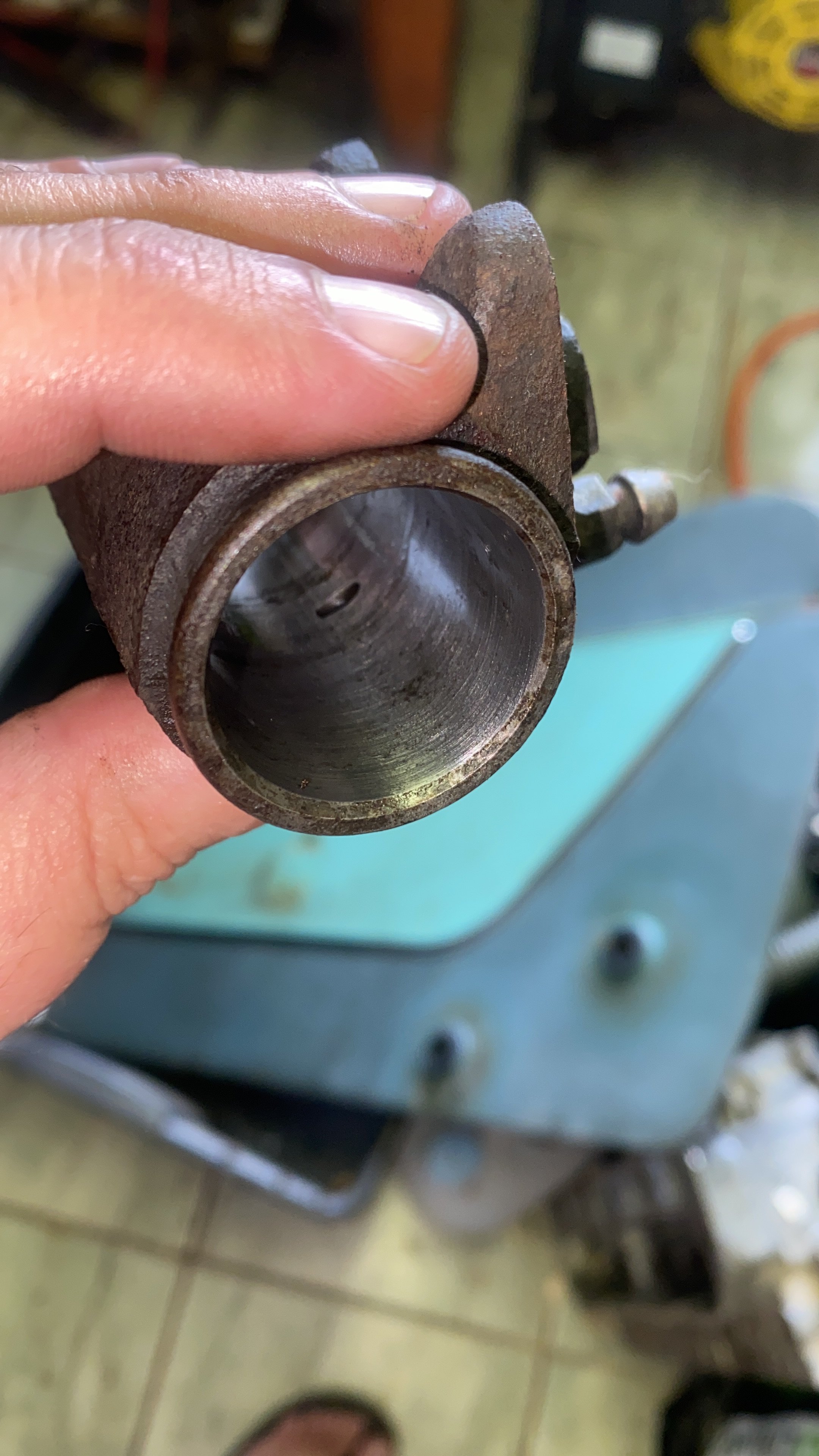

Oh also started with the brakes. Note to self. When using 8bar of air pressure to remove a stuck slave cylinder piston, make sure said piston is not pointing at you..... I will leave it to your imagination why I needed to put that out there.

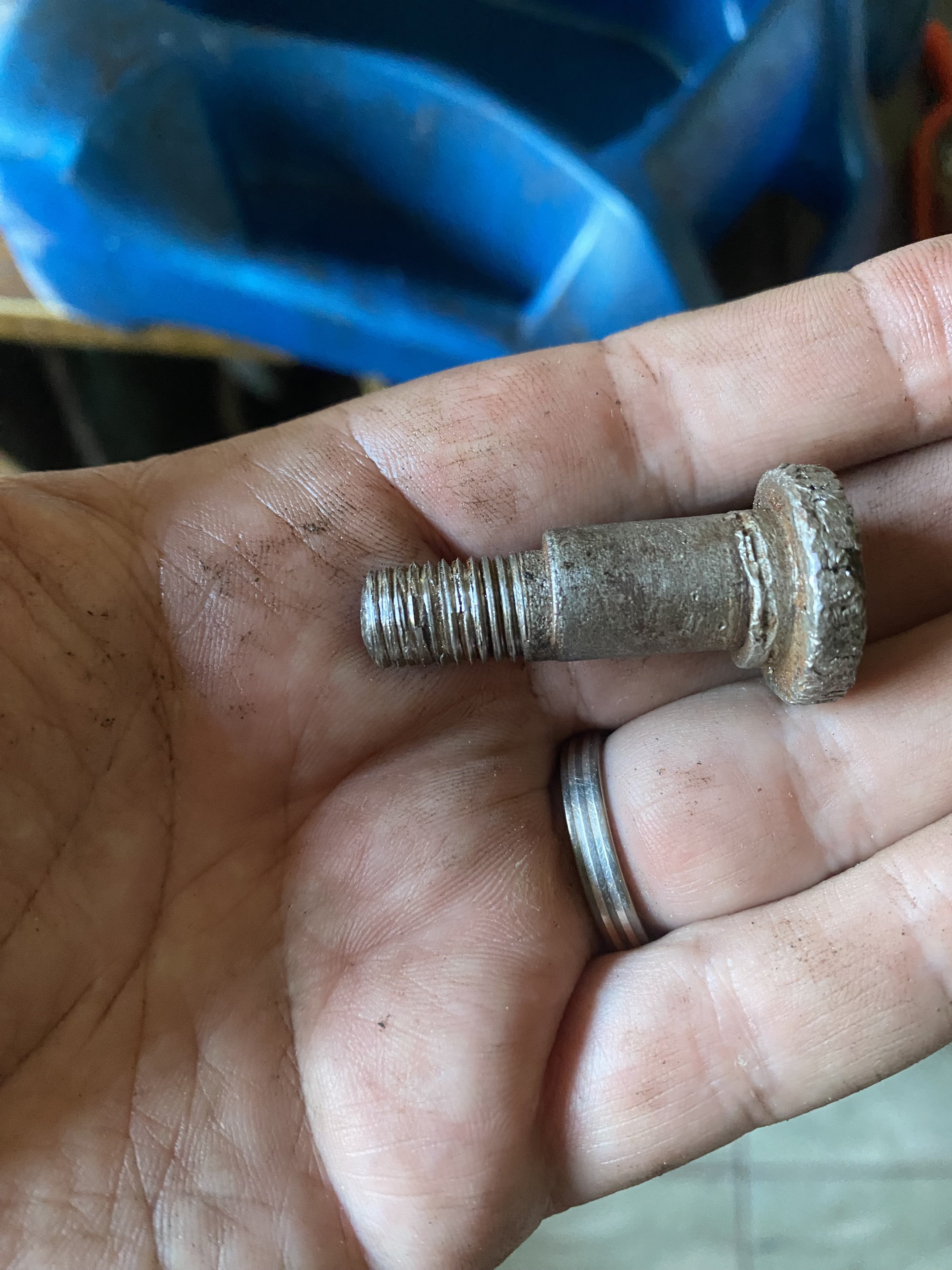

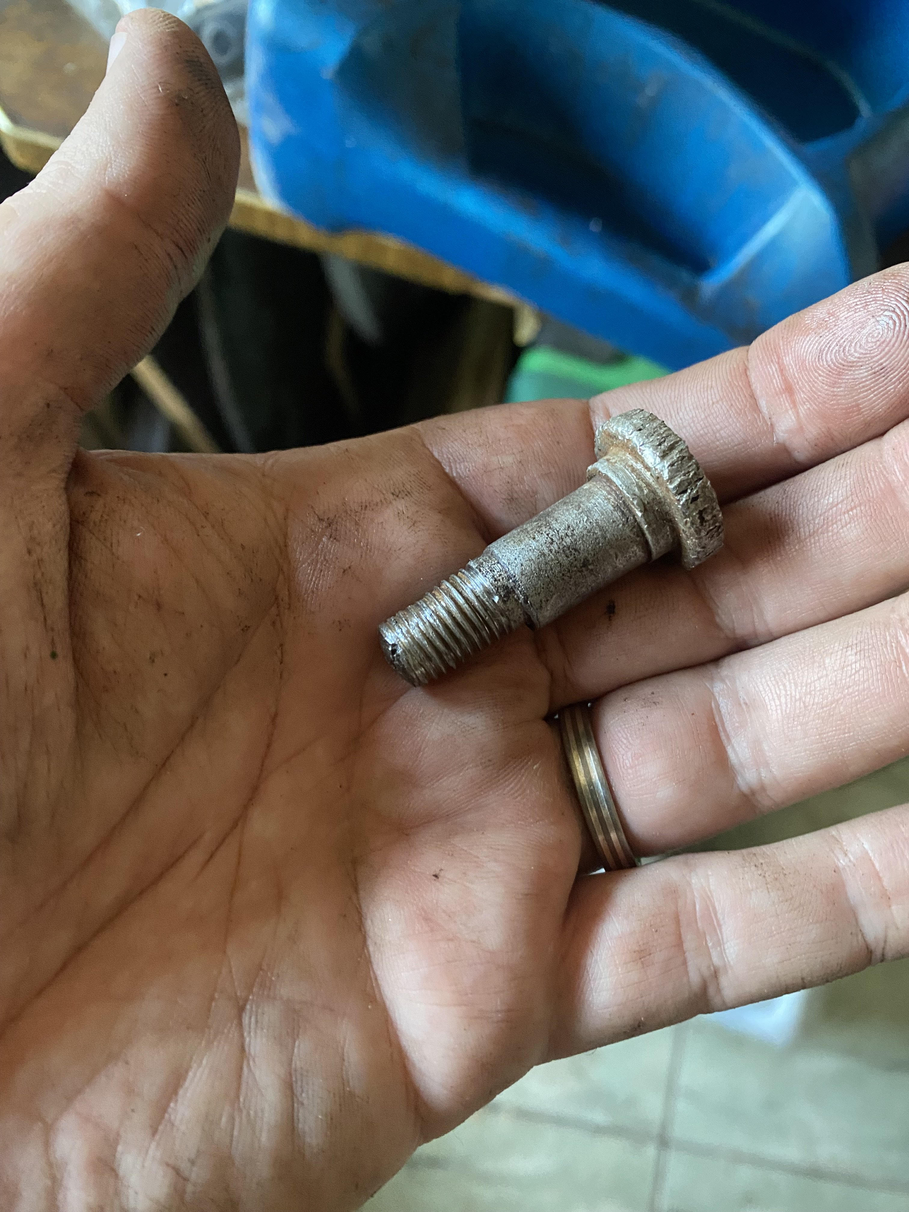

Also to anyone reading. Please don't use silicone to "fix" brake adjusters. Do it right. Somebodies ears are probably still ringing from when I found all the brake adjusters were stripped and fixed in place with silicone.

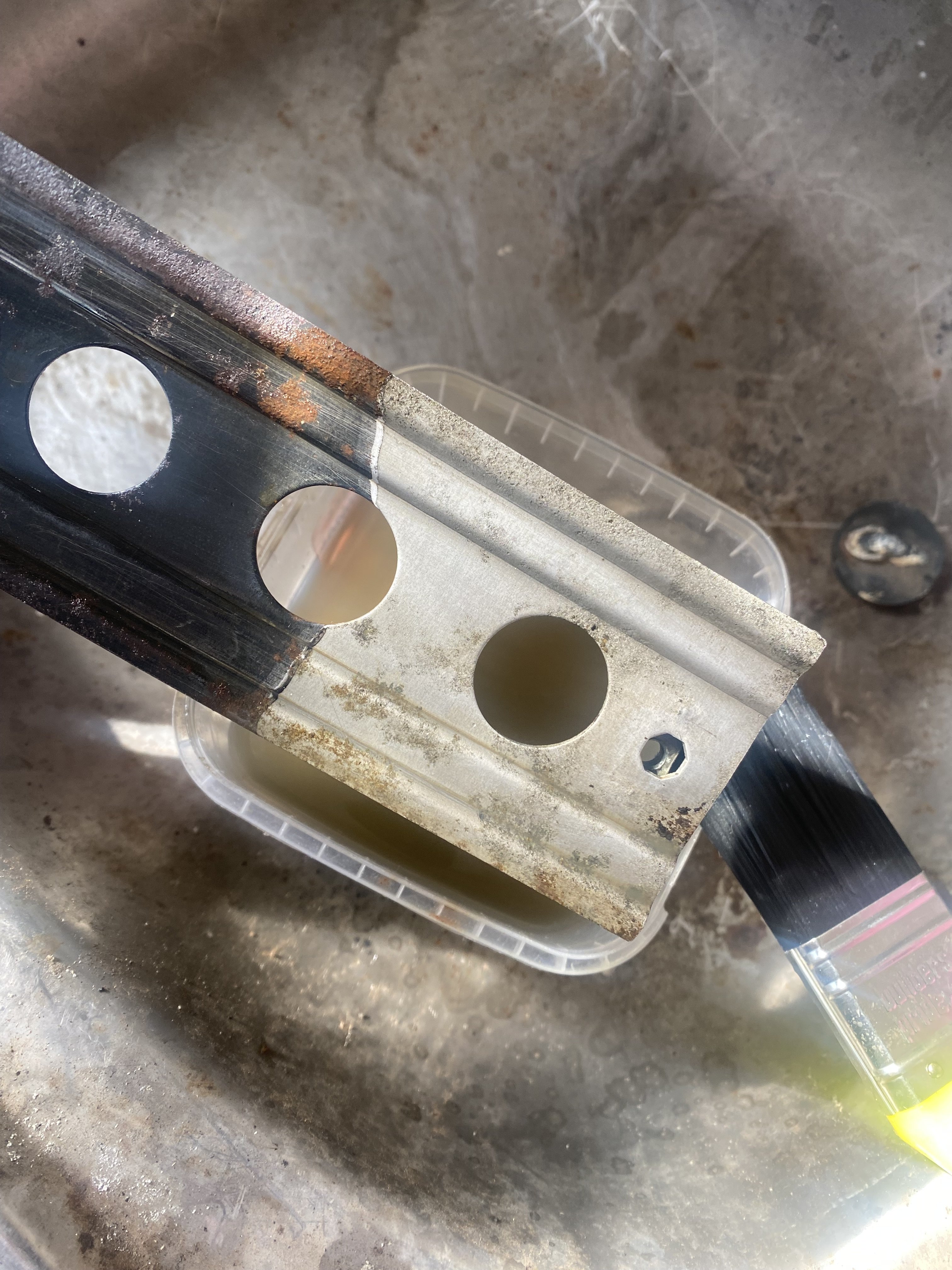

Also tried some rust removal. Tried a product called evaporust on these. The outcome is most acceptable.
