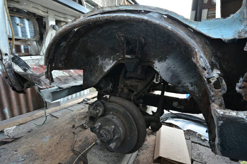

I had to fix the floor before fitting any seats. There had already been some welding to the big cross member, which seems really strong. But I have had to gradually patch in a series of repair pieces. I have nearly finished that job today.
Now it's onto the complex corners of the front valance.

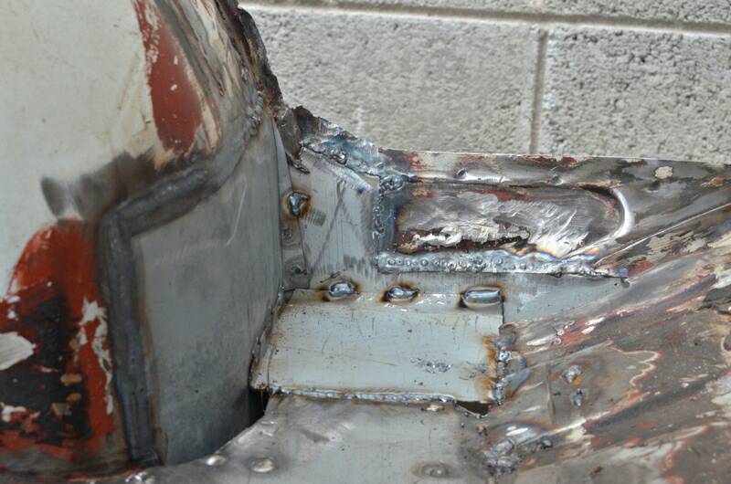

This morning I repaired that front corner. A skilled panel beater would just make a new one from one piece of steel. I had to do it in sections. First I used the stretcher tool to shape two angled pieces which were then welded in place. Then I needed a piece with compound curves...ie
in two directions. I used the shrinker to put a kink in it and then with some careful trimming and manipulation I got almost the right curves. Quite a bit of filling will be going into the valance anyway so a bit more won't hurt.

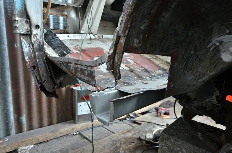

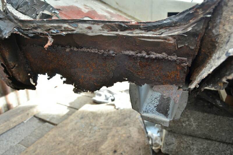

There was no way I could tell where your picture was supposed to be, there appears to be so little metal left. Good job you told us - any chance of a wider angle so we can see it in context?
Can't wait to see what you can salvage.
Oh, and your welding is alot better that what someone did before :)
I'm working most days this week so progress will be limited. I have already cut away the useless bits but there is at least something worth reusing, unlike the driver's side. I have so little space in my temporary lean to that it's hard to take the bigger picture but I will. At least my new outrigger gives some stability and locational guidance for the new bit I will have to make.

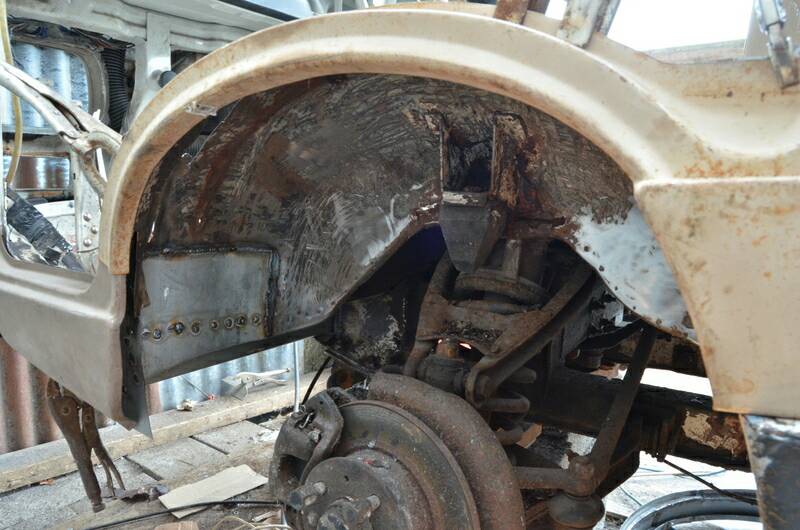

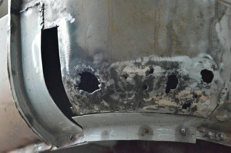

I just put in a couple of hours welding in a strip at the edge of the wheelarch. Originally this came to me with a horrible patch lapped well over into good metal, with extra patches below. Although I obviously need to do a lot of grinding here and on the floor if it is to look tidy; by welding on the top it was much easier to do and looks good underneath. It is all honest butt welding. I was a fan of lap welding in hidden places like this, but now find it makes stronger welds which can be finished to look very acceptable by doing it "properly".
The puddled welds are where spot welds held the original to the cover panel under the arch.
