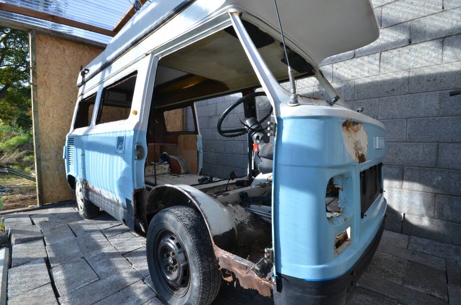

I have removed the doors and the windows...the windscreen was easiest! Since the photos I have jacked it up by about 600mm and fabrication and welding should commence next Thursday. There's certainly plenty of corrosion and poor repairs to get stuck into.

From the photo's it looks like Bluebell is further gone than Connie was.
Also looks like you have cut off the inner wheel arches?

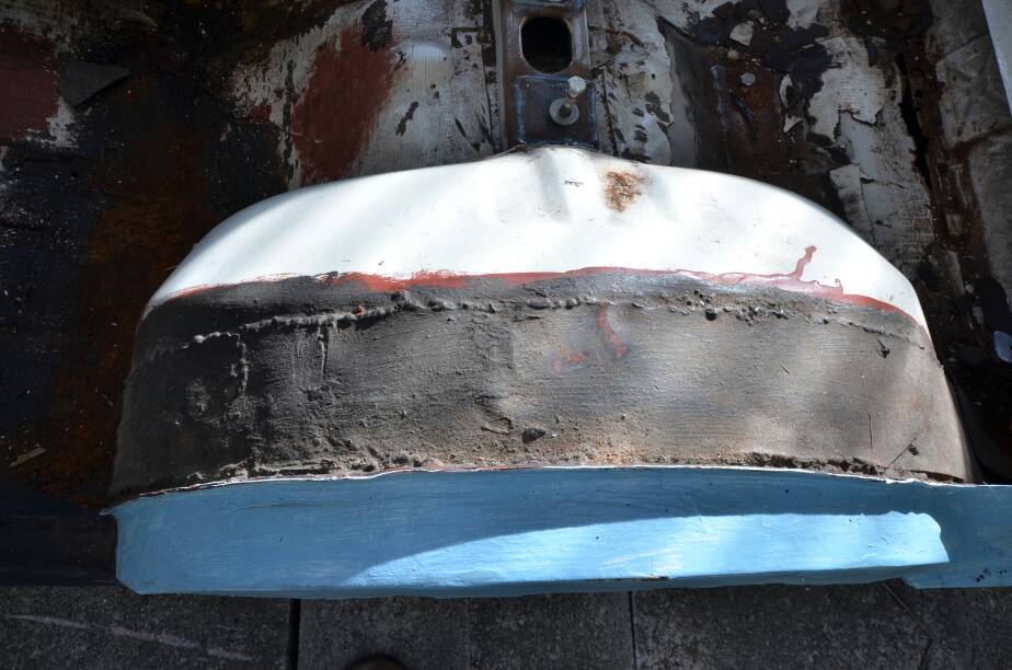

The wheelarches is a mess...lots of old repairs to unpick.

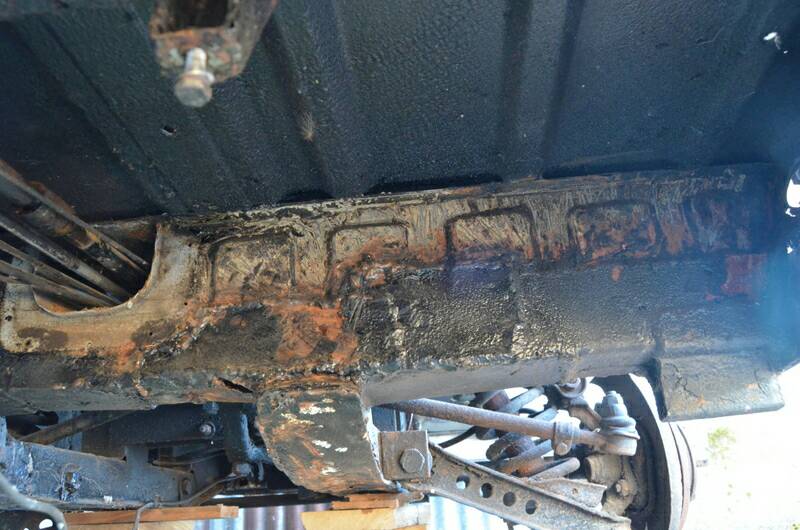

I am suddenly deep in structural welding under the floor. Previously it was a sorry mix of odd shaped plates with messy welds to draw the MOT man's eyes. I ended up making a new outrigger and emulating the original assembly as near as I could.

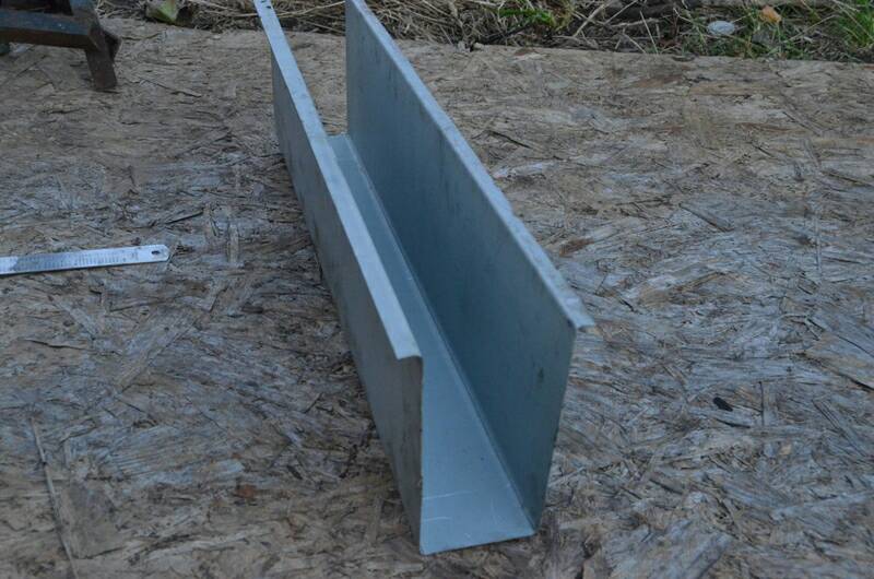

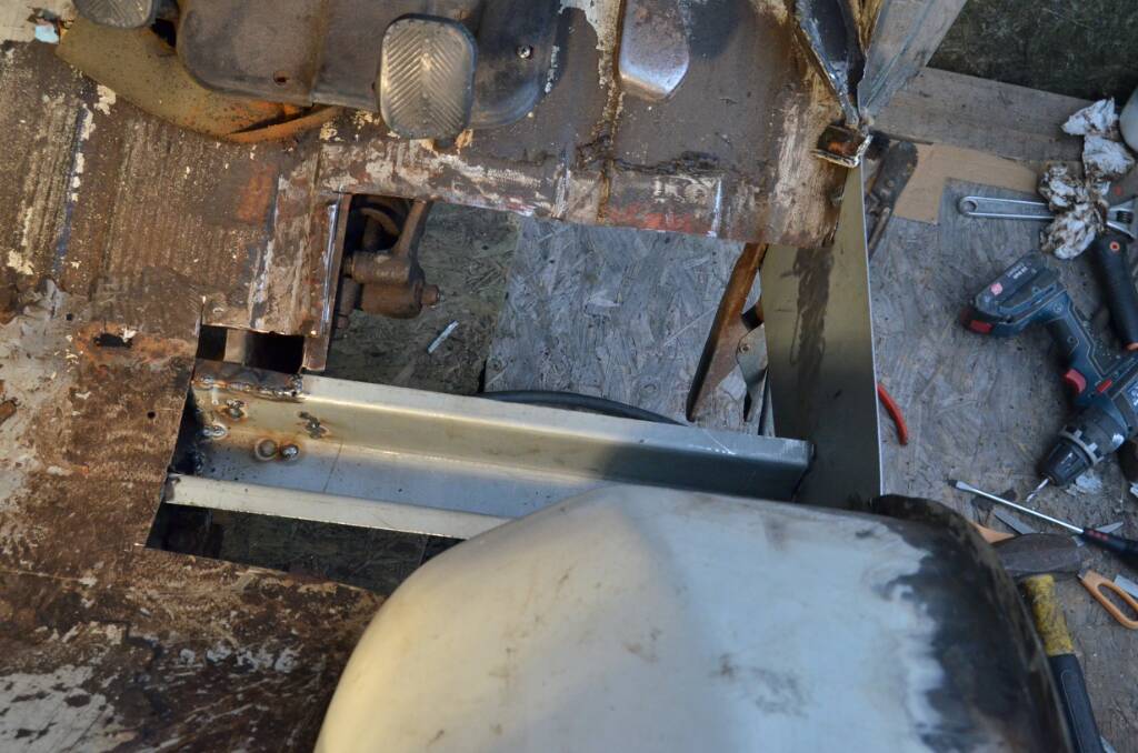

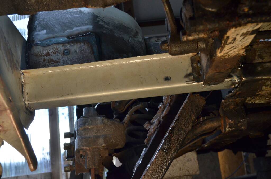

I got really stuck in this afternoon. The main crossmember was always going to be a challenge. It had numerous plates and cruddy welds ;even some sealant filling holes in places
I guess that at thirty years old and having 19 previous owners, there have had to be bodges. So I have removed a half of it and plan to fit a new piece I am making. This gives me access to the ends of the lower suspension rail which also has some horrible "repairs".
My bead roller is on back order so I can't make any strengthening ribs, but I will double up the steel internally where it attaches to the front chassis rails.
You might think things would distort with so much metal missing but it all seems very secure.
