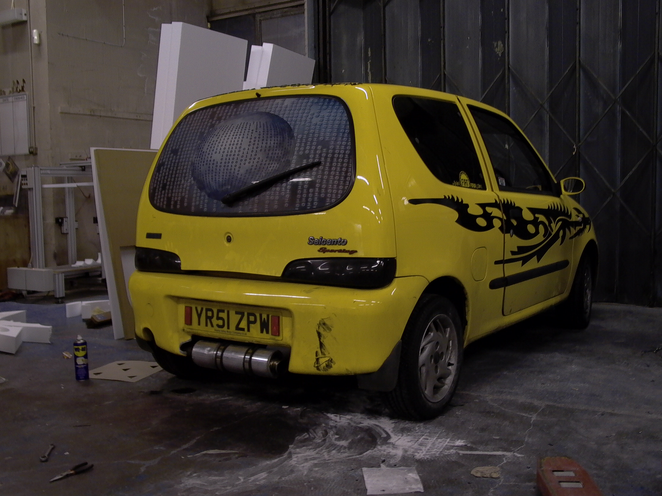

As a few of you may know, ive bought a nail of a car... I myself knew this, but i wanted to spend some time, money and effort to get it back in a show & stand worthy condition.
It was owned on here by 'wardy25' and as far as i can tell he spent a fortune on her... It was later sold, and then neglected... So far i understand that the car was left off the road for ages, owned by chavs, and thrashed, and thats only when its actually been running...
After it being sold on and on, i ended up snapping up the car...
The car has loads of problems, which i knew prior to me buying her, but she does come with loads of cool stuff...
The interior is full leather, its got powder coated abarth wheels, skirts spoiler, uprated brakes, and the main thing.... a tasty 1.4 uno turbo engine... which i think is the MK2 engine.
The car also comes with panels hanging off, cold start problems, faded paint, wiring faults, and more holes in the exhaust than swiss cheese....
So as a good thread goes.... here are a few pictures of the car in its current condition...
Hopefully in the near future, it wont look anything like it does today...

I can make an exhaust, but i just want it to flow as best as possible seeing as its a turbo'd engine..
LASt time I was there he fitted my manifold, made-up a decat section and flanged the old cat - cost about £60 which I was happy with.should be able to find his number on the net
Got my full system made by John Ashley... cost about 240 iirc.
full 2" stainless. stainless straight thru back box (I asked for it to be silent which it is! but does have a nice deep tone outside... turbo itself it louder haha)
Top quality work tho... well chuffed with it.
got mine a bit cheaper (not sure how much by...) cos hes knows a lot of people from the same motorsport club as me.

Think im going to have a shop around for an exhaust this week, see if i can get a cheap one sorted...
With regards to a turbo'd engine & exhaust, ive been told to go for 2.25" pipework... but am i better in having a middle silencer and then pipes to the rear (each side of the bumper) as it currently is... or remove the middle box, and have a seperate exhaust box at each end of the exhaust?
personally I would fibre glass behind the new cutout and repaint, just have the one exit on the standard and have 1 box.
Would also work out cheaper when it comes to having the exhaust made up.

Would look sh*te as i wouldnt get a colour match due to paint fade... so its not really an option.
yea i always use nuneaton replacement panels as they are bang on with paint...
Still id rather go via the double exhaust option as if i dont get the match perfect it will look cr*p...

Well today ive spent £50.... All for a full stainless exhaust system (twin exit).... well the materials :p
I managed to get two lengths of 60mm 304 brushed stainless steel 2mm wall and 1.7mtrs each for a jaw dropping £15 per length....
And then two Custom Chrome Ends for £10 a Piece.... although a lot bigger than i thought they where.
I have also built the runners for my buckets as i like to do the work myself to keep costs down..!
These ended up costing me arount the £25 mark including the cash for a cr*p grinder, as i was fed up of lending my mates.... Money well spent as i decided to modify the inner of my car so i can engage 2nd properly ;) lol... it was easier than messin with the gear selectors.. Il have it set a lot better when the engine has had its rebuild next year (too cold for much more driveway work this year)....
Had a go at welding the stainless with my gasless mig... I know it should be TIG welded with stainless weld, but as i have neither my new mig welder came out to play.... Only really means after a while the welds will rust... but most standard systems rust anyhow, and if you could see the excuse for the system on it now you would agree that anything is better!
I need to buy some custom rubber mountings for the exhaust, but as soon as i start work on it il be getting the camera out!!
Il also get a few snaps of the exhaust i currently have..... although its more like bits of an exhaust!
