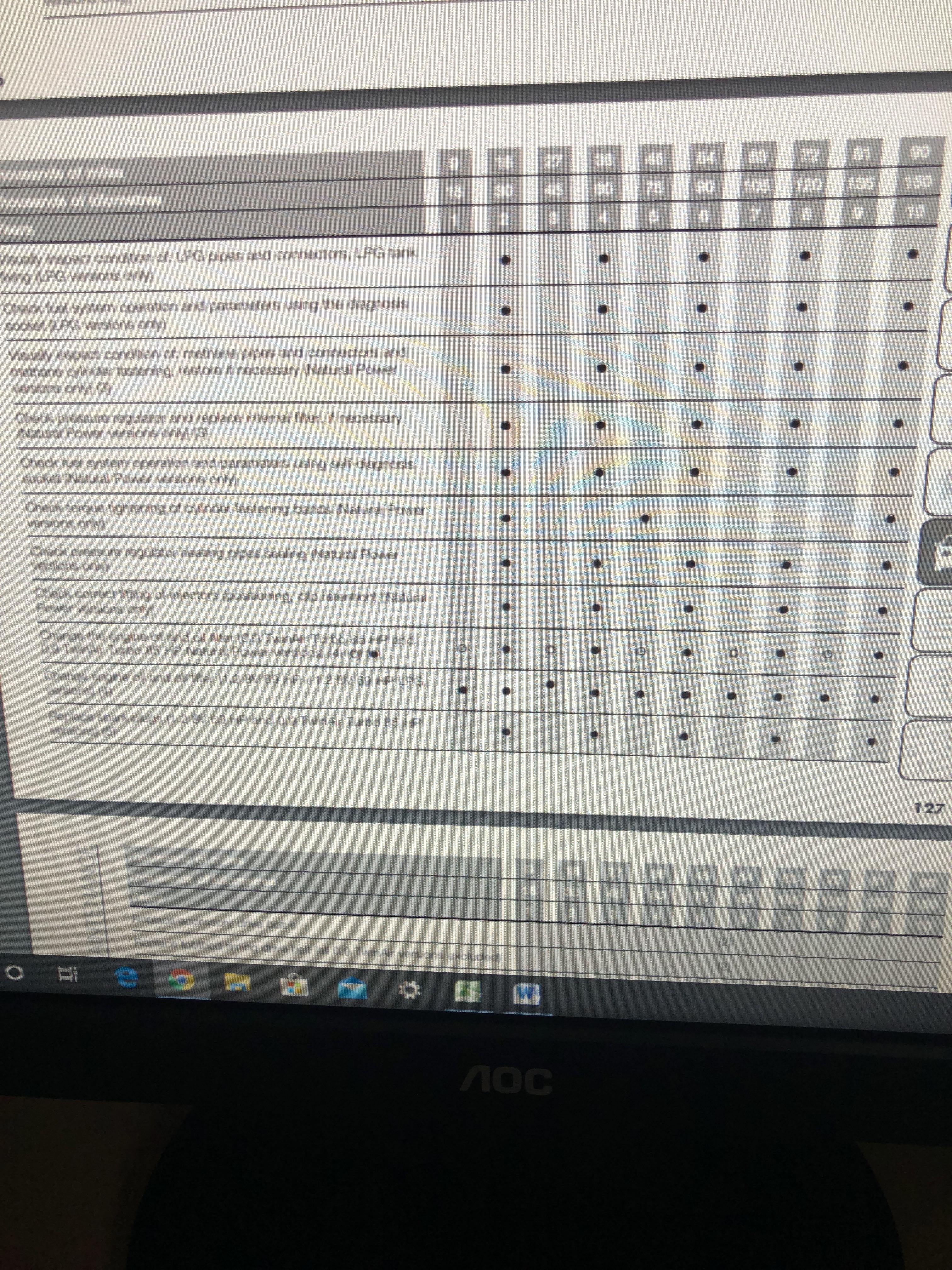

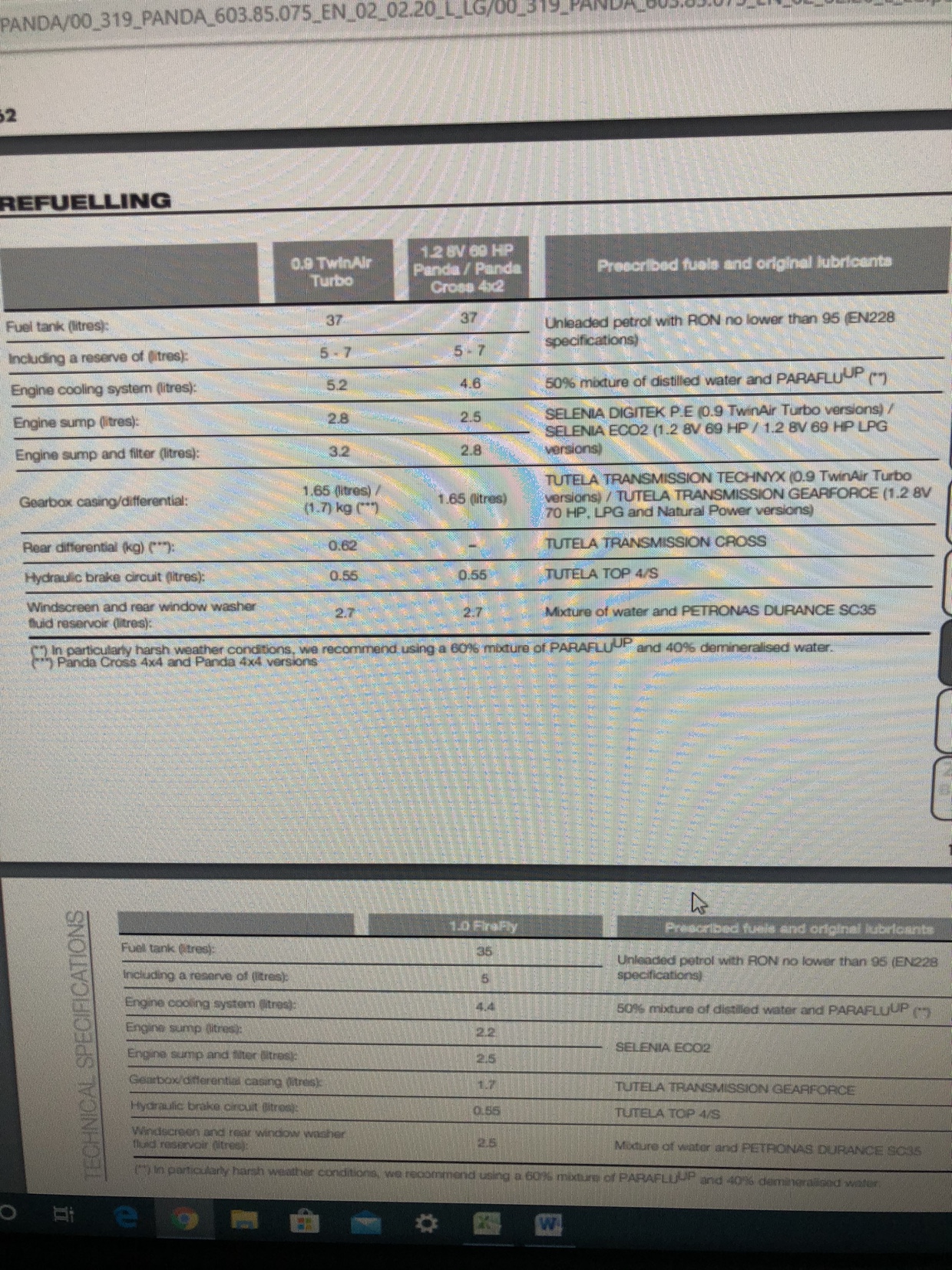

So I was interested in the new 1.0 Firefly engines and what the tech specs say in the new owners handbook. Incidentally, it seems that Fiat has changed its specs for the 1.2 8v engine too.
Tyre pressures can be 2.8 bar on the front and 2.6 bar on the back to “privilege fuel economy”.
Moreover the oil specs have changed. Now the 1.2 8v can use the new Selenia ECO2 0w20 oil for the 1.0 Firefly! Oil change intervals down to 9k.
Seems rather odd why they’d change the specs to a thin oil. What’s people’s thoughts on this? IMG_1290.JPGIMG_1194.JPG

Straight from the March 2020 fiat Panda handbook:
Lubricants for petrol
engines 1.2 8V 69HP /
1.2 8V 69HP LPG / 1.0
FireFly 70HP
SAE 0W-20 ACEA C5 9.55535-DM1
SELENIA ECO2
Contractual Technical
Reference N° F049.C18
Looking back at the handbooks this change occurred in October 2019.

Having had a look this afternoon I found two suitable oils:
Millers XF longlife 0w20 14 FE & Comma Eco-M 0w20
Both oils are C5/MB 229.71 with the Millers also BMW Longlife-14FE+
When you look at the tech specs for the ECO2, both above oils look very closely matched.
The millers stuff isn’t too dear either and they’re not far from where I live in Brighouse W.Yorks.
