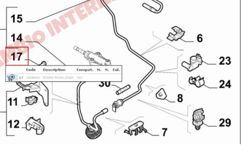

After a bit of lateral thinking, and then Googling, I believe this is a newer version of the damper in the hydraulic lines to the clutch - you can see it in this screen shot of an Italian parts supplier (first image)

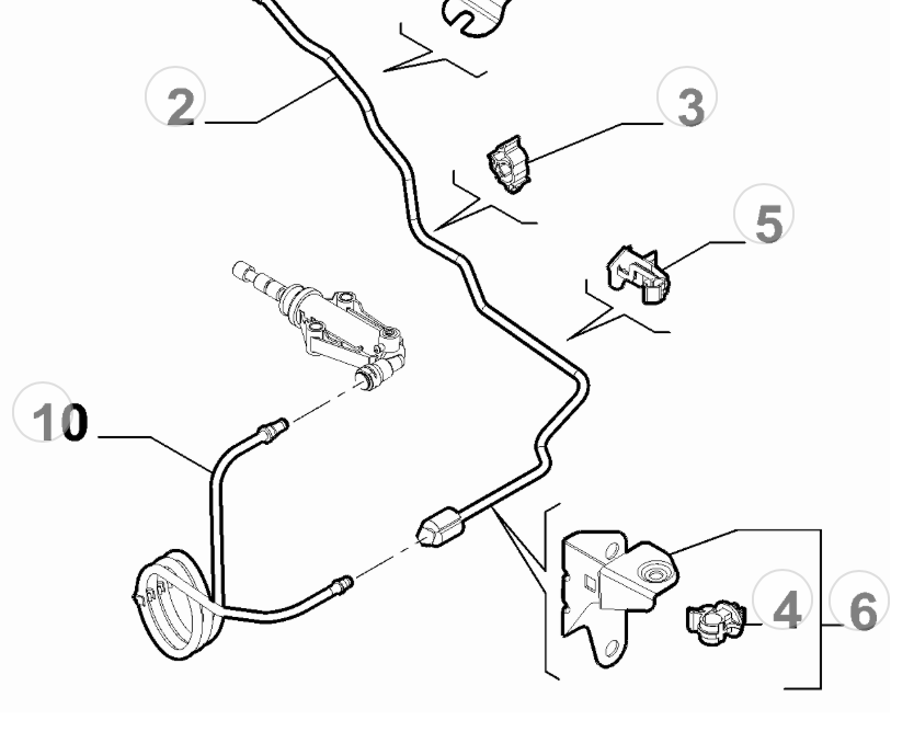

Older models had a spiral of tubing in about the same place (second image) , presumably to do a similar job.
Well done on your detective work. So far the garage haven’t a clue and have come back to ask where exactly is the item. If they couldn’t work that out from the two pics I’m pretty concerned for their abilities . I’ve sprayed Lanoguard in it as wa a rusty. Hope that won’t affect it
Damper? I think that's very likely. In fact my boy's Punto has a similar device in it's clutch line which I found when we (Harrison's Garage and me) were involved in fitting a new master cylinder - a bit of a pig of a job on newer Puntos as, unlike the earlier Grande, you have to partially dismantle the pedal cluster to get the cylinder out. Lot's of bloody fingers involved (blood as in the red sticky stuff!) took us a bit of head scratching and a few cups of tea before we settled on what it was. It's a very simple device with a diaphragm in the middle, brake fluid on one side and a spring on the other.
So putting a little Lanoguard grease in it shouldn’t hurt do you think?
