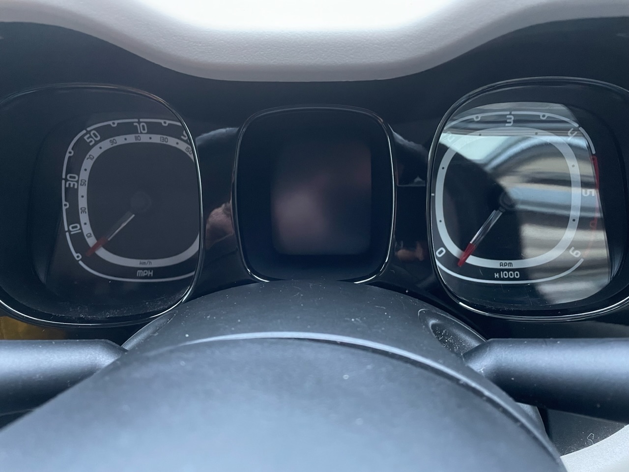

Now, next question. Where does your needle sit when the engine is off? I had clocks out, my 11 yr old child had a look at them, remarked how the needles wobbled around when you turned it over. As I had the cover off it isn’t beyond the realm of possibility that a finger may have prodded at the needle… So here’s a pic of where my needle sits at rest. What does yours do?
Notice the speedo needle rests at 0, the rpm needle drops below that. So it may just potentially be the needle has been moved on the shaft of the potentiometer.
