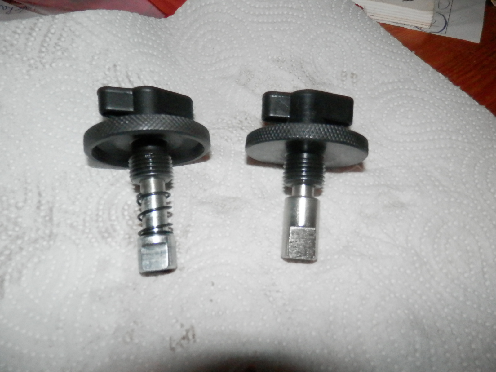

I was also thinking that the tools should not look like that, however I just tried my two different sets on my car. Only one of the sets screws in fully. The one with springs.

I was also thinking that the tools should not look like that. I have two different sets of cam tools. One set has springs so you can find the position and they will click fully into place as you move the crank pulley. For sure it is possible for the tools to be only partially slotted in because the angle of the cams is not correct.
Ok so you agree with Berne, that my cam tool should not be sticking out? I do not have the cam tool with the spring on it. Mine you push in until it slots into the cut out and they you screw the black thread down to lock it in place, which mine does do but 1-2 threads remain on show before u cannot tighten it anymore.??? I'm not sure if maybe they are slightly different for the 1.4 16v and the 1.4 16v TJET???
My apologies. I just tried my two different makes of tool. Only the one with springs will screw in fully. So no worries!

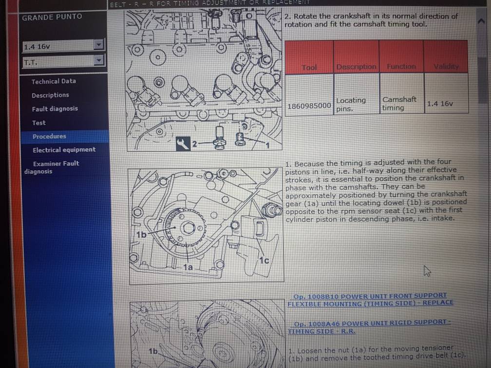

I read the elearning page.
You have followed that text correctly. However I was confused by the drawing of the supposedly fully tensioned tensioner as I had earlier told you your tensioner was not tensioned (when in that drawn position). Since I have an old tensioner it does seem their drawing is wrong.
Or maybe i am just having a senile moment again??

By the way it has not been mentioned in this thread but elearning covers it and I said you had correctly followed that text. But in fact i am not sure.
The crank shaft tools have to be fitted with number one on the down stroke.

I don't believe that is correct. I have just checked elearn for the 1.4 16v and it mentions about them being halfway up the cylinder aka "in phase" (see pic) and the if you look at that link to the TJET elearn it mentions the same thing also.20191027_195610.jpeg

The elearning instructions say to lock the cams, remove the belt and position the 1 and 2 pistons half way up the cylinders with number one on the descending stroke.
