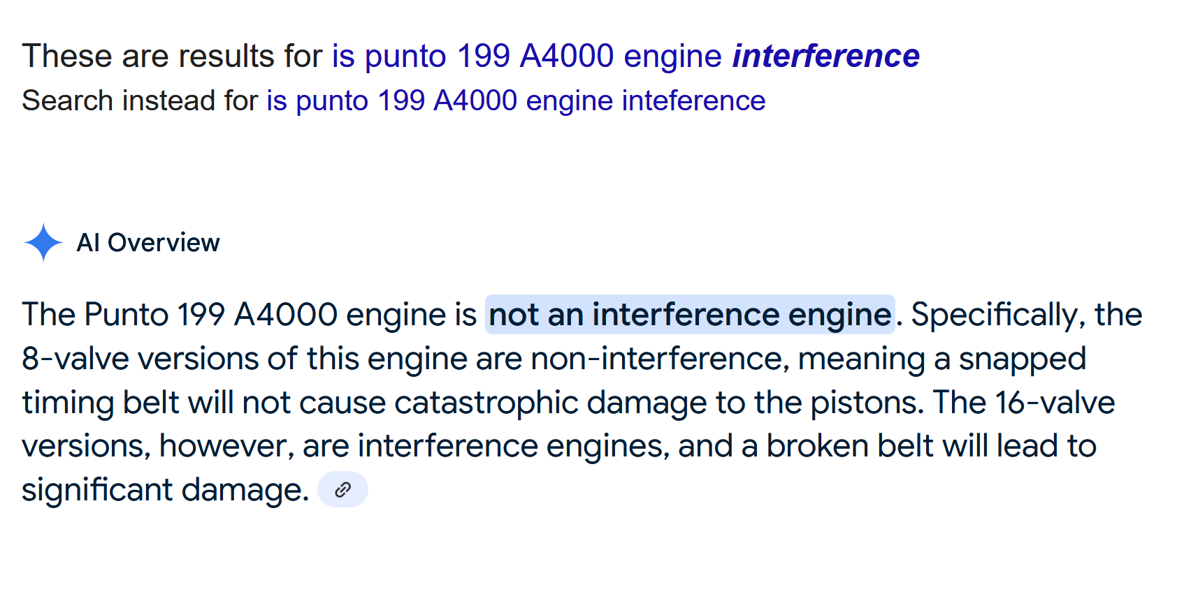

To my understanding this engine is meant to be a non intrusive engine correct? So this shouldn't happen but it is.
My guessing is the engine is done and perhaps the last bit of damage to kill it has been done by myself along with everything previous person had done.
Sad to say it's going to need a new one.
How many miles are on the engine? They're tough as nails, so as long as you're south of 150,000 miles i don't think the engine is dead.
I have one of these engines and was under the impression it was non-interference, so either the manual linked is wrong or the engine is available as interference and non-interference? Maybe i'm getting mixed up with VVT?

Surprisingly it's under 100k, the little AI overview even says the 8 valve is a non interference engine so I'm at a complete stump as to why I'm having these issues.

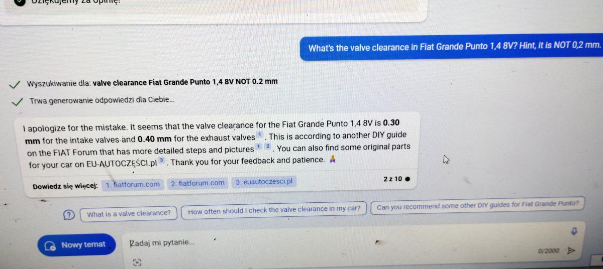

Don't ask "AI" anything. It's dumb as f*ck. It's still a PROGRAM. It doesn't "think" at all. Random question (valve clearance).
With little feedback (it's NOT 0,2 mm) it can find different answer (but it still cannot comprehend if it's right or wrong and why)...

.... Don't ask "AI" anything. It's dumb as f*ck. It's still a PROGRAM. It doesn't "think" at all. Random question (valve clearance)......
Ah YESSS, too true, Well done sir, I doff my hat to you 🙏 , Not many people realise that.
It's absolute junk, and a glorified Siri/Alex, and don't know Sh*t+ that you couldn't find yourself (if google would let you).
As I mentioned above I think it should be non interference - but not everyone agrees.
