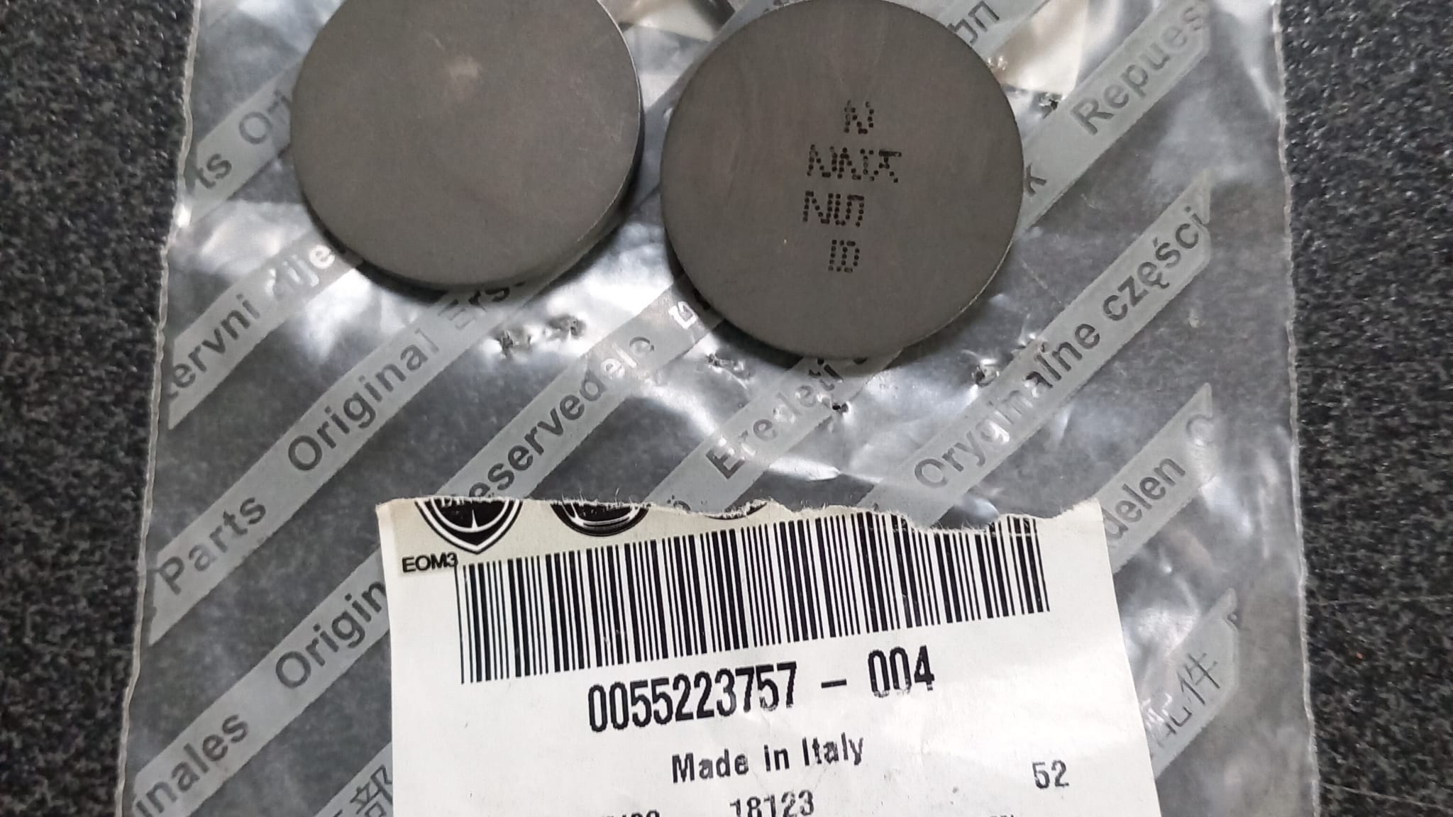

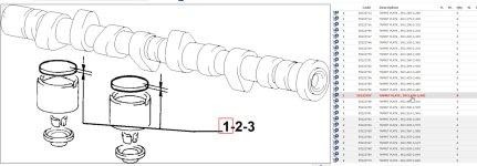

For the 1.2 8V engine the clearances are:
Inlet 0.35 +/- 0.05 mm
Outlet 0.45 +/- 0.05 mm.
To adjust them you have those adjusting shims (tappet plates) that you need to replace with the correct shim size if clearence is off.
New shim size = (measured valve clearance - specified valve clearence) + old shims size.
The shims look like this and are placed in here

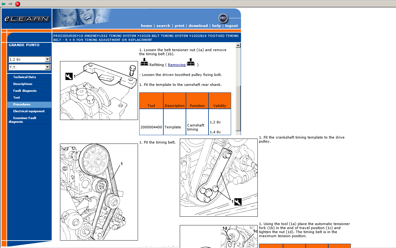

By the way, old eLearn (CD version) clearly states, that timing belt in Grande 1,2 8V is done with timing tools (same as 1,4 8V + VVT), so "old-school TDC method" is not needed (I mean: using tools cannot cause such trouble). But you must use full method (not mix them: TDC + one jig from the timing tool set).

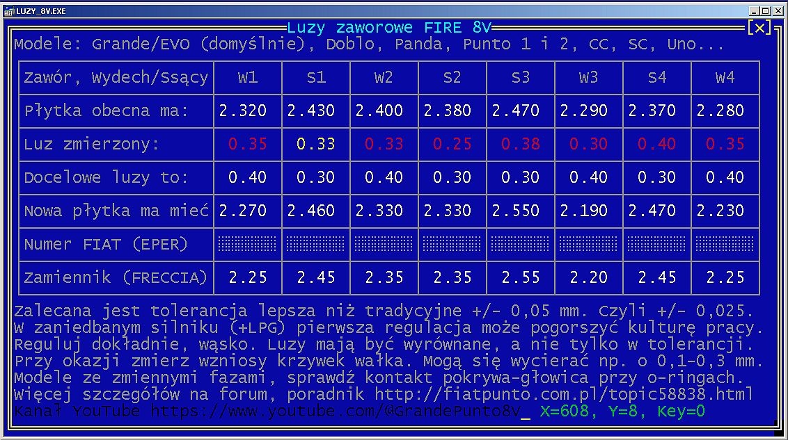

So going by the guide for the shims they should be at around 0.30 for intake and 0.40 for exhaust.
My question is how do they need to be checked? Is it where they slide between lobe and shim nicely or where you need to give them just a little push the go in to rest it?
This is them just sliding in and out no resistance or anything just nicely.
Intake 0.30
2- 0.33 shim 2.43 = +0.03 = 2.46 needed
4- 0.25 shim 2.38 = -0.05 = 2.33
5- 0.38 shim 2.47 = +0.08 = 2.55
7- 0.40 shim 2.37 = +0.10 = 2.47
Exhaust 0.40
1- 0.35 shim 2.32 = -0.05 = 2.27
3- 0.33 shim 2.40 = -0.07 = 2.33
6- 0.30 shim 2.29 = -0.10 = 2.19
8- 0.35 shim 2.28 = -0.05 = 2.23
If this is the case then all but 1 needs replacing which will be a big expense.
If it's the tight fitting and I can get away with it I only need to replace 3 and all will be within tolerance in the + but all won't be at the same.
Zero clearance during measurement gives the feedback that feels like a slight drag, small resistance.
Same for calibrating tools, like micrometer + gauge blocks = when you're on size, there is a drag (should be).
That's how you develop "the feel" (how much force is needed/expected during various checks, using different tools).

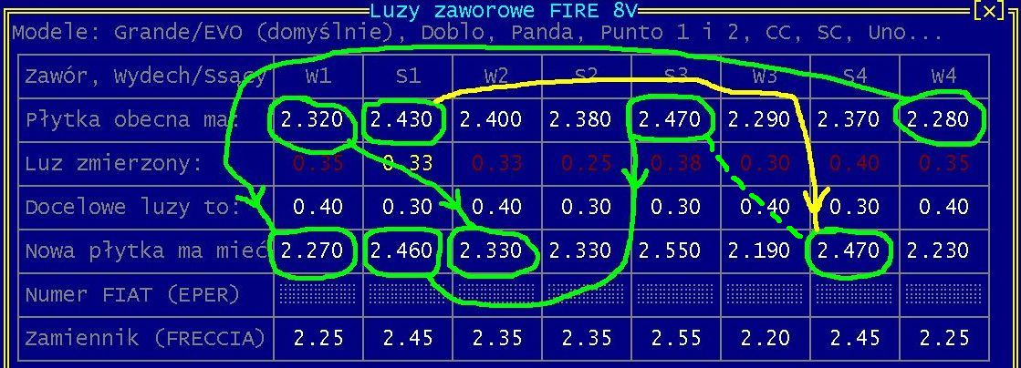

Your calculations are OK, here is a (re)check using old-school program (non-english unfortunately), works only under DOS and Windows 32-bit.
It utilizes mouse to navigate. Download (zip file), if someone is interested: LINK. Nothing to write home about. Translation (table)...
Valve, Exhaust/Intake / Current shim is / Lash measured / Desired lash is / New shim should be / EPER part number / "Freccia".
Grande model is default (clearances 0,40 / 0,30). It spits also rounded values for aftermarket shims (0,05 mm increment). Brands like "Metelli" or "Freccia".
You can swap 3 or 4 existing shims (so only 4 or 5 to be purchased, not all eight)... Example below (options, alternatives).
Again, main goal is to be equal/even (lash), then the value (is it perfect, or smaller, or a bit bigger - but make ALL clearances bigger, that's the point). Being "in tolerance" for the sake of it, is NOT a primary goal of the valve lash adjustment procedure (it's a secondary goal).
But, first of all, make sure that your valves are not looking like that (use USB endoscope). Adjusting lash in such case is pointless, doesn't make sense.

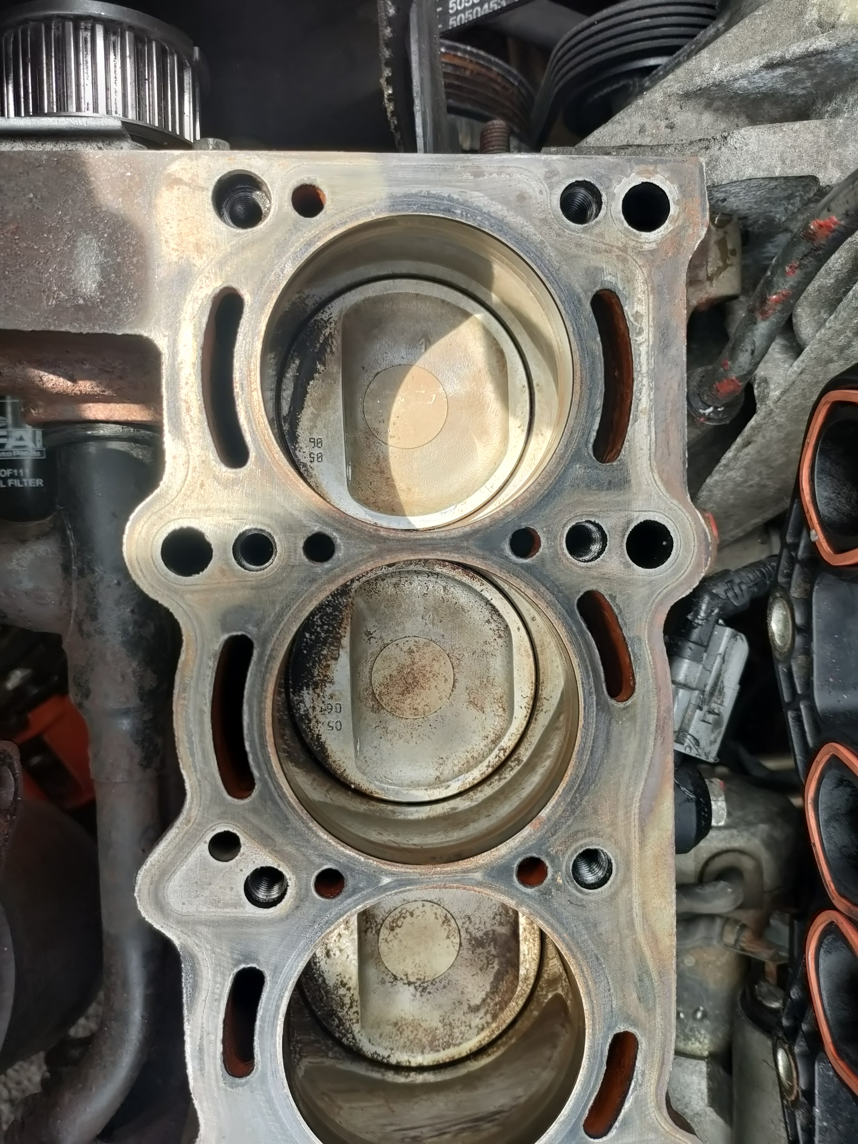

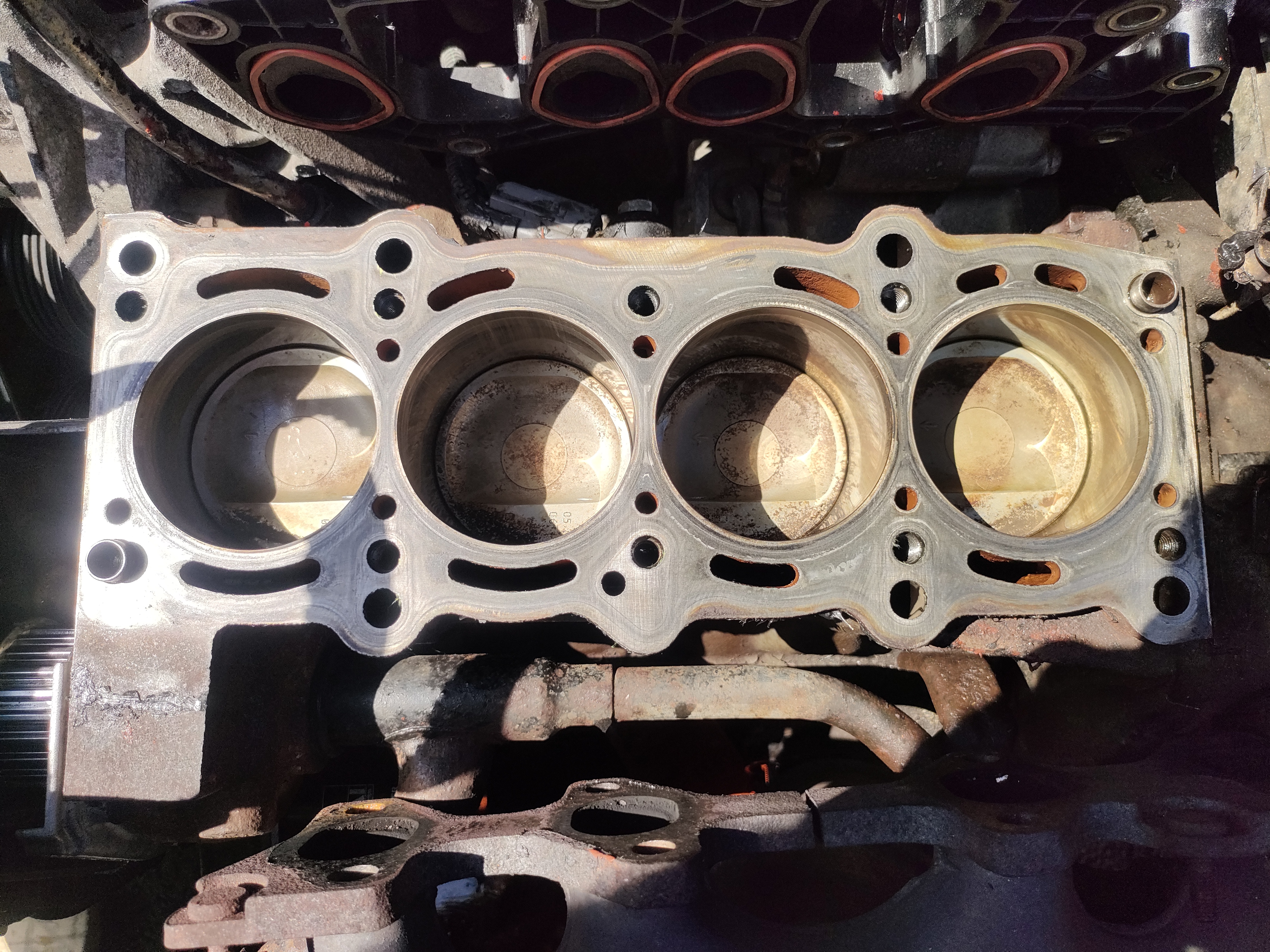

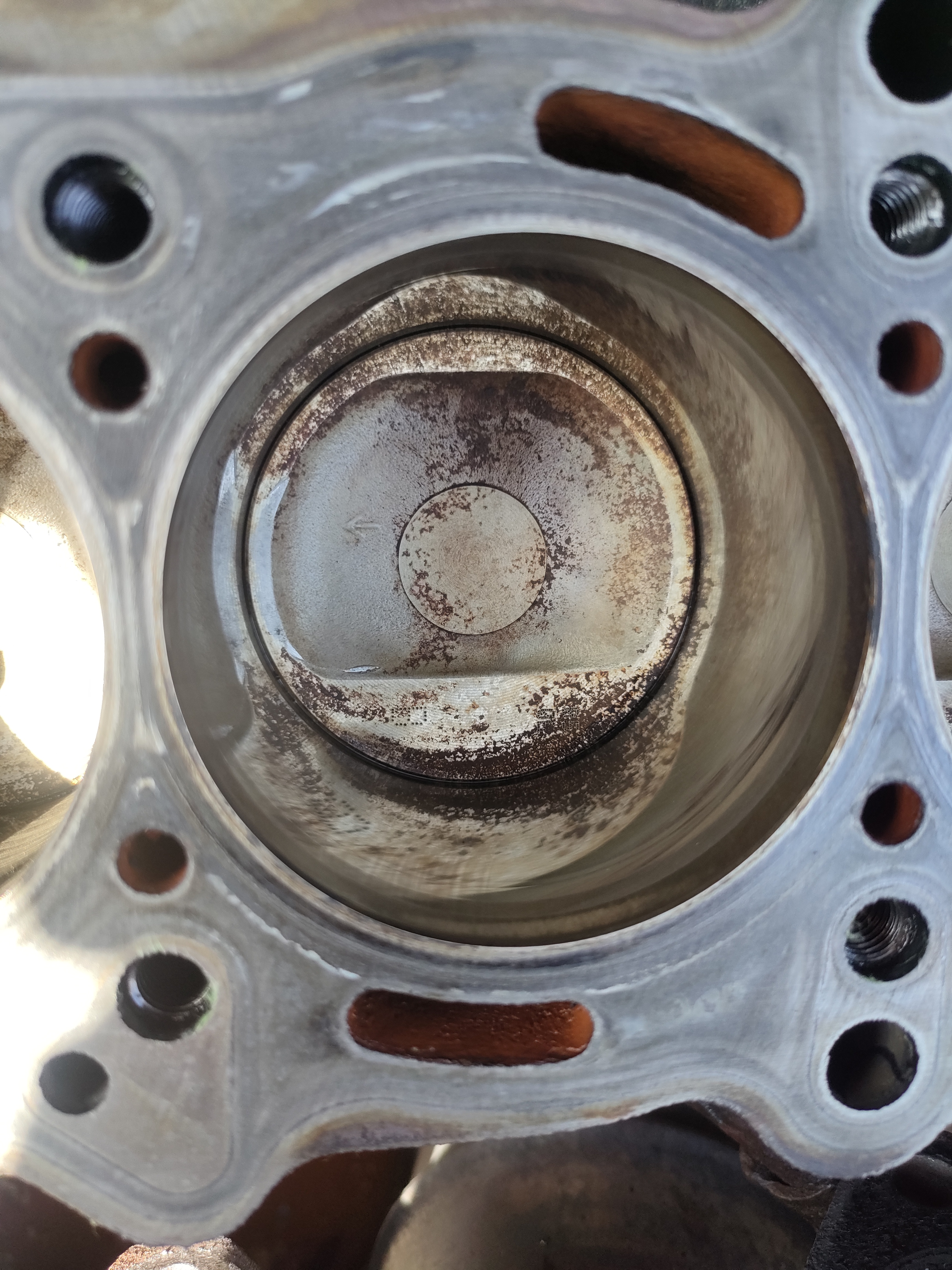

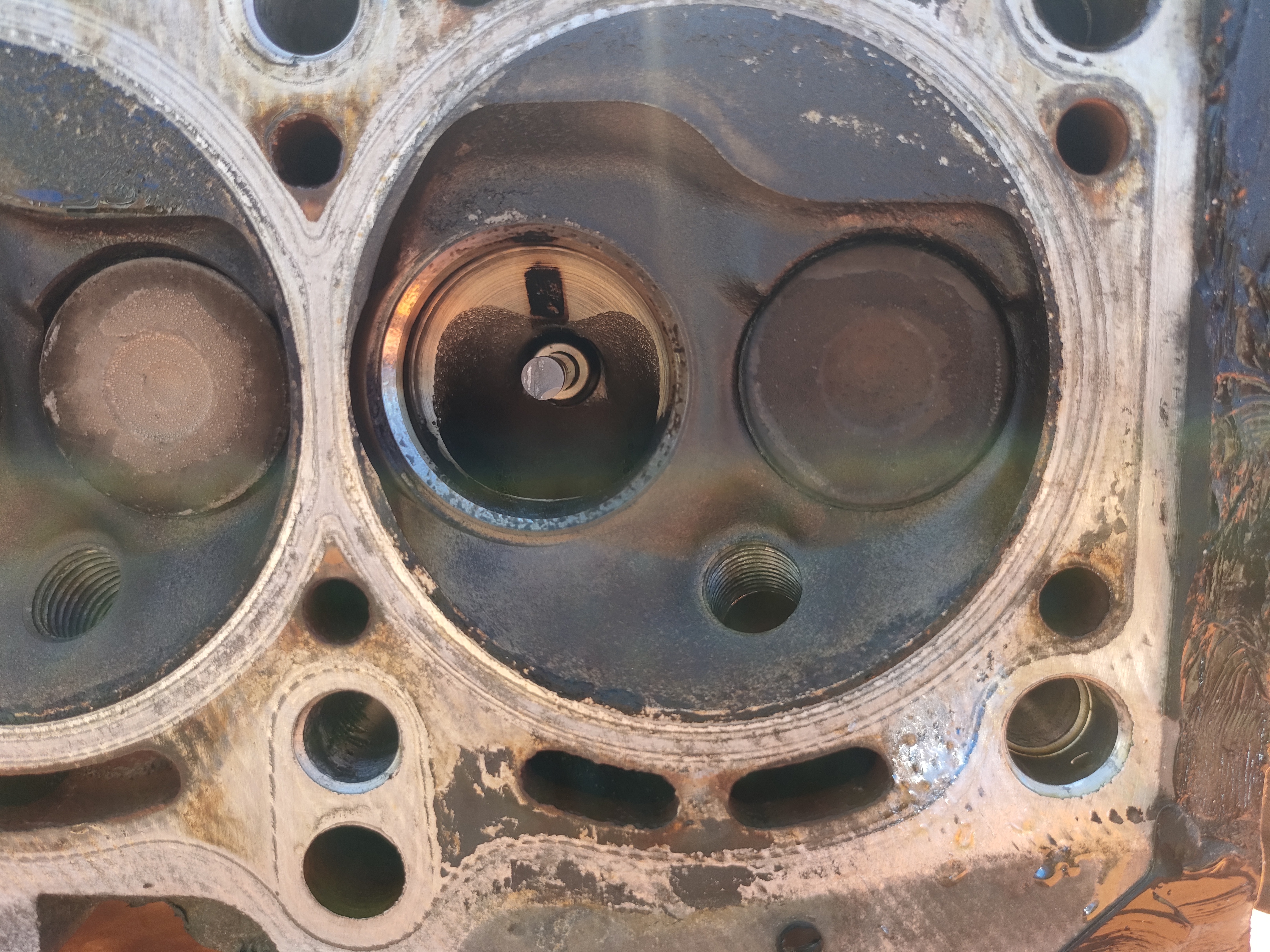

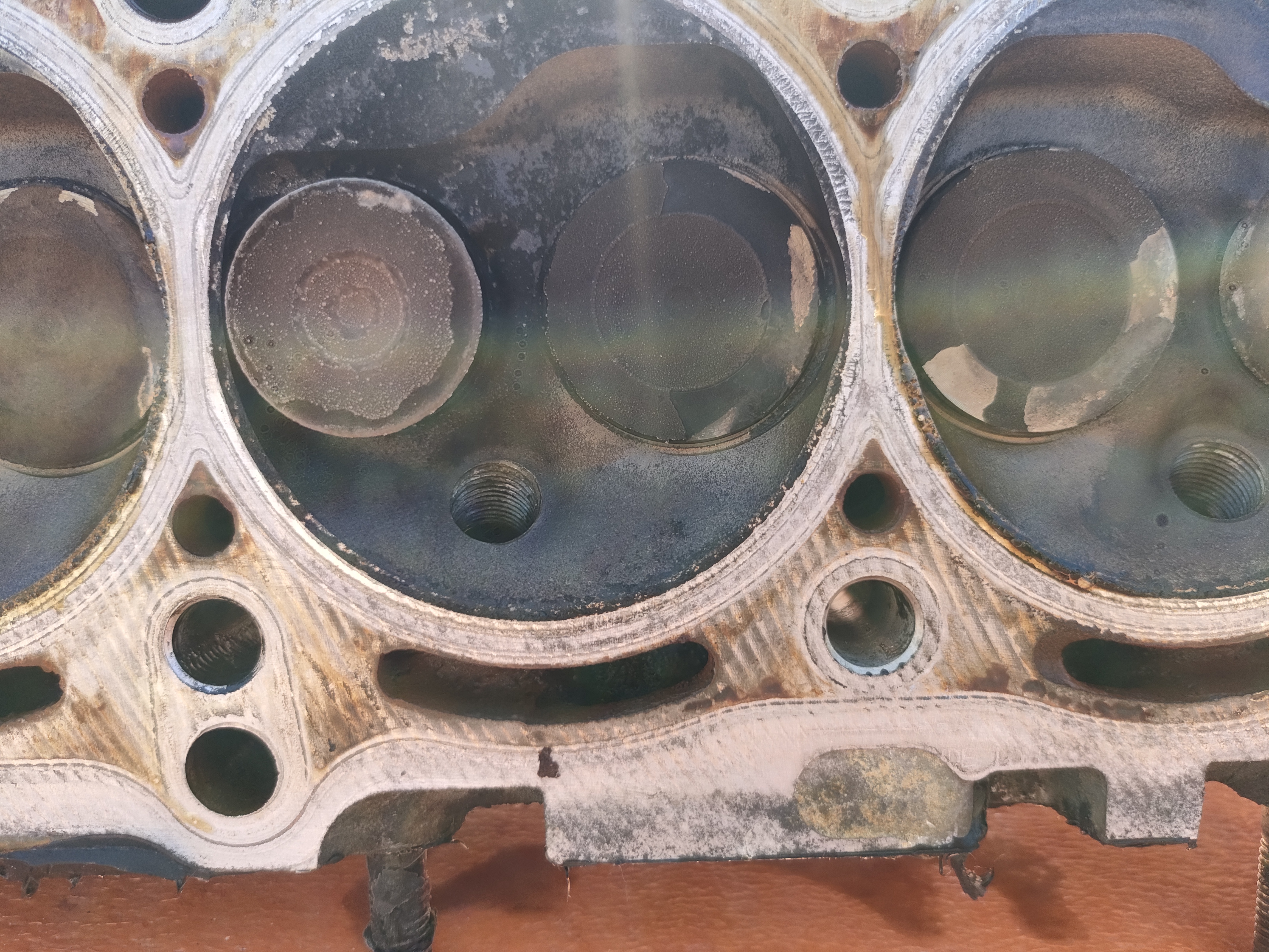

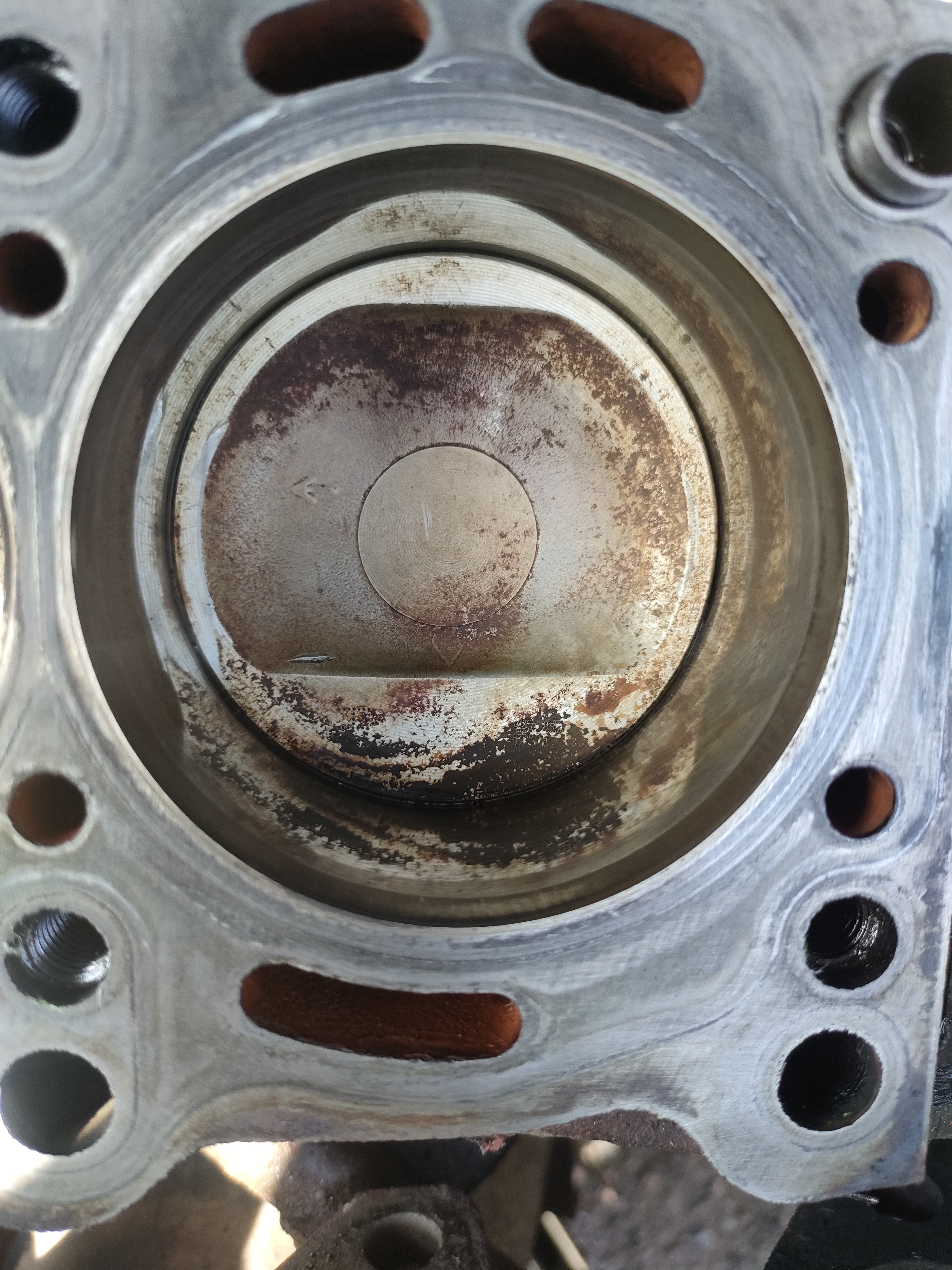

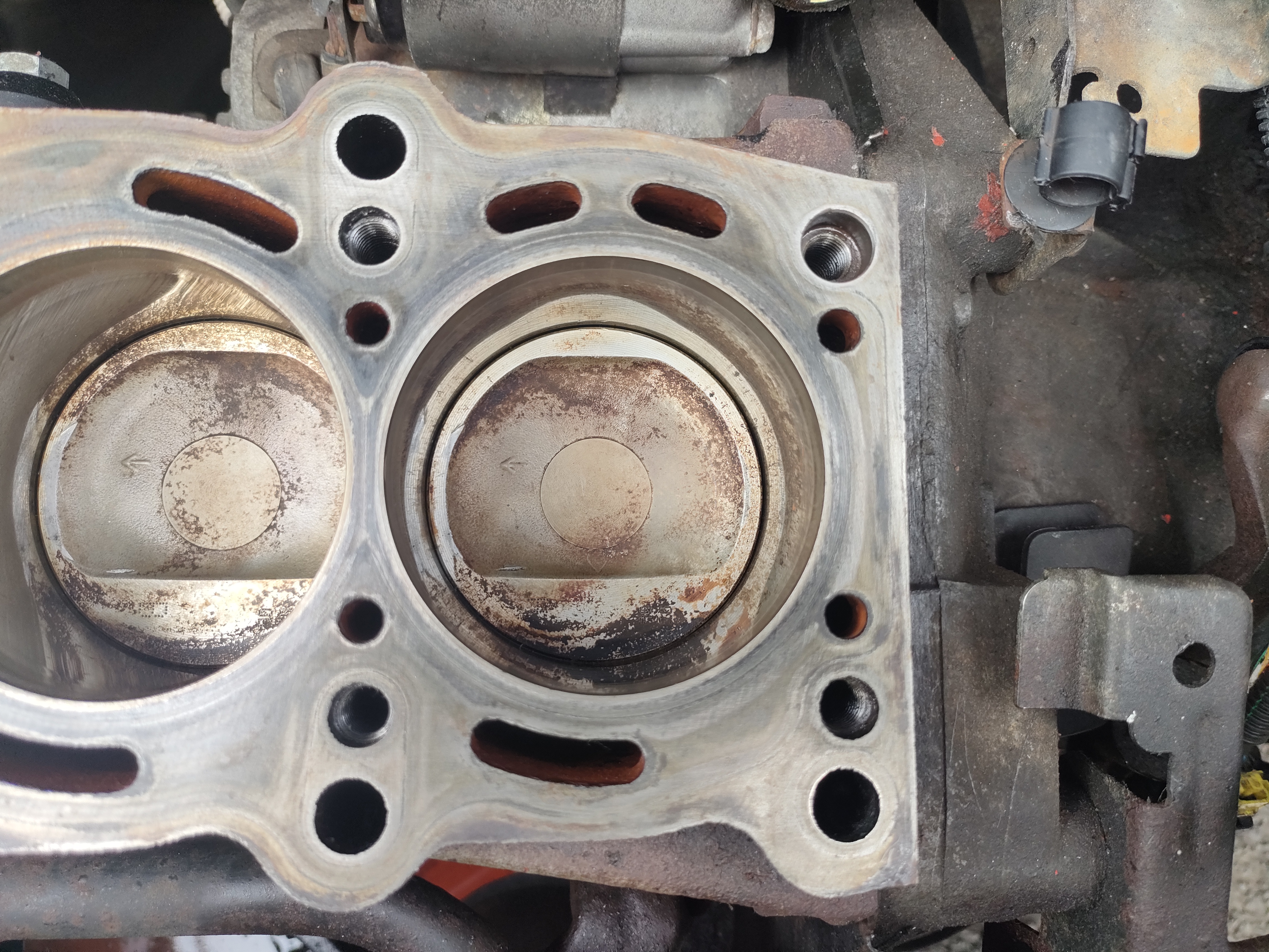

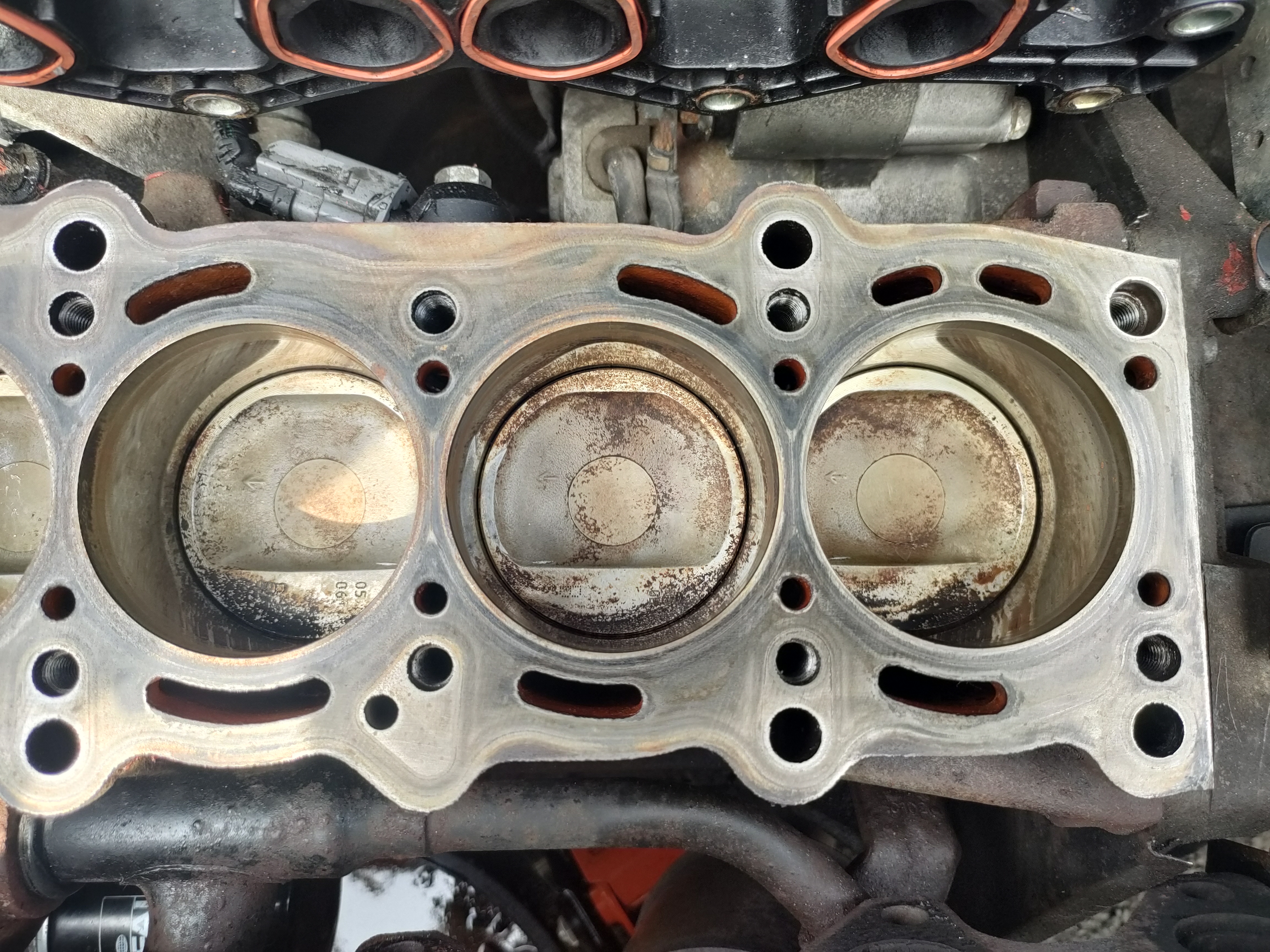

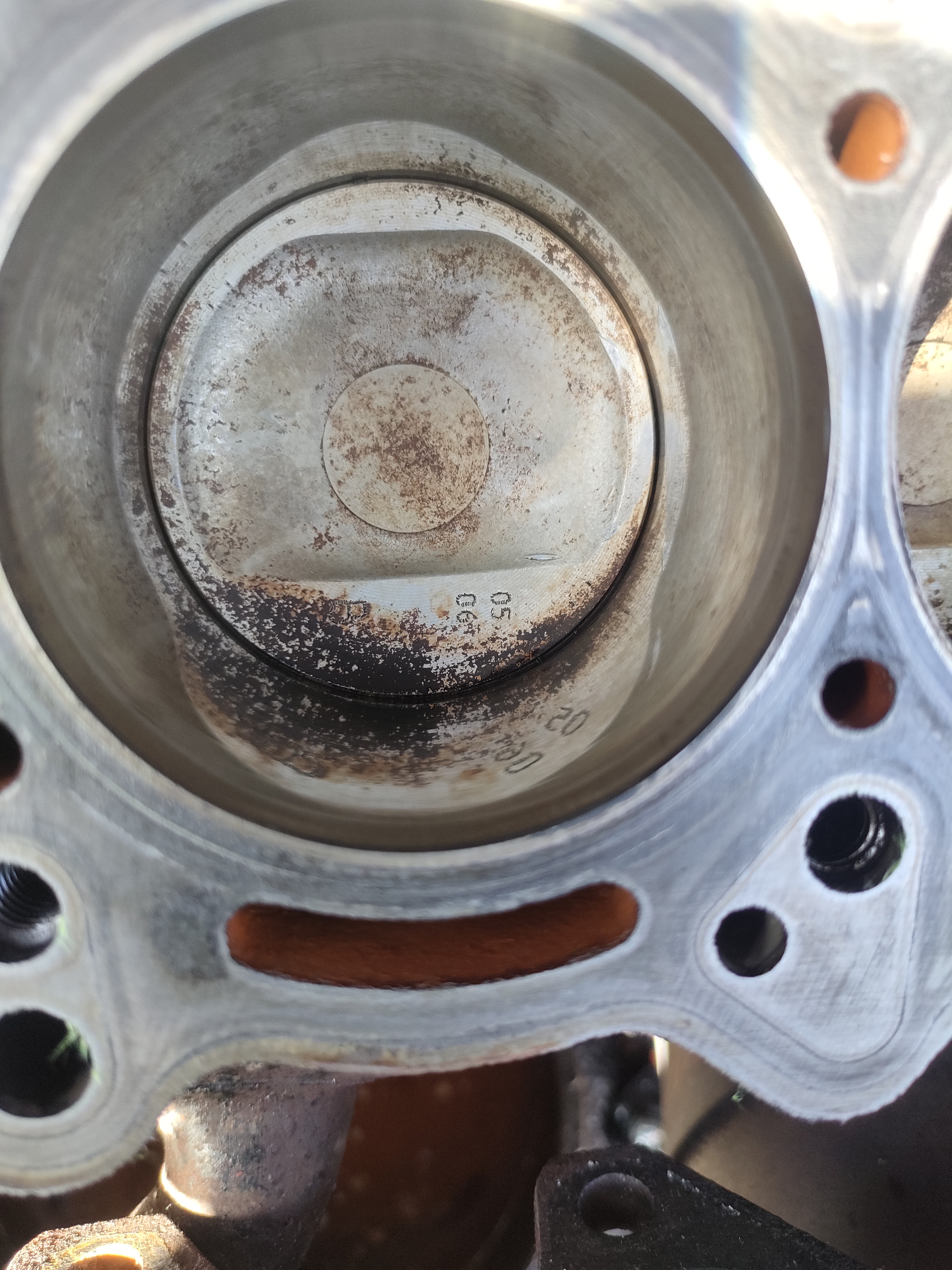

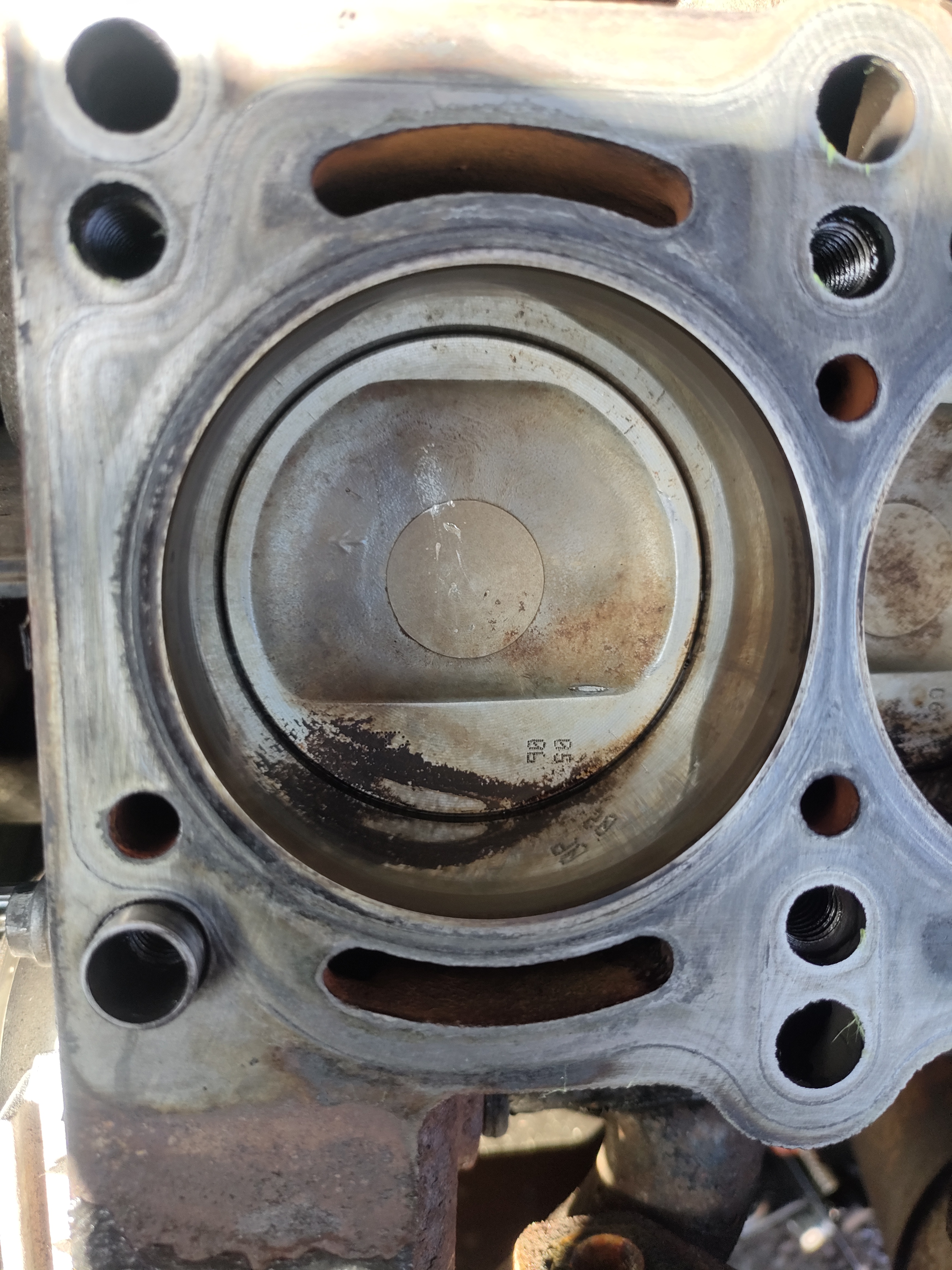

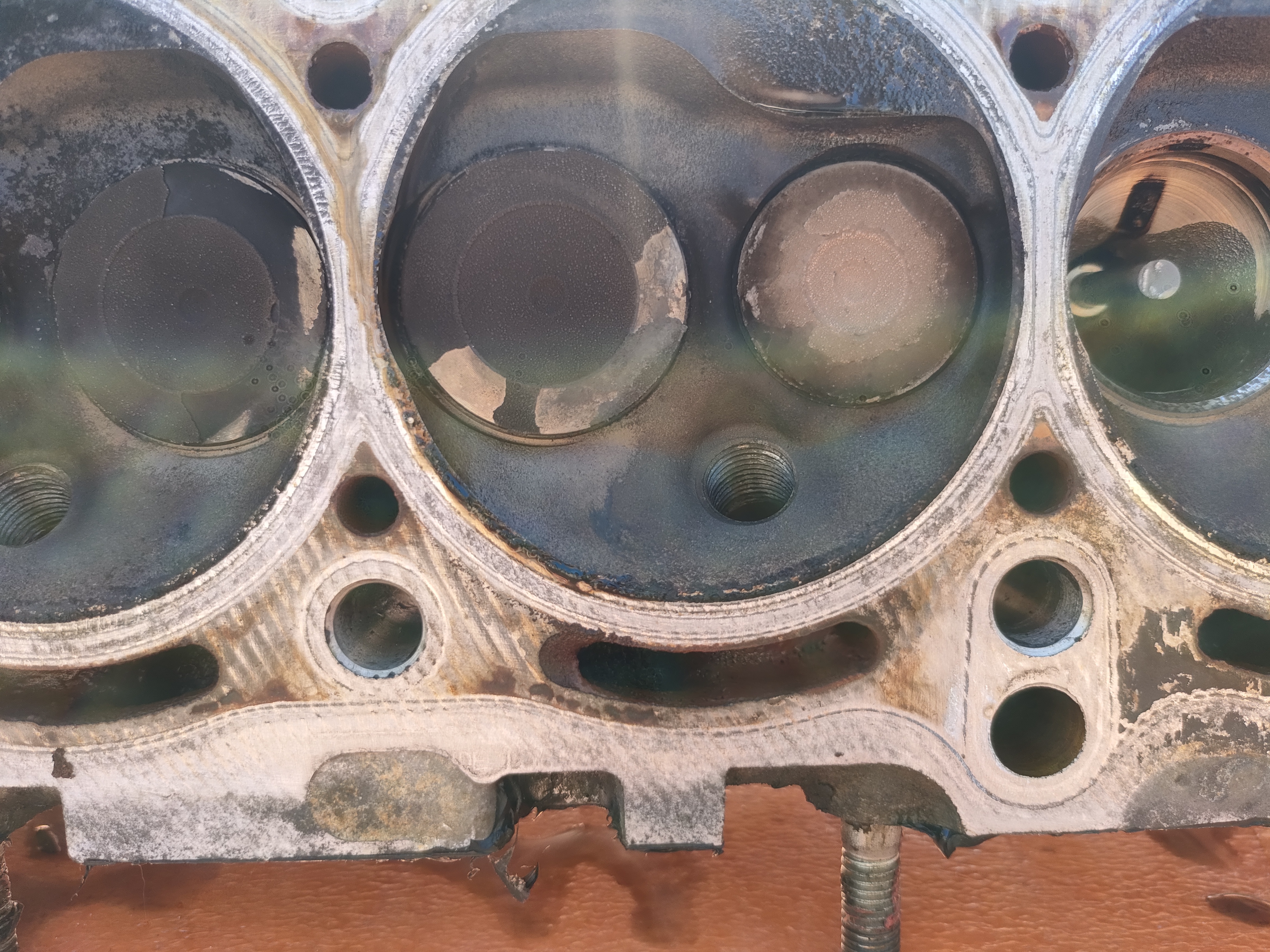

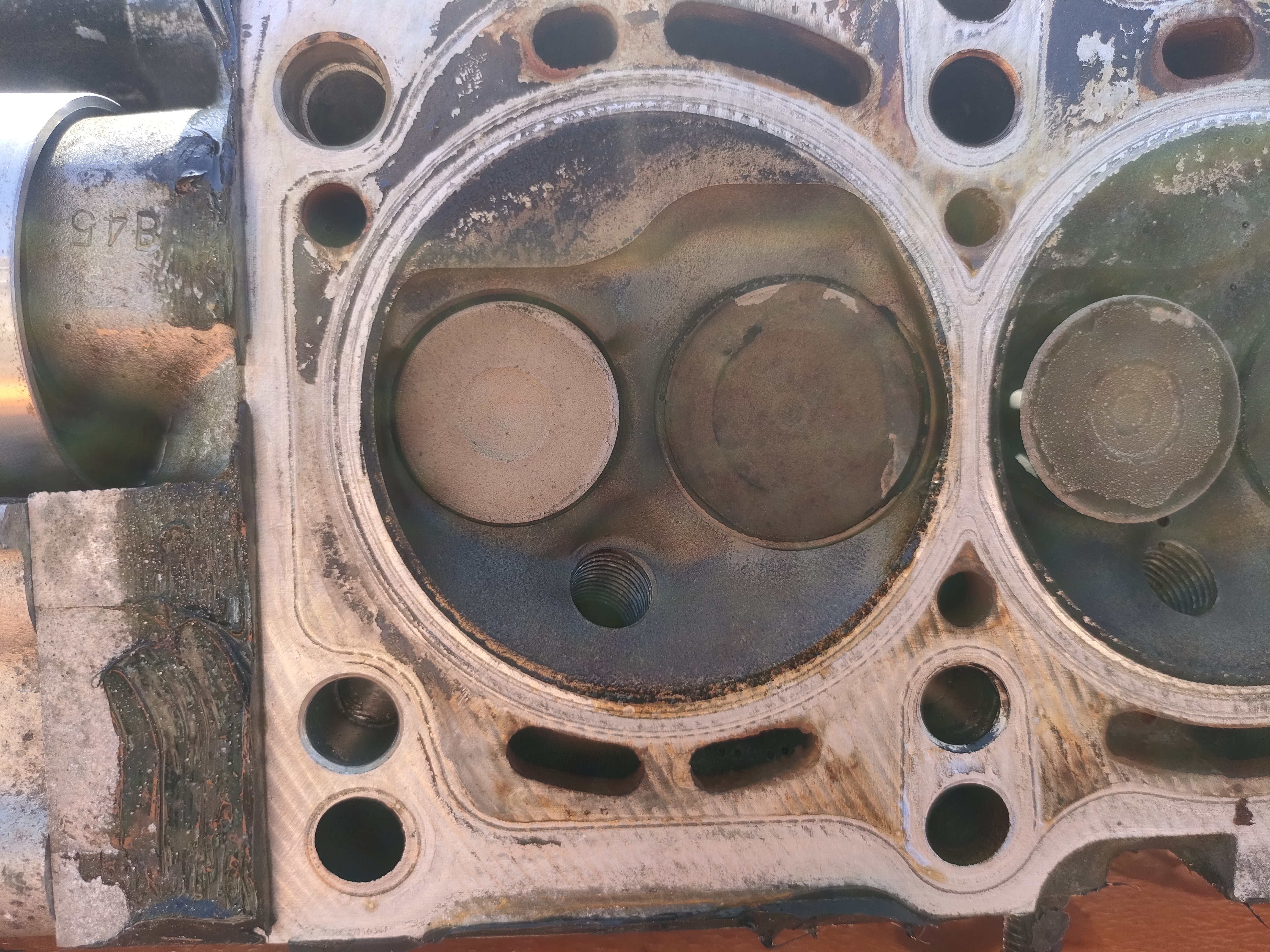

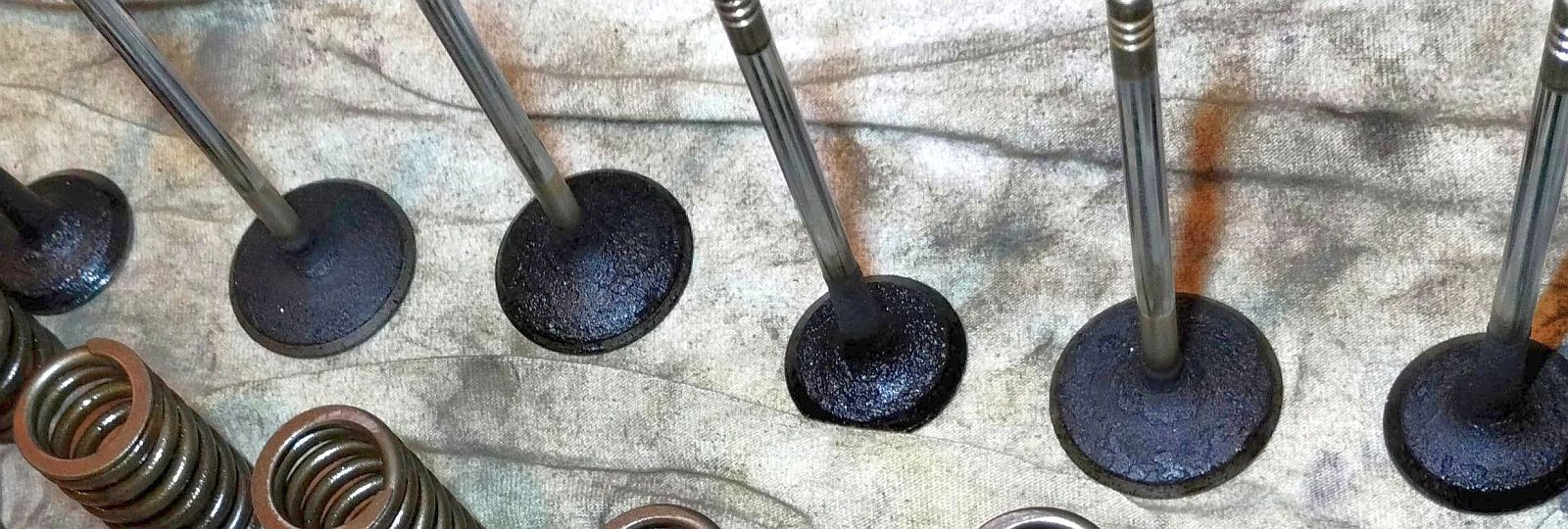

Hi sorry been a few weeks since my last post.
Ran into a problem where a valve snapped luckily only made a slight indent on the piston so been doing my homework slowly and surely.
I decided it was easier (for myself) to replace all the valves and the stem seals (also done the valve seating with correct tools so now shiny), put cam shaft back on the head tested gaps and rearranged where needed. All but 1 is on the lower end being at a -0.05mm (no further gaps in them all) and no.5 is right on the money at 0.30mm.
Firstly wanting to check will this run when back together?
Also wanting to check since both are apart I know I need cam to have the tool to fit at the end being that is correct timing place for it but what point is best for the crank?
Having them all half mast or 1/4 at top before putting everything back together?
Also top of the engine block is fine I've gone over a few times with a straight edge and checked gaps as well as bottom of head is fine, both clean and tidy (best it can be without skimming).
Have full new gasket set along with bolts (I don't like to reuse when it's for torque in engine better to be safe than sorry)
All seals that come with it have been fitted and old thrown away.
This is my last point of call after research just to ask the questions and get them answered that way full learning has been acquired.
These taken before cleaning fully ect as you can see 7 snapped, this is the same one that was previously replaced.

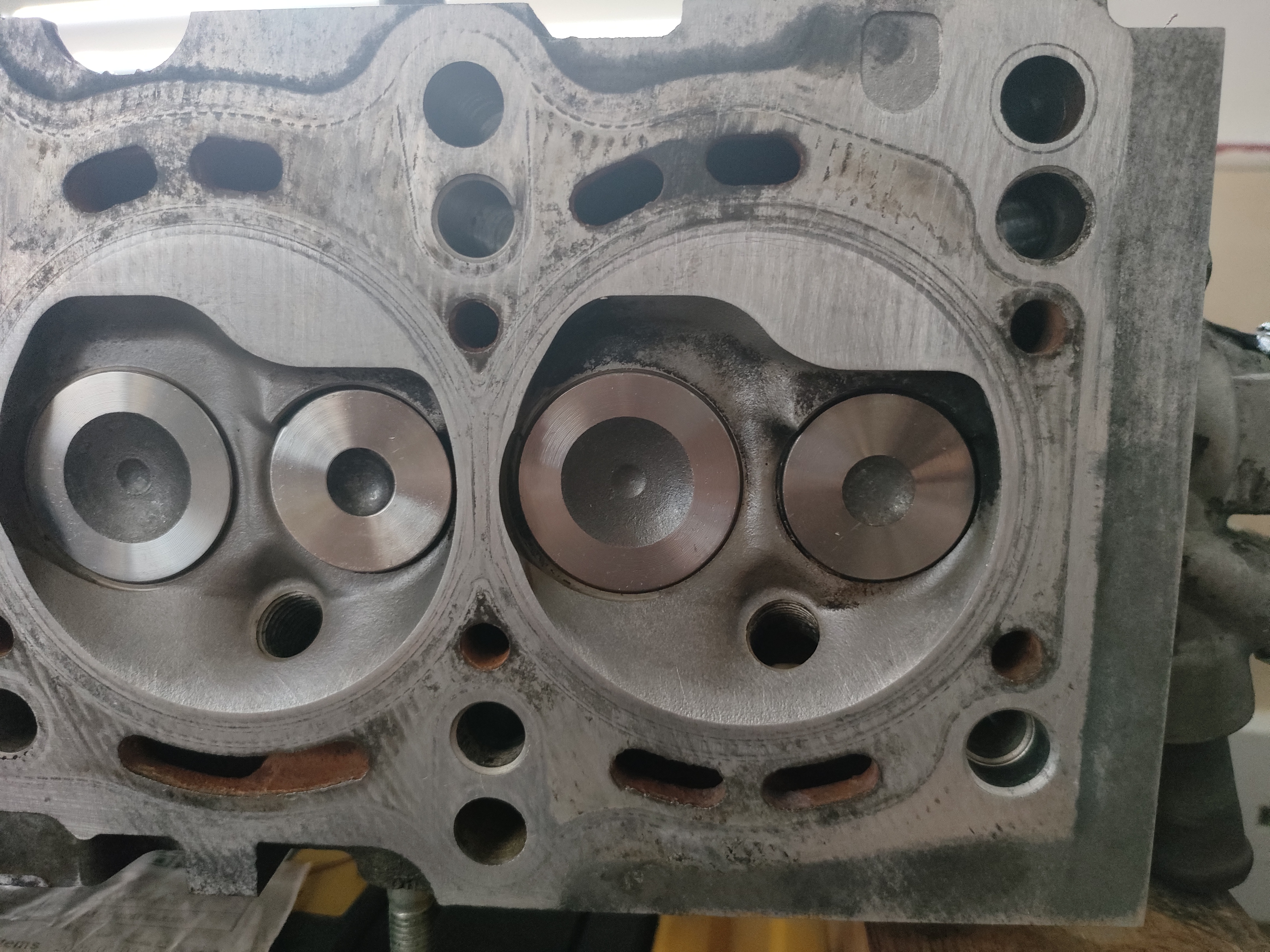

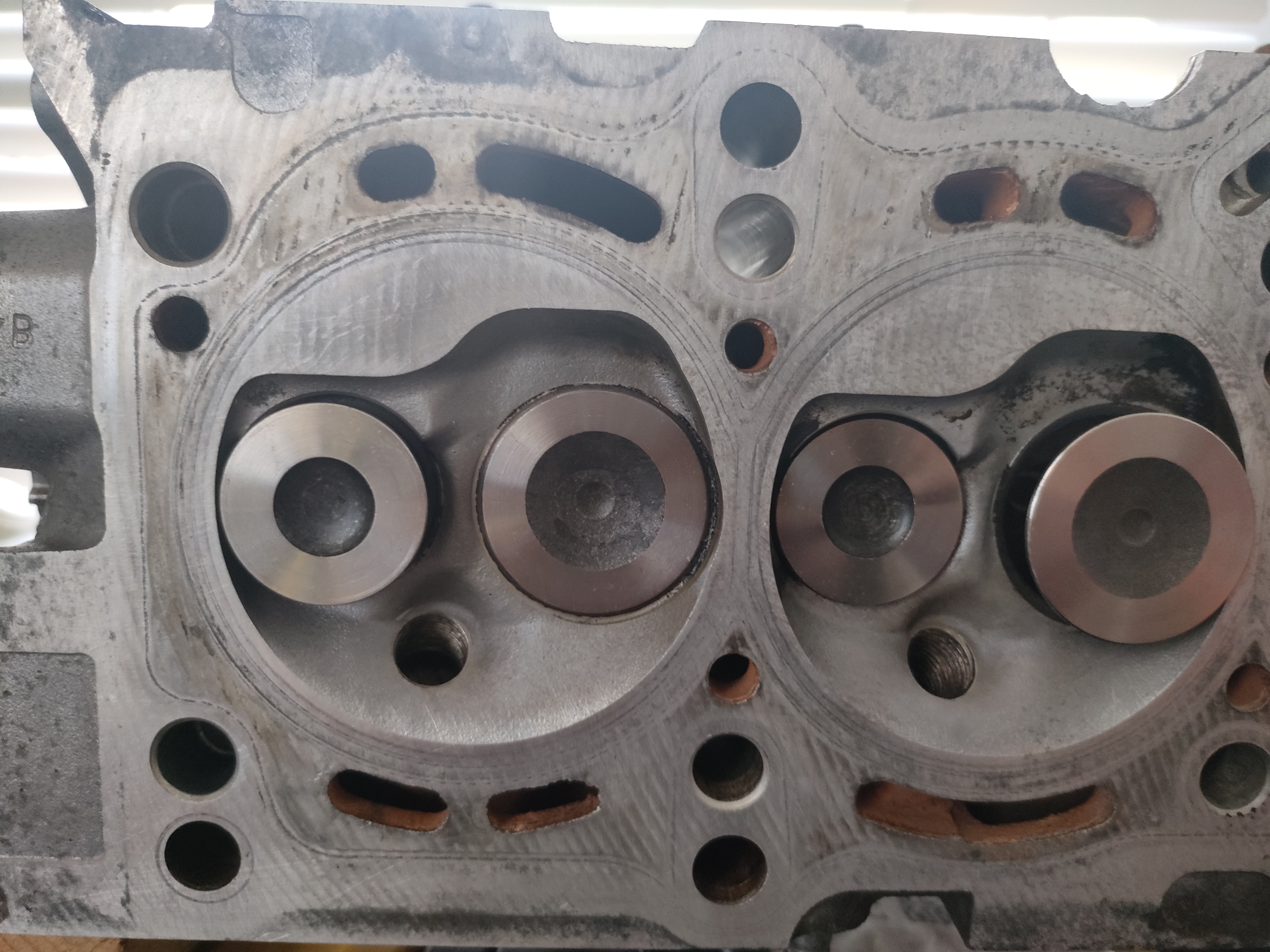

Here is is "cleaned" and new valves
