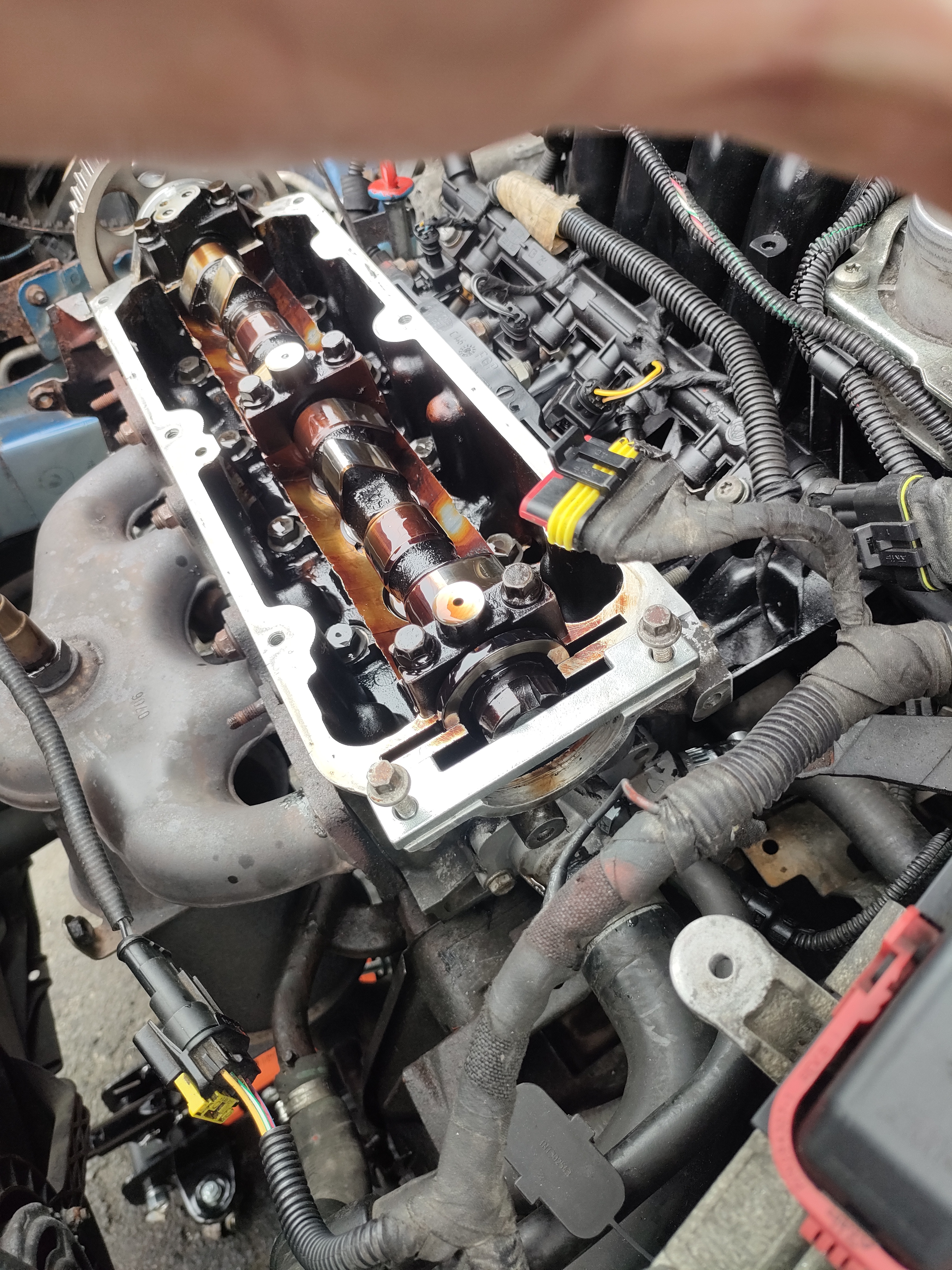

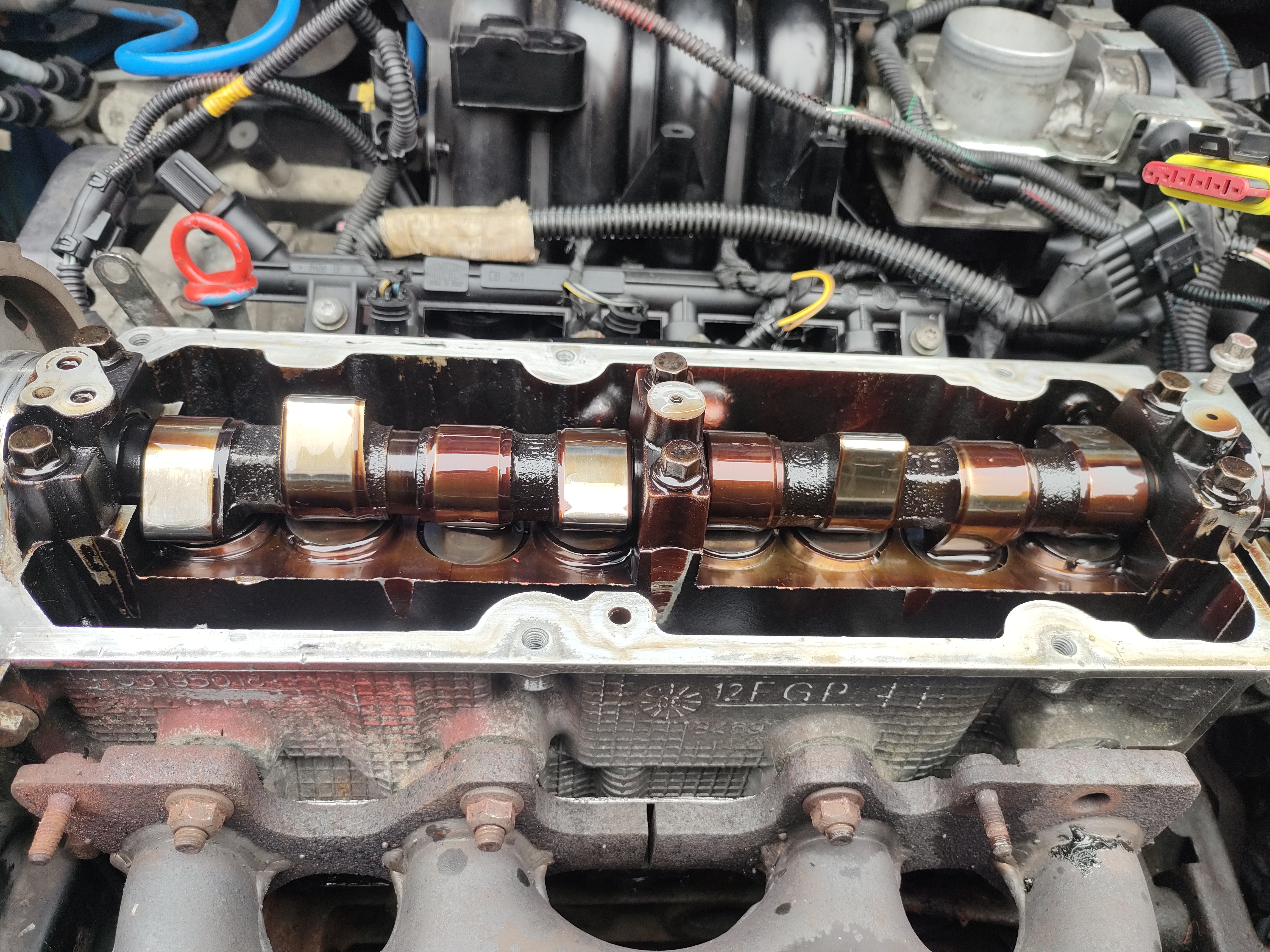

So bit of an update, done all that has been told, when doing the first 2 turns with full tension it all stayed the same albeit a tooth out on the cam side weirdly ( would need 1 tooth in forward direction for it to allow the tool in easily.
Done 4/5 more turns with forks on tension being aligned but now the forks have moved.
I'll post pics of everything to now.
First lot are before putting belt on
Next post will be after and then where I'm currently up to.
You'll also see in a set where oil is coming out from is this normal?

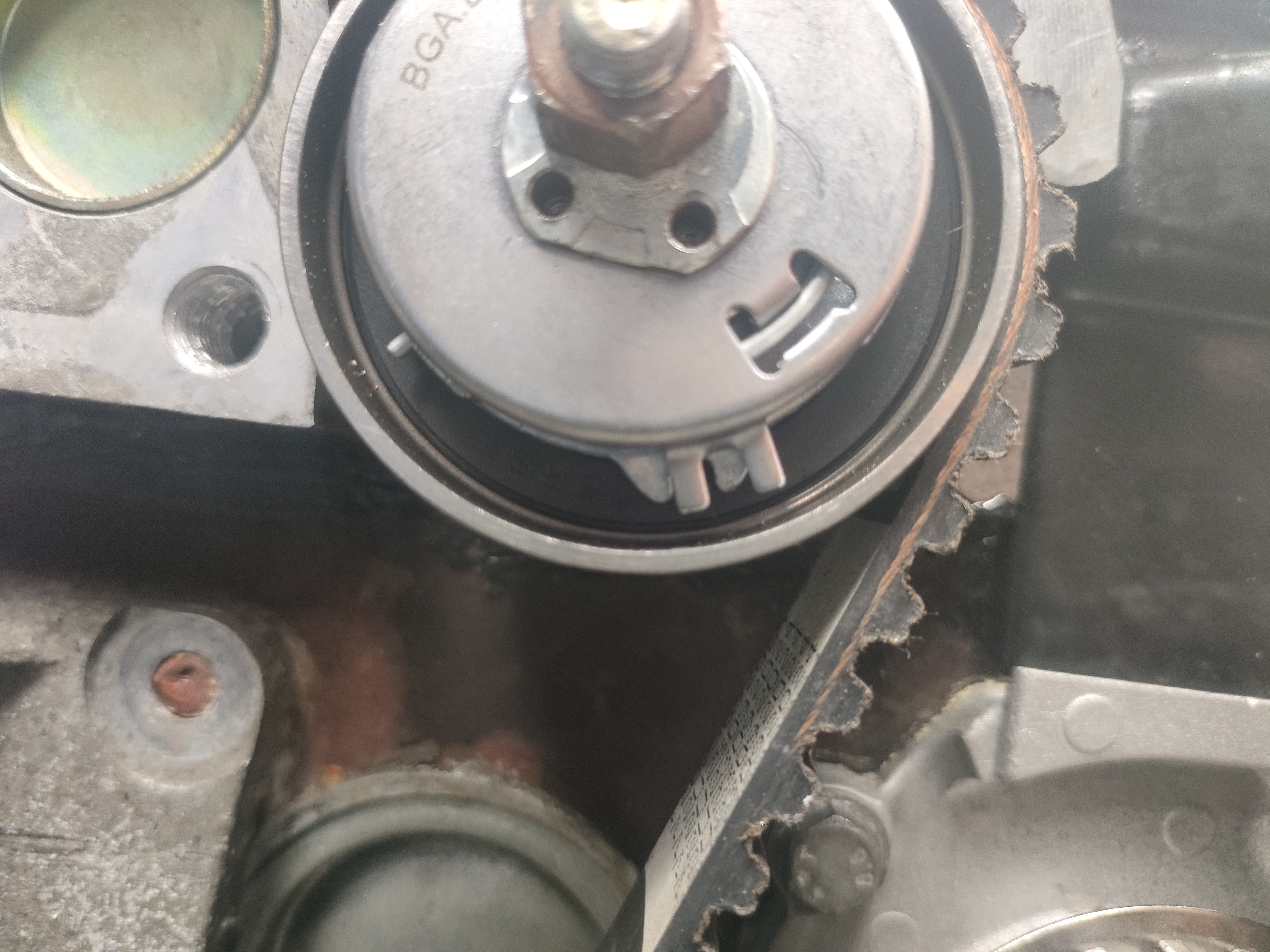

Done another 2 turns and it's staying in that same position, is it worth just moving the tension forks again?

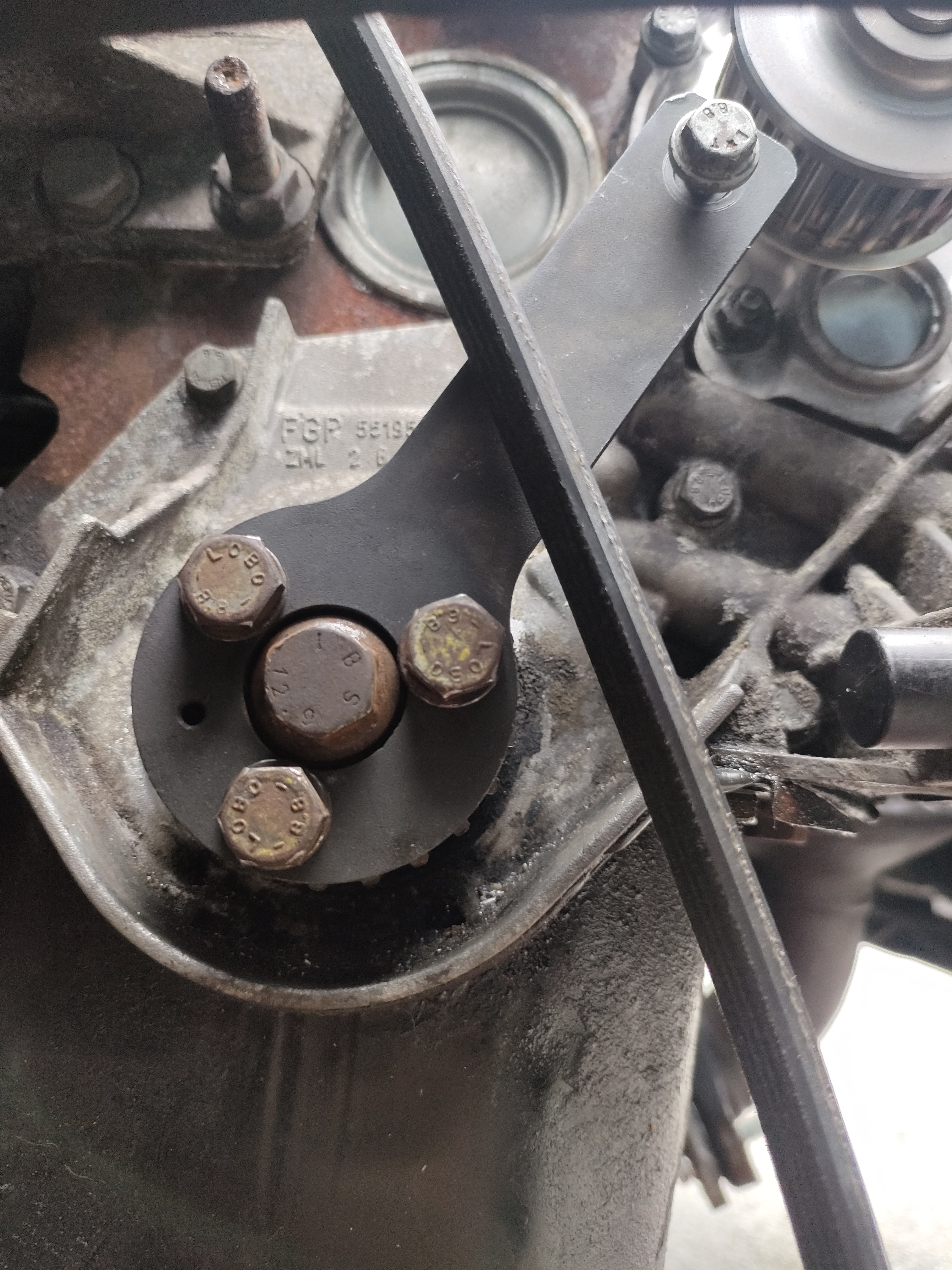

I can't see from the picture of the dumbbell whether you've got the little "pip" in the little hole of the dumbbell? I guess you have? The cam locking tool looks engaged correctly.
Did you slacken the big Torx bolt in the middle of the cam pulley at any time? If not then it's all looking good. I'm asking about this because that's what's giving you the "problem" with the "one tooth out" You probably need to slacken the tensioner again and turn the crankshaft anticlockwise just enough to allow the belt to be positioned one tooth back on the cam pulley. When you then take up the slack by turning the crank slightly clockwise and retighten the tensioner you should find that with the crankshaft "dumbbell fitted then the cam locking tool will just "fall" into it's slot.
The tensioner question is a little more difficult. When you first fit a new belt you are supposed to "overtighten" the tensioner by rotating it until all the spring movement is used up. Then rotate the crank a turn or two to fully settle the belt and finish by backing off the tensioner until the fork marks line up. Because of this "stretching effect" on the new belt many say it's only possible to correctly tension a new belt once. Which means they are advising a belt can only be tensioned once! Ok, if that's the "official" advice then who an I to doubt it. However I have refitted "used but good" belts when doing head jobs etc and never had a problem. (Always mark DOR with an arrow if you're intending to refit a belt) Myself? If the tensioner fork doesn't line up after I'd done the initial crankshaft turns by hand, I'd be readjusting it until it does. I've noticed when rechecking a new belt after maybe a couple of thousand miles, that the forks are always just slightly displaced. And, more interestingly perhaps? the fork positions vary slightly depending on whether the engine is cold or fully up to operating temperature - Which, to my mind is entirely logical as the crankshaft and camshaft pulleys will be very very slightly further apart when the engine is hot due to expansion of the block and head. Looking at the tensioner of a belt which has a lot of miles on it never has the forks lining up exactly. So I'd say that having the forks lined up exactly is the ideal position but the spring allows for taking up the tension anyway when running and as the belt ages so being just a wee bit out is of little consequence. It just makes sense to line it up as near to perfect when fitting though, doesn't it?
Don't worry about oil coming out of that wee hole centre front of the head. That's the oil feed to the cam cover which takes oil up to the camshaft bearings via oilways in the cam cover. If you turn the crankshaft it's also turning the oil pump so if you turn it more than just a couple of turns then oil will come out of it. I once turned one of these with the cam cover off using the starter motor after fitting a cam belt - thinking that letting it spin over for a couple of dozen revs would let me see how the belt was settling into running on the pulleys - this resulted in an absolute fountain of oil comming out of that hole and dribbling down the front of the engine - hell of a mess and I won't do it again! By the way, when you come to finally fitting the cam cover make sure the groove the gasket fits into is clean and, especially at the corners, use a little sealant or it will leak.

Did you checked if the pistons are mid stroke (equal) or not (when timing tools are installed)? That was the main point here.
Timing looks OK (but we/you don't know where the pistons really are).
Official eLearn procedure is wrong: they tell you to tension the belt (max.), then back off (until "forks" aligned) = it will shift the timing.
This is natural. But such small shift will not cause any trouble (engine must start). So this is not a problem at all. Belts don't "stretch" (that's BS).
Same with "phonic wheel reset/adaptation/whatever". It is one of the most useless features in the FES/MES programs.
It does almost nothing (cosmetic changes). It has nothing to do with the engine starting (or not). So forget about it for now.
Clueless people are fixated, obsessed with it (forums are full of "advice" like that: have you done The Reset, do the reset, you must do the reset, your car needs a phonic wheel procedure, learning, reset,...crazy). Engine won't start = phonic wheel reset. Rough idle = phonic wheel reset. Misfire = reset... 🙃
