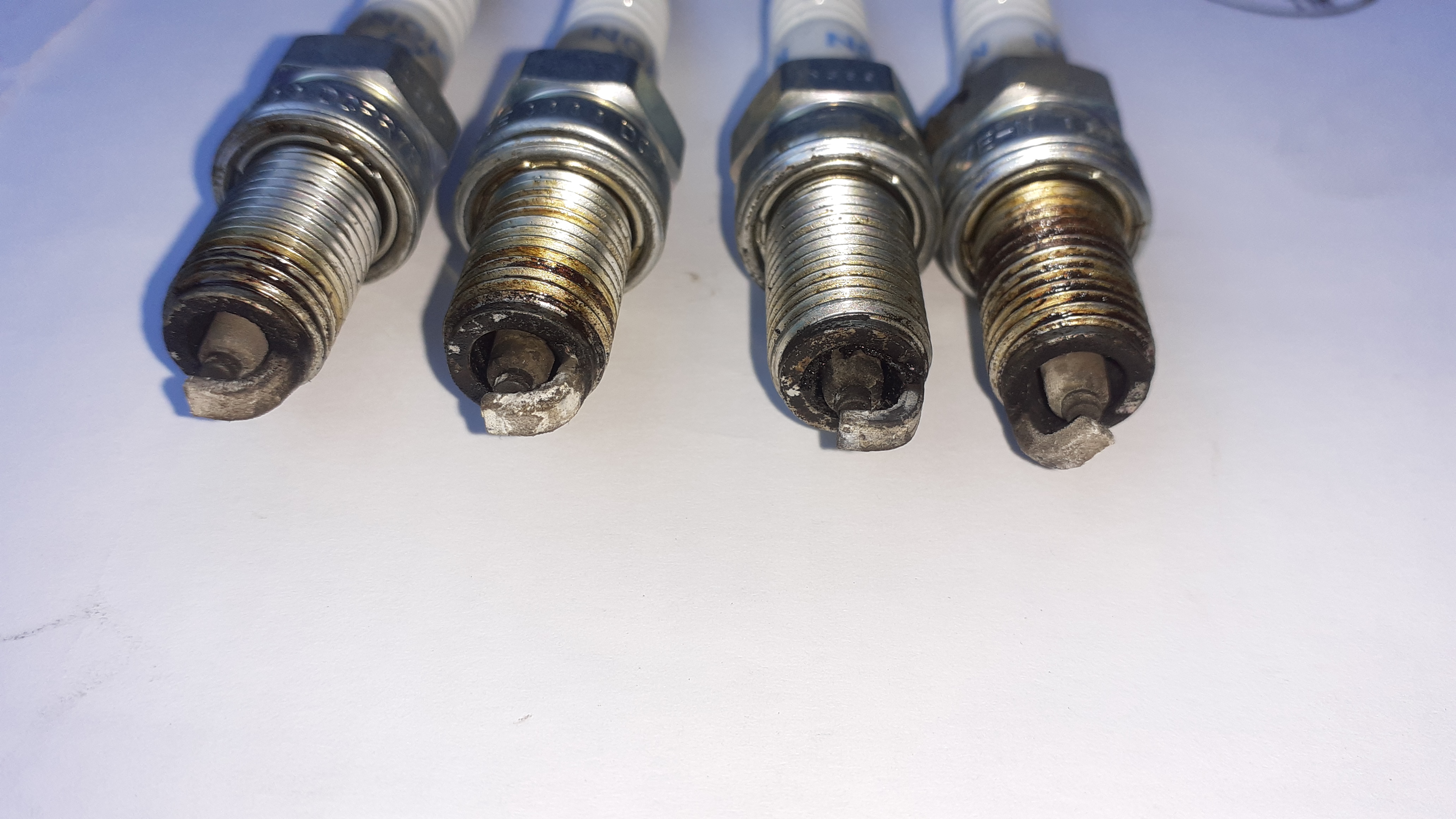

The engine runs well, but consumes a lot of oil, about 1.5 l in 1.000 kms and there are traces of oil in the combustion chambers, especially on the plugs as those are the parts I could see. There was oil on the plugs threads, so obviously oil gets inside the combustion chambers, kind of the same on all cylinders.

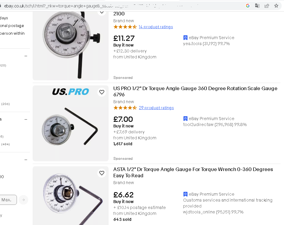

3. Your mechanic is a fool. "Torque + angle" is way more accurate than just torque (it is very sensitive to the thread condition, clean, dirty, dry, lubricated, if the turn is continuous or multiple steps). Turning a bolt with specific angle translates directly to the clamping force (torque alone is not that predictable).
Used M9 bolt will pop in the 80-90 Nm range if you properly lubricate it (thread and under the bolt head). It will survive with dry head, but you will fight the friction and not progressing in terms of clamping force (so it's pointless - goal is to install the head correctly, not to protect/save the old bolts).
as Fiat has these silly recommendations with angle-tightening that I'm not gonna use
Those angle gages/indicators are cheap (brand new head bolts too). Who's silly here?
I said "silly" because I find it more inconvenient to have to use the angle indicator than use the torque wrench. You have to "hook" that in a steady point for it to indicate the correct angle you're tightening, don't you? And also, I'm wondering, do you know, after 2x90⁰ tightening how much torque is there, more or less than 90 Nm?
No, he isn't. He did a good job. He tightened them in one movement and it was all good. And that time he used the old bolts. Can you explain me why is the angle method better than torque wrench? I don't like the angled one, I'm for the torque one. If you lubricate the bolts and tighten them all the same way, there will be no difference in clamping force. And I really don't like that there isn't at least an estimate of the resulted torque after angle-tightening. I'm thinking it shouldn't get over the recommended torque, should it? I don't think you can elongate the bolts by tightening them (nor do I want to try), they get elongated in time and that is because some tensions are not quite balanced. I don't think it's a good job when bolts get elongated, I think you can get good balance without overdoing things.

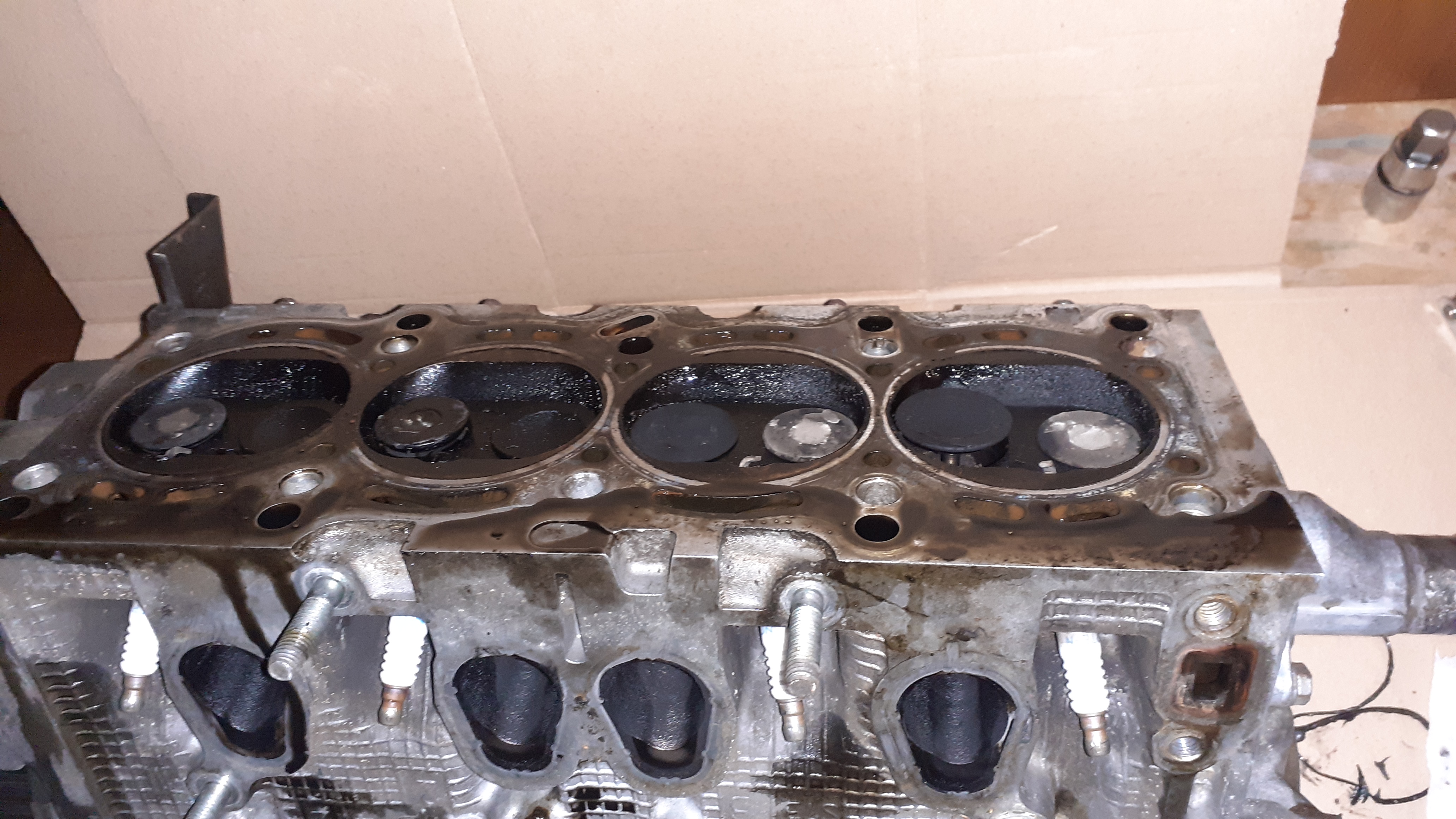

Here is how it looks. Lots of oil inside the combustion chambers.
About the oil that shows I saw people saying that that is the prove of gasket failure, but I say it isn't. I say that is the oil line that goes from the filter up to the cover and that oil dripped when I took the CH down.
The right-hand down side bolt had that yellowish thing that shows in the pictures, looked like that foam that appears on the aluminum parts on cold temperatures and high humidity. I don't know how it got there, is that bolt in touch with the cooling system or so?

I took the gasket off the engine block, too and it is looking good. Not so much dirt, I will clean it nice. I did spray some brake cleaner on top of the pistons and rotated the crankshaft, it moves with ease. If there was carbon on the rings, might have got it off. The spray helped remove a lot of that oily carbon on the pistons, they are not just yet clean, but I will get there.
I had the CH soaked in diesel, the valves too. Them too are way cleaner, but not there yet. What do you reckon, would it help to try cleaning them with brake fluid? Or do you know any othe good stuff to proper clean them?

@GrandePunto PL, you convinced me, mate. I bought myself an angle indicator and I will use it to tighten the bolts as recommended.
I thought about it and I was trying to avoid using the angle gauge due to the practical aspect of things. Yes, theoretically the gauge is more precise than the torque wrench. But practically you need to apply pretty big force in tightening the CH bolts and my opinion is that the best way to do it is in one movement, a swift turn. So I was being worried that is no an easy job to do that and to stop bang on to the 90⁰ or how many degrees are required for other bolts. In that way the torque wrench is more practical because it just clicks when you hit the set torque. But of course, using torque is not so precise, friction force being involved and more variables.
So thank you for the advice, I wil do it just as Fiat recommends.

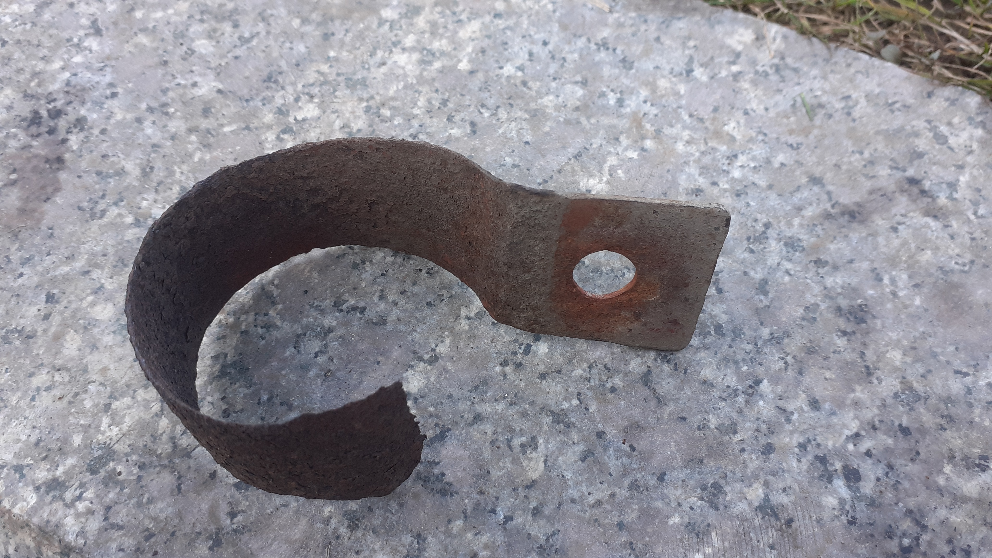

I bought a tap to clean the threads on the engine block and also found the needed shims, ordered them, should have them soon.
Any advice on how to clean the head where is most needed to be clean? I'm not using sand paper so I wouldn't scratch it and so far I soaked it in diesel, also tried with some petrol, break cleaner and WD40. Also did a wash with worm water and detergent and it started to look better but there are still bits of the old gasket. How could I take those off, easy and safe?
The plastic scraper didn't really work. Bits of it (of the scraper) would come off, just not the old gasket. So I got to the next level and I used scuff pads and break cleaner. That did the job, I'm satisfied of how it looks. Also cleaned a bit more the stems by putting them in the drill and spinning them against scuff pads and cleaner. Happy about them too. And I also cleaned the engine block and the piston's heads, as well.
