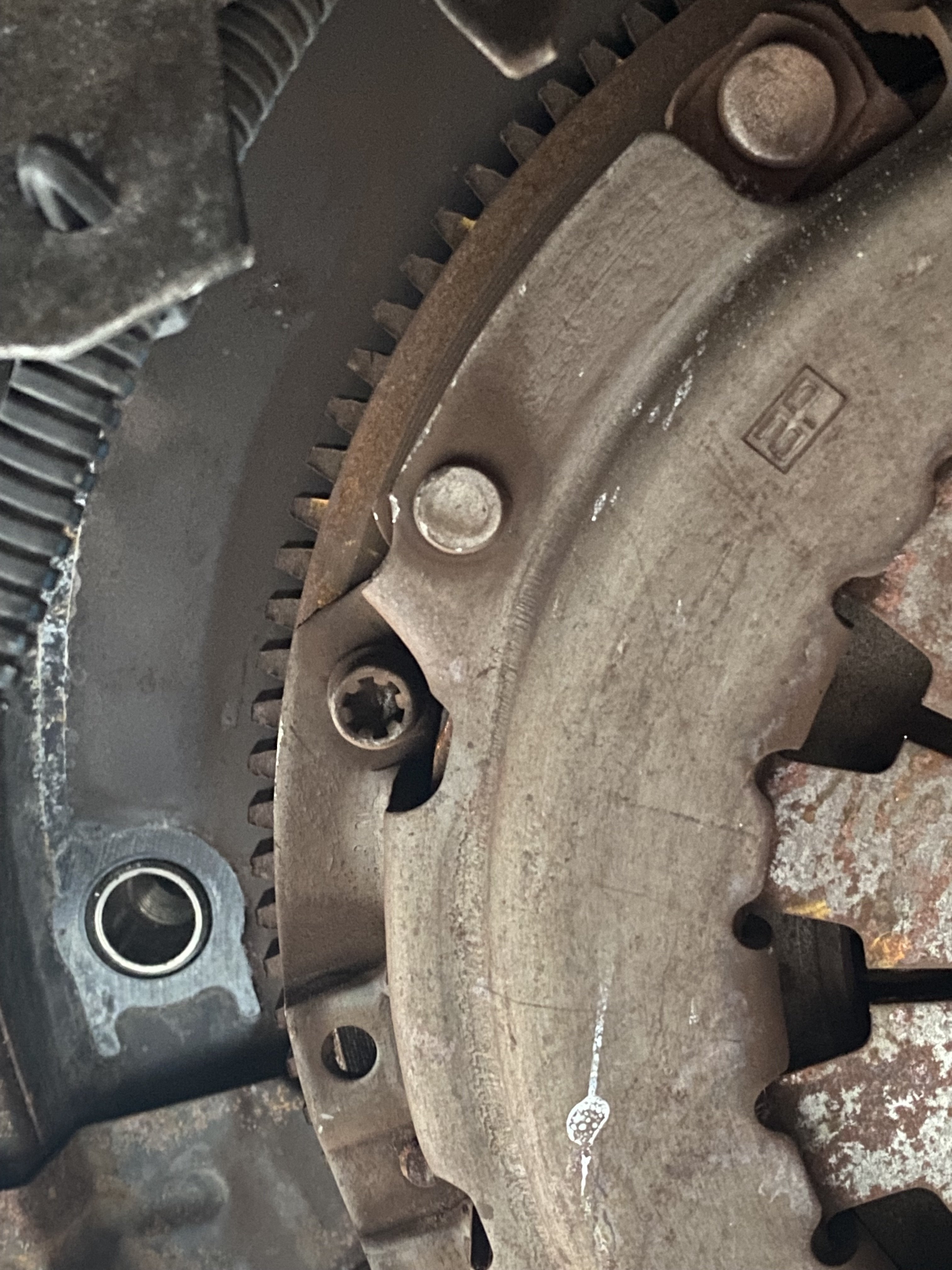

What tools are used to remove the pressure plate?
I used a block of wood to chock the flywheel, if that's what you mean?

Well that's an odd one!
I'd know it as a Bristol?
Bristol cause they're odd?! That's funny! (Wouldn't it be Brighton though...?! 😁)
I actually had this exact conversation once:
Paul, where are you from?
Bristol!
Sorry...?!
BRISTOL
Neh..., I heard you. I'm just sorry you're from Bristol!
*Laughter*
That is a Torx Plus.
