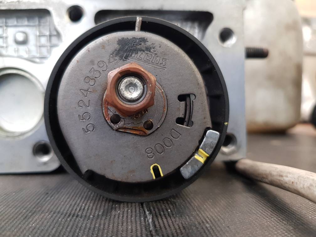

The timing belt procedure is the same for bravo, grande abarth, abarth 500, mito tjet. They all share the same timing tools. Only difference is room and airbox/pipework etc. But identical in the belt procedure.
The tensioner tool makes it a lot easier than trying with circlip pliers. And if you lock the cam and crank you can't go wrong where as paint marking has the potential to be slightly out.
Leave water pump to go off for 24 hours to be sure the sealer has fully dried as there is no gasket.
I would highly recommend slacking off the cam pulley bolt which makes it easier to pull the belt round, which start from the crank, go up to the water pump, round the cam pulley and have the slack tensioner side.
Tension pulley, then torque cam pulley bolt last (cam pulley is floating type so cam will not move as its locked in). You will need a locking tool to hold pulley and torque wrench to tighten) Turn engine over twice after removing locking tools, then make sure locking tools fit back in correctly.
I have marked in yellow where the tensioner needs to align (if the picture uploads ok)View attachment 203664View attachment 203665

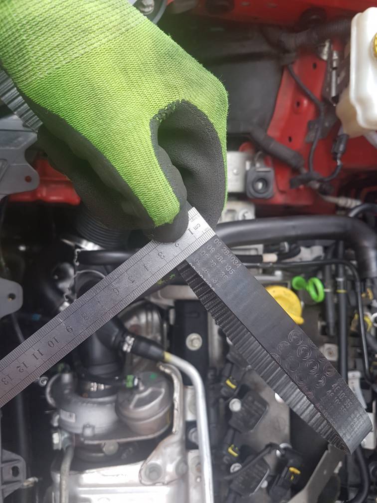

Hey Boost. I also noticed on your timing belt vs.mine. Your belt thickness is a lot wider and covers the whole cam pulley it seems. When looking at mine (See pics) there is space either side. I measured the thickness of my old OEM belt (well it's the one the garage gave me back) and they do match at 2.2cm but when ordering my new belt should it be covering the entire cam pulley like yours? 20191010_163444.jpeg20191012_115510.jpeg
Mine does not cover the whole pulley it was just over near the edge of the pulley, it is not the entire width of the pulley.

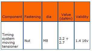

2) Thread Locker? - Do people recommend using thread locker on main bolts i.e Crank pulley, tensioner bolt and Cam pulley bolt?

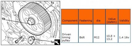

3) Torque Specs - Can anyone confirm if correct: Crank bolts: 28Nm / Tensioner retaining nut: 27Nm / Cam pulley bolt:132Nm (sounds high???)

Here are the torques I found in eLearn, notice the crankshaft gear uses the two steps tightening technique: torque + angle ...
BRs, Bernie
BRs, Bernie

Thanks for this berne. A little unsure now with the main CAM pulley bolt, as the tjet elearn states 10.8 - 13.2 daNm which i believe = 108Nm - 132Nm, but nothing else to do with angle tightening. whereas the 1.4 16v seems to be 19Nm - 21Nm and a further 107 to 113 degrees of turn but on both the validity is listed as the 1.4 16v? maybe Boostjunkeee can advise due to having a tjet vs the 1.4 16v?
I did not require a phonic wheel relearn, also tighten the cam pulley bolt to 130nm, that's what mine is at (higher end of the scale)

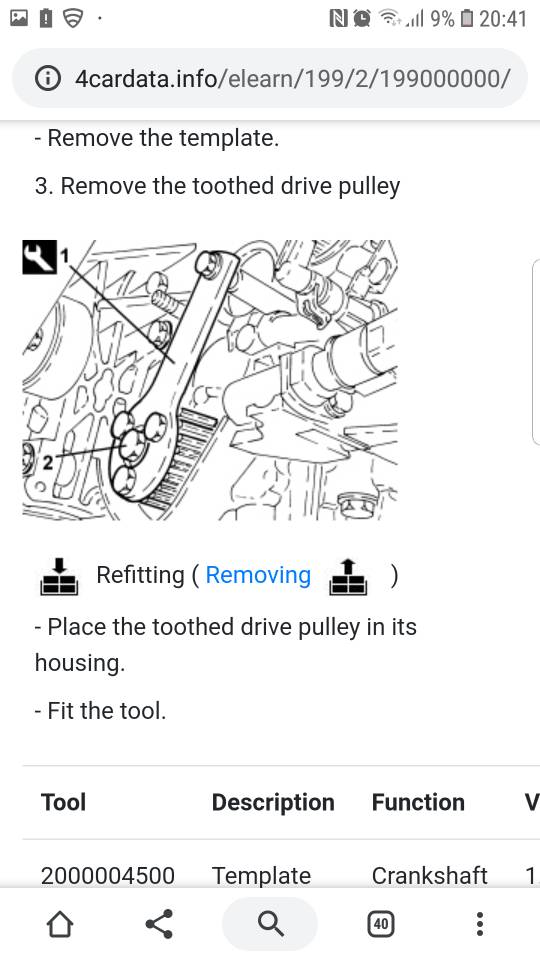

When you say to "be careful when removing and installing the Crank pulley". When u say crank pulley do you mean the bigger pulley that drives the Crank and auxiliary belt or the smaller actual crank pulley behind it...if that makes sense?
You also say the way to prevent cracking the key is to.use the timing belt locking tool. Are you referring to the tool that is shaped like a.magnifying glass (See pic)
