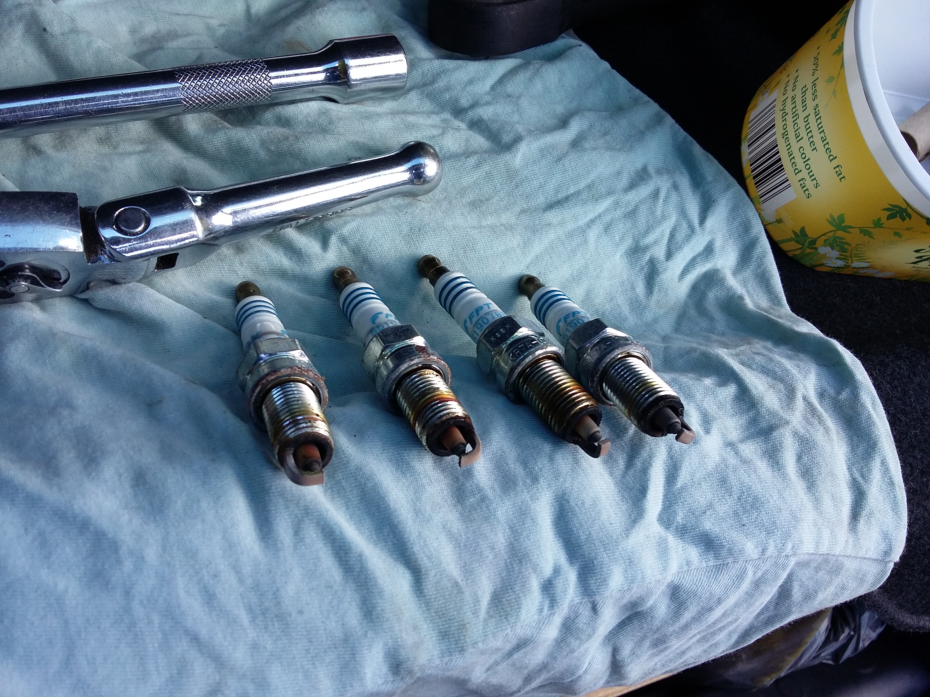

Plugs changed :
#1 on left..nearest the flex-head ratchet
Along with #2 are reddybrown
#3+#4 are hotter looking
All are NGK FPT.. again Im thinking this was 'Factory fit'
Strangely the leads and coil pack are Champion FPT
I was amused by the FOMOCO on the inlet trumpet too :cool:

Incidentally I am not a fan of wire brushing plugs as the metal fragments from the brush encourage the insulation around the centre electrode to break down.
Once on a Ford Motorcraft course they demonstrated how even sandblasting a brand new plug then testing under load it failed earlier, so every service my customers had regardless of mileage always had new plugs (only the petrol engines;) )
