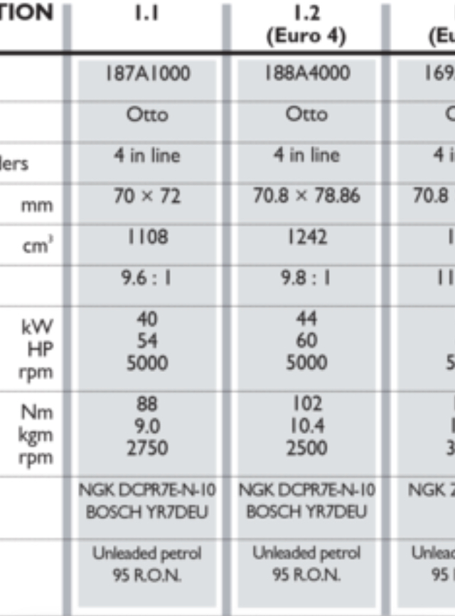

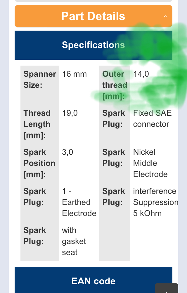

What doesn't sound right?Doesn’t sound right to me 14mm plugs
I had a 05 1.2 and 06 11 and they both had these 12mmWhat doesn't sound right?

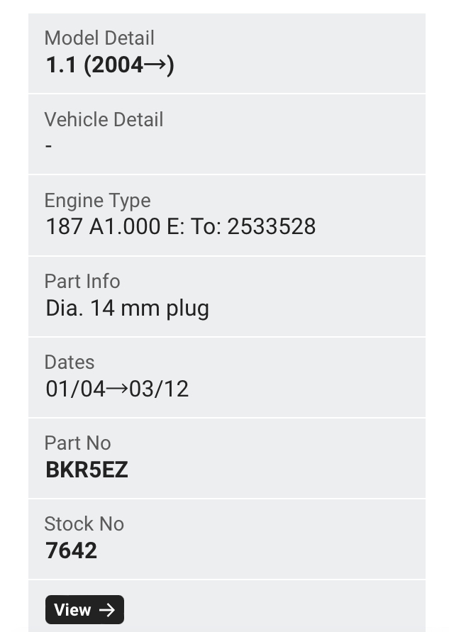

I got this reference number off this forum and they are said to fit by the sellers.
It has done 50k and I have no idea when they were last changed.
It's a 2004.
This is what I found amongst others.
4x NGK BKR5EZ (7642) Standard Spark Plugs For FIAT PANDA 1.2 11/03-->12/11 87295176429 | eBay
Find many great new & used options and get the best deals for 4x NGK BKR5EZ (7642) Standard Spark Plugs For FIAT PANDA 1.2 11/03-->12/11 at the best online prices at eBay! Free delivery for many products.www.ebay.co.uk
I like to have the replacements with me before I mess with any work. I live 40 minutes away from Halfords or any such motor shop so I buy things online in the main anyway.Shop4parts only show the 12mm from 2004-2009
Spark Plug 55188857
www.shop4parts.co.uk
Personally I would have lifted the bonnet and doubled checked what was fitted as your car is on the cross over period.
Far quicker than google and 100%

S4p have never sent me a wrong part so I think you can trust them. However pulling a plug is so easy why not?Shop4parts only show the 12mm from 2004-2009
Spark Plug 55188857
