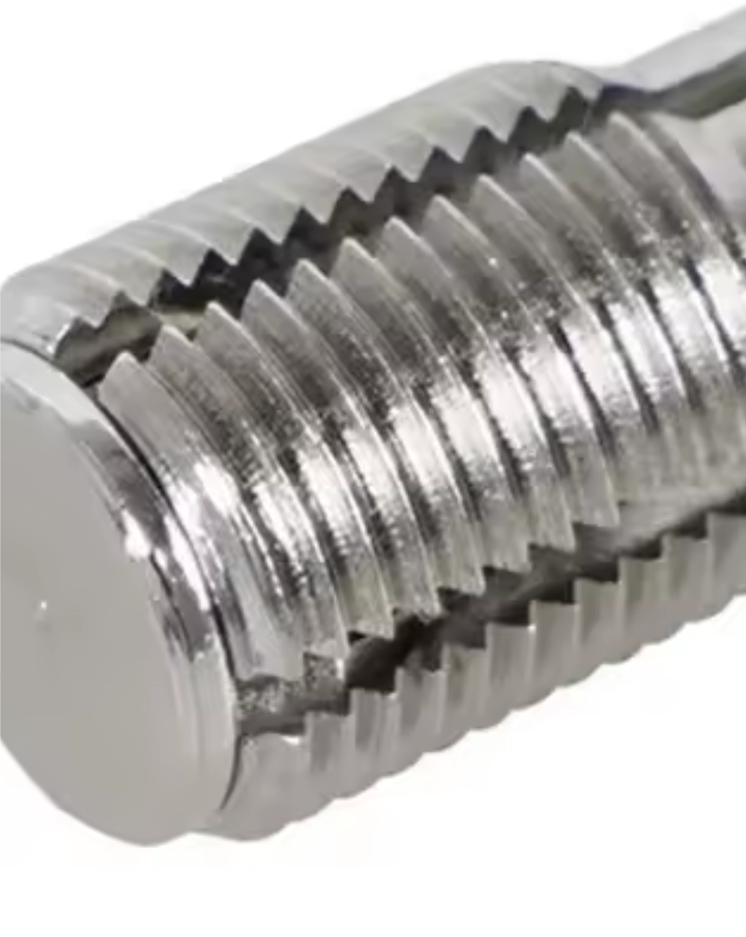

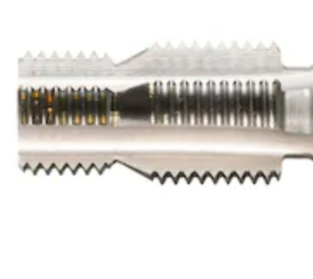

Expanding taps were patented in 1870

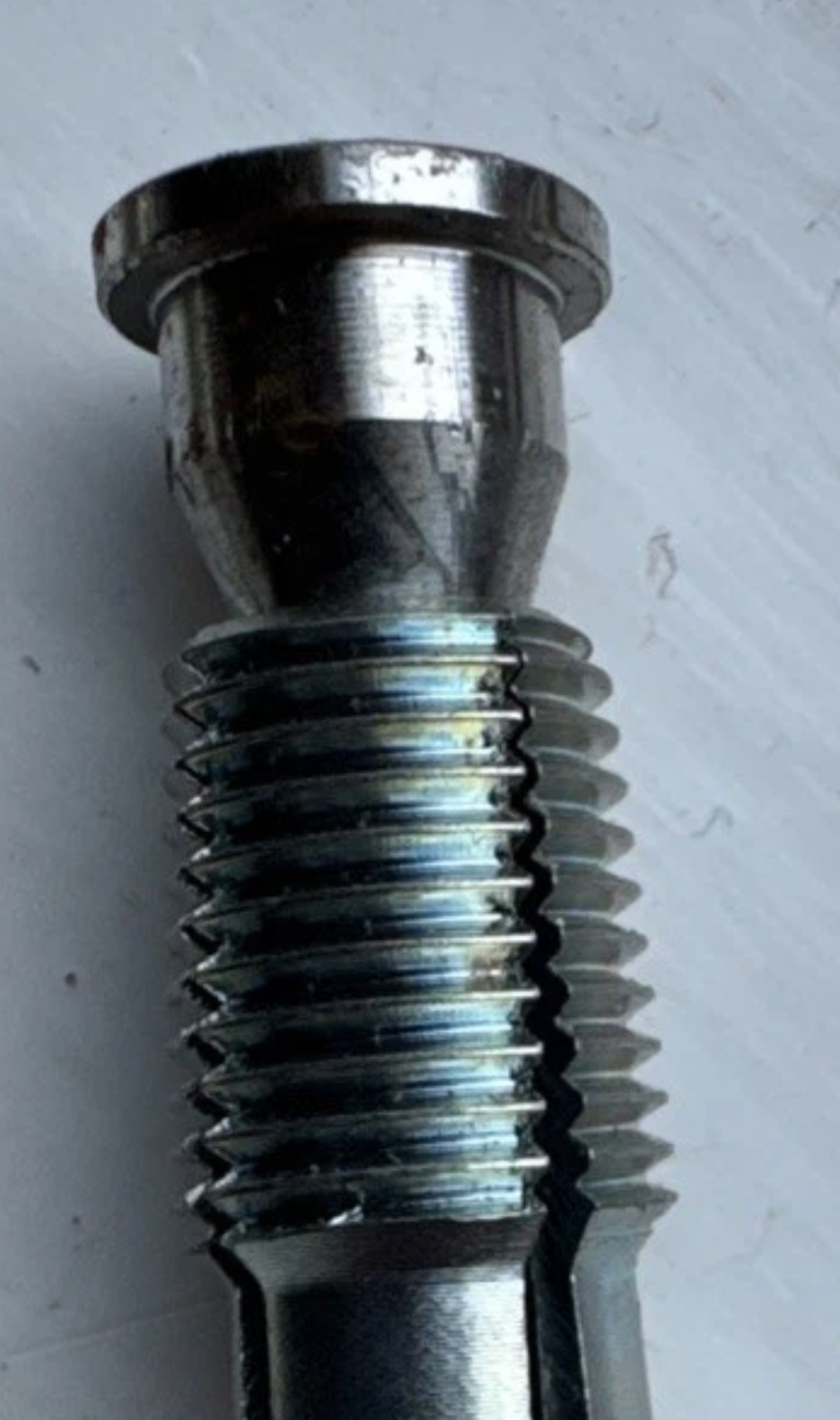

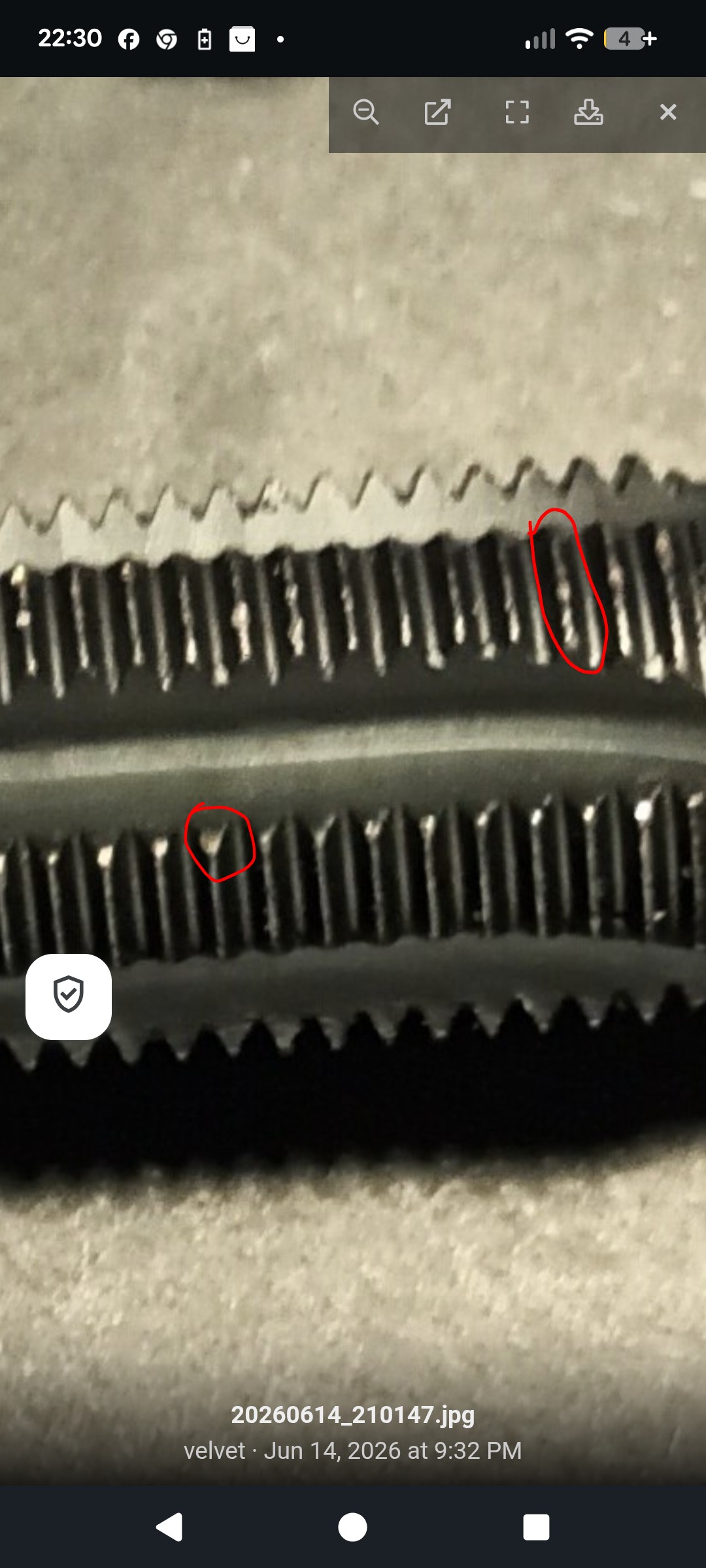

If you don't know they exist, you don't know to look for, ask for them, I guess the back tap became popular with the rise of aluminium heads 1990s
Looking at the prices £5 upwards, Sealy ones are around £15
I've come across expanding reamers and used them, but never thought about an expanding tap. I first saw this type of expanding tap some years ago, which, of course, is intended very specifically to clean plug threads and overcome the swarf problem. However an expanding tap for use in the normal way? Never knew they existed. Every day's a school day as they say.
They should go in dry if you are going to torque them up using a torque wrench
Oiled will over tighten them and risks damage
They are coated, no need to oil read link in post 5 should explain everything

They can be re threaded without removing the head.

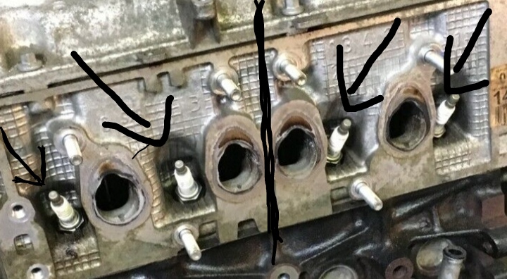

On many engines access makes this a variabley difficult job. And don't forget all the plugs may not be aligned identically. For instance the FIRE engines have two plugs with axis leaning slightly to the N/S and two leaning to the O/S.
