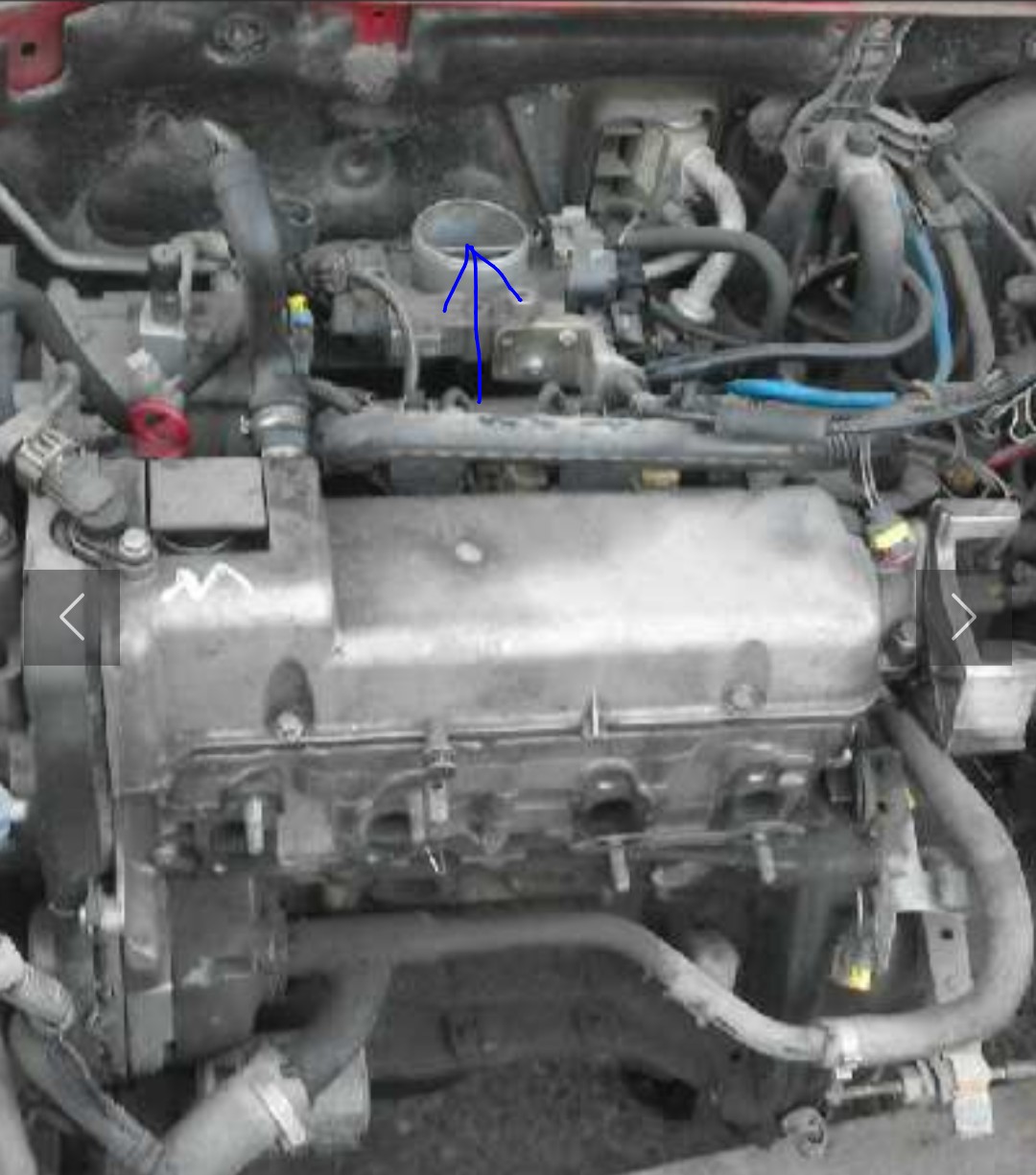

I'd start by getting some of the fuel out and testing it
Remove this plastic cap
Carefully push the pin down with a small screwdriver or similar, cover with a rag
Get someone to switch the ignition on
Does it smell of petrol, diesel or varnish
