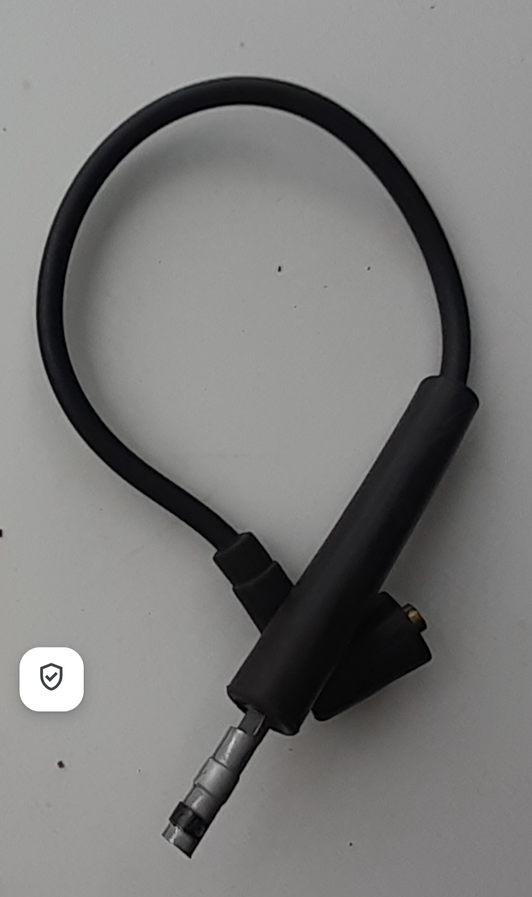

These type leads don't deserve to go onto any car these days, there probably not suppressed either
Not seen none molded ends since the bad old days of BL and unipart of the 70s, unless it's a bespoke homemade for a custom setup such a a drag car, it does not make sense in warranty returns
M/M leads aren't like that normally

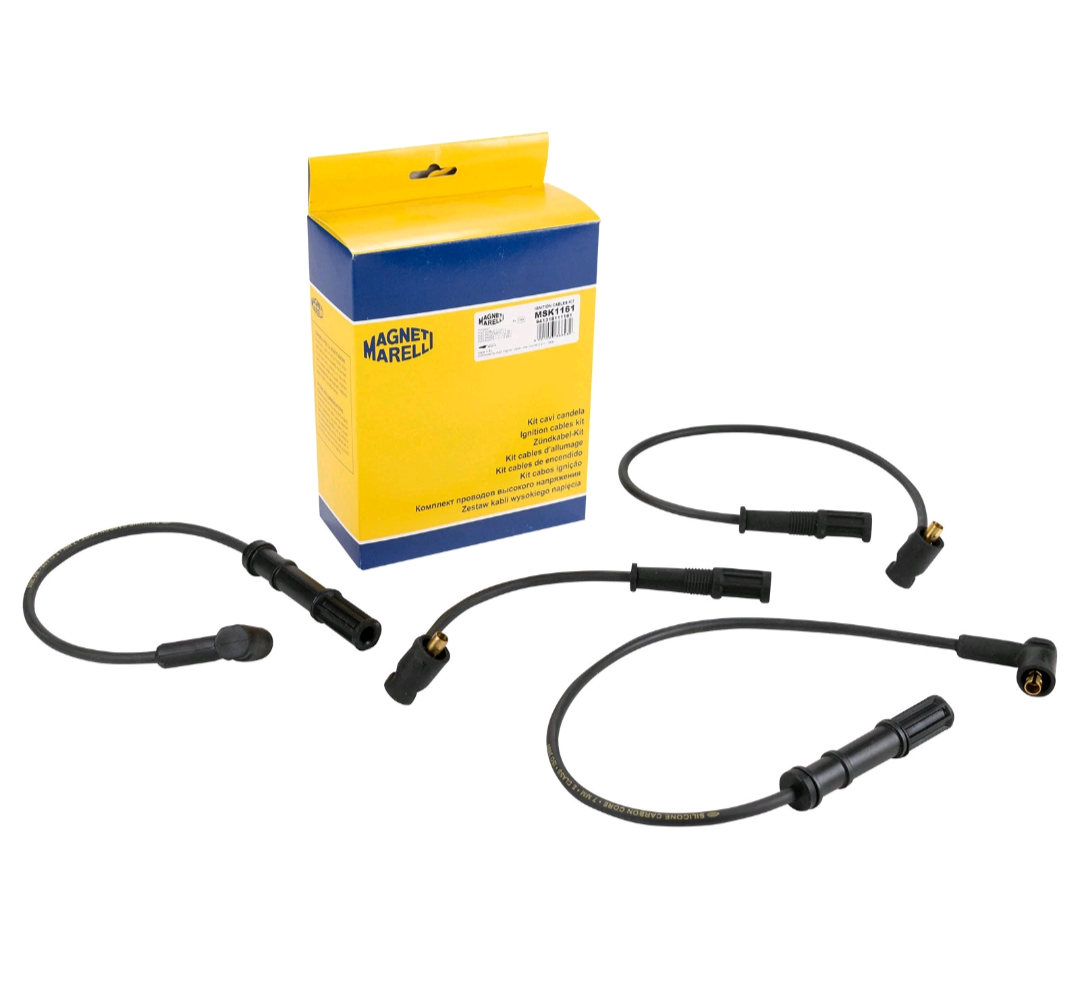

I suspect they are a cheap china import being sold as M/M
Unless M/M also sell a dirt cheap alternative (unlikely)
A few years ago I tried a set of those Magneti Marelli leads. They were crap then too. The boots were loose on the leads, which helped ensure the connectors sat on the plugs, but then were reluctant to slide down over the plugs. They fell apart in less than a year, hence my recommendation to go with NGK ones.
