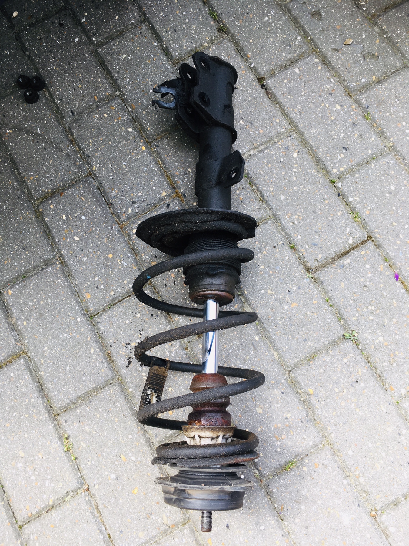

i have a Panda 1.2 dynamic my 2004 and shock absorbers are very noisy especially the passenger side one. Do anyone know if i can mount the Panda 4x4 absorbers on my model ?
Like Charlie (above) I'm puzzled as to what the noise you are hearing is and why you think it's the shocker. Much more usual to get noises from drop links, a/roll bar bushes, maybe even top mounts or ball joints?Hi everyone

This isn't advisable; shock absorbers and springs are carefully matched to give optimum suspension performance.
Thanks guys I'll have a look at your suggestions : snowy, icy and full of bumps roads this winter in Sweden....as there has never been this kind of noises when we hit a bump we simply thought it was shockers....other than that car starts at -20 and drives like smoothly in this kind of weather
