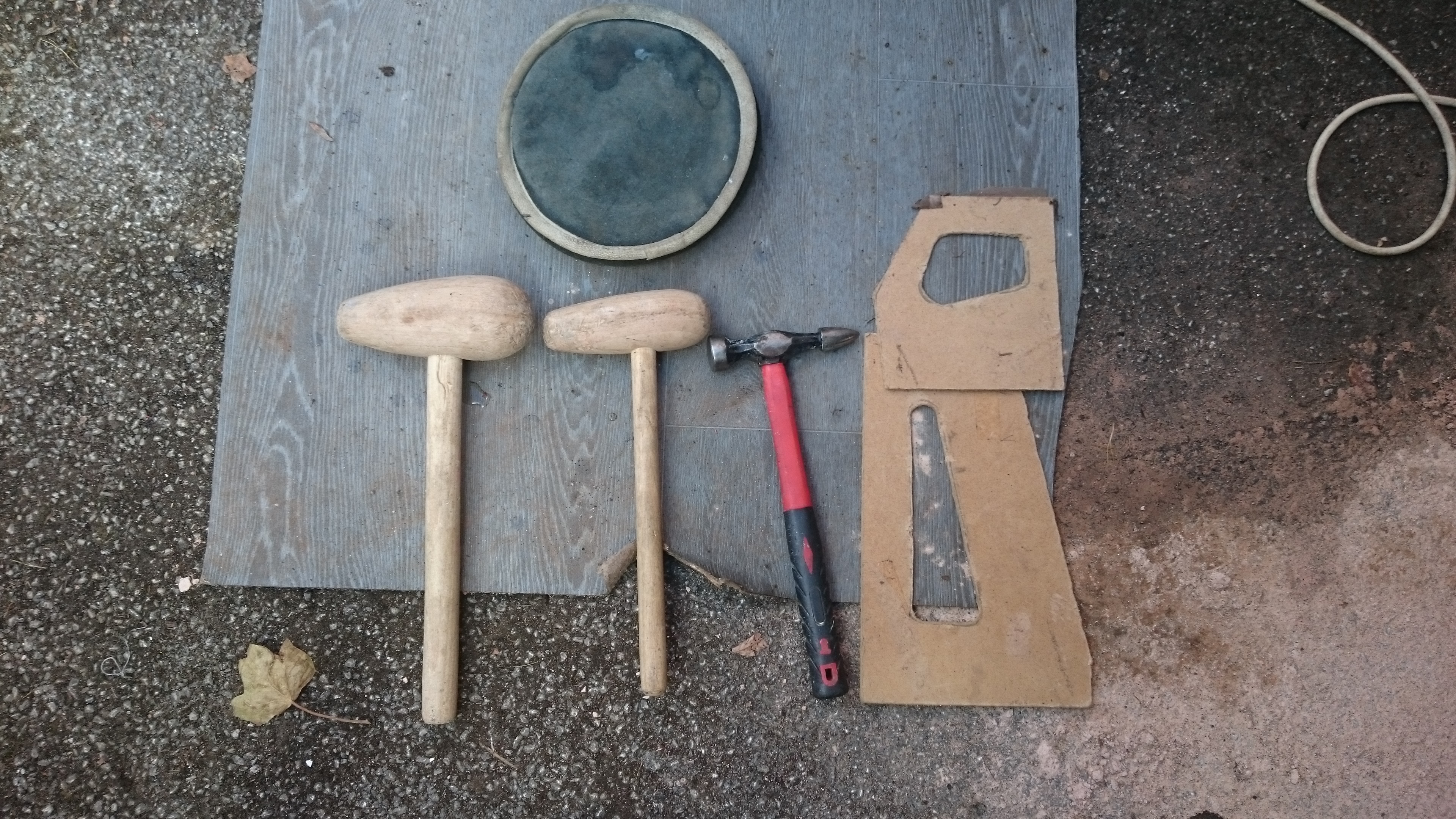

Regarding tools for the earlier fabricating work, the following is required:
1)a sturdy bench and vice,
2)a Panel beating hammer to bash the sheet into cut outs resembling the shapes in the original panel, cut outs are made in thin hardboard. For folds that may also be curved, cut the curve in thick hardboard x 2, sandwich the metal sheet between the hardboard in the vice and bash it round the hardboard profile.
3)A couple of round headed wooden hammers to make dished shapes, hitting it on to the shotbag.
4)You can get a shotbag from a bodywork supplier and it needs to be filled 2/3 full with lead shot. The hammers can be bought cheaply on Ebay.

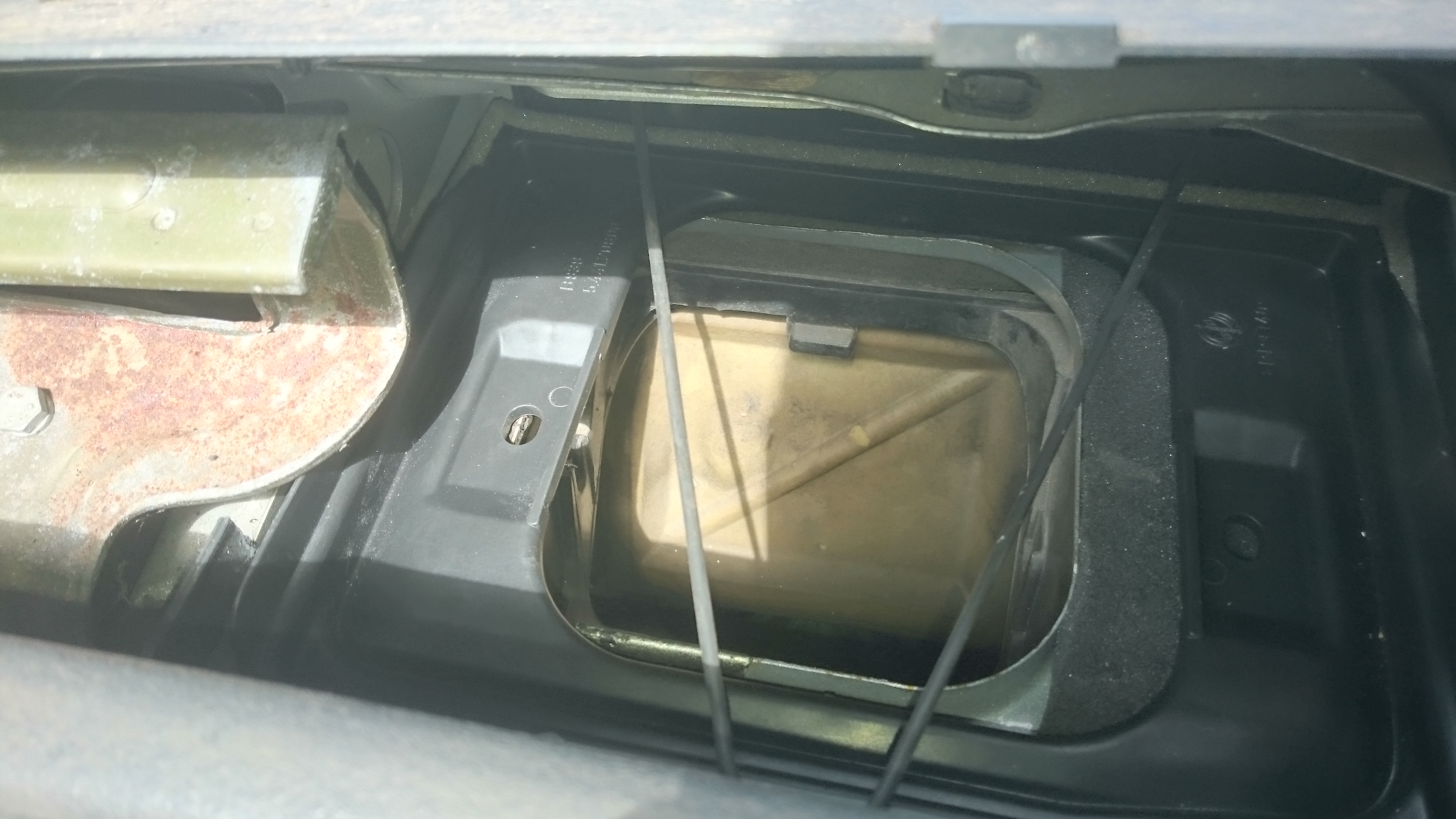

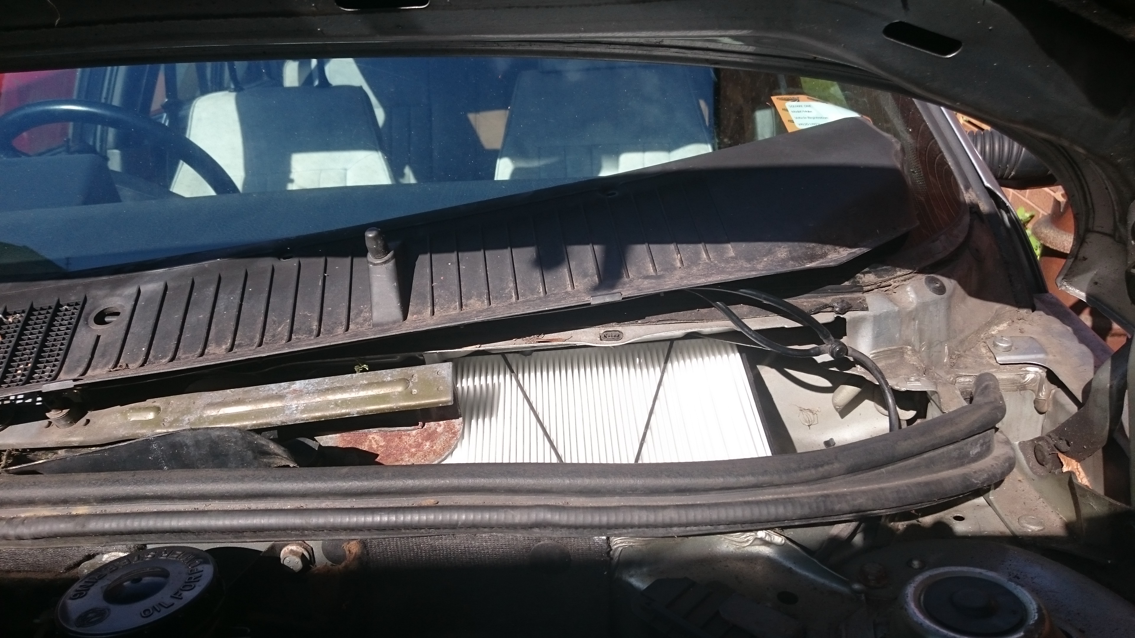

Some time ago on here, somebody retro fitted a pollen filter to a LHD car. I don't need to do that because the Tipo Liberty brochure states the air conditioning provides 'a breath of clean fresh air'. Upon investigation, this statement turns out to be questionable, as with all UK cars there is no cabin filter. :D
I had bought the two types of filter case listed for the Tipo for the Turbodiesel but neither would fit a RHD car, there are too many obstacles in the way.
Looking at this again on the car I have now, I found by cutting the height of the smaller frame down and adding additional foam, a reasonably neat solution is possible, if a tight fit. Cartridges are available for the Tipo, although they can't have sold many! It just needed the width trimming.

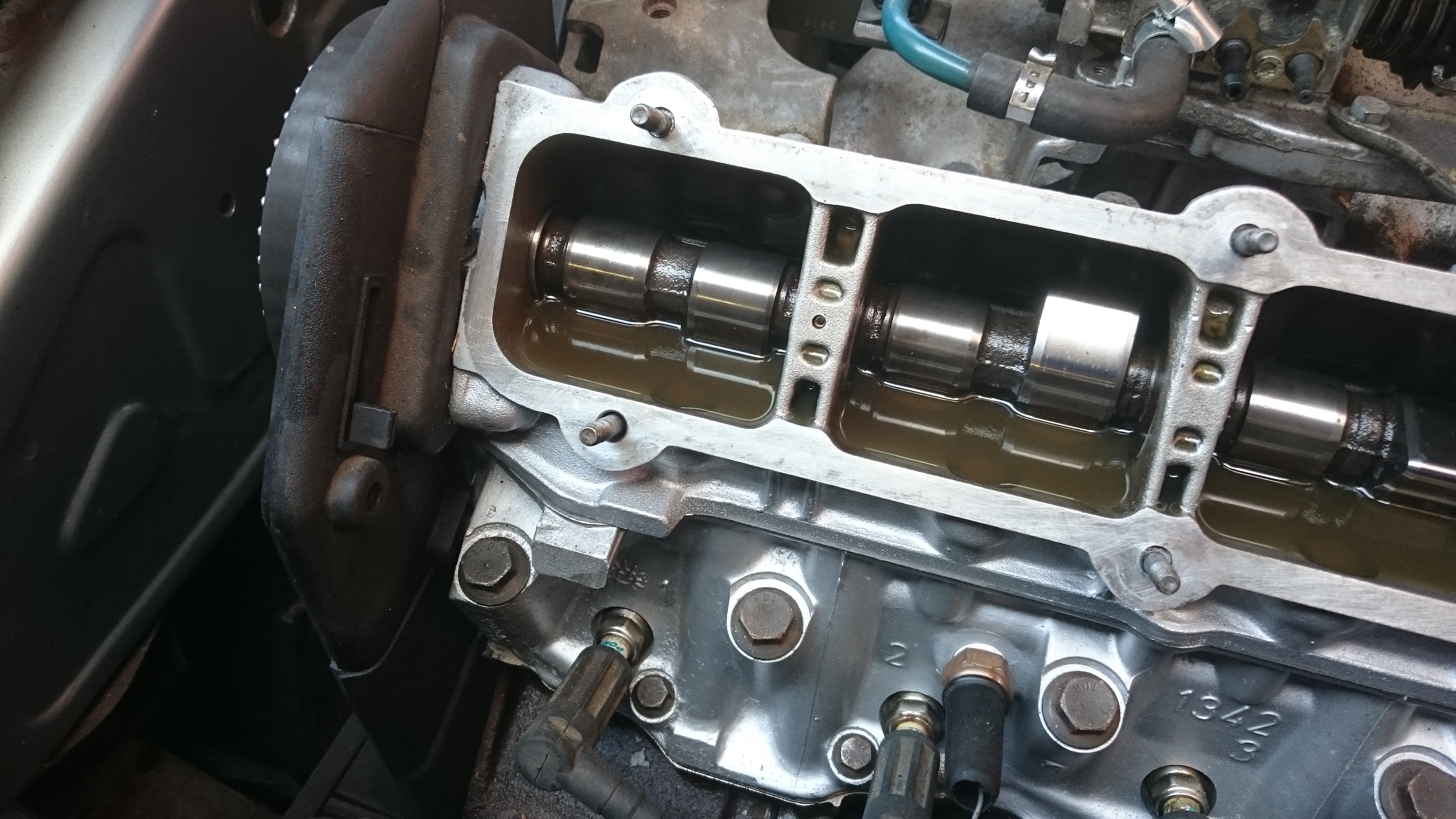

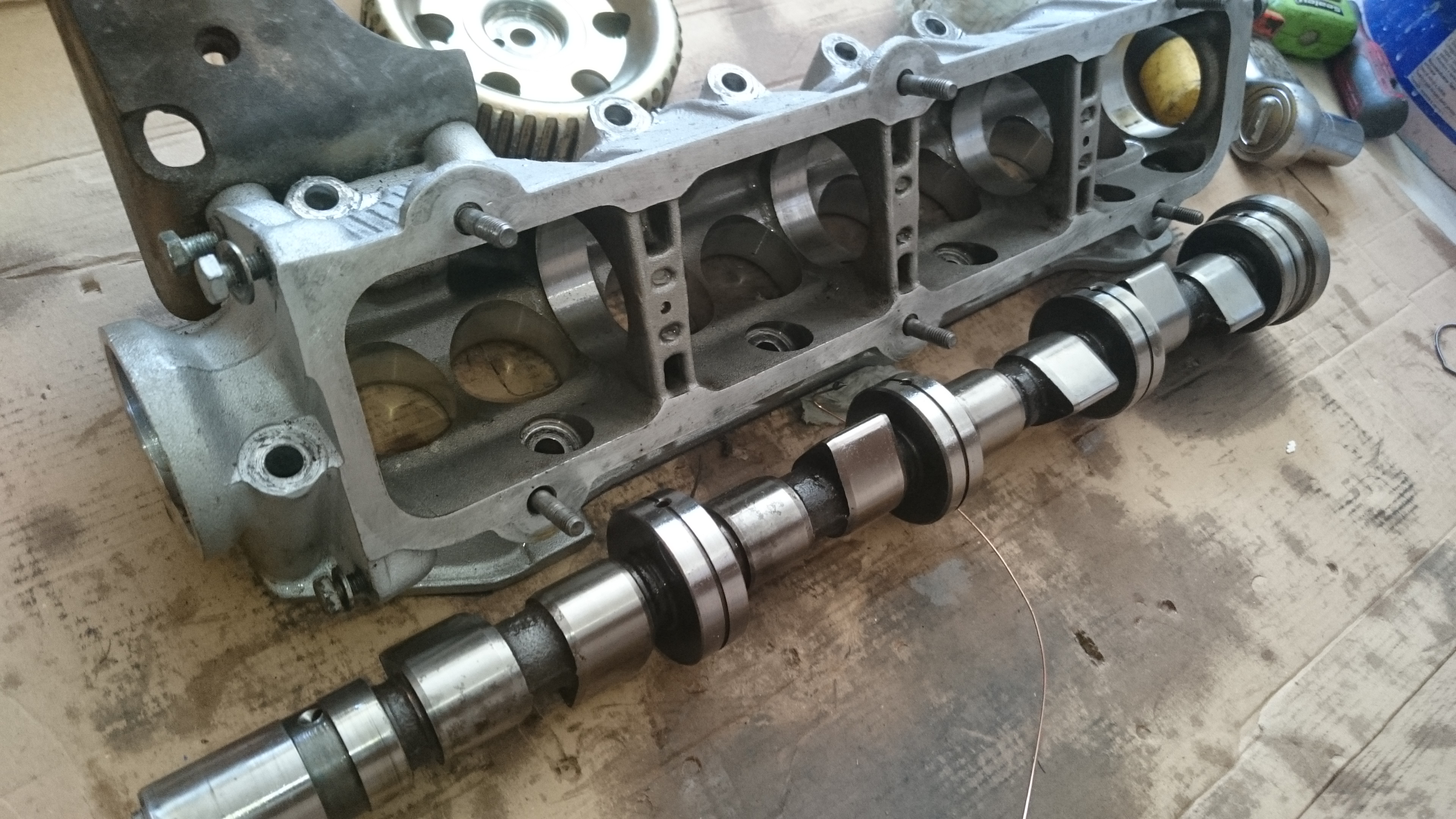

After a relaxed job adjusting the panel fit on this car and also the front doors so they don't have to be hurled shut, I can't really dodge an investigation of the engine issue. I can hear a clacking from the left of the cam and an unhappy bearing.
I figure as the oil light is going out immediately the oil is getting up to the cam as it should, as the sensor is located in the cylinder head. This is a comfort as given the original state of the block, you might imagine any residual blockage being in there. Possibly the oil gallery to the left of the cam is the issue but everything looks normal so far.

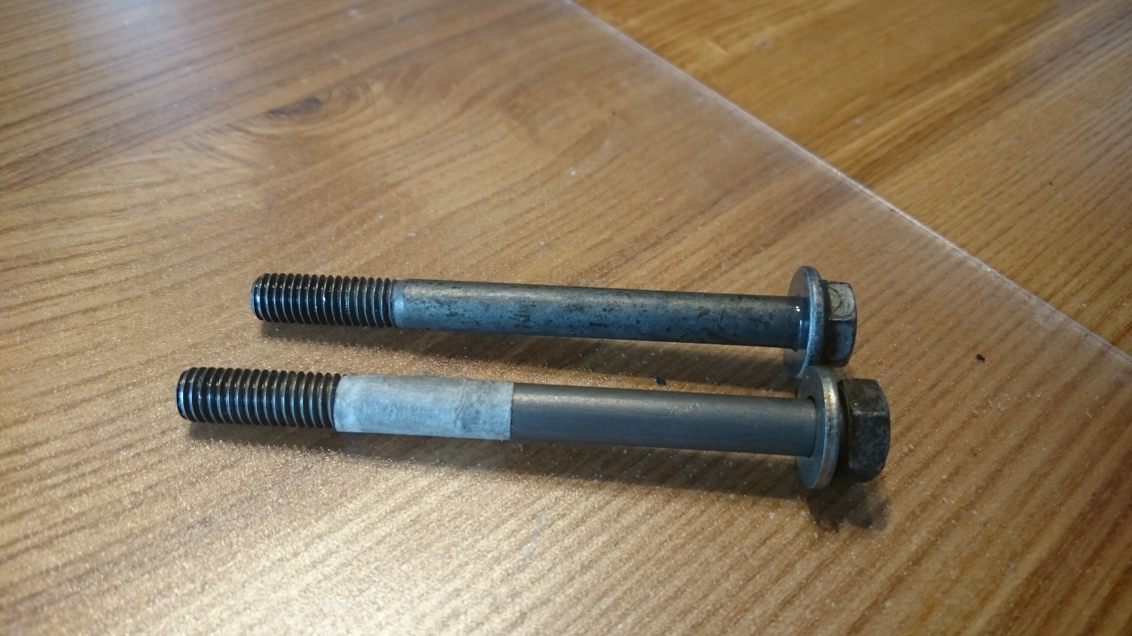

No particular issues with the bearing, just one tiny pit in the alloy probably historic and the oilways were clear. I think the cam was perhaps a touch out of position laterally blocking the oil holes, it seems to be that it can be positioned incorrectly. Then when putting the cam carrier back on the head disaster struck when a bolt hole threaded. Can't understand what caused this really so was fortunate to find a slightly longer bolt left over from the diesel head which could utilise the remaining thread.

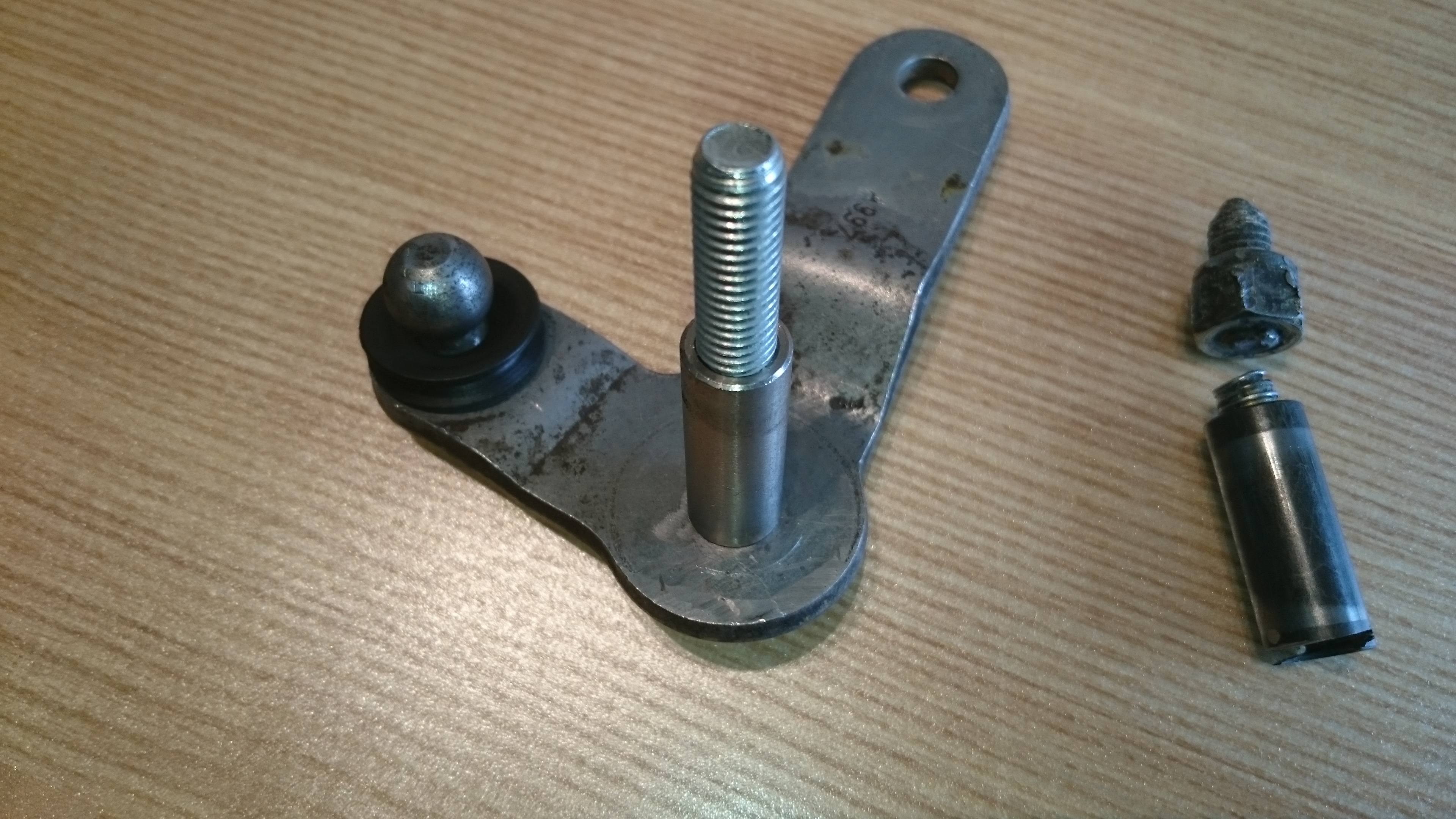

The gear rod is an interesting set up with a plastic ball in two halves glued on, a captive rubber boot, a casing, some insulation and two metal plates with the second containing the pivot mounting bolt and sleeve under the floor. The boot is trapped between the ball and the pivot, so cannot be replaced and mine was torn. Although the first plate could be levered out of the floor aperture it seemed to me no human would be able to reach the both ends of the pivot bolt under the second plate without going from below and removing the exhaust and 2 covers, but I didn't fancy that and it seemed to work ok so I moved to the other end of the linkage.

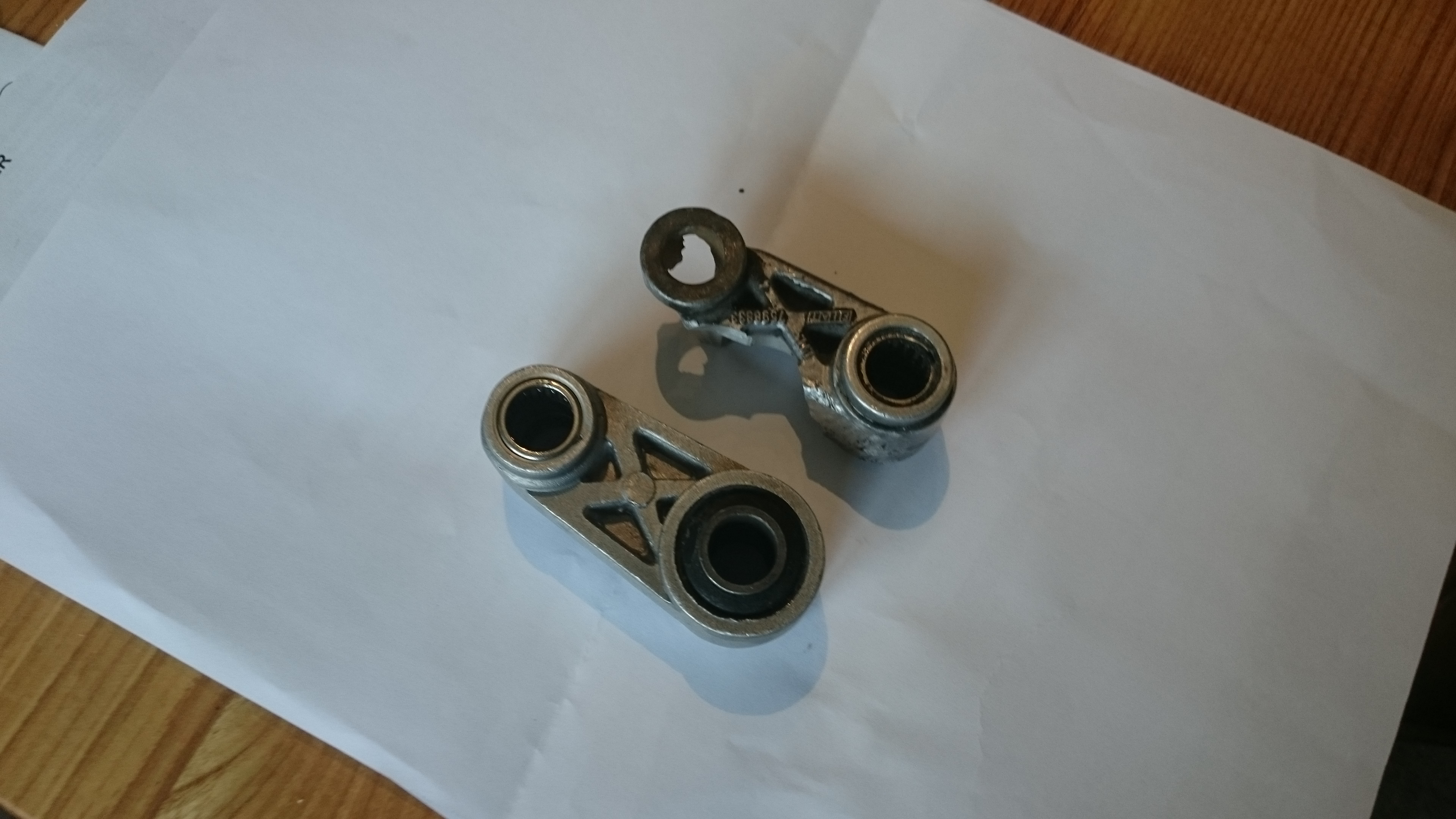

The rear end of the linkage unit in the middle of the drawing here is mounted on a bracket which is part of the steering rack aluminium casting. It took a couple of evenings messing around and study of Haynes for it to dawn that the bracket was not just that but a second pivot/pin. But that on my car, the linkage unit just happened to have welded itself solidly to. After applying a clamp to leverage the linkage unit from the front and applying full force :eek: eventually I was able to get a couple of mm of sideways movement.
Clearly the linkage unit was not in any mood to be parted from the steering rack so it seemed the belt sander would be my only option given the linkage's location underneath the floor, above the subframe and behind the engine.
Belt sanders are a splendid tool for £20 with more precision and much less chance of collateral damage than a grinder. Eventually with good illumination and taking it very slowly the linkage unit was recovered by destroying it leaving the pivot/pin on the rack intact, as the thought of having to replace the steering rack was too painful to contemplate! The integral thread on the bell crank (no.4) had already broke earlier due to a seized nut, the bell crank is not available any more but I was able to repair it by drilling a hole and fitting a conventional bolt and sleeve as shown.
The more commonly available replacement linkage unit is super-sized (shown the wrong way round!) and given the tiny space around the power steering pivot getting it on/off in future would be a concern so I sanded some of thickness before refitting (however the design with a metal and rubber sleeves seems designed to avoid future corrosion). There was a new plastic bush to press fit on to the bell crank and after reassembly and copious greasing of all front-end components I cut off the split boot in the car and replaced with a 38mm grommet which does the job.

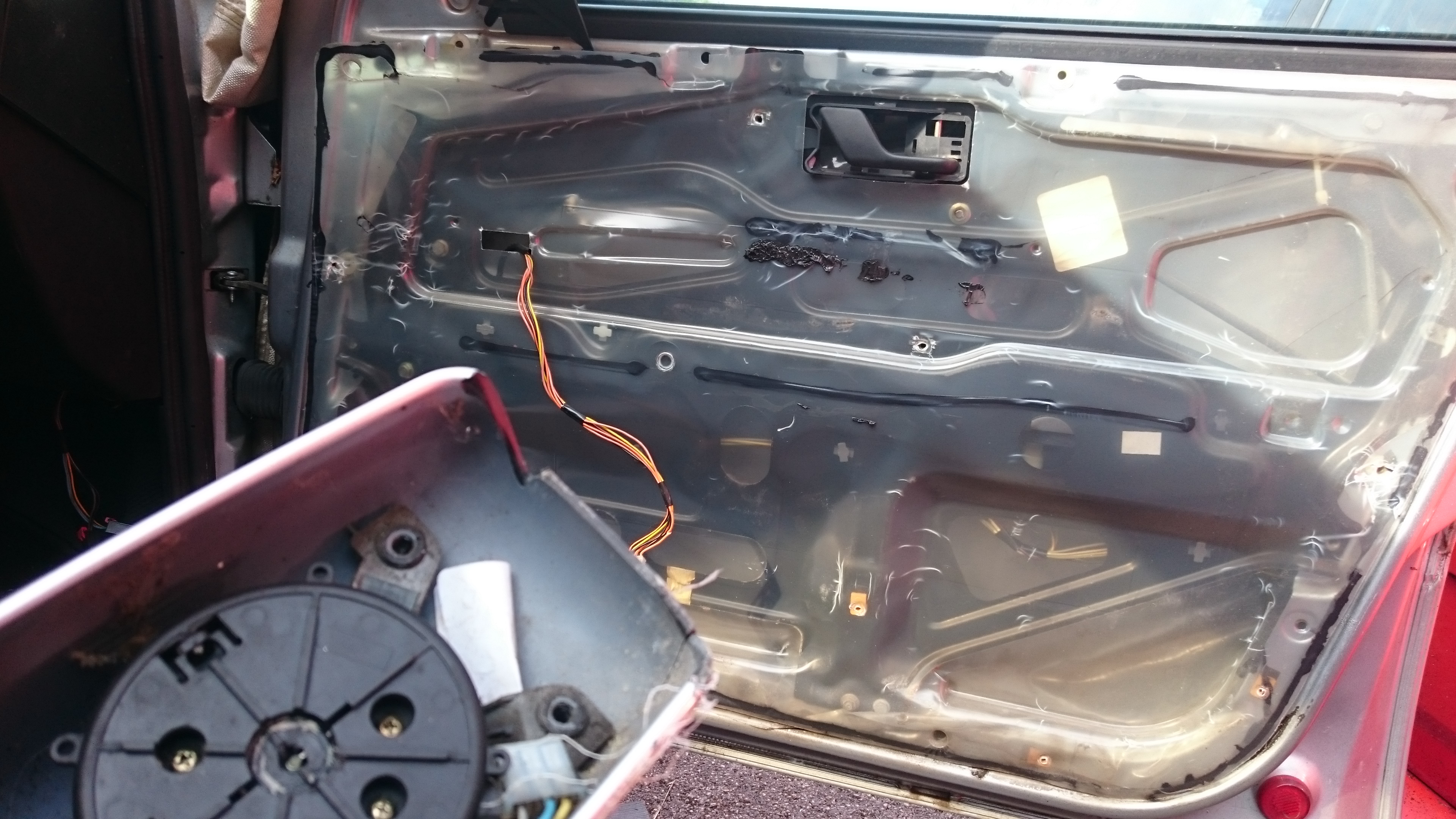

The indicators were not working at all so I cleaned the earths, replaced both damaged mirrors, the nearside was also blowing the indicator fuse. Turned out to be the classic joined wires in the door from a previous replacement. This was to avoid running the new mirror cable all the way to the correct connection under the dash.
