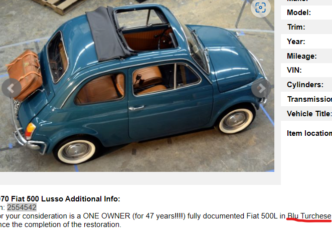

i am looking for the paint code for the traditional Blu Turchese, but not having luck. Like this car:
i simply love it. If anyone has that Fiat paint code and year, i would really appreciate it!
Let me see if i can find the can tonight and get you a ppg number. Unfortunately. The original fiat number was not in the database for the paint shop. North american shops dont have alot of the european only colour codes. Especially from that era
The Fiat code is 419. Blu Turch

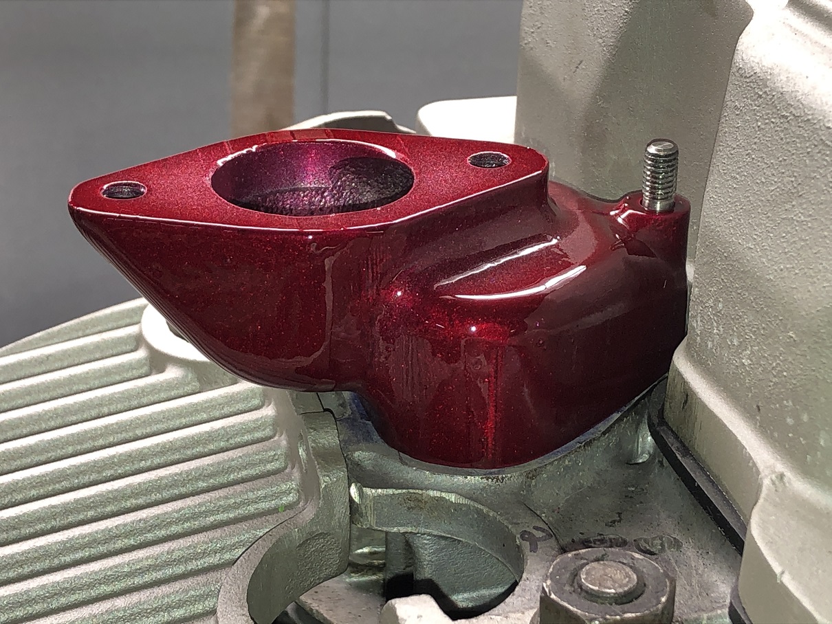

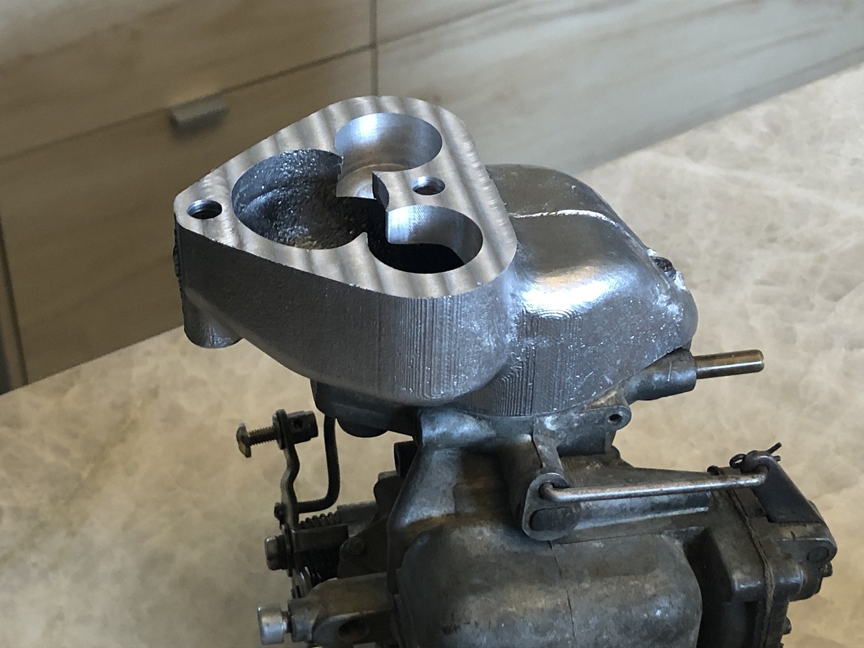

After bolting on the flywheel, it was time to deal with the elephant in the room; the carburetor. Last summer i picked up 2 ICH 34's, and then when i visited Tom, i bought a ICH32 from him. Which would more then likely work better for this 540cc build. Thing is, Its not a quick swap and go upgrade. The weber ICH is a completely different bolt pattern, and requires a spacer-adaptor to match.
All winter long i was making a final parts list to order from axel gerstl, they have what looked to be the cast adaptor i needed to make it work. However I wasn't fully decided on if it was a make or buy for the carb adaptor. I didn't go much into the overall cost of this build, but you get to a point where you reach your limit of enough is enough, either it be cost or time (its been multiple stages of that thru this build LOL). As silly as this sounds, this adaptor as insignificant as it might seem on the grand scheme of things, was getting close to breaking that point. Its like 115€ plus shipping, plus duties, and conversion. The stupid thing was going to cost me over 220$ for 5$ of material, which is not a hot and flashy Dellorto FZD or Twin Weber.
Also, I still was not fully sure the adaptor would work for the application. Its listed as a Dell'orto 32, and the research i could find seemed like it has the same footprint. I made a choice; either i go down the entire journey of trying to machine a relatively complex part, get into a casting system, or bite the bullet and get the adaptor. I was getting close to the end of having to constantly reinvent the wheel; i bought the dumb adaptor.🫣
Parts showed up after a long wait. First thing, grabbed the adaptor bolted the carb on, and tried to fit it. Not a chance. I have a cast aluminum abarth valve cover, and the adaptor sat so close to the cover that the linkage on the accelerator pump hit the cover even without any throttle actuation. Ok i snapped, time to do it the right way my way. Ill save the lengthy details, as ive gone on for too long. Built up a small casting rig, designed and printed 3 revisions of the new part. Did some flow testing and such and came up with the perfect adaptor for my application. All at the same time while learning about aluminum casting, casting metallurgy, high temp hydrogen gas porosity, and shrinkage tolerances. Casting v3 had all the reversions i needed, had a decent surface finish (could of spent more time making the mold core a smooth surface), and had no porosity during final machining. A quick surface sanding and then a quick candy apple powder coat and it fit the engine spot on!

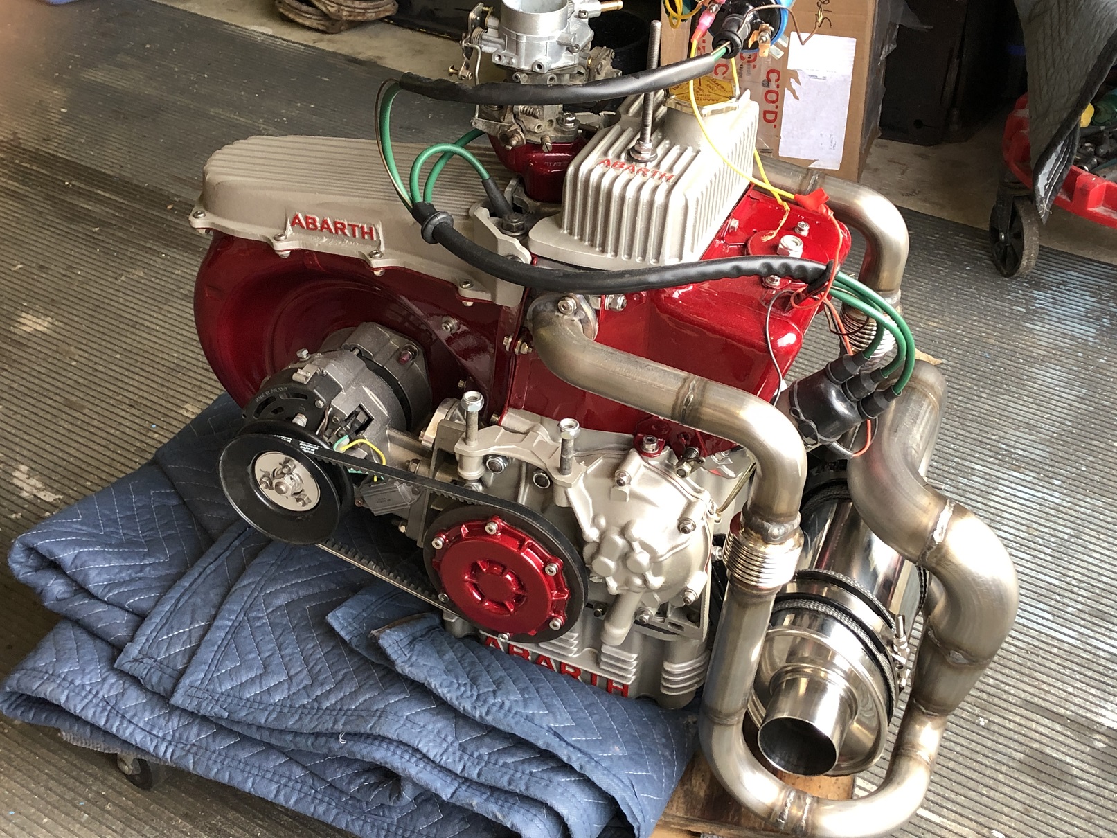

With the carb mounted, the temptation was too much, i had to run it. At at least do a 2500rpm lifter break in, i really wanted to do the break in under load on the dyno, but i havent even had a chance to build it yet, dry run it is. I spend a day to finish the final exhaust bracketry, and the engine was ready to run.
I couldn't leave you folks hanging without a video 😊
The rattle mid way was a loose exhaust bolt.
Still need to tune and possibly jet the carb, but all in due time

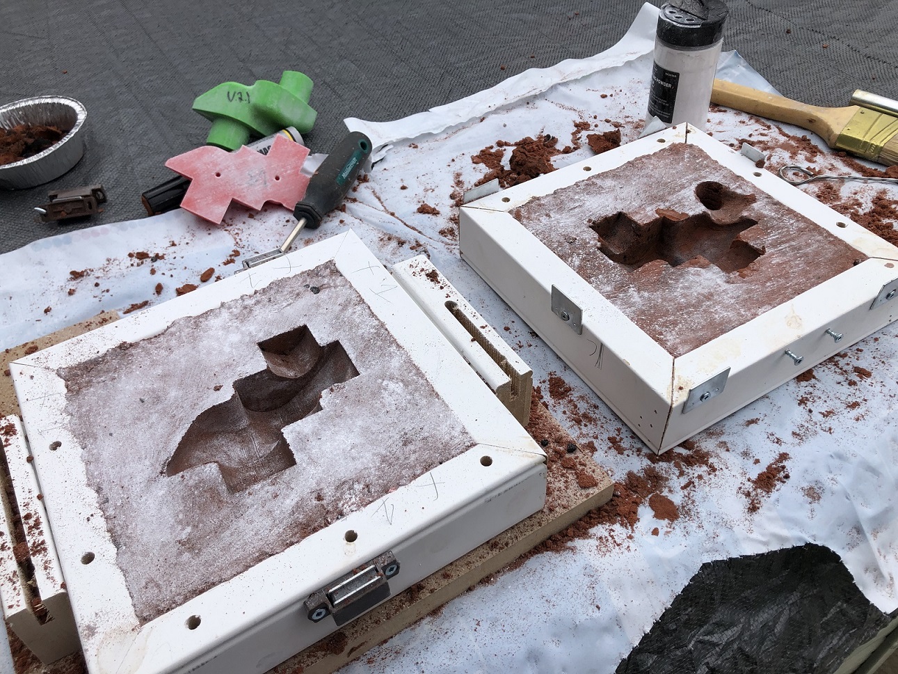

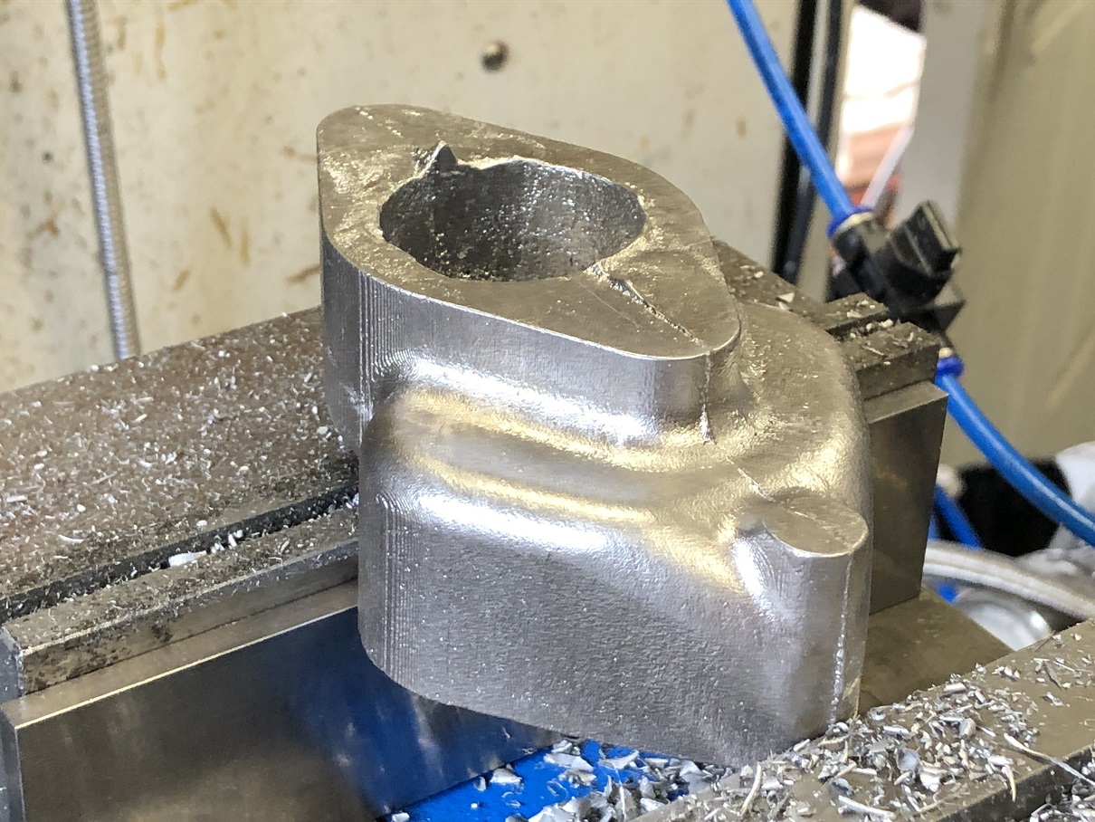

Excellent update! Your attention to detail is as impressive as ever, and mad props to embarking on casting a one off part!
So many times I have gone down a similar route where I try to buy my way out of a problem, only to realize that I should have just built it myself!

So about those. It was kinda an experiment to see if they would help reduce vibrations down the exhaust system. As we know these parallel twin engines cannot be perfectly balanced thru out the rev range, and the art of balancing these engines is more of a trial and tune finding/choosing the best optimized balance rpm for the application. With many secrets held back online in discussions when choosing the best balance factor for these engines. The best i could do for now was to try and keep odd harmonics from creating havoc and isolate out reaching components as much as possible. One of the suppliers i buy parts from (Vibrant performance) a great local company ive been dealing with. Had a great selection of exhaust parts and goodies to experiment with, and these bellows were something i wanted to try. We will see how it will perform once its in the car. With the added sound deadening and fresh bushings all around, it should help to keep engine vibration down. Plus im hoping it will help reduce any thermal stress between a rigid stainless exhaust and aluminum block/head. But more-so, when i plan to swap around 500, 126, panda 30 heads; I was hoping these would help give me enough flex in case there were slight differences in wiggle-room depending on machining and whatnot is done to them.

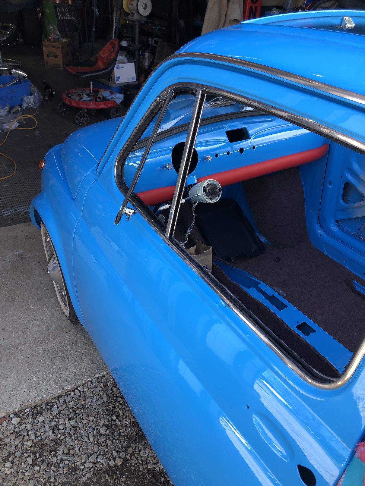

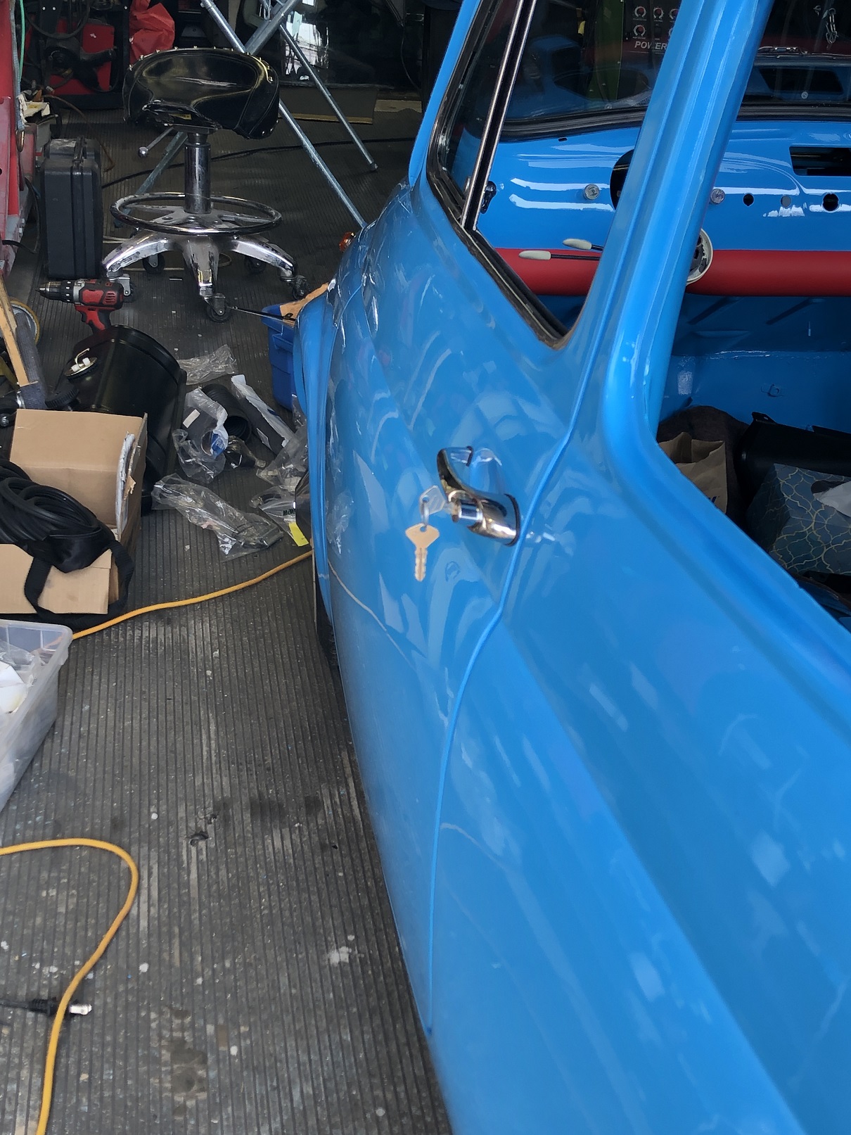

So starting off from a few weeks ago. Gave the interior a quick wetsand, buff and seal. I personally found the interior of these cars hard to paint, hard to fit the gun in tight spaces, and typically automotive interiors dont have as much exposed metal as the tiny 500. I unfortunately had a few small paint runs in some corners, but nothing the razor technique, 1000g, 1500g, 3000g couldn't fix. Dash turned out really nice, imo the showpiece of the 500. Once done, some of the interior bits went in like newly wrapped knee panel and visors. It was awesome to see the interior come to life. A layer of automotive one side reflective Jute felt went in, should give a nice soft feel as a carpet backer.

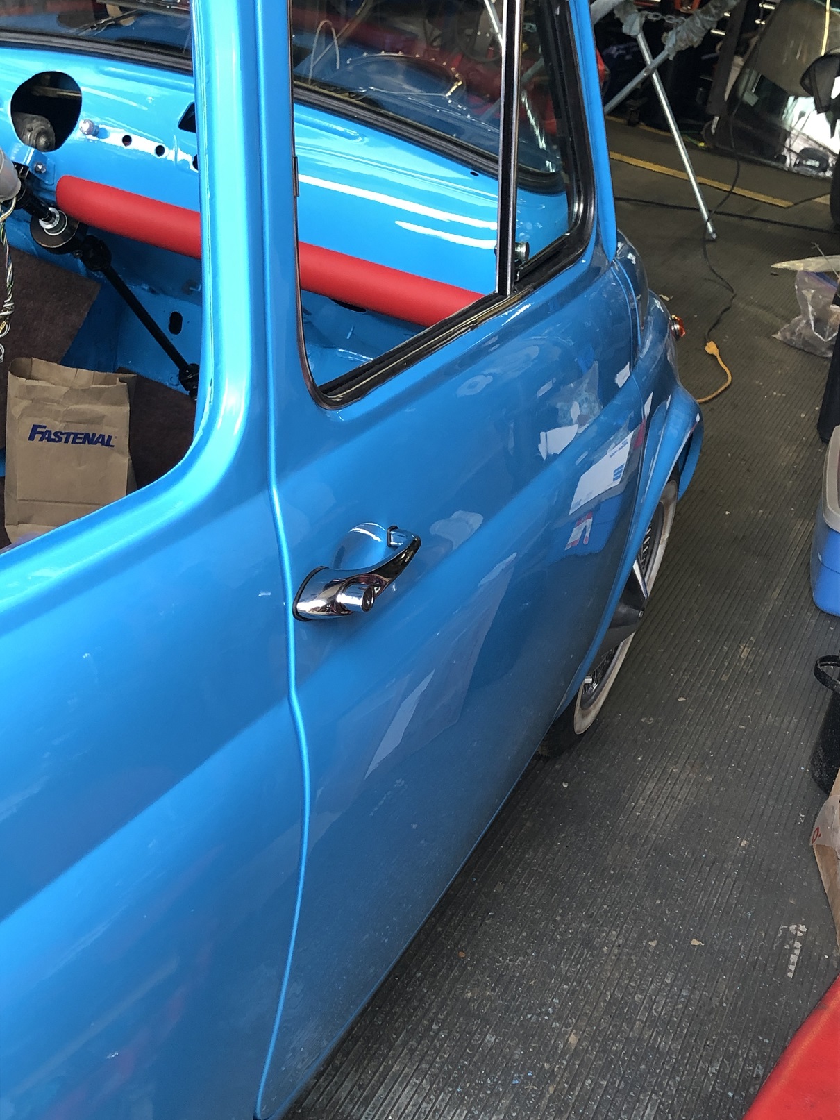

With the doors all painted i installed them on the car, and began installing the window trim. Saving and refinishing the original quarter glass assemblies help with a painless fit. The new seals were a tad tight, but they will conform with age. Passenger side and driver side went without major issue. Door handles were installed, along with the latch assemblies. A quick hinge adjustment (i drilled location holes while i did the body work so all i had to do was shove in 1/8" drill bits in the hinge holes and it all aligned up). Cant complain, panel gaps are very consistent, and body lines flow without issue. There is one tidbit i skipped over, but will go in detail in the electrical update.

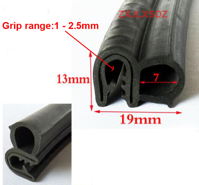

One issue i was facing during the body work and door alignment was the door seals. I misplaced the set i had purchased at the beginning of the build, Tom helped save the day and got me a set when i went over to visit. I then found my original seals 🤯. But either set i just unfortunately wasn't happy with the fit. It wasn't a quality issue, both were a oem decent quality gasket with internal reinforcements, i just found them both to be a touch too stiff when the door closed, and required a significant slam to get the door latch into its 2nd indent. No amount of hinge adjustments or body seam flange adjustment would get the seal right. I even left them on with the doors closed for months, and couldn't get the rubbers to "break in". I spent hours on the hunt trying to find a slimmer profile seal. In the land of vintage muscle i swear it would of been a simple task, but honesty is impossible to find that D profile gasket in the dimensions needed. Funny enough, of all places i found a seller on aliexpress that had a whole slew of profiles. Now you always have to take things with a grain on salt on AE, lots of junk or poor quality product on there. But i took the chance as i had no other options. I ordered 2 sizes, and low and behold when they arrived, the larger of the 2 worked perfectly. Quality was top notch too, good rubber quality and metal cored also. I was pleasantly surprised.
Here's the link in case any one is interested in also trying. https://www.aliexpress.com/item/1005002390307686.html
Type "3" was the one that fit perfectly, dimensional photo for reference.
1-Meter-Rubber-Edge-Guard-Edge-Trim-Soundproofing-Car-Door-Seal-Strip-Noise-Insulation-Weather...jpg

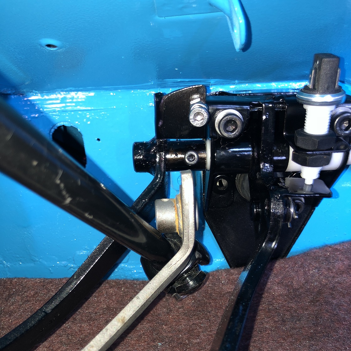

Pedal System:
That final 10% of the build is always the hardest. Or so, you leave the hardest to solve to the end 😋

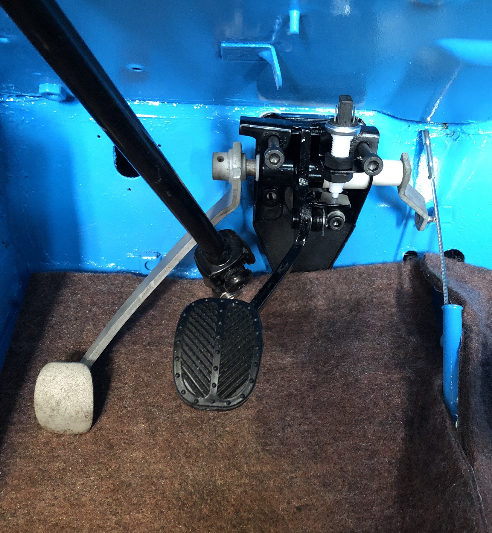

With the upgrade to the 126 rack in my case the steering universal joint landed right where the clutch pedal wanted to be. There were a few revisions to the clutch pedal design thru out the years, with mine being the older style (clutch cable lever and pivot one assembly, arm with bushing). I had been contemplating how to solve this. The easiest being welding a tube/bar in that wraps around the steering shaft then cutting out the original arm to clear. Something about doing that didn't seem right. Last week i stared at it for a while, then rummaged thru my bins. I had a few new "gen 2" style clutch pedals, and devised a plan. I removed the shaft from the new pedal. Machined a new "longer" tube sleeve, and spaced out the pedal enough to graciously clear the universal joint. With a few added benefits. The original travel stop no longer worked, so i welded a tab threaded a bolt with a double nut that will allow me to adjust pedal stop height which is nice. And second!, i always found the original pedal location very tight for my feet. I always had to take my shoes off and drive bare foot, or wear a slim pair of puma driving shoes. Not that im against driving accessories for the 500, but i wanted a tad bit more space. The new location spaces the pedal about an extra 3/4" out, with still lots of space between the inner fender. Should be a good compromise when driving. The safety/design aspect of the brake pedal is untouched
I love this color scheme more and more with each update. Can't wait to see it all together!
Nice and elegant solution for the pedals!
