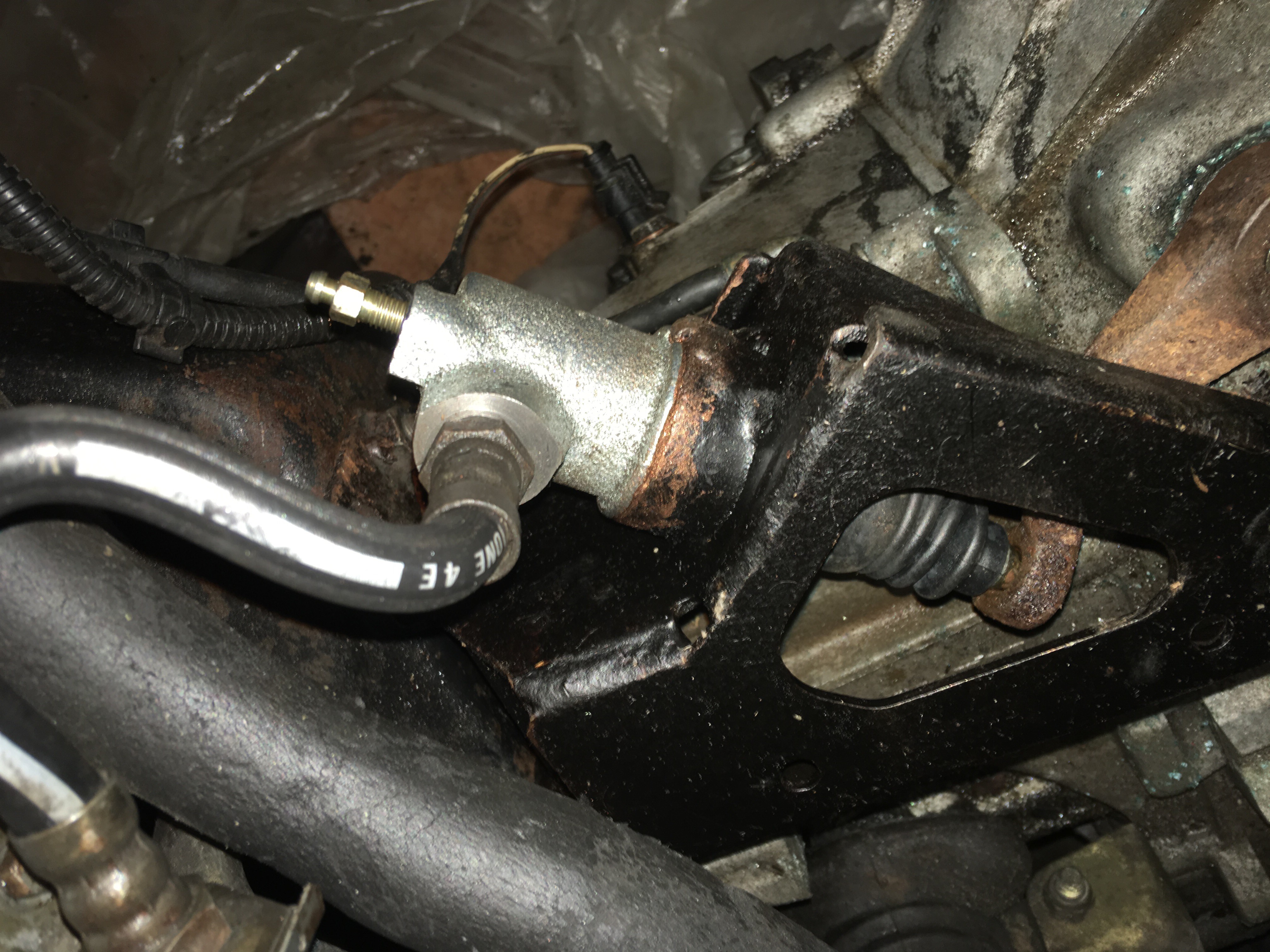

Unfortunately, the days of wind in our hair and cloudless skies (sunroof) didn't last long. I went down the garage to get a proper clip round the inner cv boot. Picking it up after hours, the clutch was almost on the floor. Unrelated, but why do such things happen... :rolleyes:
I'd been surprised the original slave cylinder was working and glad, because it looked jolly awkward compared to the TD (just 2 bolts). However, on getting back from the garage it had clearly sprung a leak.
On this car the slave sits in a steel bracket sleeve. I assume the gearbox was designed for a cable and this was the easiest way to accommodate hydraulic.
So both were predictably rusted together SOLID. Smashing the slave with a hammer then cutting it down with a grinder didn't help. I came up with the idea of frying them for a while on the hob and this enabled the slave body to start to release, after further clouts with hammer and chisel.
Oh, and not to mention the most awkward and brutish circlip.
So here is the new one Dynaxed and copper-eased to excess. The little plastic protection was missing from this side when I got the car, they reduce wheel spray, garages tended to 'lose' them, and it contributes to problems like this.

Any hints for getting that retaining circlip back on? I decided to change my cylinder as I had one in stock plus the old one looked like it was weeping fluid out under the boot. Unfortunately i need to change the hose as well but don't have one of those at the minute. You need about 3 hands to try and get the circlip back on!
Any hints for getting that retaining circlip back on? You need about 3 hands to try and get the circlip back on!
Yes. It's a problem. I had a cheap circlip tool (too small for this brute, but can fit in one hole in the circlip) then a screwdriver type thingy with a point (can't think what it's called :bang:) in the other hole and maybe pliers too to drag the other end round. I think I got enough circlip on the body to tap it on further with a hammer.
A needlessly difficult task. Pleased you are still making progress, post any updates when you get chance (y)
Yes. It's a problem. I had a cheap circlip tool (too small for this brute, but can fit in the hole in the circlip, then a screwdriver type thingy with a point (can't think what it's called :bang:) edit: a braddle, in the other hole and maybe pliers too to drag the other end round. I think I got enough circlip on the body to tap it on further with a hammer.
A needlessly difficult task. Pleased you are still making progress (y)
I just realised you must have removed the bracket in its entirety with the cylinder still attached. I tried changing mine in situ (the old one came out easily in contrast to yours).
I will probably just take out the bracket, clean it up and fit the cylinder on the bench.

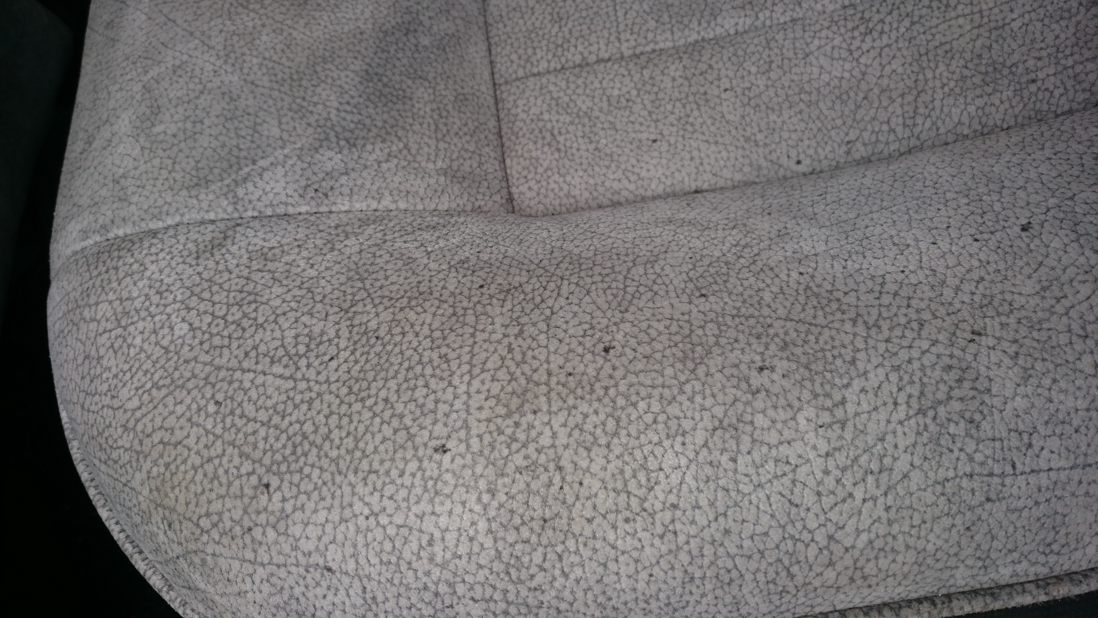

Someone attempted to clean the front seats and ruined the faux leather, I am wondering whether some light work with a razor will restore the sought after tortoiseshell look?
I've got some Punto wheel trims I feel will work with the Tipo aesthetic whilst a little more contemporary and I need to work up the energy to fit them.
