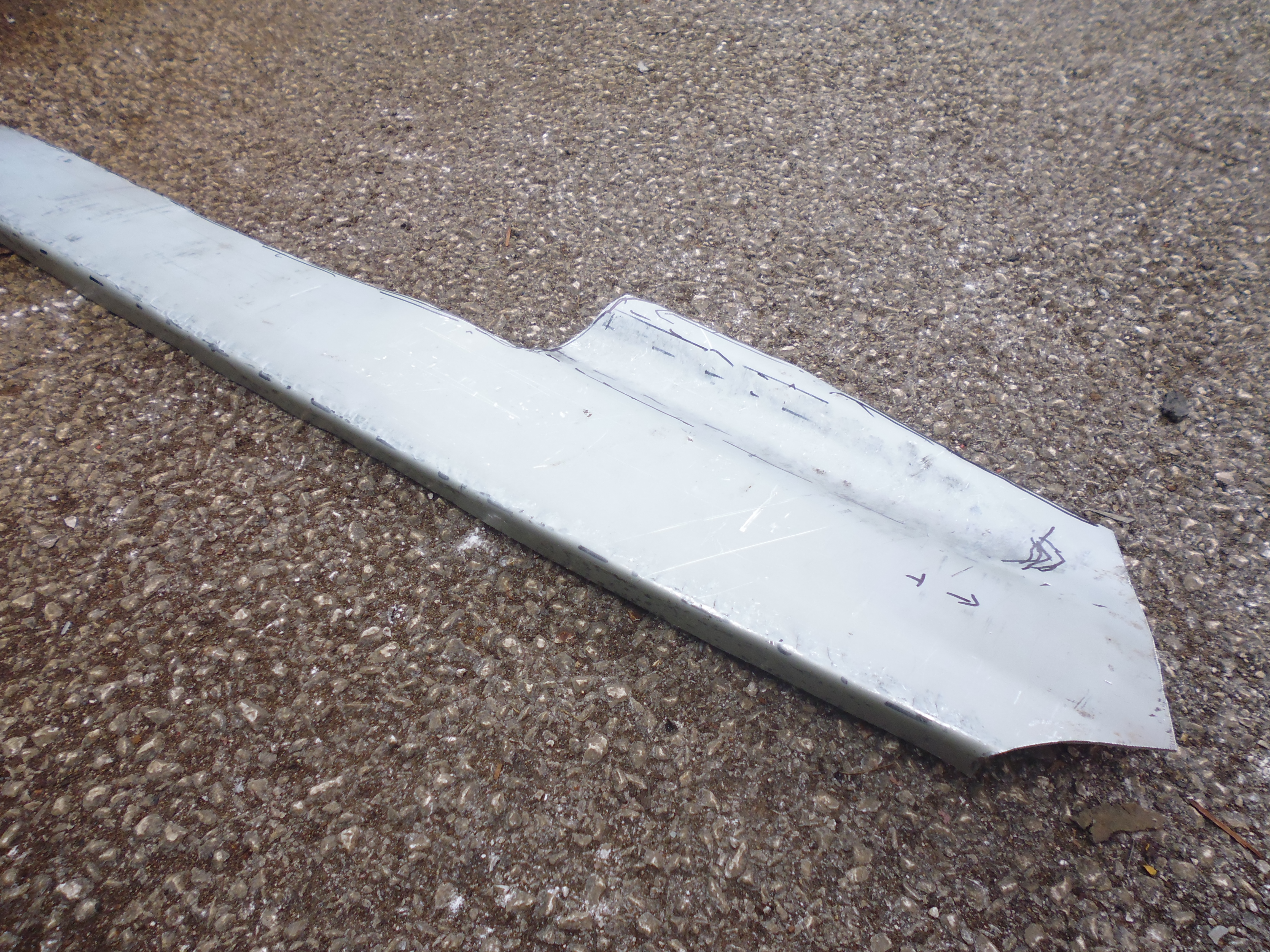

The rear valance is heading the same way as the red Tipo and cutting off and using the remade valance from the red one may be the way forward later on.

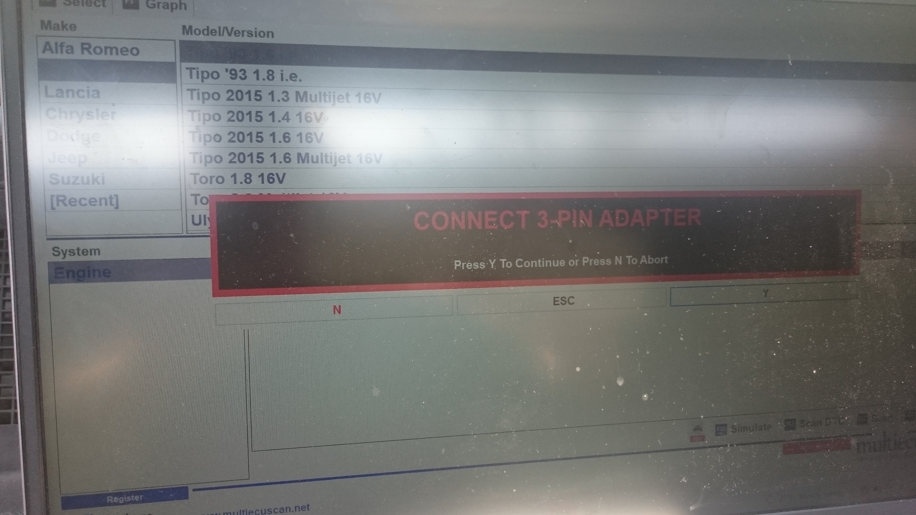

Then it was time to deal with some remaining issues. Working the air-con seemed to precipitate the engine light coming on again. I purchased the Multiscan software and 3 pin cable adaptor and plugging in highlighted two errors - crankshaft sensor and Throttle Position Sensor.
I'm grateful to Adrian Bravo on the Forum for his thread suggesting marking the TPS position (calibrated at the factory) with spray paint. It works! Here is the old one sprayed up before removing, an old-style anti-tamper torx (6 points) is needed to get it off. The new one (pictured) shows the largish holes to allow for alternative positioning on the injection unit.
The old TPS looks ok, but starting up the car the idle sounds to have stopped fluctuating all over the place. All the numbers, more on the other side, what do they mean!

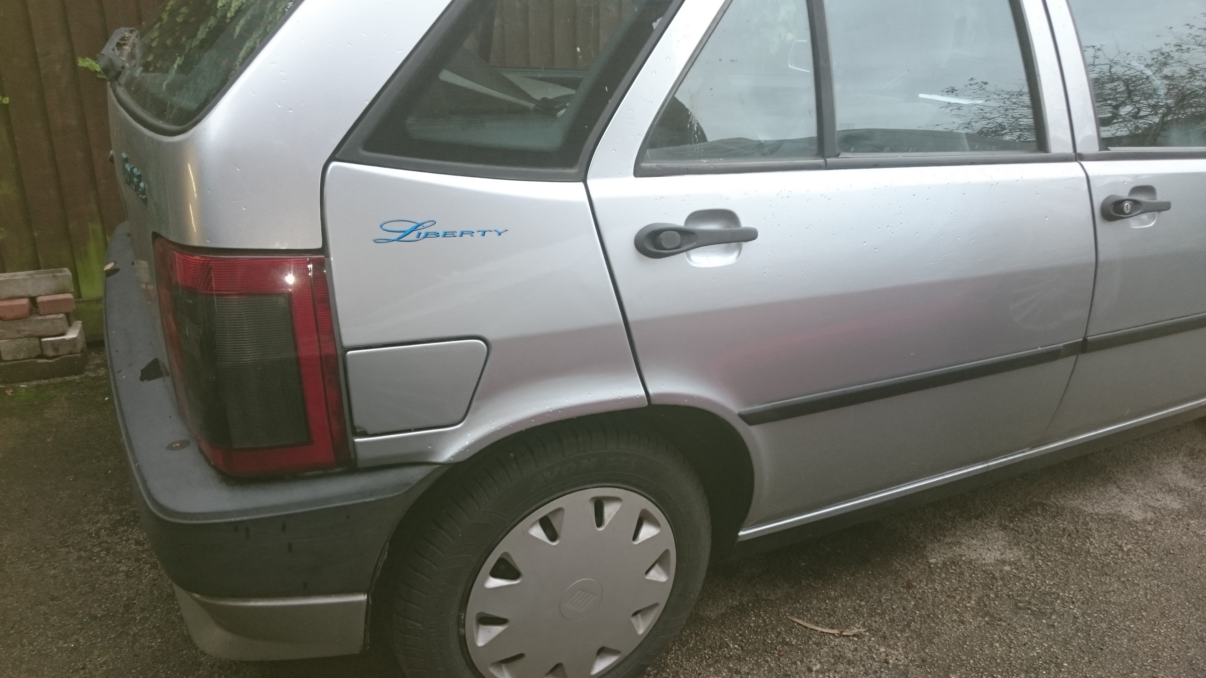

One day (when not in a rush and liable to mess up) I reinstated the missing decal, another italian purchase.

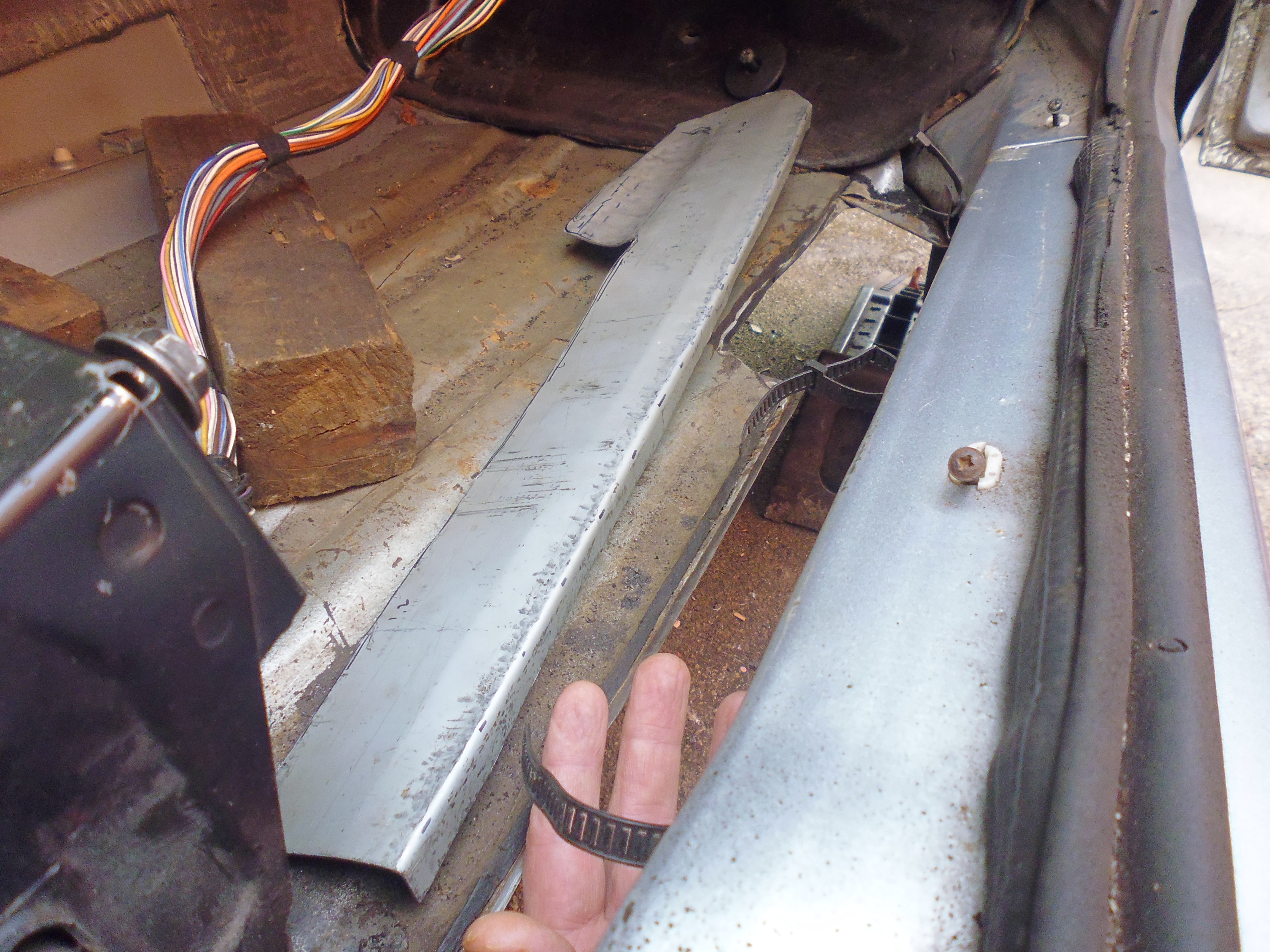

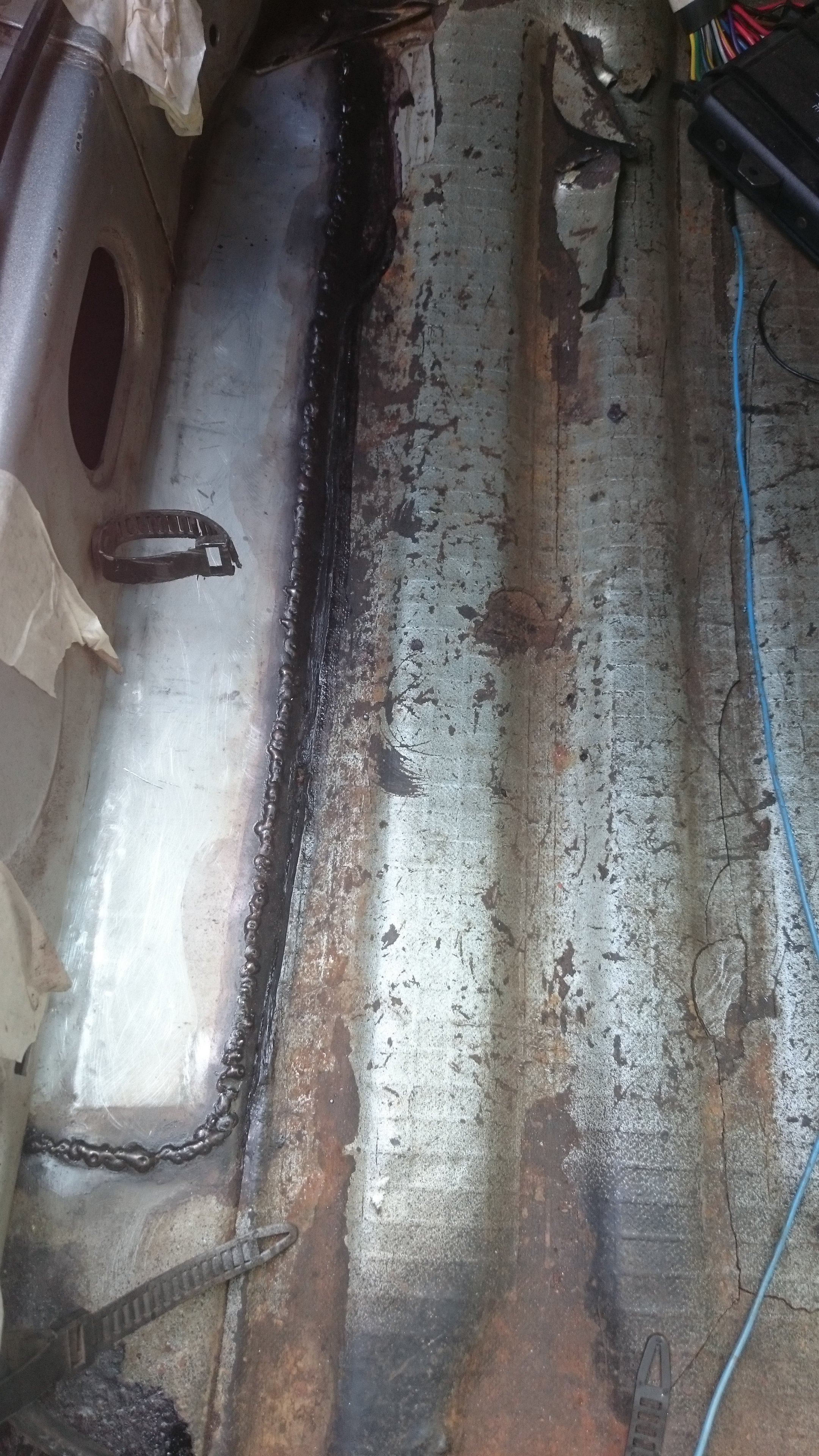

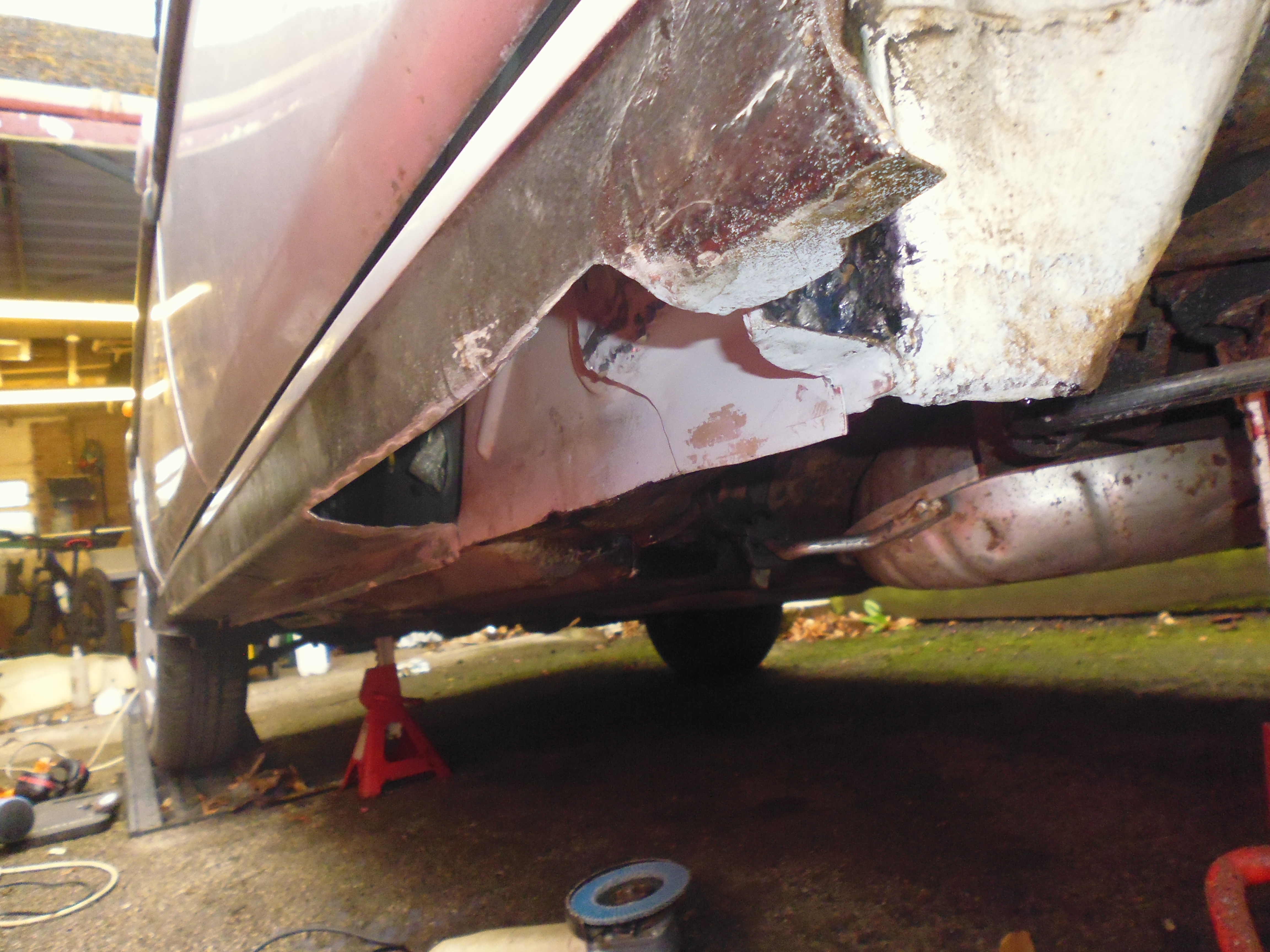

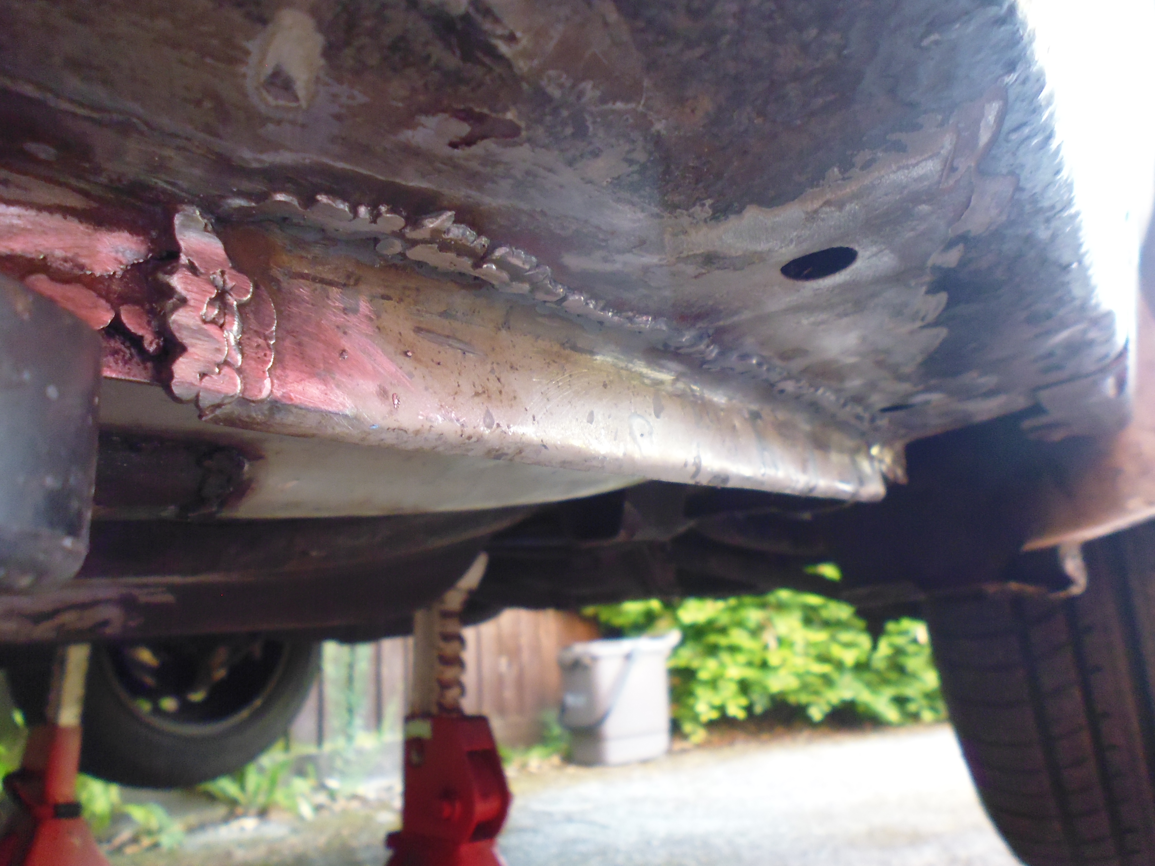

The front repairs require repairs to 3 pressings, the floor, inner sill and outer sill, then all spot welded together at the seam

Hello,
Do you have any other error codes? The crankshaft sensor error always pops up when scanning the ECU with the engine not running and does not indicate a problem with the sensor.
Hello,
Ah that's helpful. There were a couple of others. It's only just back on the road but the engine light has appeared from time to time. When I get back I will scan it and if you have any thoughts I will appreciate it.
then moved from front left to front right. Removed old plating and rusted remains. These holes are a bit smaller than they look perhaps but restoring integrity was required by rebuilding the panels and the spot welded seam where the 3 panels join.

There are relatively few variables on these engines so interpreting the error codes goes a long way usually in solving issues.
I also follow engine parameters to understand what is happening, but the fact that MES always disconnects after a few seconds makes that challenging. Do you have a stable connection to the ECU?

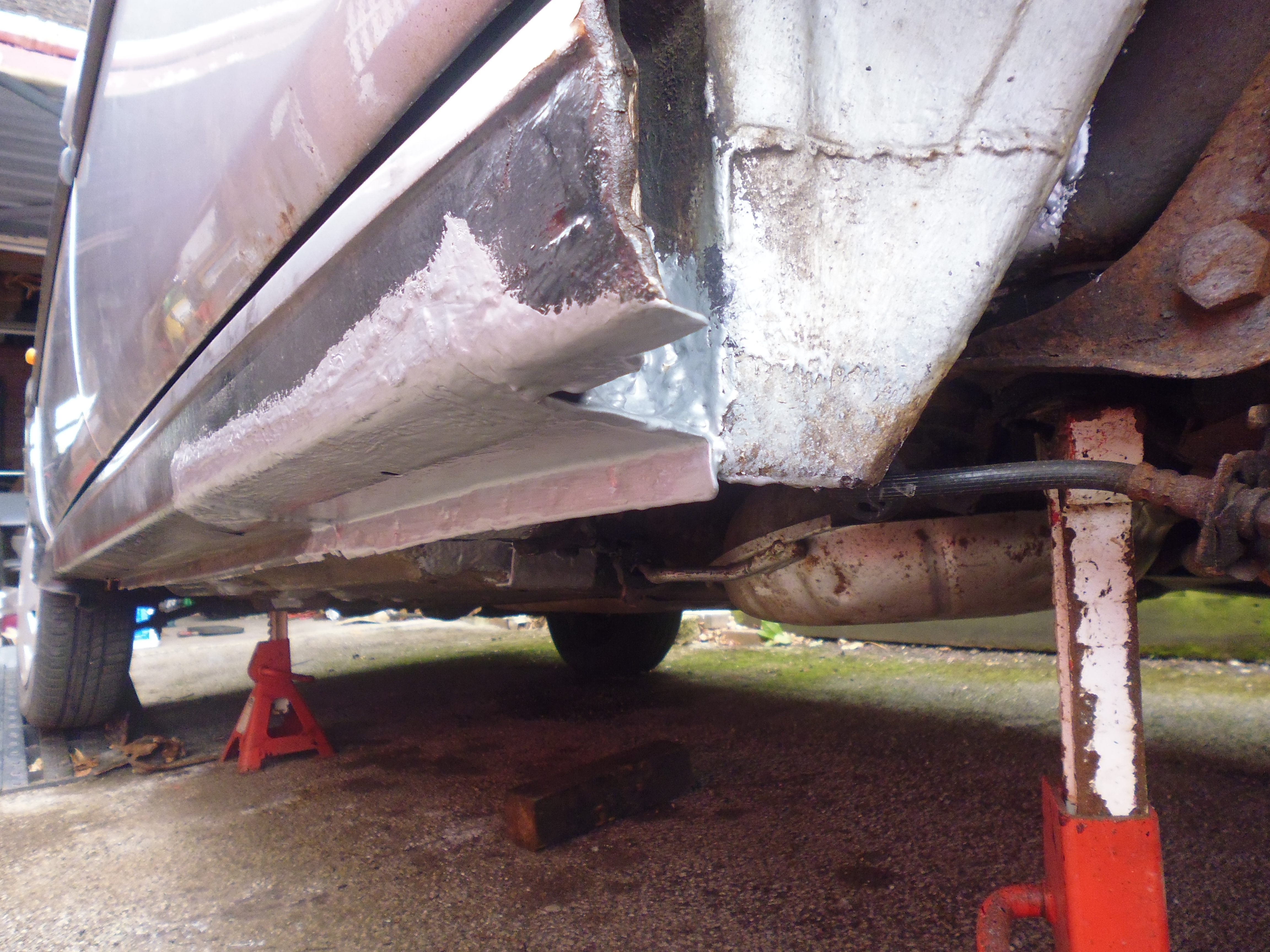

'Touchwood' this 'should' draw the body repairs to a close, finishing with epoxy mastic, galvanising spray and noxudol as required.

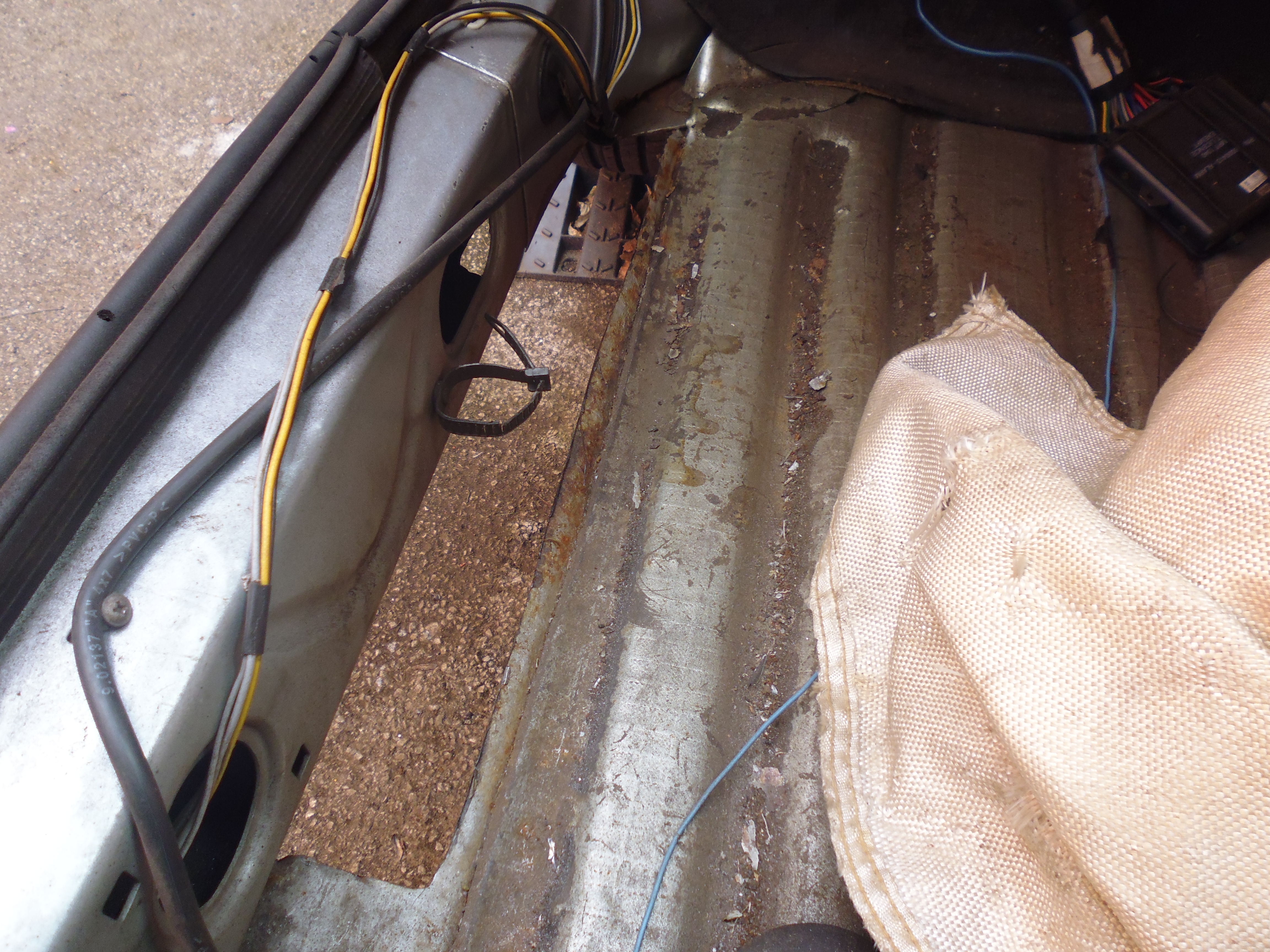

Glad to see this rust-trap plating gone. The underlay toward the sides of the car may cause some of this by being a wet sponge, so I glued replacement deadening to the underneath of the original old rubber mats. I hadn't noticed until now the black seals between the side doors were broken and perished, likely letting water in to collect on the floor. The seal strip parts seem to be extinct, but there are some great products from Ebay (China) which fit really well. Finally, I replaced the shaft seal that had leaked on the refurbished AC compressor, with a seal kit, Youtube videos on how to repair the Harrison V5 compressor were essential. The AC seems to be holding up, at last.
